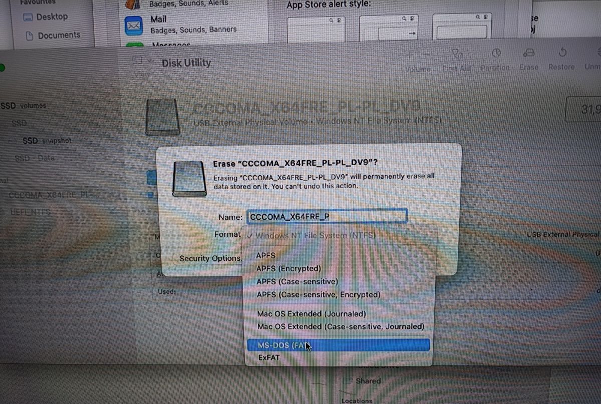

    Connect our flash drive to the mac. We go to Disk Utility (e.g. via Search) and format it in FAT:
    Disk Utility window for formatting a USB drive on a Mac. .

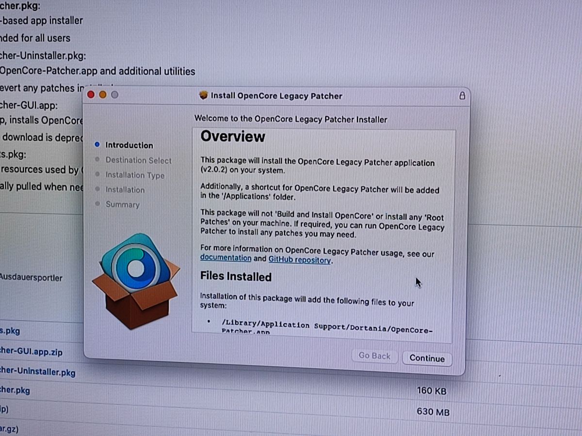

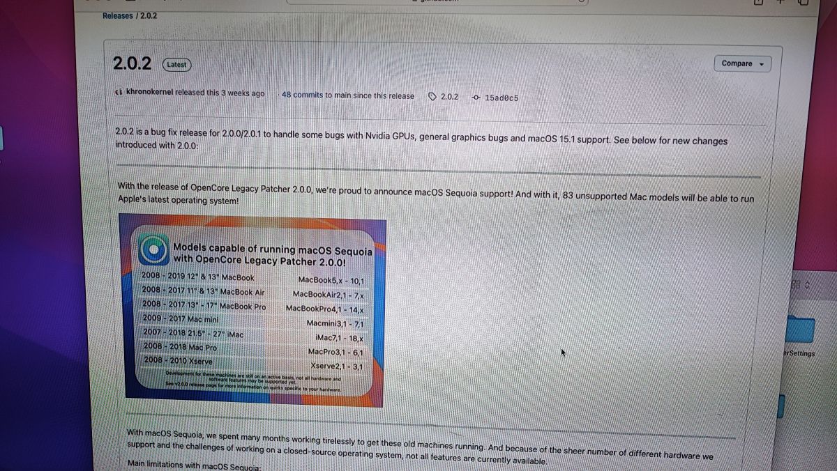

    We download the OpenCore Legacy Patcher from Github (Releases tab):
    Screenshot of a website detailing OpenCore Legacy Patcher 2.0.2 and compatible Mac models. .

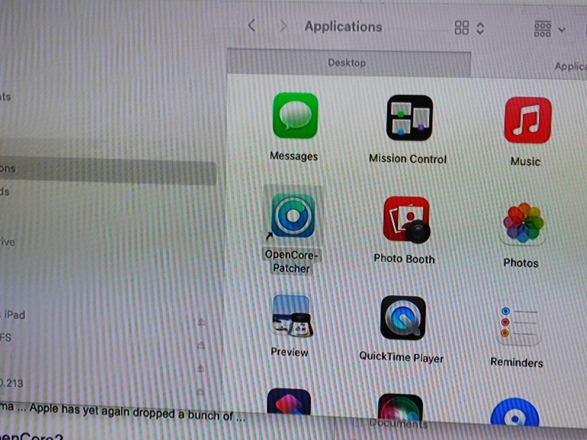

    Install - it should appear in Applications:
    OpenCore Legacy Patcher installation screen on a Mac computer. Screenshot of Mac applications, including OpenCore-Patcher. .

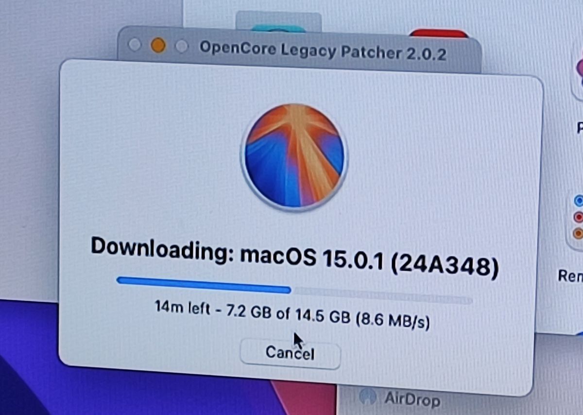

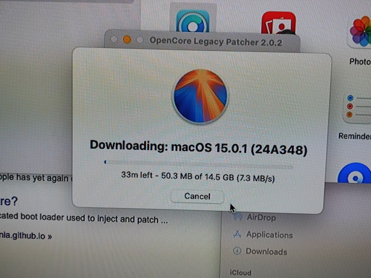

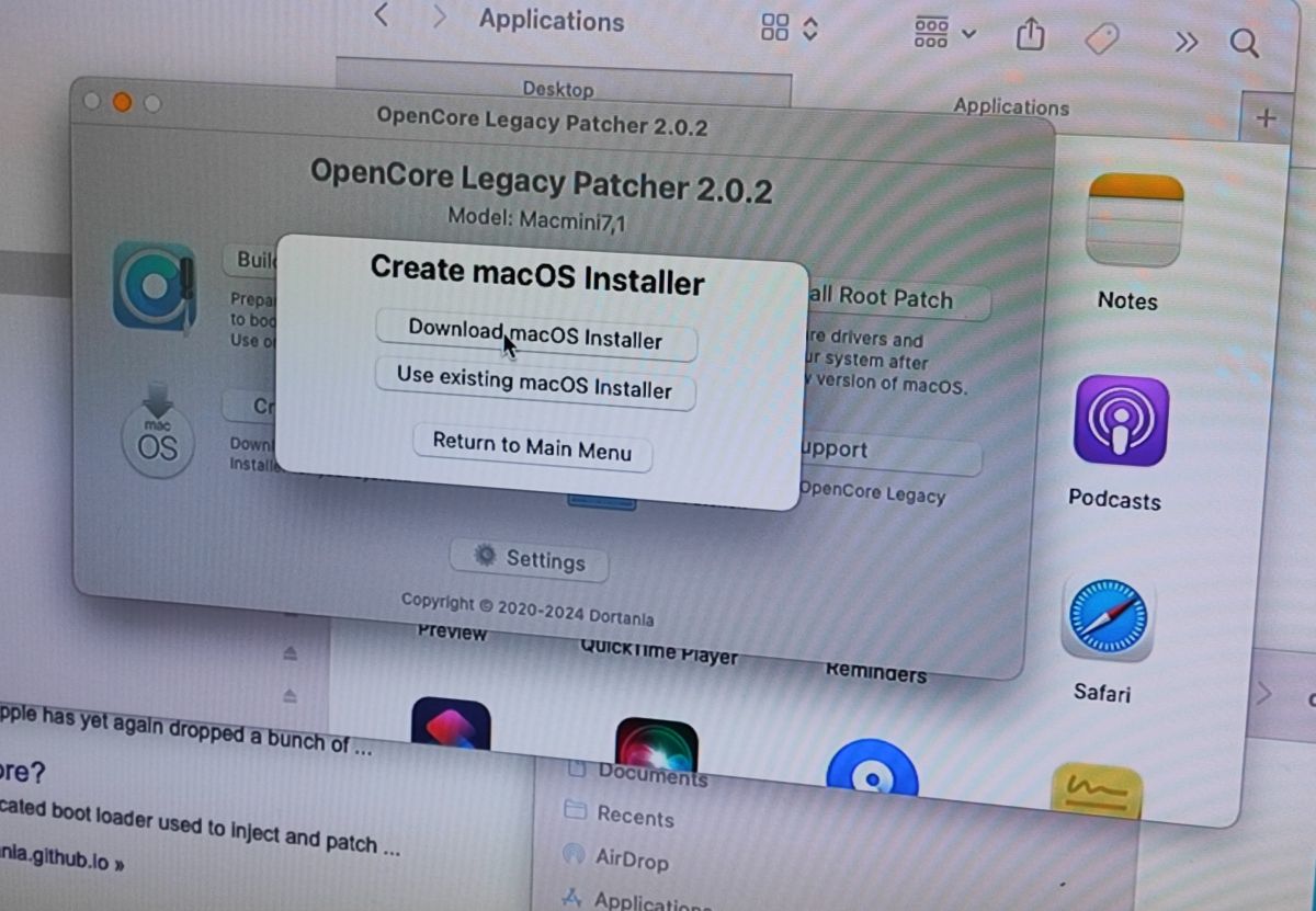

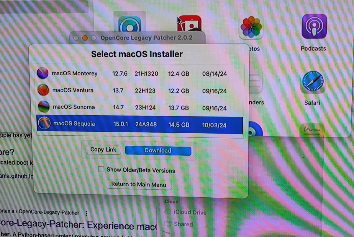

    Firing up. We start by downloading the system image - "Create macOS Installer". Select the desired system from the list. The download will then start, we wait.
    OpenCore Legacy Patcher 2.0.2 application window on a Mac computer. OpenCore Legacy Patcher screen with the option to download macOS installer. OpenCore Legacy Patcher window with macOS installer selection Screenshot of macOS 15.0.1 download process using OpenCore Legacy Patcher. .

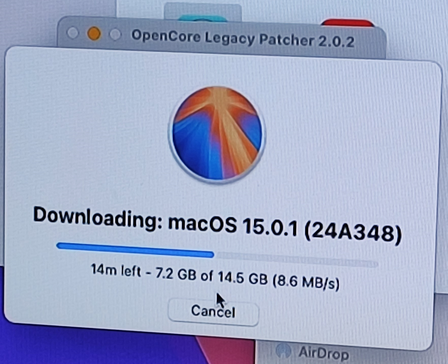

    Patience:
    macOS 15.0.1 downloading window using OpenCore Legacy Patcher on macOS. .

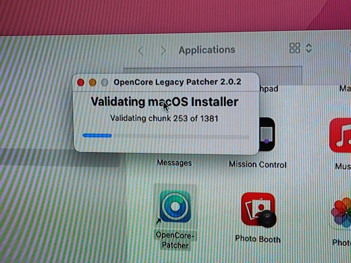

    Then we still wait for validation:
    OpenCore Legacy Patcher installer window validating macOS installer. .

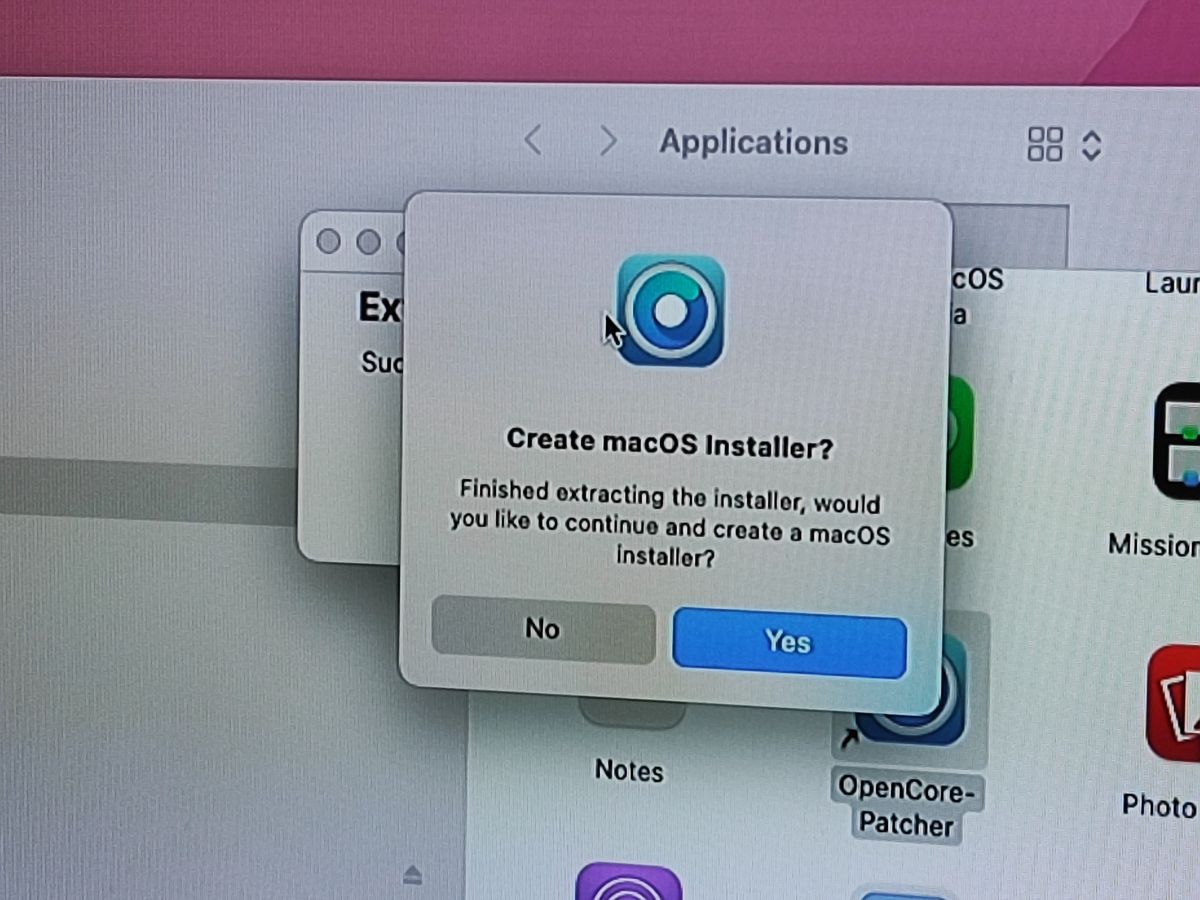

    Once downloaded, we confirm the creation of the macOS installer:
    Screenshot with the prompt Create macOS Installer? .

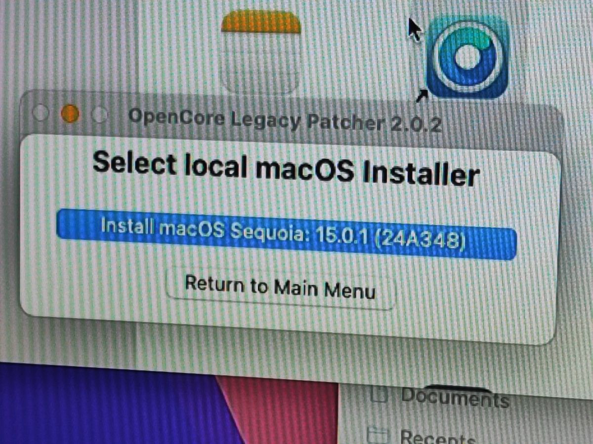

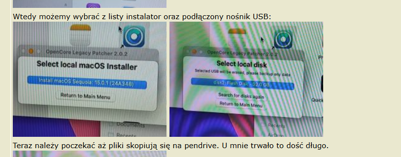

    We can then select the installer and the connected USB stick from the list:
    Screenshot of OpenCore Legacy Patcher 2.0.2 with the option to install macOS Sequoia 15.0.1 selected. Disk selection menu in OpenCore Legacy Patcher 2.0.2 with a selected 32 GB USB drive. .

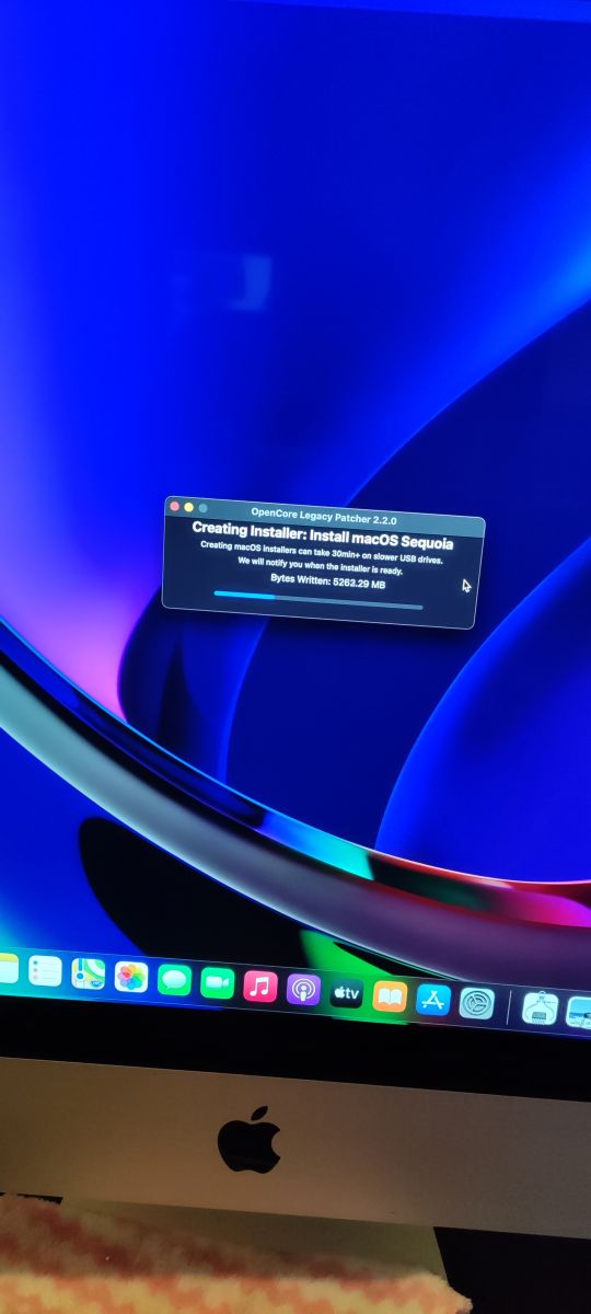

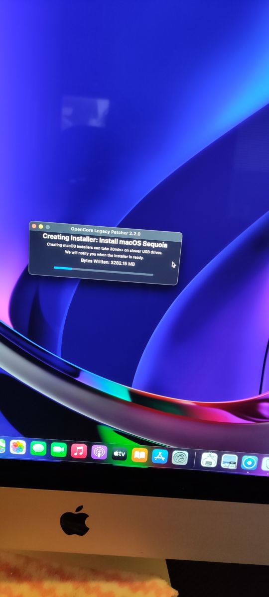

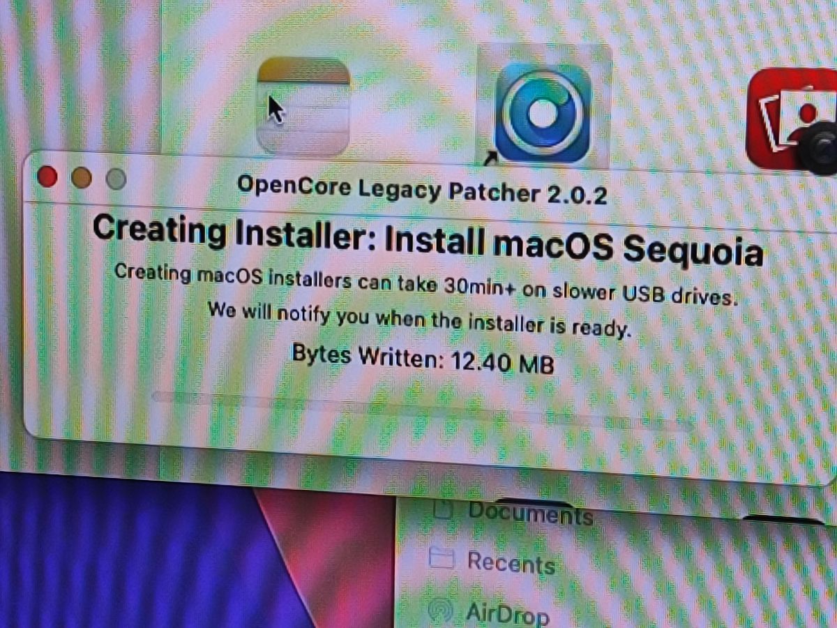

    Now you have to wait until the files are copied to the USB stick. In my case it took quite a long time.
    Creating macOS Sequoia installer process using OpenCore Legacy Patcher on a Mac. .

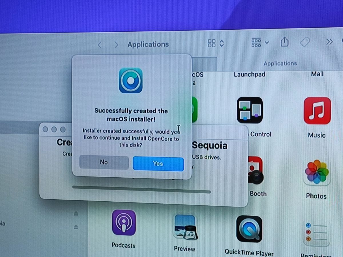

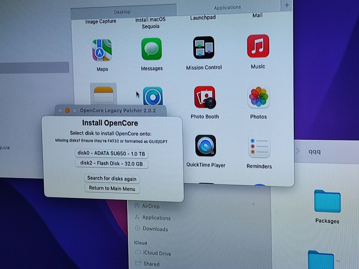

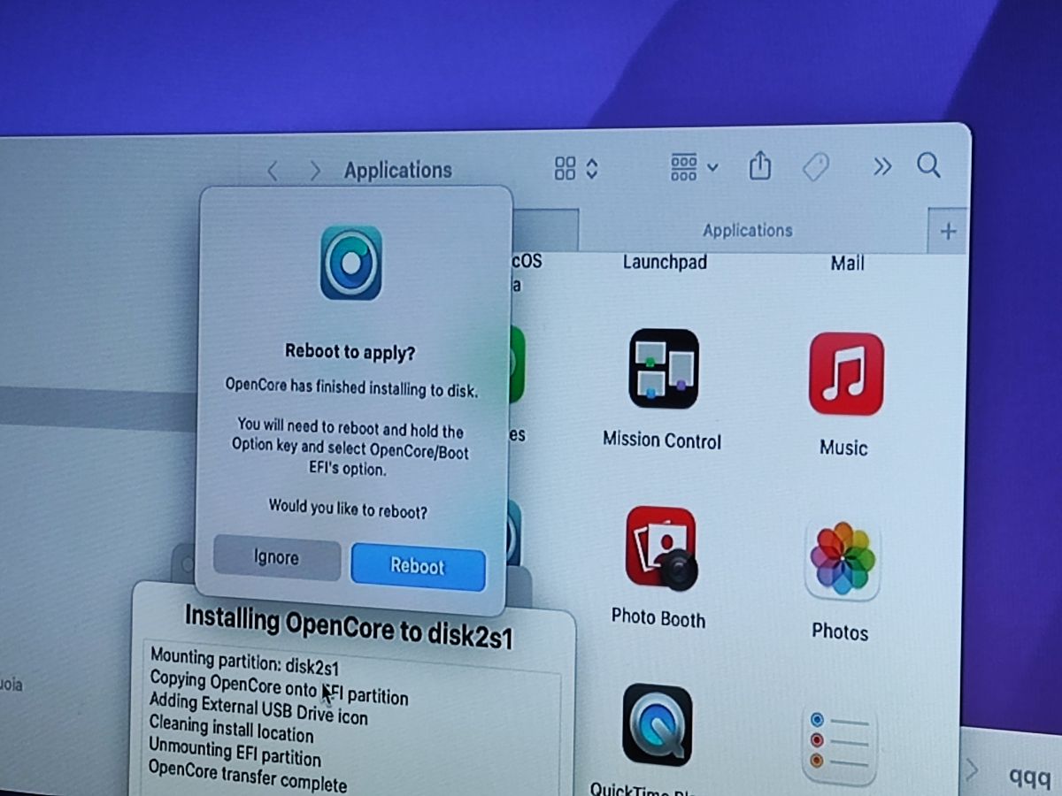

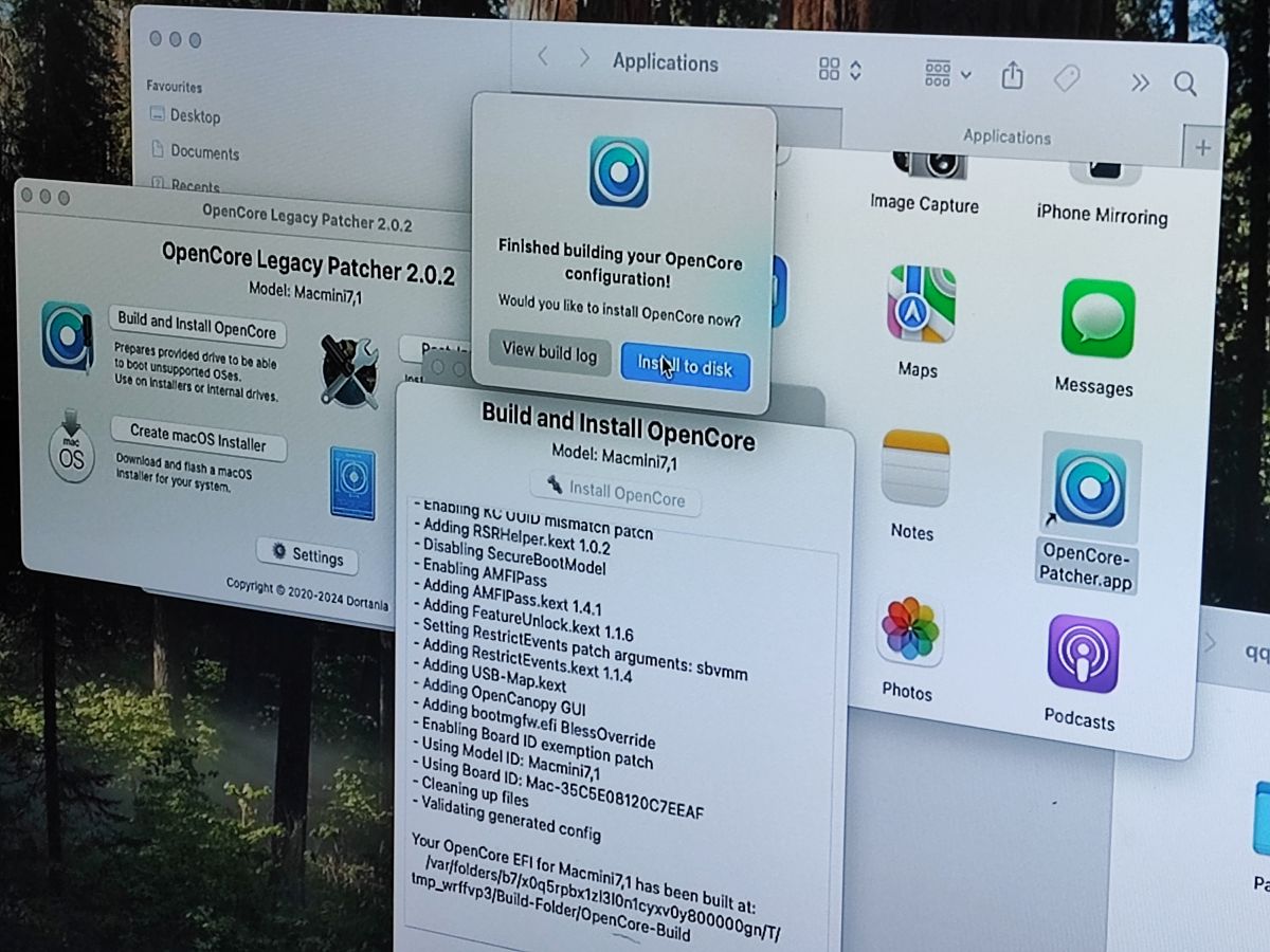

    Then you will be asked if you want to install OpenCore to this drive - yes, confirm, select the flash drive, its first partition:
    macOS dialog window confirming creation of installer and option to install OpenCore. Installing OpenCore on Mac Mini using OpenCore Legacy Patcher Installing OpenCore on Mac with disk selection OpenCore Legacy Patcher window showing volumes on disk2. .

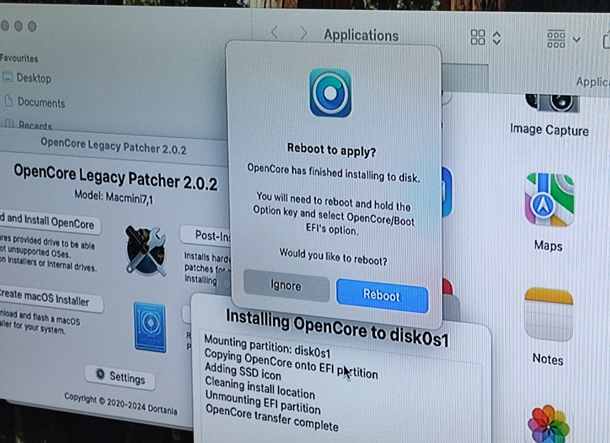

    After the installation, confirm the reboot and on this reboot press the Option button to be able to select the media from which to boot.
    Message about successful OpenCore installation and reboot prompt on macOS screen. .

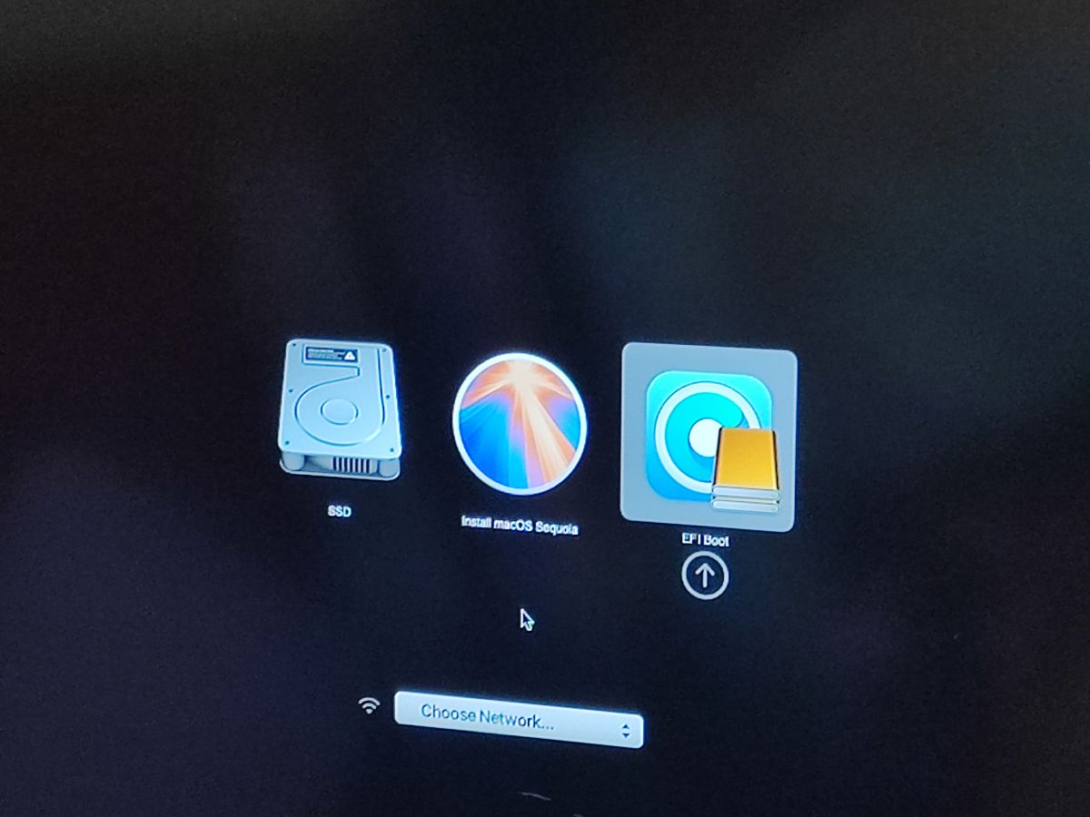

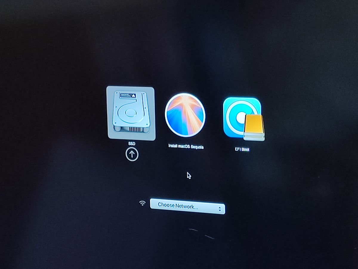

    Selection of bootable media:
    Mac computer boot selection screen showing operating system options. .
    In addition, we then press Control to select the carrier from OpenCore as the default choice:
    Startup disk selection screen with options: SSD, Install macOS Sequoia, and EFI Boot. .

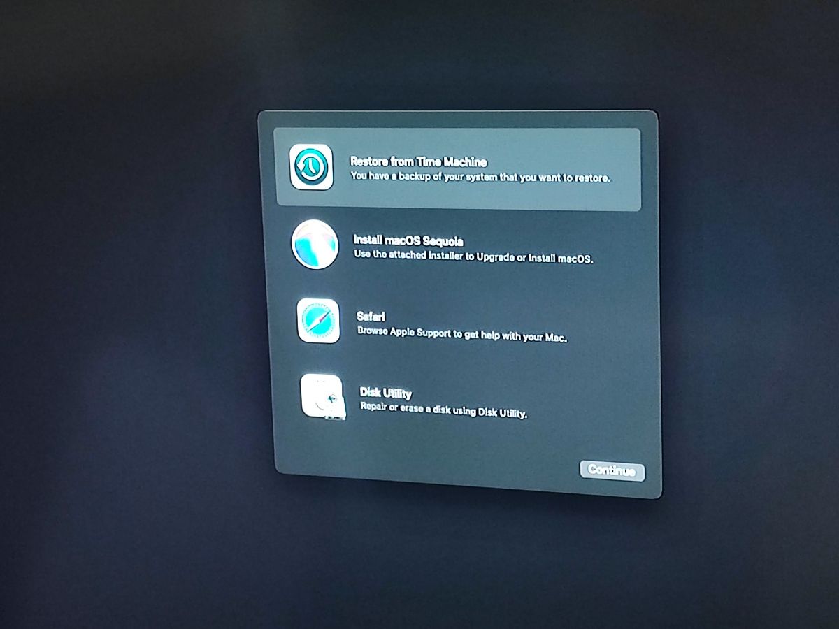

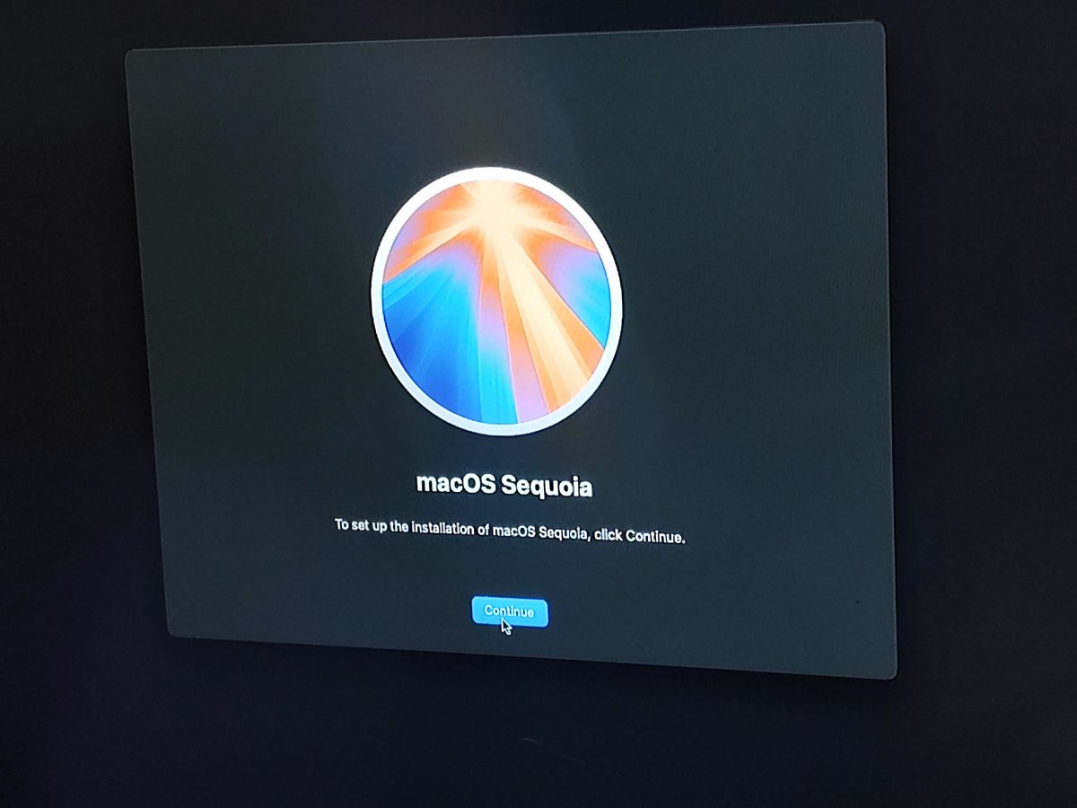

    Select the "Install macOS Sequoia" option:
    macOS installation options screen on a Mac computer. .
    There are not a lot of options to click through, basically just select the target drive (the hard drive from inside the computer):
    macOS Sequoia installation screen with Continue button. .

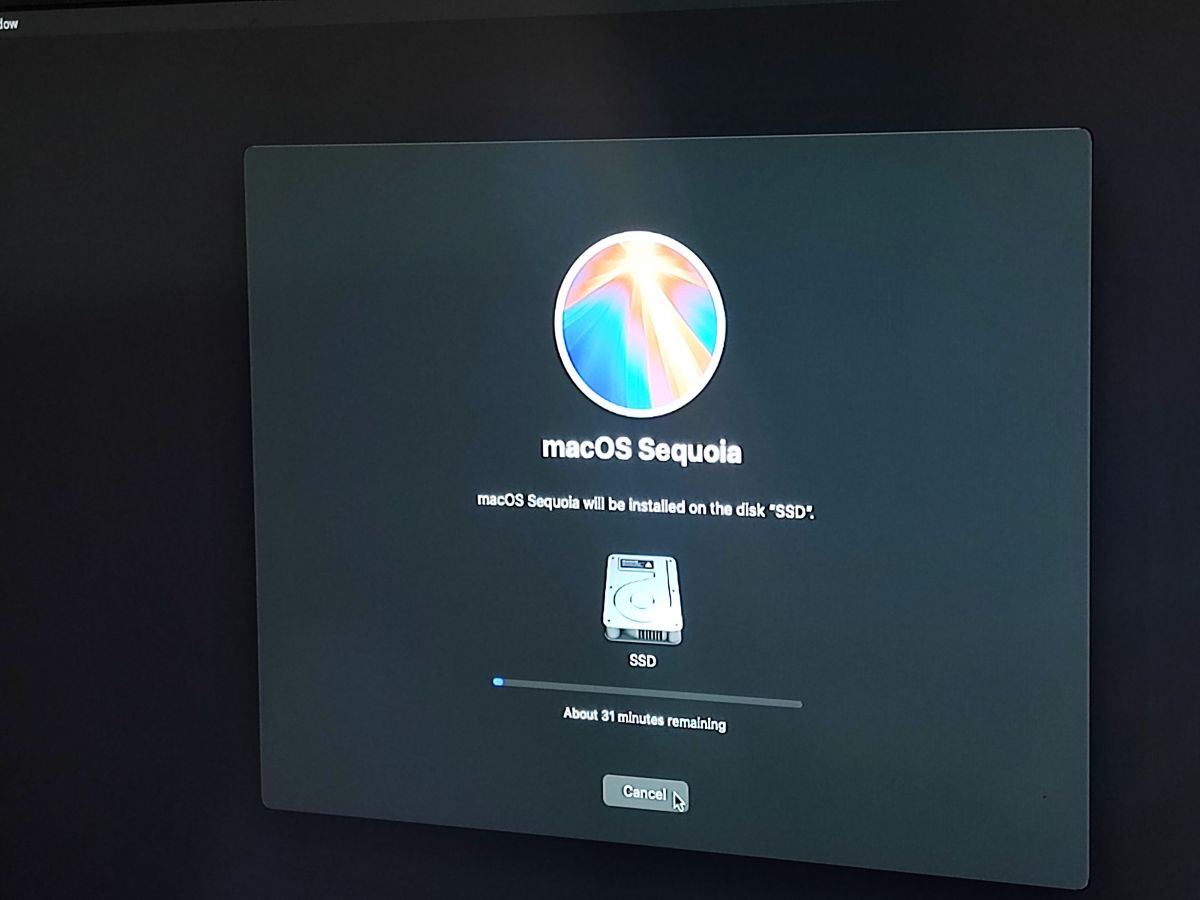

    We install and wait - but really patiently. In addition, the system will perform several full reboots along the way and the progress bar will start from 0 several times.
    macOS Sequoia installation screen on SSD with time progress. .

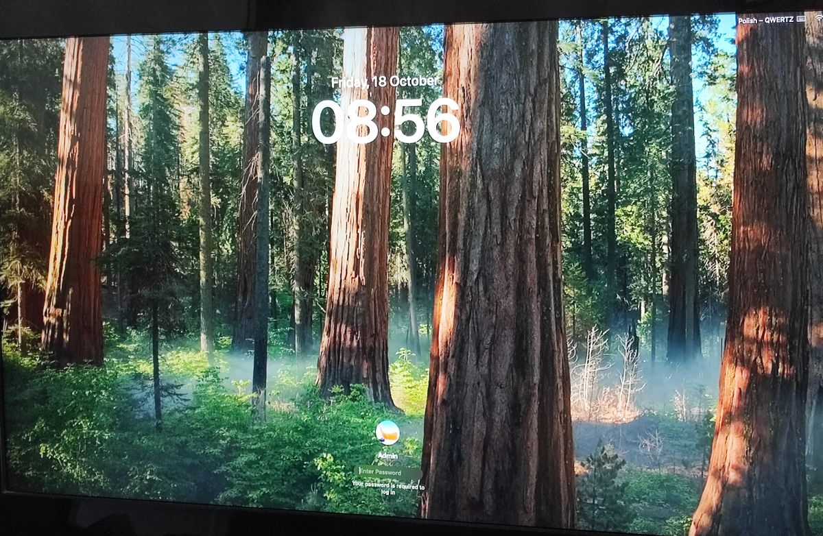

    Success. We log in, password as we had before:
    macOS login screen with a forest wallpaper featuring large trees. .

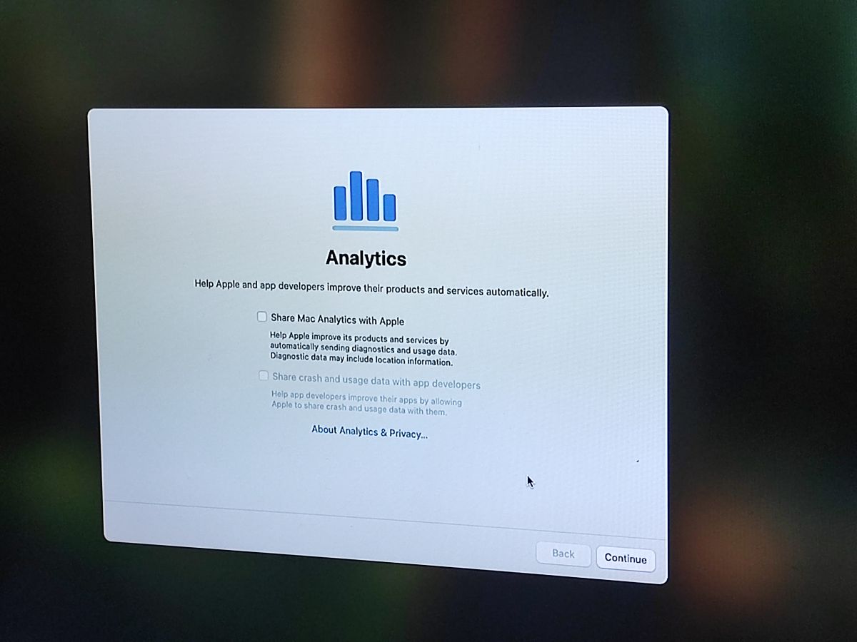

    We give our consent (or not):
    Analytics settings screen in macOS. .

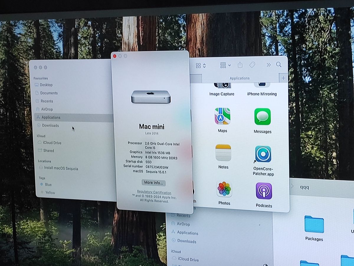

    And after a while we have a new system and our files are still in place:
    Computer screen with open windows showing Mac Mini information and OpenCore-Patcher app. .

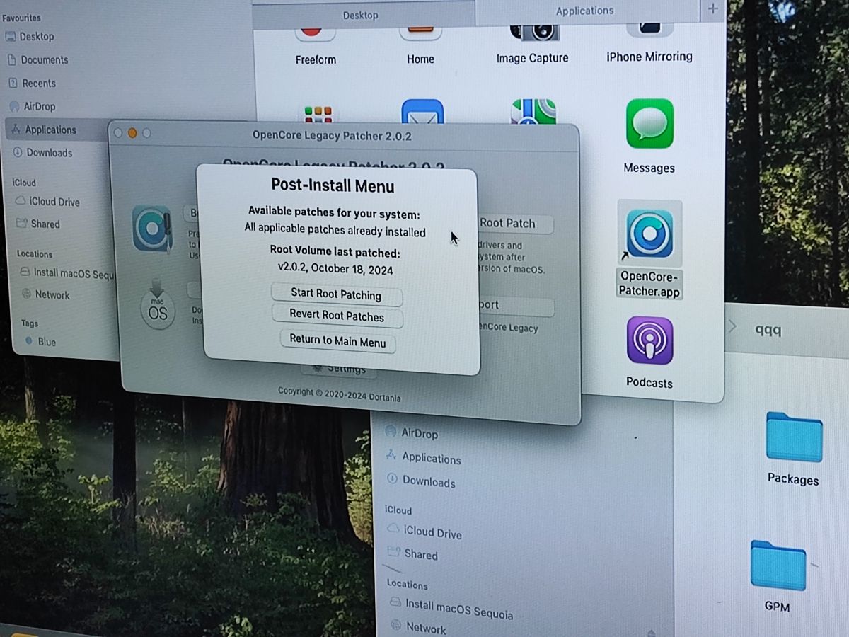

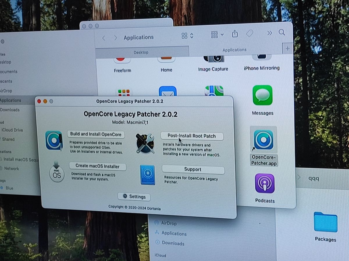

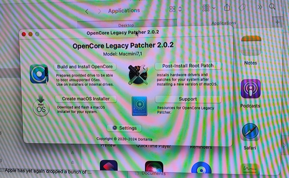

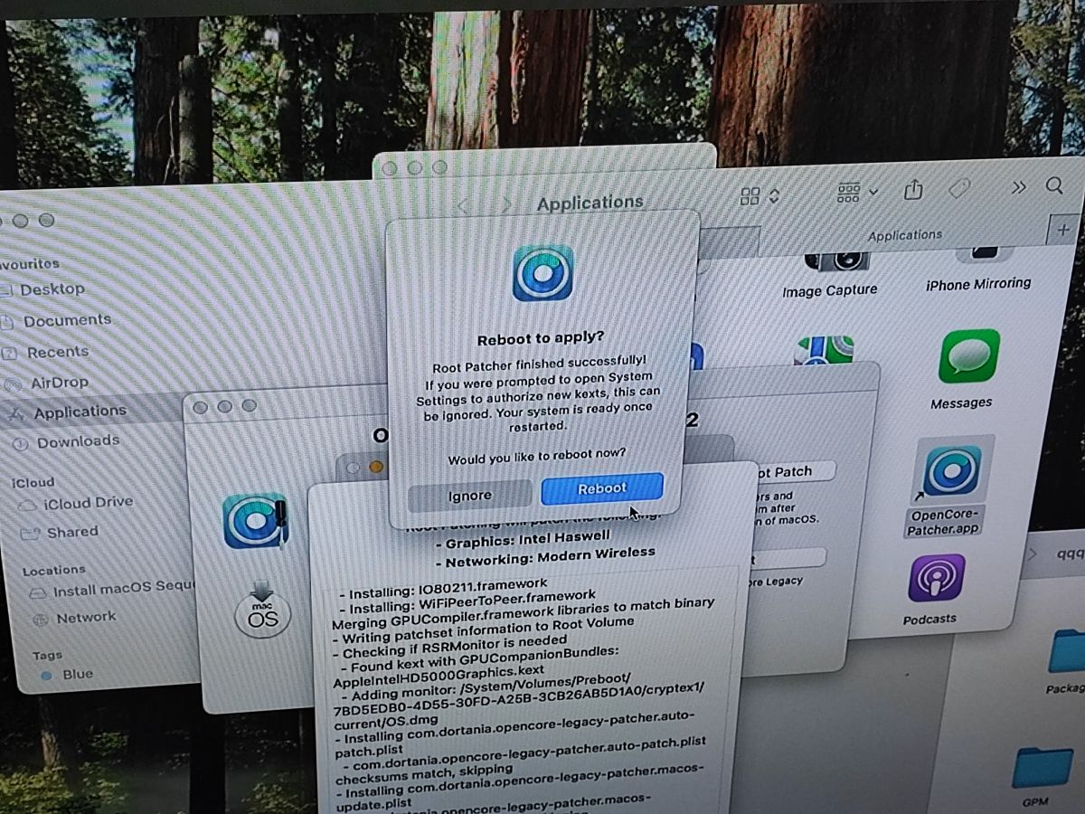

    But this is not the end. You still need to perform a Post-Install Root Patch:
    Mac screen displaying OpenCore Legacy Patcher 2.0.2 window and application icons. OpenCore Legacy Patcher app window on a Mac screen. .
    The system will suggest a reboot, and....
    Screen displaying a message about the need to reboot after applying Root Patcher on a Mac. .

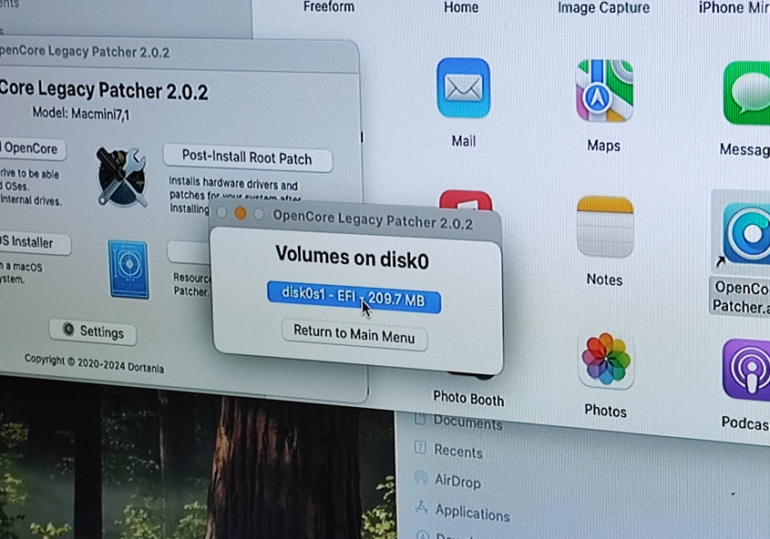

    Well for me then, after removing the flash drive, the mac would no longer boot. Only one additional step fixed it - you also had to install a patcher for the first partition on the main hard drive, just like before on the flash drive.
    Prohibition symbol icon on a screen background. .

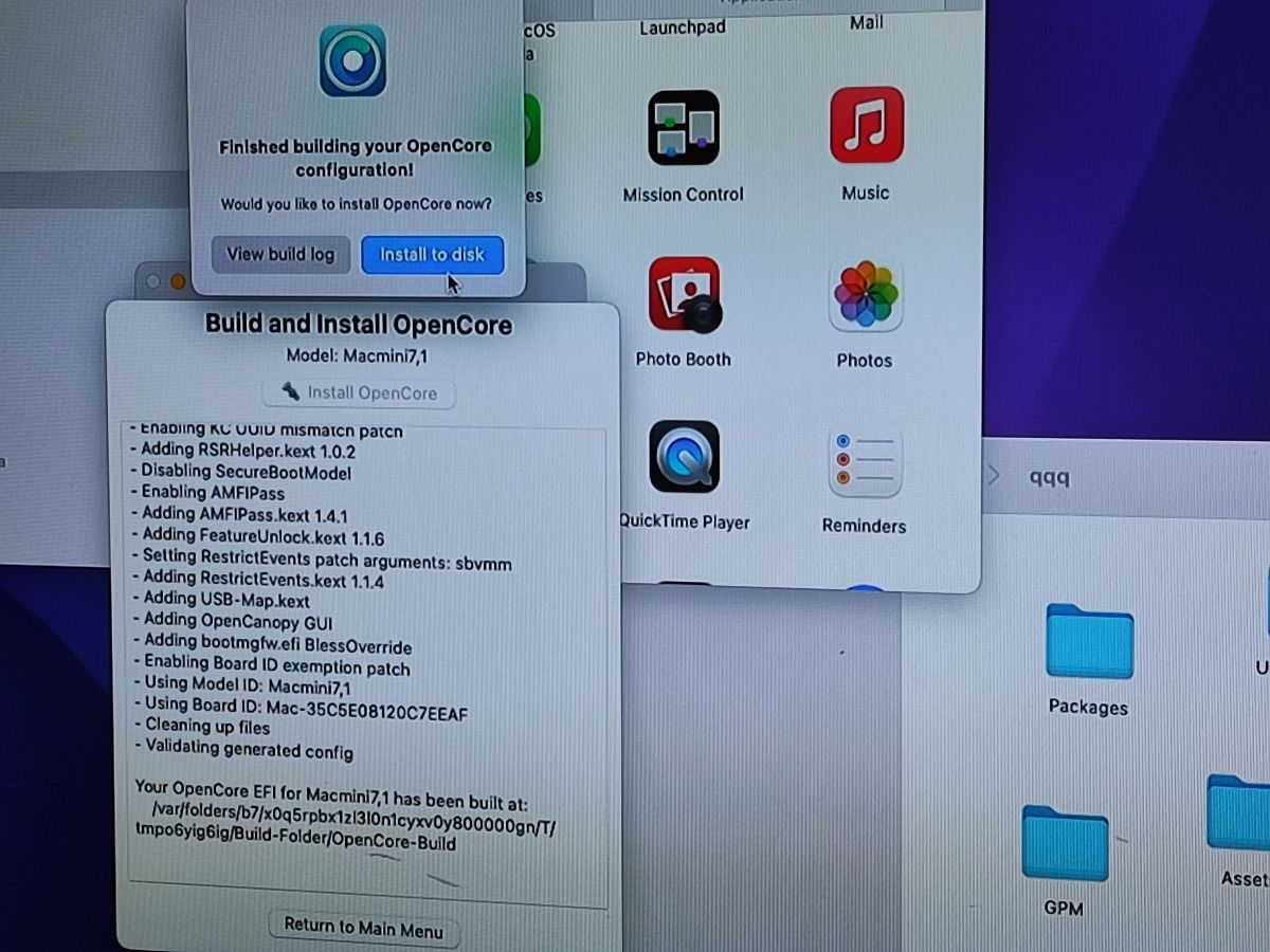

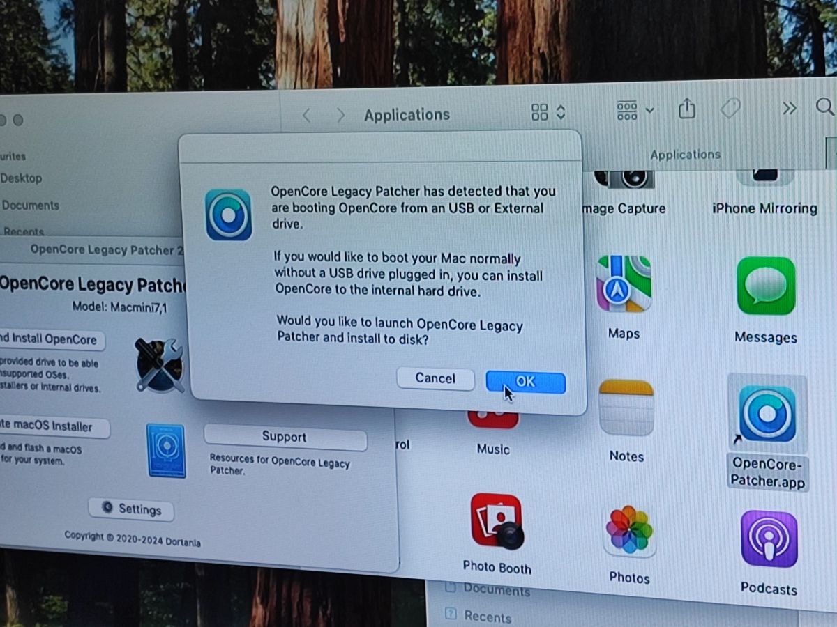

    The patcher itself detects this and proposes it:
    Dialog window for installing OpenCore Legacy Patcher on a Mac. .
    As before - install to disk:
    Mac screen displaying OpenCore Legacy Patcher applications. .

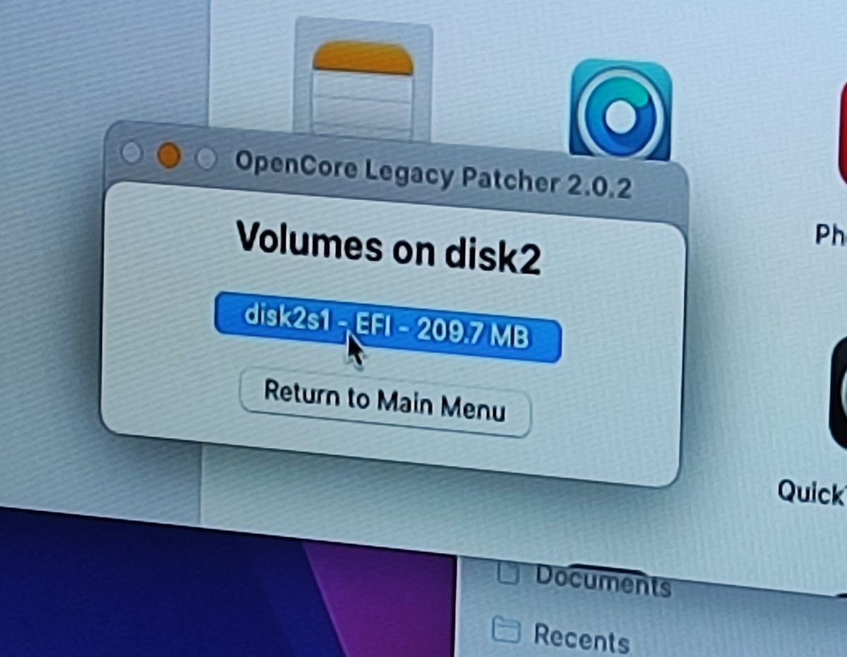

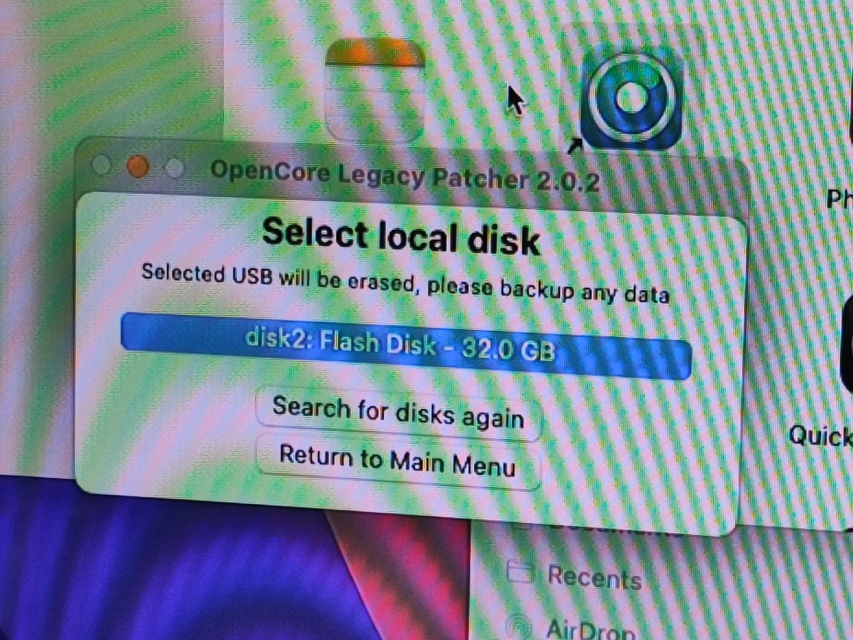

    First partition, but this time with SSD:
    MacBook screen displaying OpenCore Legacy Patcher 2.0.2 software. Screen of OpenCore Legacy Patcher installation on a Mac. .

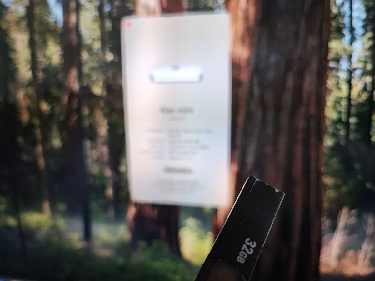

    You can now boot without a flash drive:
    32GB USB drive in front of a computer screen with a blurred forest background. .
    This way the latest macOS (at the time of writing this topic) works correctly on my 2014 Mini.

    zabson229
    Hi there, I felt that creating a flash drive with inastalator also took more than 30 minutes.

    I don't use Aidrop, I'll check with myself @domlux , you can also ask at the source (on Github OpenCore LEgacy Patcher)
    @zabson229 it took a long time, probably 30 minutes or more, in places I thought it had already died, but patience pays off. Although... at the moment I can no longer remember specifically which stage took how much, it was certainly long.

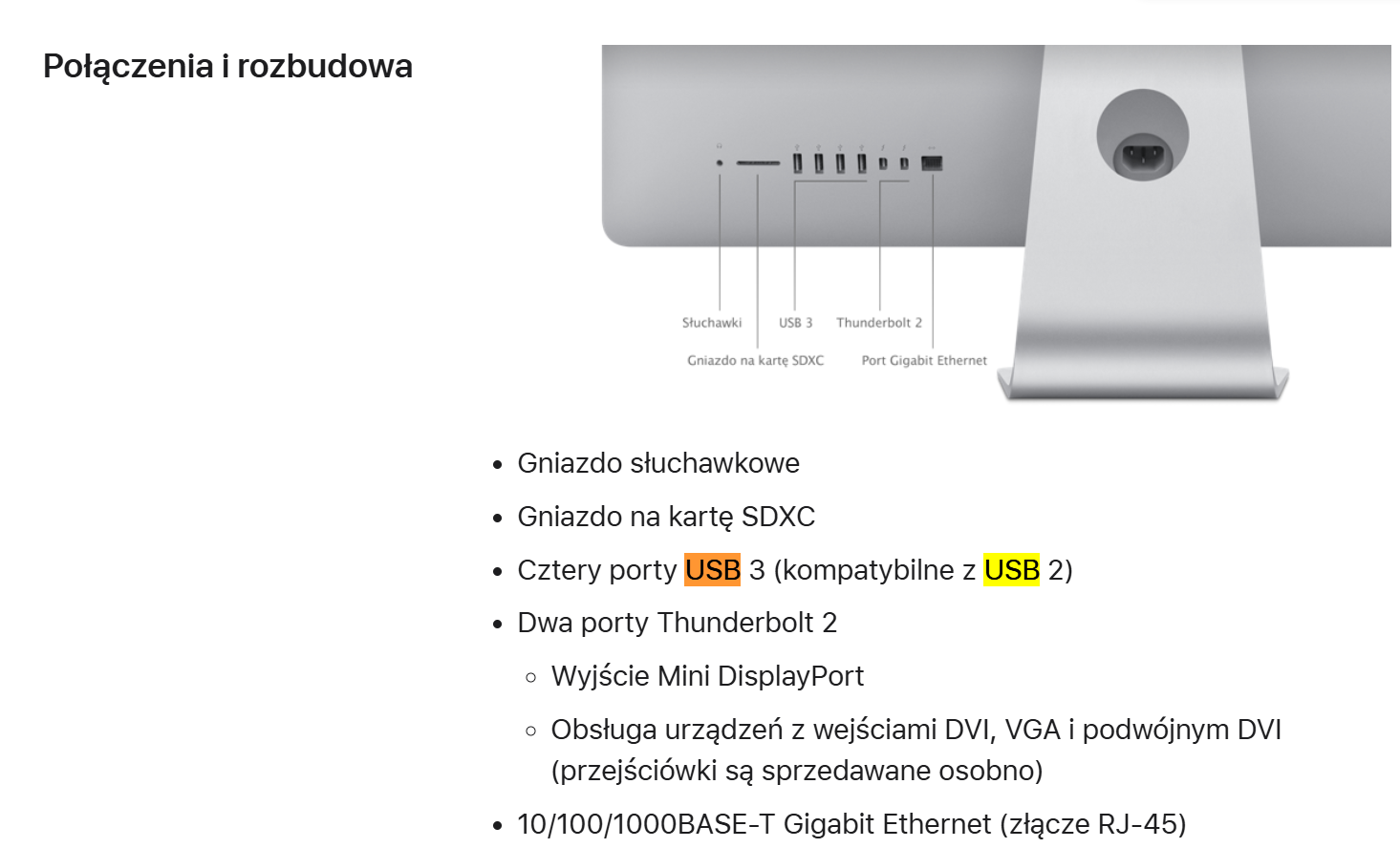

  • #23 21384917
    Posts: 14465
    Help: 650
    Rate: 12478
    wetter1966 wrote:
    but I don't have a usb
    how do i do it to install sequoia without usb just on the internal drive
    Don't you have a USB port or don't you have a flash drive? A flash drive is not expensive... On disk I haven't tried, you'd have to see if it makes a difference.
    PS: Please work on your spelling, because it's hard to read and then it makes people less willing to help you....

    OK, then you have a flash drive, so if you follow the instructions from the topic (either from the OpenCore Legacy Patcher documentation or from Youtube), at which stage is the problem?
    Have you successfully downloaded OpenCore? Have you successfully uploaded it to the flash drive? And then boot the system from the flash drive?
    PS: or maybe the issue is that the mac 27cali retina 5k year 2014 does not have USB slots? Not likely, according to the internet it does:
    Rear view of ports on the iMac 27-inch Retina 5K from 2014. .
  • #26 21384961
    wetter1966
    Posts: 37
    so far there is a creating installer mac os Sequoia
    Computer screen displaying OpenCore Legacy Patcher 2.2.0 with a message about creating a macOS Sequoia installer. .
    Added after 4 [minutes]:
    what to do next
    step by step
    I am a woman and I have never done anything like this before.
    what about when he's done?
    but great thanks for speaking up
    Mac computer screen displaying the OpenCore Legacy Patcher window creating a macOS Sequoia installer.

    where should i write down what he chose
    disc ADATA SU650
    or disc 2 flash disc????
  • #29 21385017
    Posts: 14465
    Help: 650
    Rate: 12478
    I hope you are following the instructions in the first post step by step? If you follow the pictures and description you should be ok.
    Booting is simplifying booting, you have in the body of the first post it says you then have to press Control.
    If you are unsure of the terms you can also try looking up descriptions on the internet/Google, there is plenty of material about this on the net.
    ADATA SU650 disc
    So you are at this stage from the instructions?
    Screens displaying OpenCore Legacy Patcher settings with macOS installer and USB drive selection. .
    If yes then flash disk, that's your memory stick. Just remember - this will erase the data on the flash drive, so as if there's anything important on there, back it up first or get another flash drive.
    The images on the forum can be enlarged, then you can see more, also you can see what I chose.

    I didn't manage to squeeze in sequoia and imac
    iMac screen with Apple logo on dark background. stands still with apple
    side what now???
    Added after 3 [hours] 54 [minutes]: .
    failed to install why I don't know
