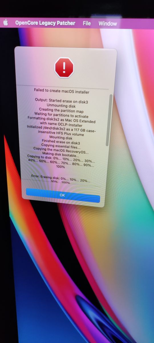

    what is the reason for what I have to do
    can i just press and not hold and when exactly????

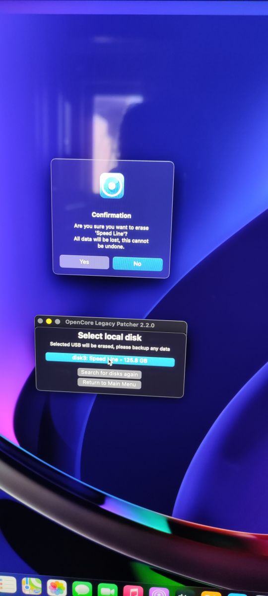

    Added after 31 [minutes]:
    cofirmation is shown
    when i press yes it removes the USA
    when I press no it has no effect
    Computer screen with data deletion confirmation on USB.

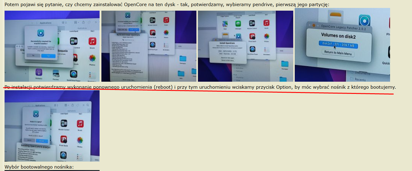

  • #35 21386552
    Posts: 14465
    Help: 650
    Rate: 12478
    Unfortunately, I am not from Germany.

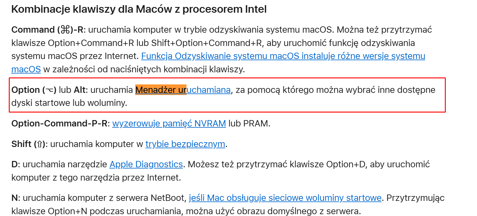

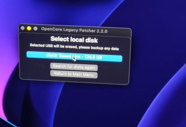

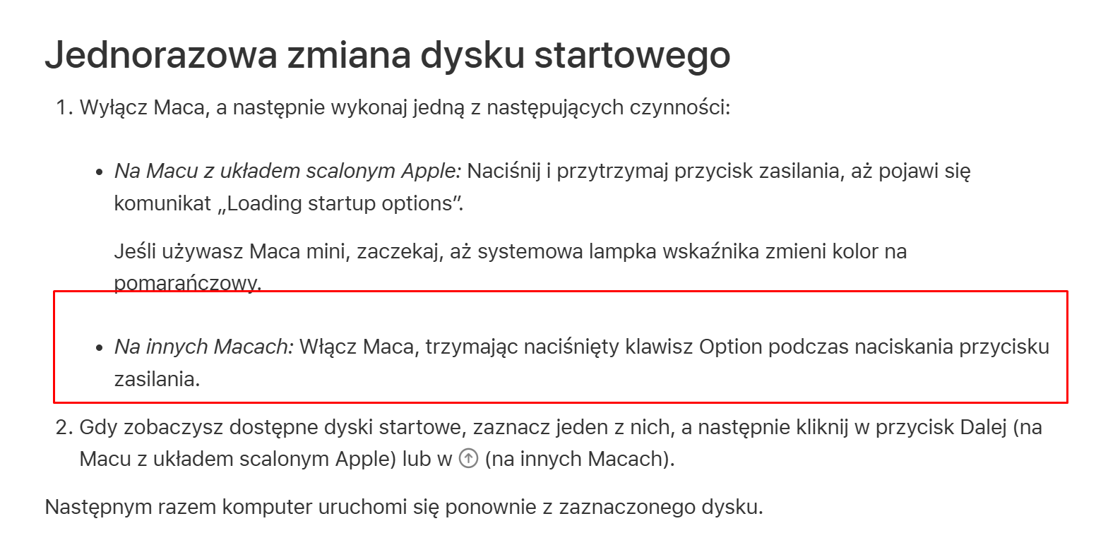

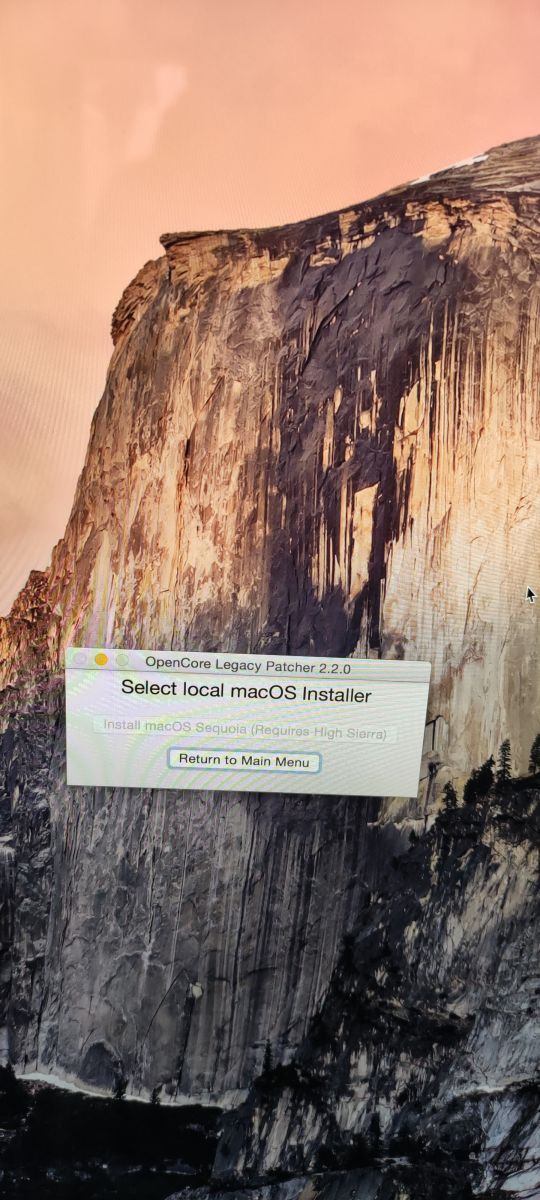

    This photo:
    OpenCore Legacy Patcher 2.2.0 program window with local disk selection. .
    It looks as if you want to upload the OpenCore Legacy patcher to the USB again, even though it only shows some 120GB media there - better not to move it, or you'll delete your files.
    If you have already uploaded the OpenCore Legacy Patcher to the USB stick, do not upload it again to the USB stick. You now need to switch off the computer completely with the USB stick plugged in at all times, then press Option on startup, or check here:
    https://support.apple.com/pl-pl/102603
    Screenshot from this page for your convenience:
    Screenshot of instructions for key combinations for Macs with Intel processors. .
    Here you have a more detailed description of this process of entering the boot disk selection:
    https://support.apple.com/pl-pl/guide/mac-help/mchlp1034/mac
    Instructions for a one-time change of the startup disk on a Mac with detailed steps for different models.
    PS: As you are doing this process for the first time, I'll remind you again - if you have any important documents on your computer, copy them somewhere to keep them safe, e.g. to a PERSONAL memory stick, to the cloud, to email, etc., before experimenting further.

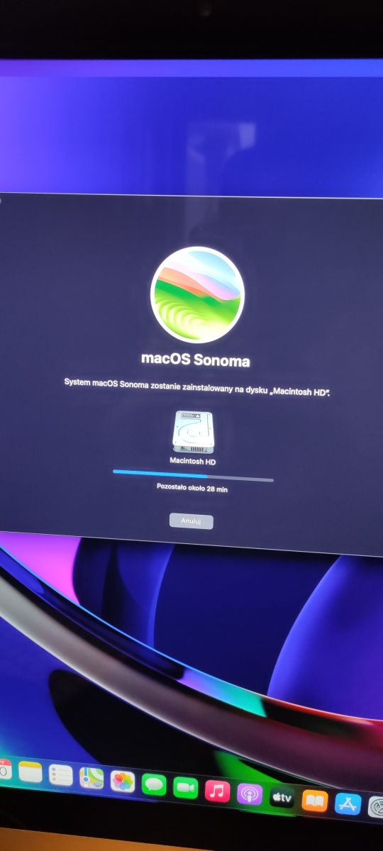

    why didn't you say that the new axle could be in FINDER
    Screen of macOS Sonoma installation on Macintosh HD. .

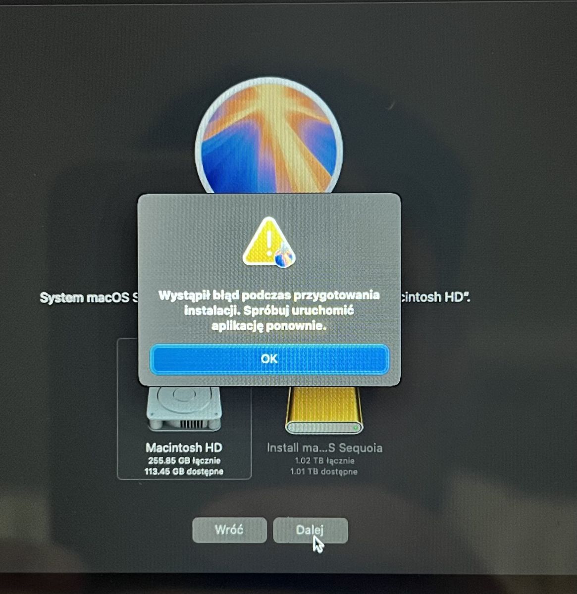

    I have a Macbook Pro 15 inch from late 2013. I wanted to upgrade the system from Big Sur 11 to Monterrey 12. (I only have a 16 GB flash drive).
    I did everything as you described but in the end I can't write the boot data to the hard drive. After rebooting and pressing option only the hard drive is shown and not the efi partition. I have to reboot the Macbook each time with the pendrive inserted. Please help.
  • #44 21547543
    kupiecpl
    Posts: 74
    Rate: 13
    >>21538115 >>21538115 Problem solved, I installed Clover Configurator which allows you to mount EFI partitions and then edit them with Finder. From the ssd disk0s1 partition I deleted all directories (with files) and from the usb disk0s2 partition I copied everything, i.e. the EFI directory and the SYSTEM directory to the disk0s1 partition. I then ejected the flash drive and rebooted + Alt. The boot to ssd showed up and everything works without the pendrive.
    EFI partitions can also be mounted from a terminal but then they are read only, nothing can be written.

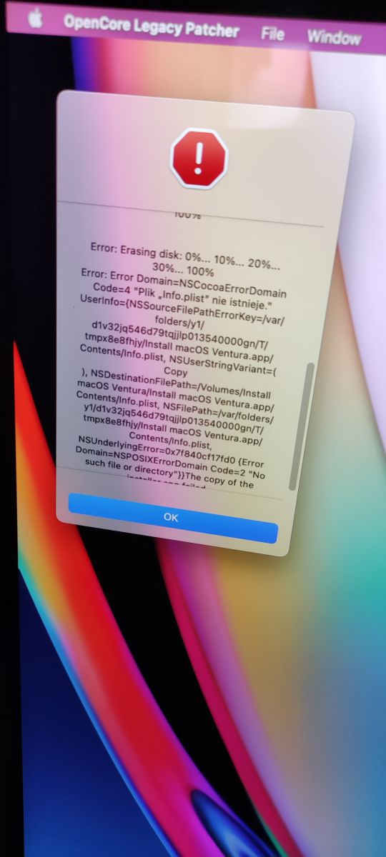

    Error message during macOS Ventura installation using OpenCore Legacy Patcher on a colorful background. Good morning
    Please help
    I can not download os Ventura on imac 27 inch 2014
    Man installed oclp
    Pen drive 120 GB
    I keep getting a message in English
    Error message on a computer screen during an attempt to create a macOS installer using OpenCore Legacy Patcher.
    What should I do please tell me step by step or I will call you ONLY I do not know YOUR NUMBER

    If I were you, I wouldn't use that 120GB usb but some new, smaller one. Ventura will probably fit on a 16GB usb. Format this usb to FAT and then start the installation again.

  • #60 21693182
    Mechanik2019
    Posts: 21
    How do I install the latest macOS on an old computer, laptop? OpenCore Legacy Patcher .
    Colleagues please help.
    I am stuck on an error as above.
