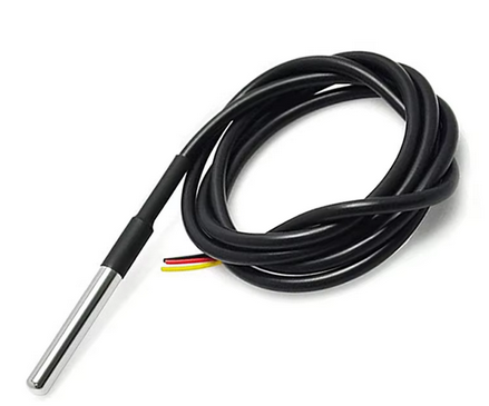

    sx642005elektroda
    Posts: 6
    DS18B20 temperature sensor with three wires.
    I use this DS18B20 on this image "OpenBK7231N_1.17.780.rbl".
    I tested these 2 sensors on tasmota which detects the 2 together. As the platform I will use has a BK731N chip, OpenBeken is the solution for my need.
    I changed the value several times (0 then 1 then 2) in the channel field associated with the DS1820_IO module, but it had no effect.

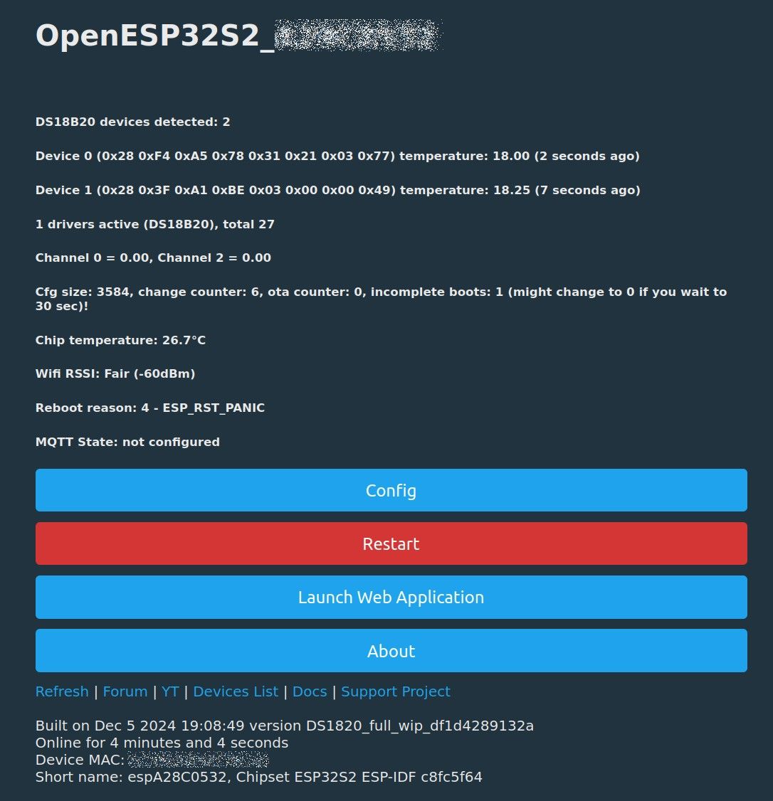

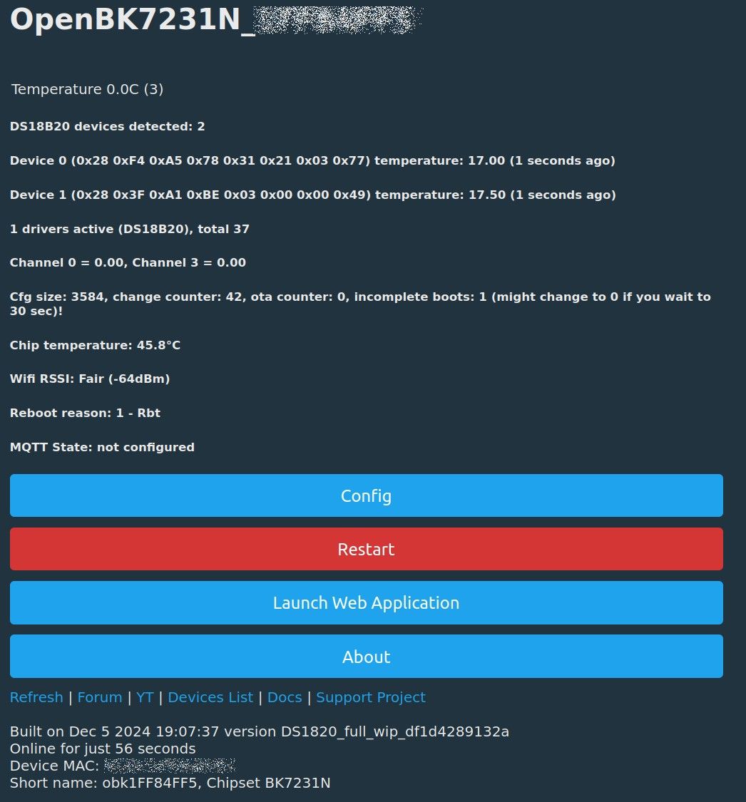

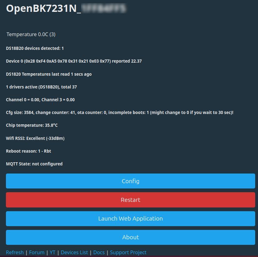

    O.k., as I'm busy today, please find my first try for BK7231N attached.
    Define pin like other driver - or keep definition, if already done ;-)
    startDriver DS18B20 [<seconds between reading of sensor>]
    Screenshot of OpenBK7231N interface displaying temperatures and sensor statuses.
    • dev_20241203_072219.zip (9.91 MB) You must be logged in to download this attachment.

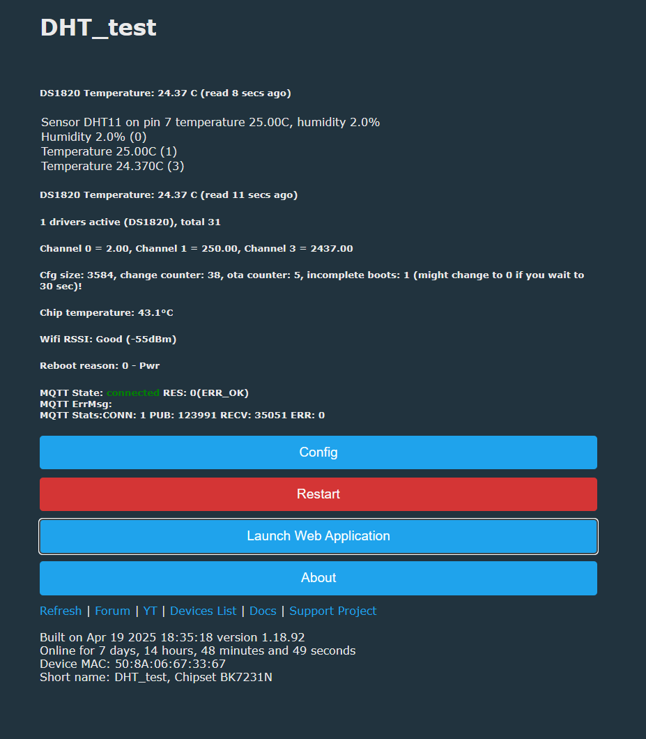

  • #42 21351856
    hojnikb
    Posts: 45
    I'm trying to get this sensor working in home assistant. I've set up the pin and channel and started the driver; the device is shown at the first page and shows values correctly.
    But I can't seem to be able to get that value to publish to homeassistant.
    Any ideas what to configure? I've set the DS1820 to channel 1
  • #43 21351979
    Posts: 14632
    Help: 655
    Rate: 12647
    Set channel type to Temperature.
  • #44 21356295
    romvya
    He publishes the temperature to MQTT as soon as it changes by 0.06 degrees, but it changes with every measurement on the DS18B20 sensor. How can I set it up so the temperature is sent once every 5 minutes or when it changes by 0.2 degrees? (Learning C is easier than OpenBeken.)
  • #45 21356384
    max4elektroda
    Posts: 756
    Help: 48
    Rate: 187
    Usually that's intended to have the actual temperature, for "no message" can mean "no change in temperature" or "the device/sensor doesn't report any temperature" (might be dead).
    But I can check if/how it would be possible to change the behavior by either sending updates only every X seconds, regardless if it changed or not or introduce a minimum change needed to trigger an update (which might lead to the problems mentioned above)
    Added after 5 [minutes]:
    Btw, thinking it over again: it should be possible even now to change the interval of updates:
    Calling the driver with an additional value is possible.
    So if you start it with
    startDriver DS1820 300
    should trigger a reading of the sensor every 5 minutes and hence the updates should follow the readings.
