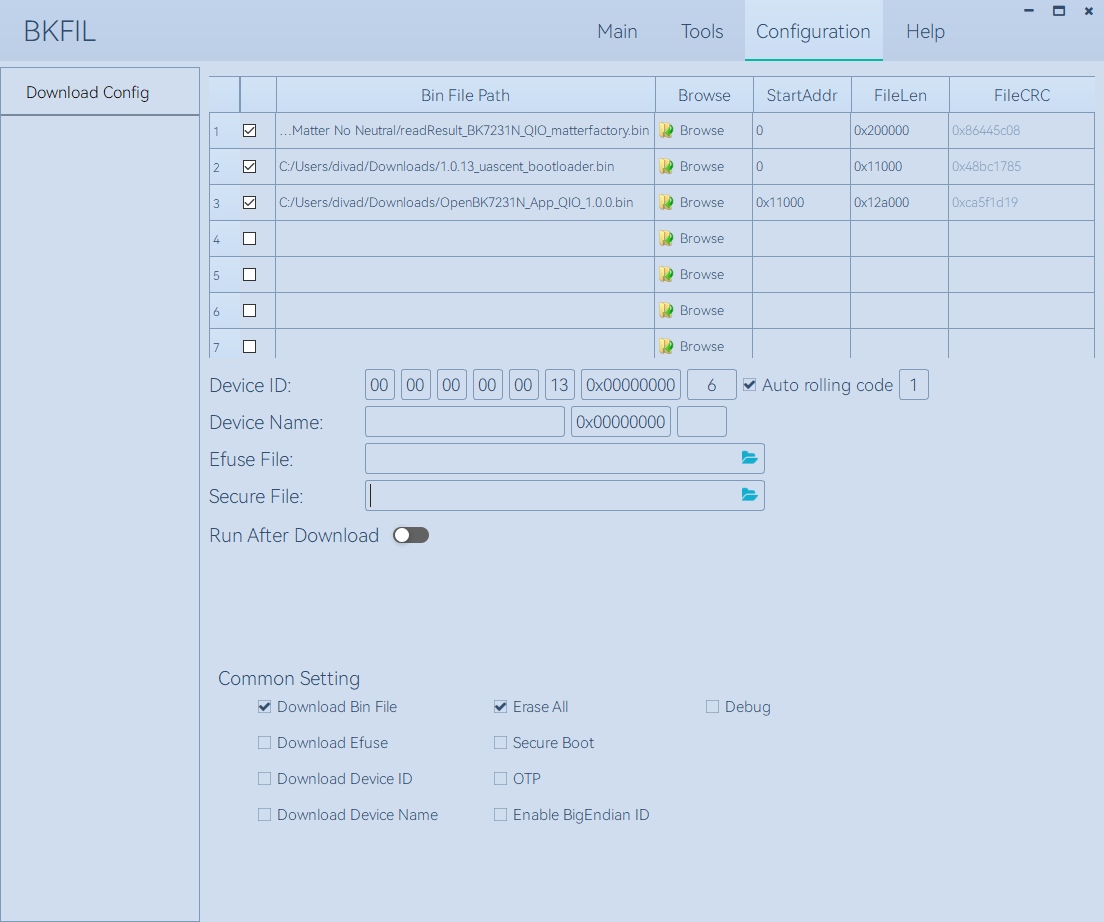

    I came across this 'new' official Beken flasher a couple of weeks ago but have only just started playing with it in earnest. I've only experimented with my Uascent uHome Matter CB3S BK7231N device so far, which for other reasons isn't working with OpenBeken UPDATE, but the actual writing process seems to work.
    The site isn't always online so I attach the program download, in which there's also a nice English user guide.
    https://docs.bekencorp.com/arminodoc/bk_idk/b...config_tools/bk_tool_bkfil.html#bk-tool-bkfil
    https://dl.bekencorp.com/tools/flash/

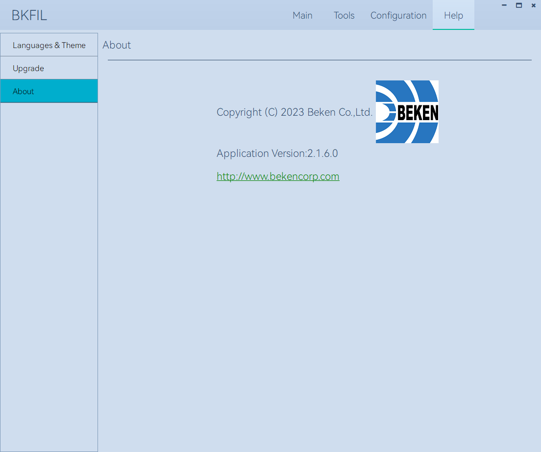

    Pics of the main program
    Screenshot of the BKFIL program showing BIN file paths and messages in the Status section.
    Screenshot of the BKFIL program with flash configuration settings. Screenshot of the BKFIL program displaying version information.
    One nice feature is the ability to queue up multiple files for flashing, each with their own starting addresses.

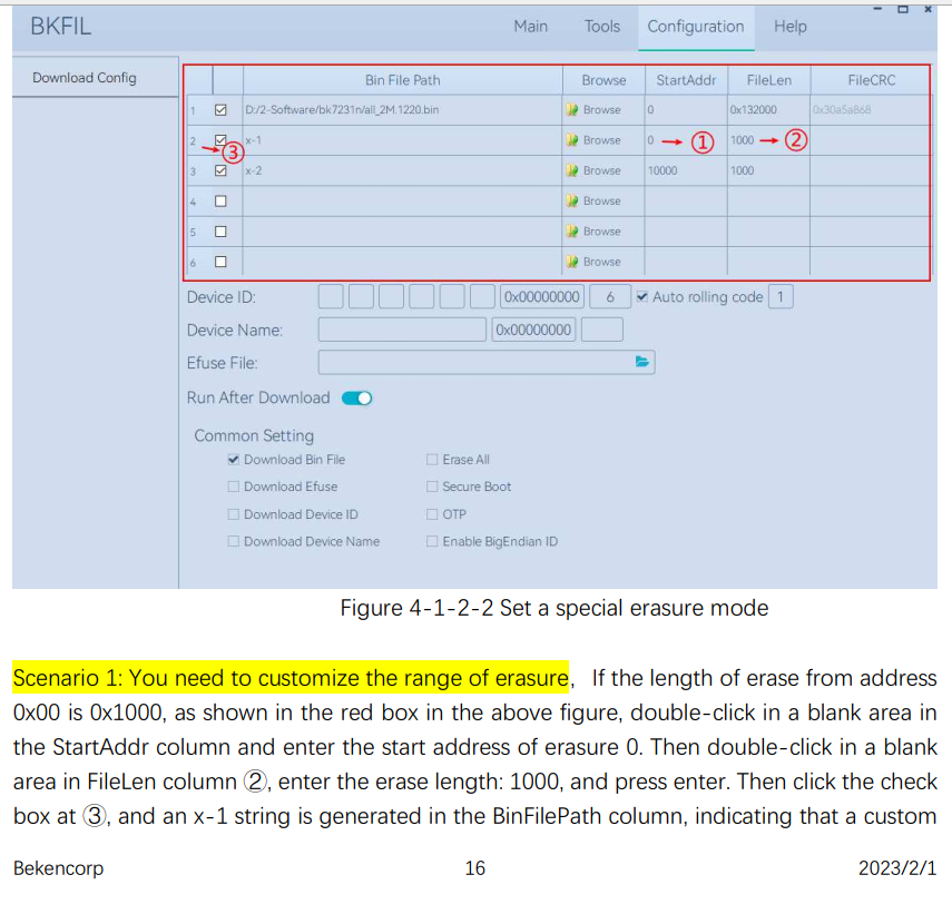

    Also cool is that you can specify specific ranges for erasure
    Screenshot of the BKFIL program showing the configuration of the erasure range.

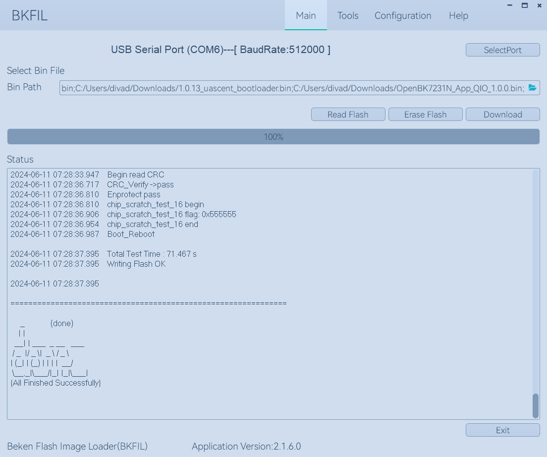

    I did think this log output was interesting
    I don't know if this is a compliment to BK Writer or a replacement of it aimed at more recent chips.

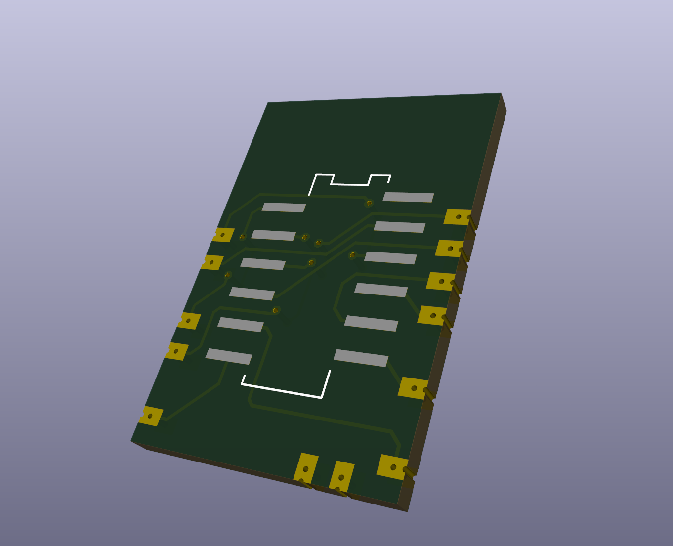

    Finally some time found for the CB2S/WB2S adapter!
    3D model of CB2S/WB2S adapter showing traces and solder points.
    Have to finalize the gerber files and send them for production, castelation will be somewhat of an issue but it will be ok for the first try.

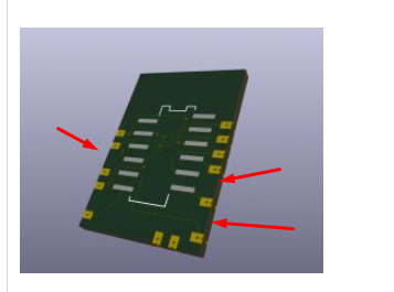

    Would it be possible to utilize empty space for pads?
    Green PCB with red arrows indicating empty spaces potentially for pads.
    For example, also add pads there, and maybe allow for tiny jumpers or something,,, but again, maybe there is not enough spaec

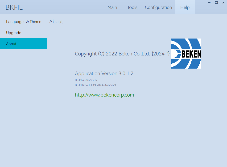

    BKFIL v3.0.1.2 released - https://dl.bekencorp.com/tools
    Screenshot of a table showing the release of BKFIL v3.0.1.1 with a date and feature description.
    Information about BKFIL application version 3.0.1.2 with a sidebar and Beken logo.

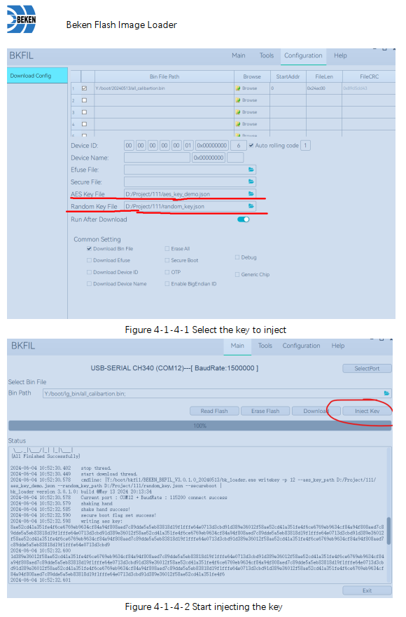

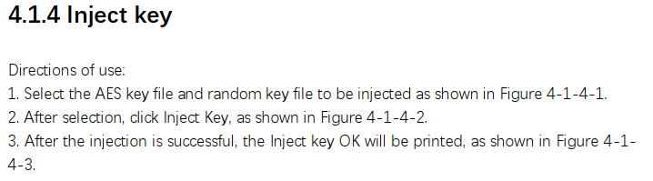

    Instructions for injecting AES key
    Screenshots of the Beken Flash Image Loader interface highlighting the options to select AES key file and random key file, and the key injection button.

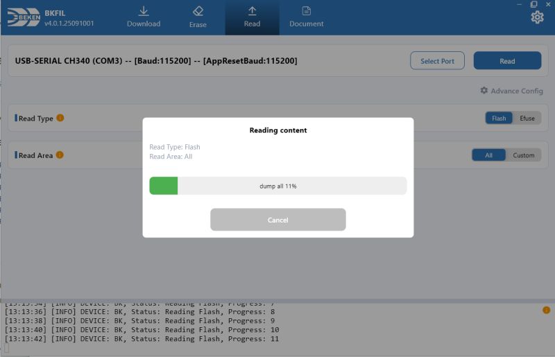

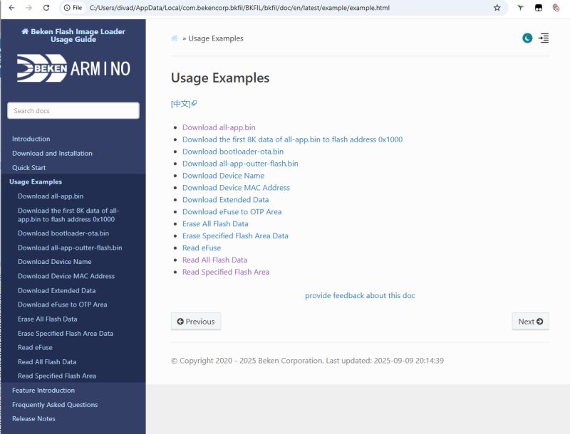

    refreshed BKFIL v4 beta GUI/CLI Linux/Windows/Mac https://dl.bekencorp.com/tools/bkfil/v4

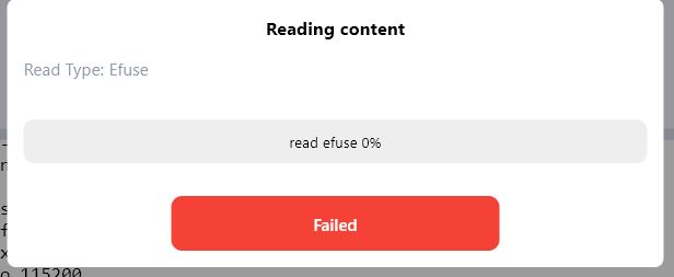

    NiceMCU BK7238:
    BKFIL software reading flash memory with 11% progress displayed
    Error message: efuse reading failed, progress bar at 0%
    Screenshot of Beken Flash Image Loader documentation showing usage examples section.
