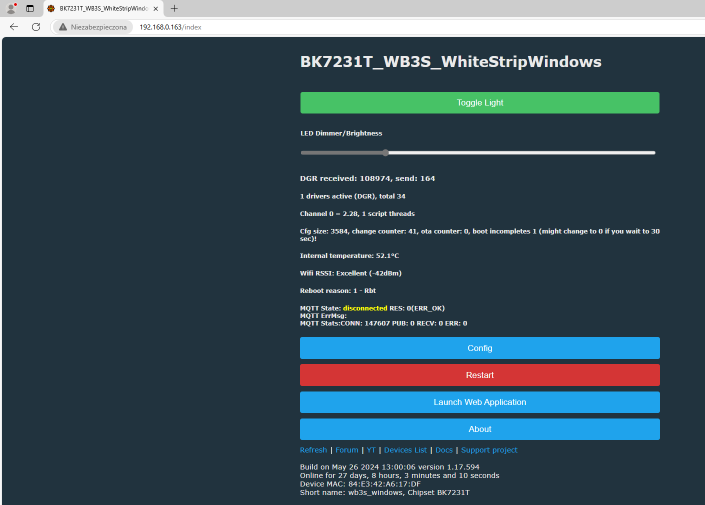

    Hm, are you able to access the device web page through a browser? You just need to connect to the device IP and it should load correctly...
    For example:
    User interface of a web application for the BK7231T device.
    How does it look for you? Or are you referring to some other issue with the page loading?

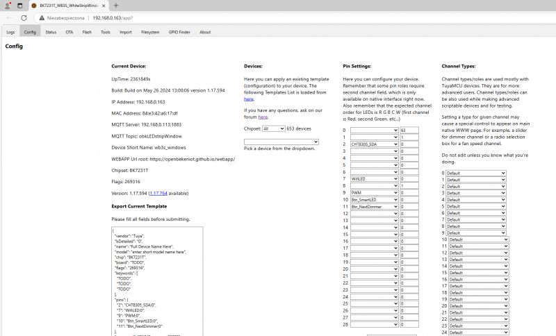

    Or maybe... do you mean the Web Application, specifically? This page:
    Web configuration interface of a device with IP address 192.168.0.163.
    Well, Web App is an addon that is fetched from Github, so you need to have Internet Access in order for the Web App to work. Alternatively, you can host web app yourself in your local area network, for example by using Home Assistant for that. https://www.elektroda.com/rtvforum/topic3995065.html
    The simplest way to get this working is to just to enter your WiFi information first, so OBK can pair with your local WiFi, and then access it via WiFi, when it's in WiFi client mode (not via OBK custom Access Point with default IP 192.168.4.1).
