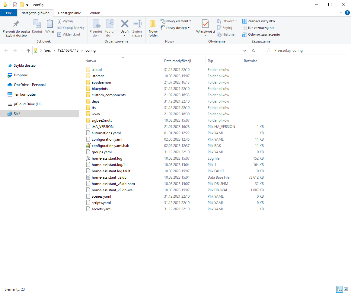

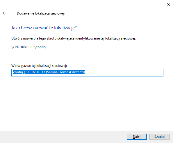

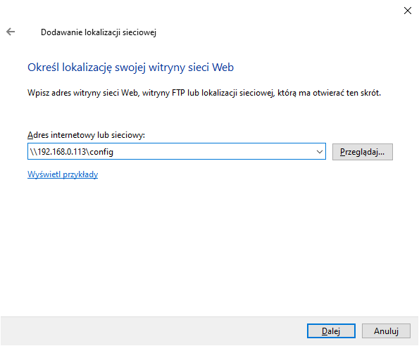

    Some convenient access to it will be useful, I mapped the config folder via SMB:
    Window for adding network location in Windows
    Network location addition dialog with Home Assistant configuration.
    This allows you to conveniently operate on the Assistant's files:
    View of the Home Assistant configuration folder with its contents.

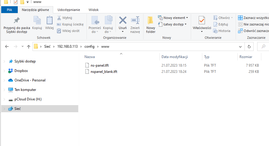

    We upload the files we want to host to config/www :
    Screenshot of a Windows folder with TFT files.
    For me, there are ripples for the Sonoff panel, which I will describe soon.
    You can get to them from a web address like:
    http://192.168.0.113:8123/local/ns-panel.tft
    The subdirectory is very important local We can't get to them without him!

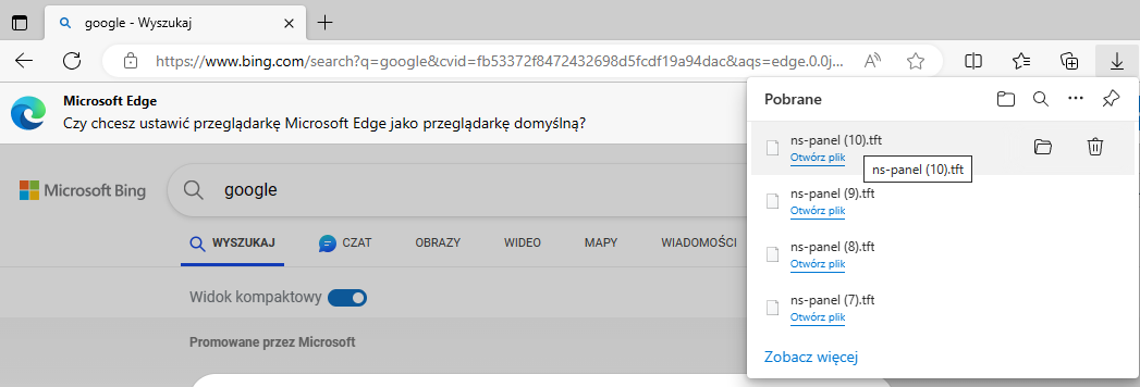

    Just opening this URL will download the file - without logging in:
    Screenshot of Microsoft Edge browser with the Downloads pane open, showing the file ns-panel (10).tft.
    And it is this URL that can be given to devices that need to download our update via HTTP GET...

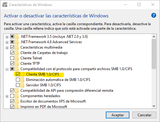

    What I haven't been able to do is connect to that folder from my Windows 11 PC. I've enabled SMB1 but I don't know if that's enough
    Windows features window with SMB 1.0/CIFS client enabled.

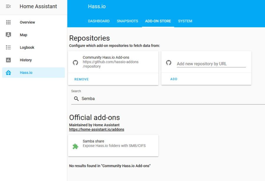

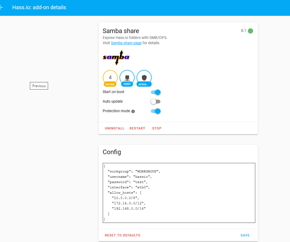

    I do not remember well but I check this and it seems that you need to first install SMB Samba Share addon for HA. I think I did that, but it was a year ago or so...
    Screenshot of the Add-on Store tab in Home Assistant with the Samba Share add-on selected. Samba Share add-on configuration panel in Hass.io.
    Please try and let me know how it works.

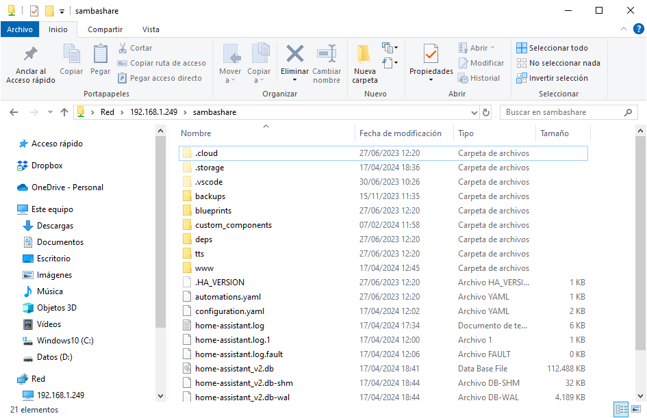

    I'm afraid I can't access the add-on store because of my docker-compose install of HA... I remember I read some (most) of the add-ons also have a docker version, but I still haven't found this one.
    What seems to work for me is this tutorial. Setting "path = /home/morgan/domotica/ha/config" (which is the config directory defined for HA in the docker-compose.yml) in /etc/samba/smb.conf lets me access its contents from Windows:
    Screenshot of Windows File Explorer with the sambashare folder open on the network address 192.168.1.249.

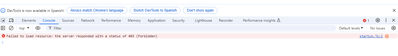

    I tried again after re-reading this thread and related ones but with no luck...
    This is the error I get:
    Screenshot of browser console showing a resource loading error with a status 403 (Forbidden).
    Maybe I have to configure something else on the home assistant side?

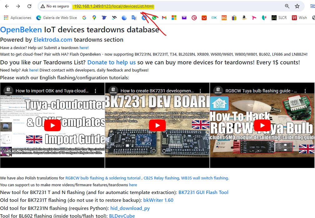

    EDIT: Another test, devicesList.html (also in the downloaded webapp-gh-pages) seems to work OK when accessed from the HA host:
    Screenshot of the OpenBeken IoT database page.

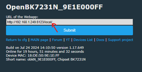

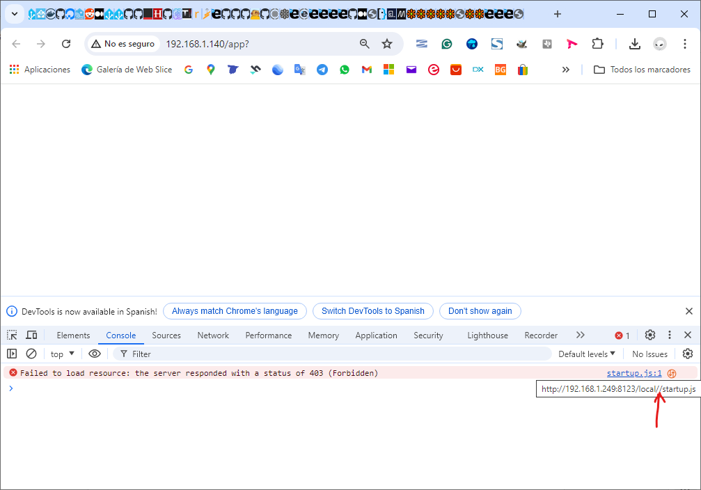

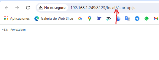

    EDIT2: I may be getting closer to the problem...

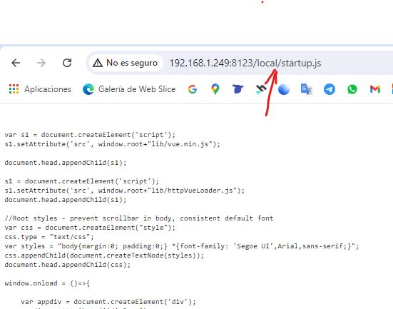

    If I put 192.168.1.249:8123/local/startup.js/ (ended with "/") in webapp config:
    Screenshot of OpenBK7231N interface with a web app URL field.
    I get this error:
    Browser console showing a 403 error when trying to load startup.js from a URL.

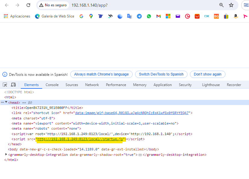

    The path to startup.js includes two bars, and if I open that in another tab it effectively gives the 404 error:
    Browser URL shows a double slash and 403 Forbidden error.

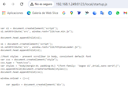

    If I delete one of the bars, the error disappears and the script is listed:
    Screenshot of a browser showing JavaScript code from the URL 192.168.1.249:8123/local/startup.js.
    This is the code I can see with F12 in the browser:
    Screenshot showing the DevTools console highlighting an error in the JavaScript file path.

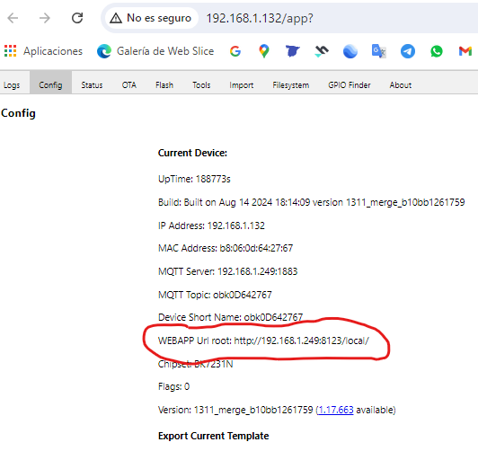

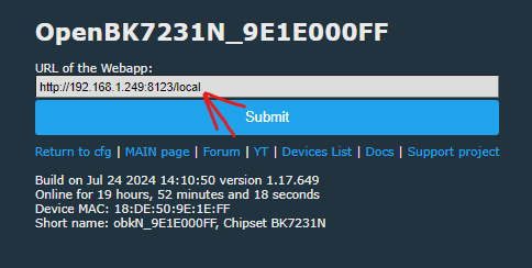

    So, although the examples I've seen indicate that it should be included, I tried removing the last "/" of the path in webapp config:
    Screenshot of the OpenBK7231N device configuration panel with a field for entering the web app URL.

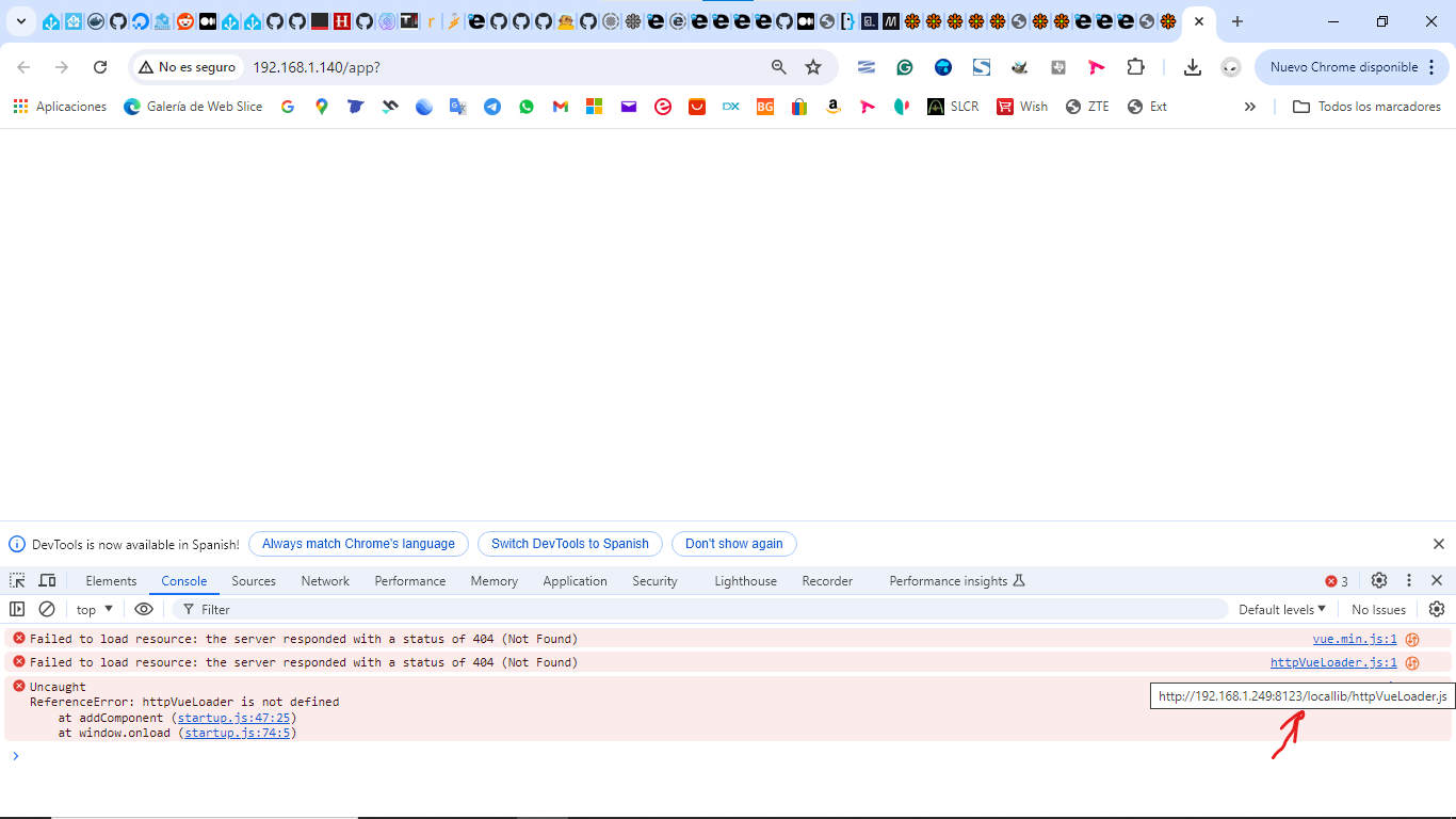

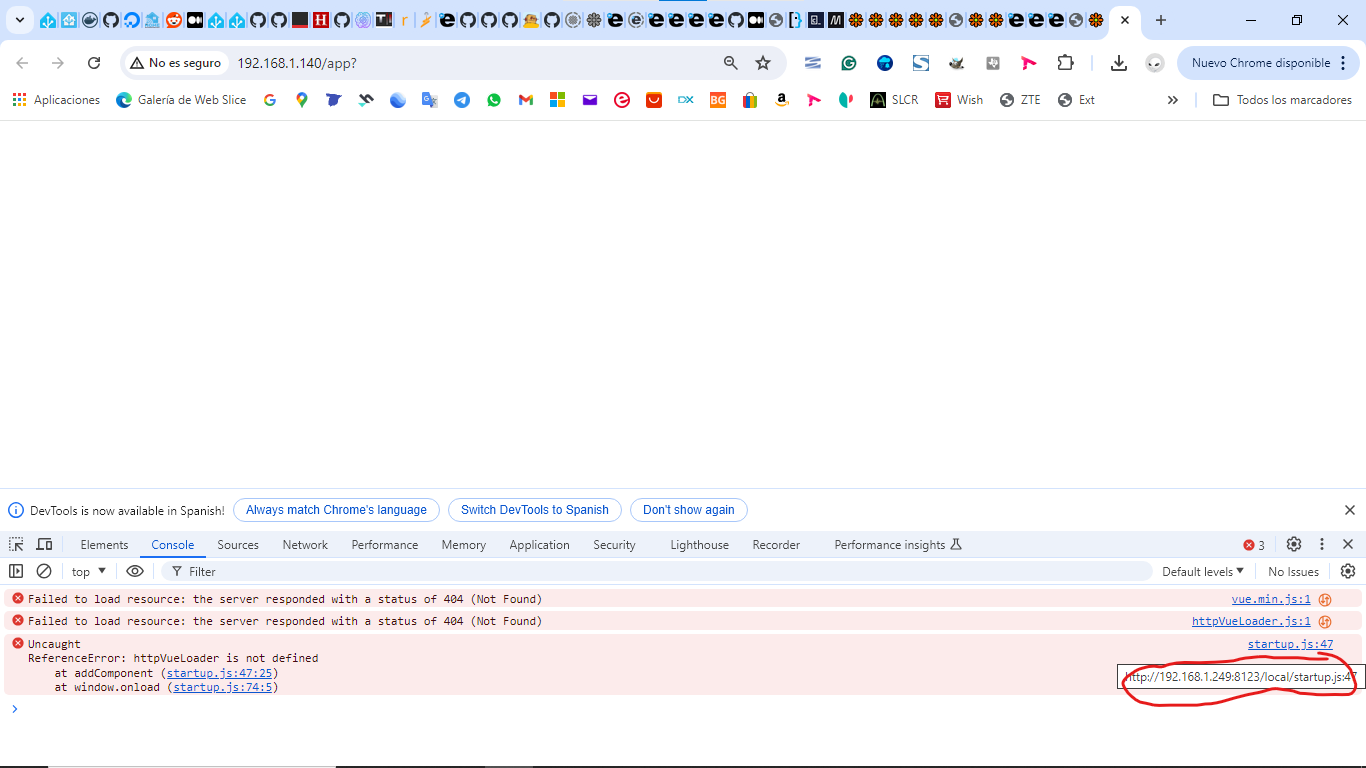

    With this configuration, other errors appear. The link to startup.js is now correct:
    Screenshot of a web browser displaying resource loading errors.
    And if I hit "open in a new tab" in the contextual menu, it opens correctly. But the path to other needed files is now incorrect:
    Browser console with errors related to script resources in an application.

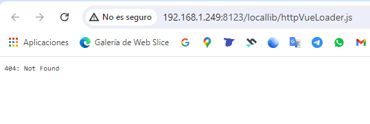

    And hitting "open in a new tab" gives a 404 error:
    404 error page showing URL 192.168.1.249:8123/locallib/httpVueLoader.js
    Maybe I can correct the double "/" problems in one of the .HTML files... Which one is called from OBK, when clicking "Launch web application"?
    EDIT3: I think the problem is due to having "/local/" in the address... I've opened the same www folder in sambashare via visual studio code and opened it with file server and everything goes well with "http://127.0.0.1:5500/" as webapp address

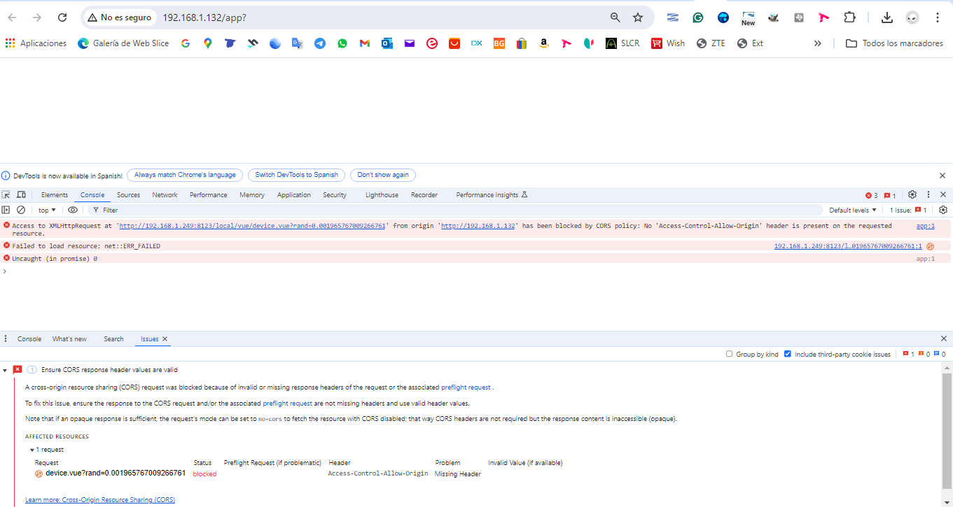

    EDIT 4: I made a slight mod in OBK's source code to avoid that double slash. The web app continues to work OK with the default https://openbekeniot.github.io/webapp/ and also with a local server with "short" URL (e.g. http://192.168.1.249:7231/).
    With Home Assistant's local server (in my case http://192.168.1.249:8123/local/) the former error has disappeared and http://192.168.1.249:8123/local/startup.js is run without the previous 404 error but, unfortunately, a new error has appeared:
    Screenshot of browser console with CORS error.
    I've been searching about "'http://192.168.1.132' has been blocked by CORS policy: No 'Access-Control-Allow-Origin' header is present on the requested resource", but the answers are way beyond my capabilities 🤦‍♂️. Hopefully, somebody here can explain this error and why it doesn't appear with default webapp's URL or the simpler local one.

    Problem solved!
    With a "little help" from ChatGPT.
    I just had to add the following to configuration.yaml in Home Assistant:
    Code: YAML
    Screenshot showing device configuration with details like uptime, IP, and WEBAPP URL.

What causes double-slash URL problems like /local//startup.js when hosting the OpenBeken web app on Home Assistant?
The double slash comes from joining a base URL that already ends with / to a resource path that also starts or assumes /. In the thread, using http://192.168.1.249:8123/local/ caused a request for /local//startup.js, which returned 404. Removing the trailing slash fixed that specific path, although other resource paths then exposed additional problems. One extra / was enough to break the first script request.[#21170646]
Can someone explain why the OpenBeken web app works from https://openbekeniot.github.io/webapp/ or a simple local server, but fails from Home Assistant's /local/ path?
It worked on GitHub Pages and a simple local server because those setups did not trigger the same path-format and CORS issues seen on Home Assistant /local/. The thread shows two separate failures on Home Assistant: first a 404 from /local//startup.js, then a browser CORS block from http://192.168.1.132. Once the path issue was patched and cors_allowed_origins was added, the Home Assistant-hosted version finally worked too.[#21197391]

How can I access the Home Assistant config directory from a Windows 11 PC when Home Assistant is installed with Docker Compose on Ubuntu Server?
Share the Docker-mounted Home Assistant config path through Samba on Ubuntu, then open that share from Windows 11. In the thread, the working path was /home/morgan/domotica/ha/config, which matched the config directory defined in docker-compose.yml. The user could then browse its contents from Windows after editing /etc/samba/smb.conf. That approach avoided relying on Home Assistant add-ons, which were unavailable in that Docker Compose installation.[#21049230]
What is the SMB Samba Share add-on in Home Assistant, and when do I need it instead of configuring Samba directly on Ubuntu?
The SMB Samba Share add-on is the Home Assistant add-on mentioned in the thread for exposing the HA config folder over SMB. You need it when you run a Home Assistant installation that supports the add-on store and you want an HA-managed file share. In the thread, that route was suggested for a VM-style HA setup, but it was unavailable on a Docker Compose install, where direct Samba configuration on Ubuntu became the working alternative.[#21048841]
How do I host the OpenBeken web app from Home Assistant so an OBK device can use a local URL instead of the default GitHub Pages address?
Copy the gh-pages web app files into config/www, then point the OBK device's Web App URL to the Home Assistant-hosted path. In the thread, the intended local URL was http://192.168.1.249:8123/local or /local/, but success required more than copying files. The user had to fix a trailing-slash path issue and then add CORS allowances in Home Assistant before the self-hosted OBK web app worked reliably from the local URL.[#21197391]
