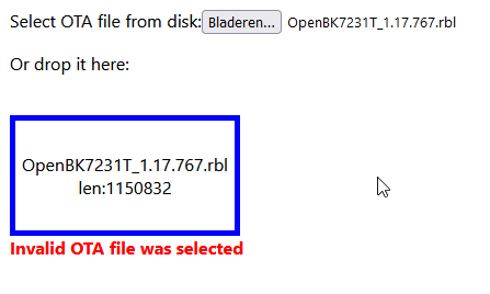

  • #3 21298286
    plekke
    Level 4  
    Posts: 7
    no this also didn't do it
    OTA update interface with file selection error.
    #4 21298290
    insmod
    Posts: 1424
    Help: 164
    Rate: 446
    >>21298286 Is your device a T one? And by the way, your rbl file weights too much (have you just renamed the bin file?). When esphome finishes building - download the Beken OTA file.

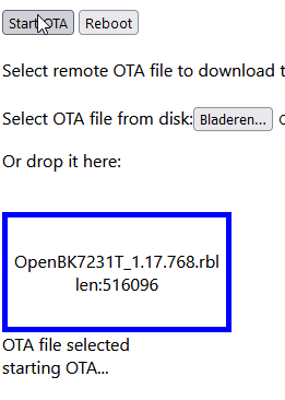

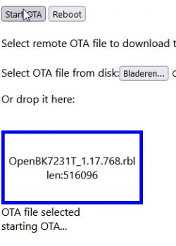

  • #5 21298299
    plekke
    Level 4  
    Posts: 7
    User interface for OTA update with OpenBK7231T file selected for installation.
    renamed and OTA beken worked!! thx mate
