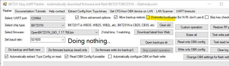

    divadiow wrote:
    It'll be the N variant of the Beken firmware
    User interface of the BK7231 Easy UART Flasher tool for updating firmware.
  • Need confirmation on flashing the N-series Beken firmware
    #9 21293491

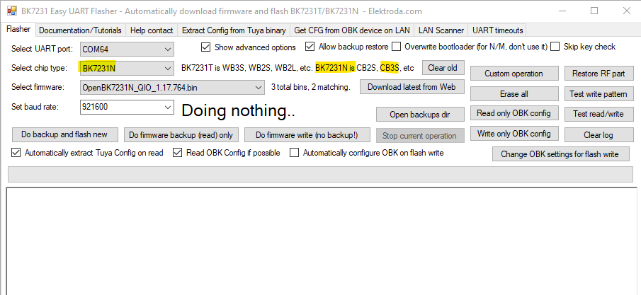

    Your CB3S module will have BK7231N chip on it. Easy Flasher is for Beken N and T chips. Easy Flasher will offer to download the latest firmware for your selected chip if there is not one already downloaded.
    Screenshot of BK7231 Easy UART Flasher program with an open firmware download window.
  • BK7231N chip identified on CB3S module

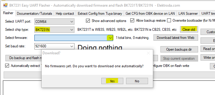

    Ok, sorry wrong reading. I was now looking at espeasy but that isn't working.
    I try again to burn the chip the way you are telling me. I now also have a backup bin. I think it's all burn ok but still no app or any live but the wifi led.
    i attach the backup bin file

    Posts: 5153
    Help: 443
    Rate: 907
    hmm. that backup doesn't even boot so I guess the bootloader was overwritten with something in previous efforts.
    You could use this to write a new one
    Screenshot of the BK7231 Easy UART Flasher program showing flash configuration options for a chip.

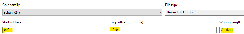

    yes, burn backup from 0x0, no offset and nothing in write length in LT like this
    Screenshot displaying backup settings.
  • #25 21294071
    basdelouw78
    Posts: 13
    Ok, can you tell me how to write from offset 0x0? Where in the settings do I make that change?

How do I flash OpenBeken correctly on a Smartlive DS-121 using Easy Flasher and the BK7231N N variant firmware?
Use Easy Flasher with the BK7231N N variant and let it fetch the latest matching firmware if needed. Do it in 3 steps:
  1. Select the BK7231N chip for the CB3S module.
  2. Let Easy Flasher download the latest firmware if none is present.
  3. Flash OpenBeken normally and then check for the AP or network join. The thread states Easy Flasher supports Beken N and T chips, and CB3S in this switch is BK7231N. [#21293501]

Which firmware should be selected in Easy Flasher for a CB3S module based on the BK7231N chip?
Select the BK7231N, or “N,” firmware variant. The thread explicitly says the CB3S module uses a BK7231N chip and that Easy Flasher supports both Beken N and T families. Choosing the N variant matches the hardware in the Smartlive DS-121 and avoids using the wrong image family. [#21293501]

How can I use a known-working BK7231N Tuya factory firmware from 0x0 to recover a device before reflashing OpenBeken?
Write the full known-working BK7231N Tuya image from address 0x0, then flash OpenBeken again. Do it in 3 steps:
  1. Load the full backup or known-good factory .bin.
  2. Set the write start to 0x0 with no offset.
  3. After recovery boots, use Easy Flasher for OpenBeken. The thread recommended this because the original factory backup was missing and the module needed a clean full image first. [#21293822]
Where in ltchiptool do I set the write offset to 0x0 and leave write length empty when restoring a full backup bin?
Set the restore to start at 0x0, leave write length blank, and do not add any offset. The thread’s final instruction was explicit: “burn backup from 0x0, no offset and nothing in write length in LT.” That is the exact restore setup the responder recommended for recovering the BK7231N image state. [#21294069]
