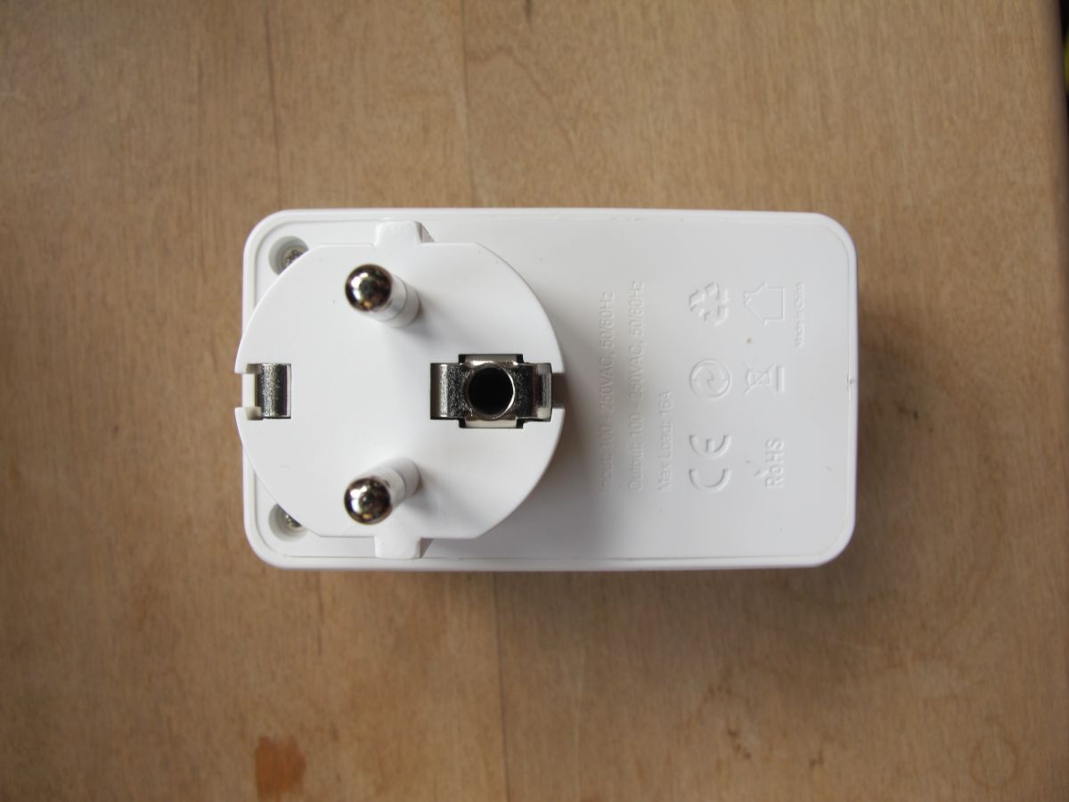

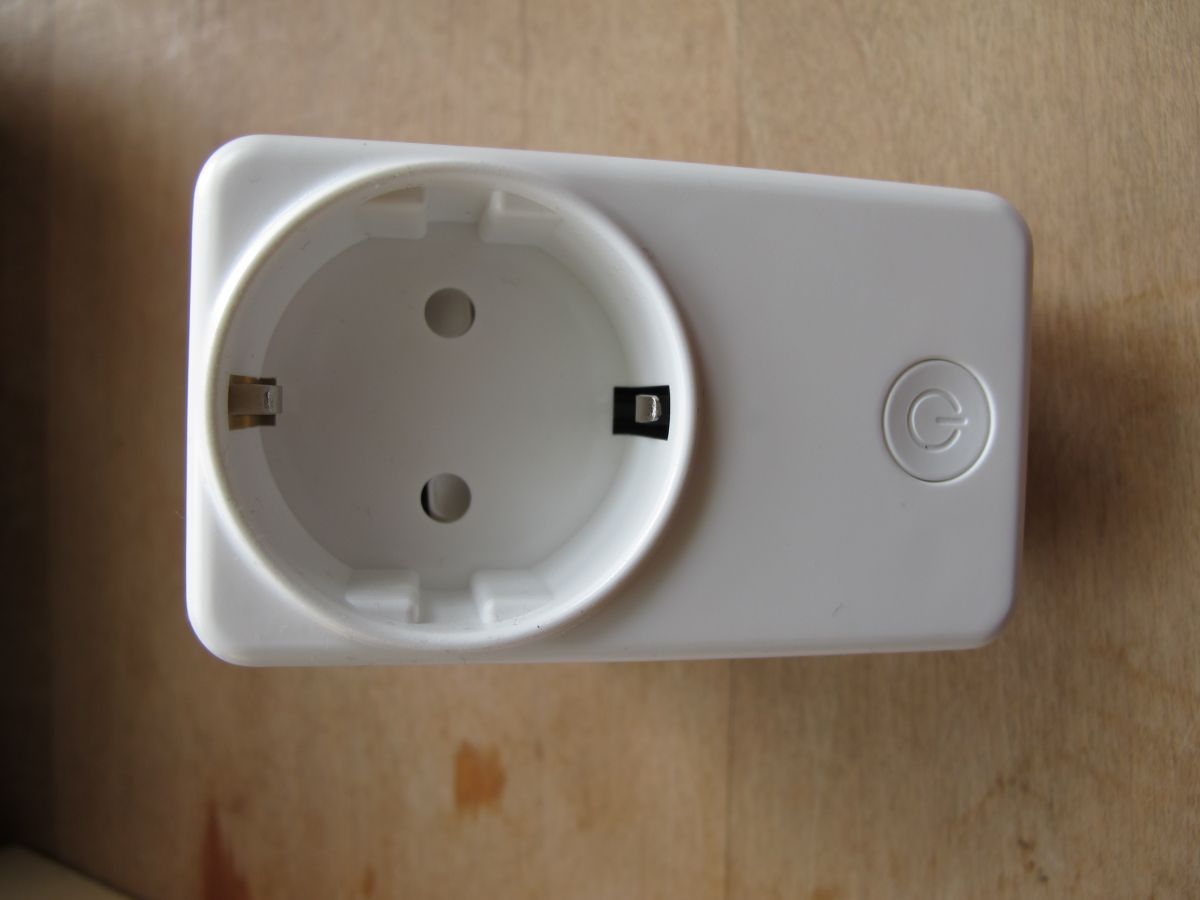

    First we'll look at the product, then open it up, take it apart and solder the relevant parts up for flashing to OpenBeken, an open source Tuya replacement firmware. This conversion will cut the device off from any cloud servers for total control locally with or without HomeAssistant (and other IoT control platforms) integration.

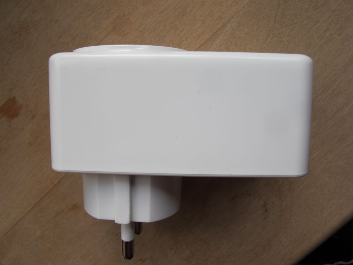

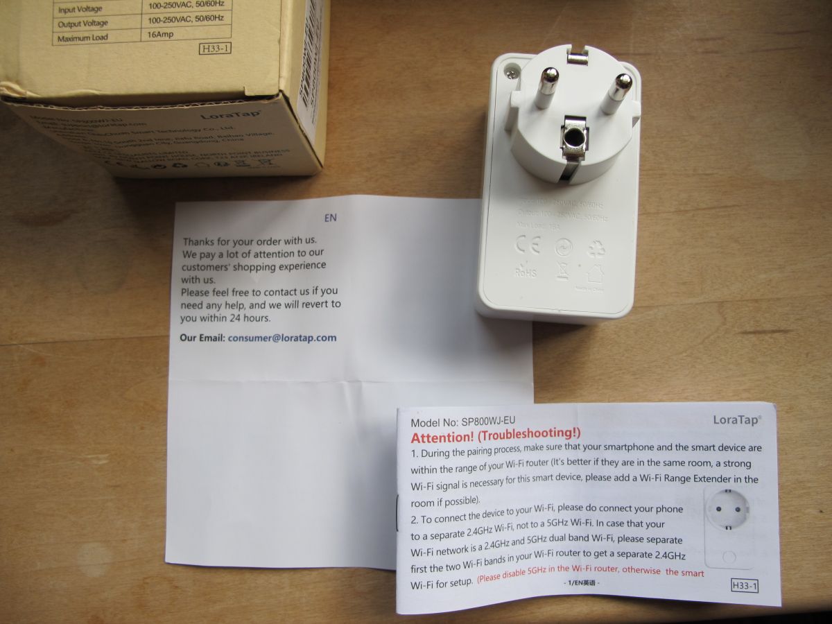

    Packaging, box content, external product pictures:
    Packaging of LoraTap SP800WJ-EU smart plug Box with technical specifications of a WiFi smart plug.A cardboard box with a label containing details of Apex CE Specialists GmbH.Packaging of LoraTap plug model SP800WJ-EUCardboard box with the label of the LoraTap SP800WJ-EU product.White LoraTap EU smart WiFi plug side view.Close-up of the LoraTap SP800WJ-EU smart plug with a power button.Back of LoraTap smart plug with voltage and certification informationTop view of the European smart plug LoraTap SP800WJ-EU.LoraTap SP800WJ-EU smart WiFi plug with leaflets.

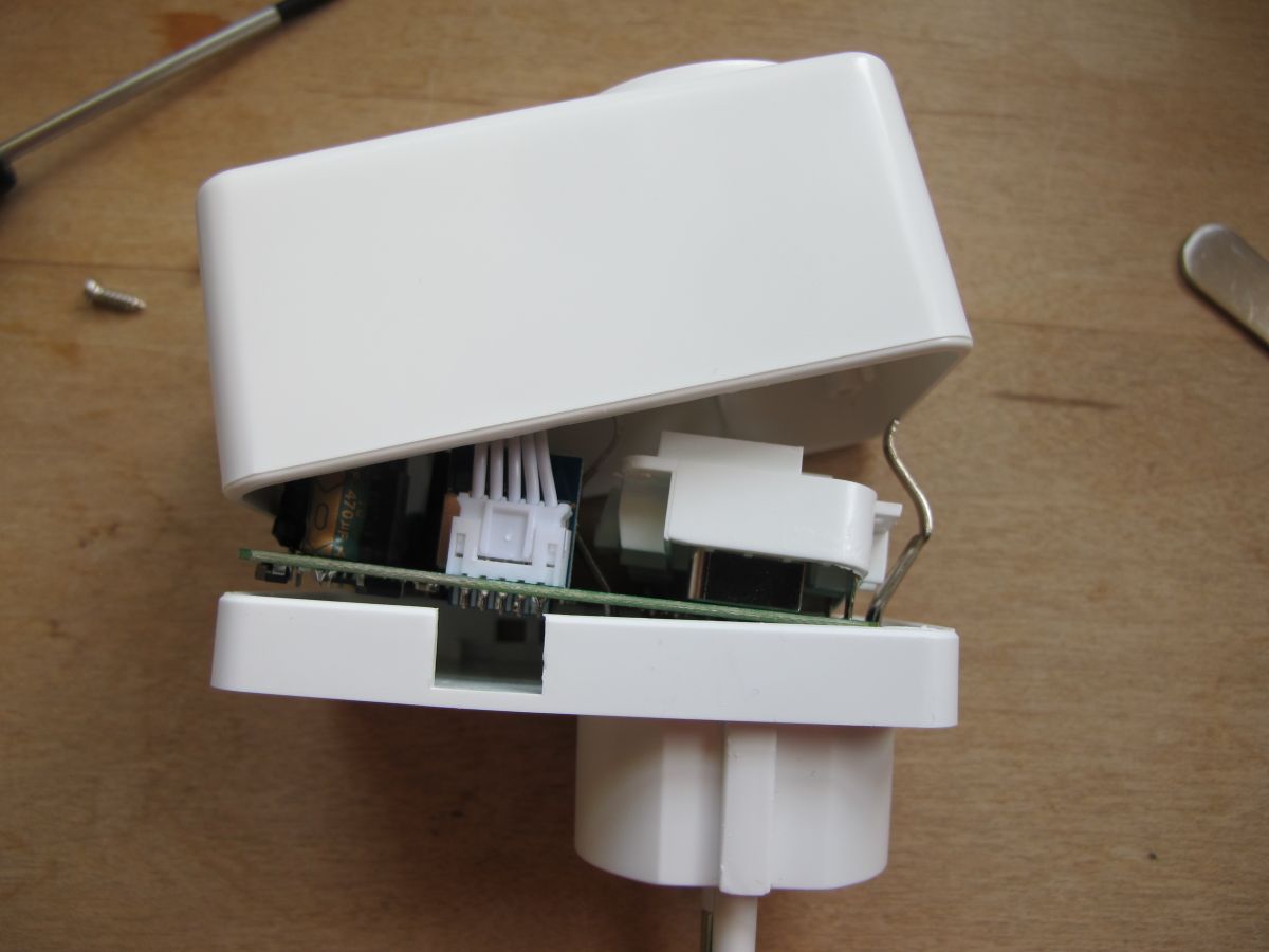

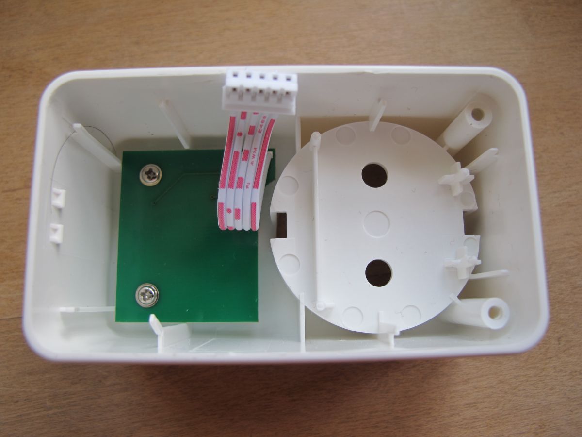

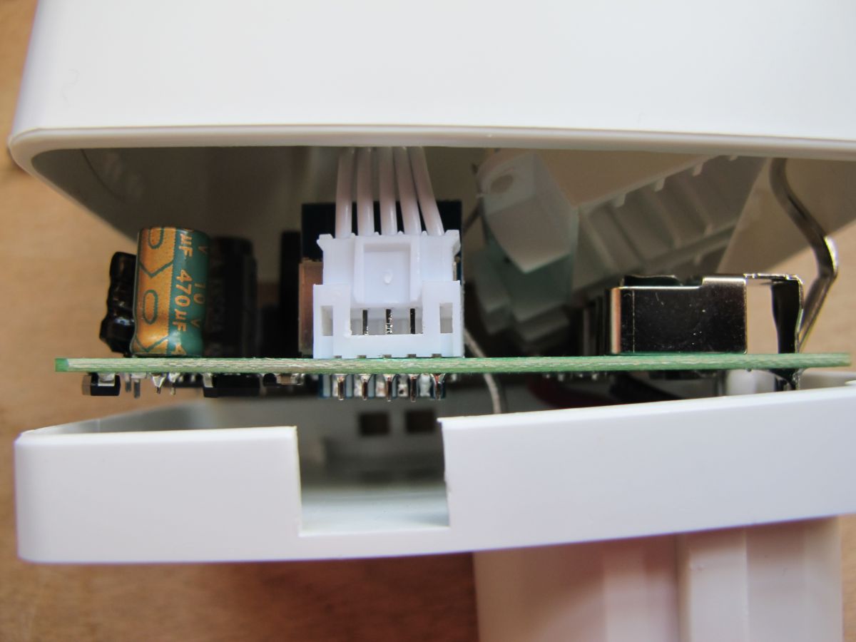

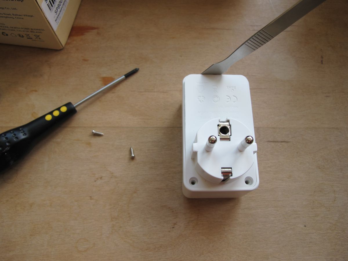

    To get inside the device, the two cross-head screws on the underside need to be removed and the snap-fit casing pried open with a thin spudger
    LoraTap Tuya smart plug with open case and tools on a white background.

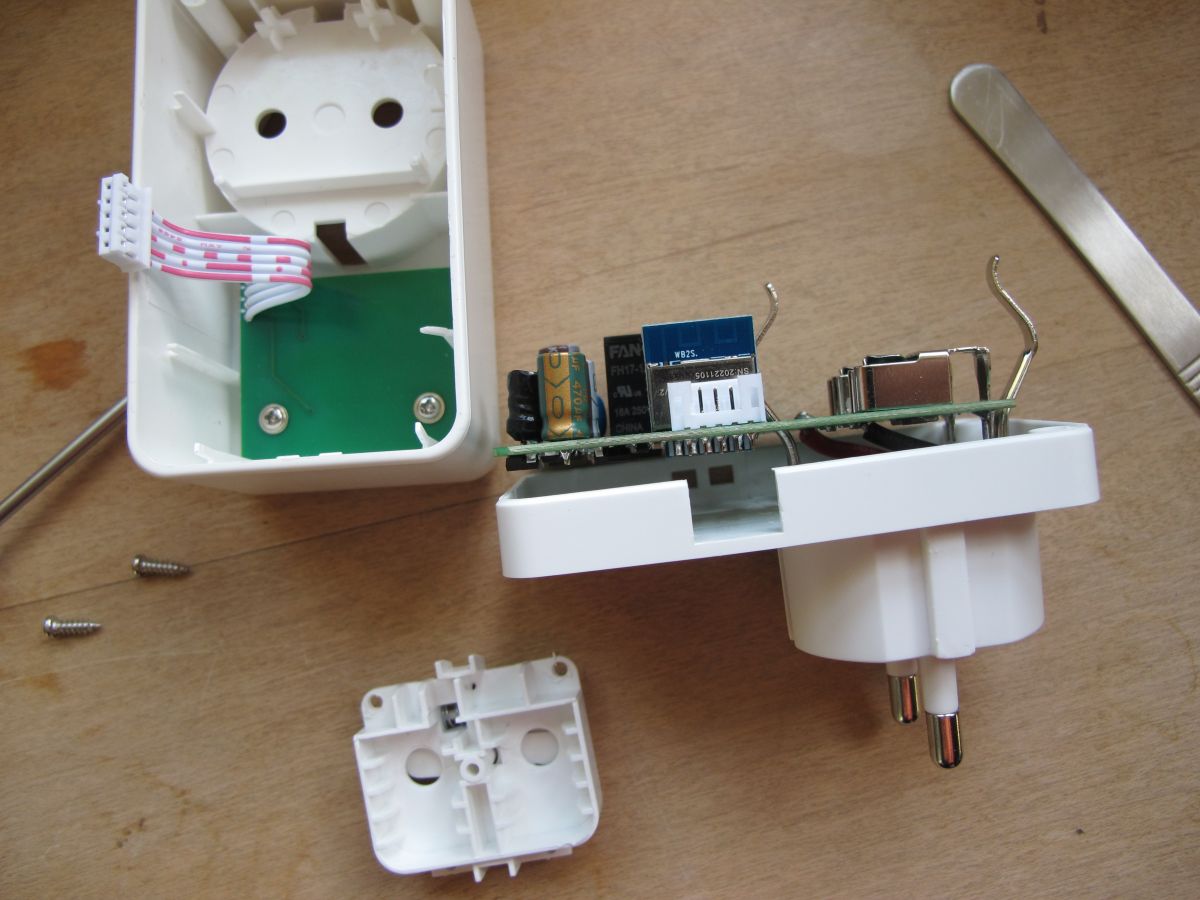

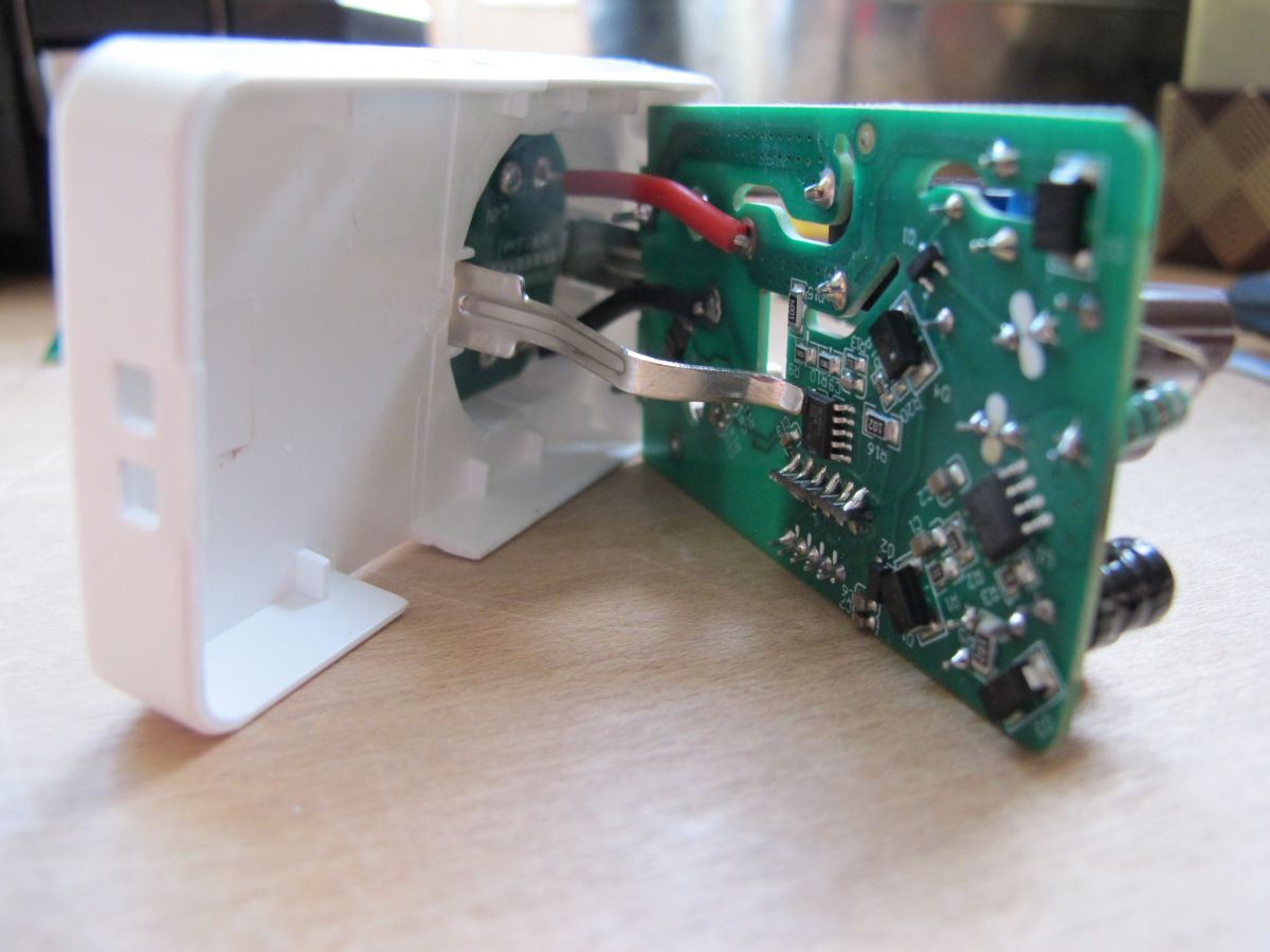

    With the case apart there'll be some connections between the main parts stopping complete separation.
    Disassembled LoraTap SP800WJ-EU smart plug.

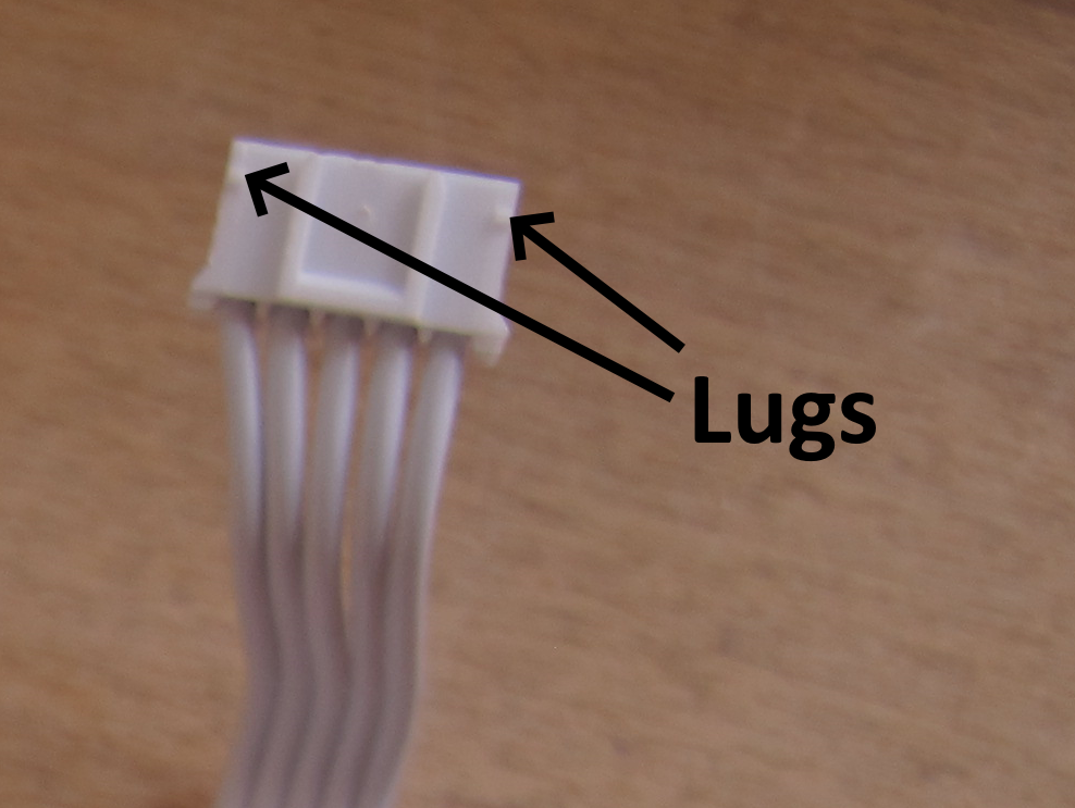

    Pushing the little white lugs at the left and right of this connector allows the connector to be pushed upwards using something with a thin wedge, like a flat screwdriver or the edge of the spudger if narrow enough
    Interior of LoraTap SP800WJ-EU smart plug.Plug with wires and Lugs labels
    With that separated:
    Interior of disassembled LoraTap SP800WJ-EU smart plug Interior of LoraTap SP800WJ-EU smart WiFi plug with exposed circuit board. Interior of LoraTap SP800WJ-EU smart plug housing with circuit board and ribbon cable WB2S module on a circuit board with electronic components. Close-up of the SP800WJ-EU-KP3210 circuit board with visible components. PCB of LoraTap SP800WJ-EU smart plug with electronic components. Disassembled LoraTap SP800WJ-EU smart plug showing the interior with PCB and components.

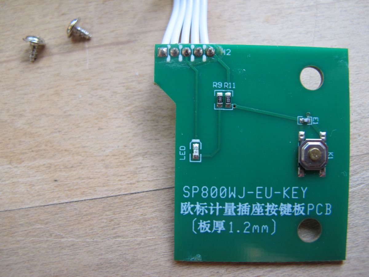

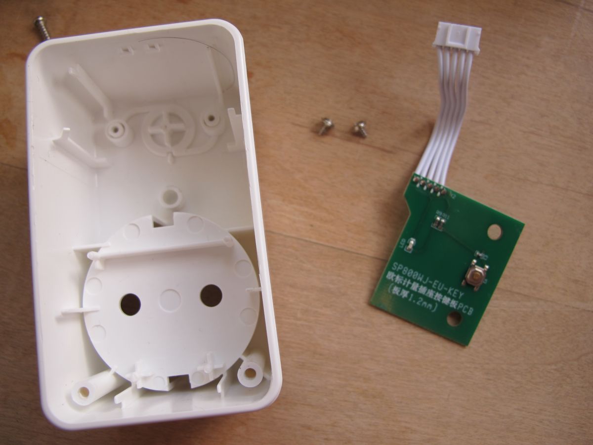

    The ribbon cable went to a separate PCB where the LED and button are soldered, which itself can be freed by removing the two screws
    PCB board with electronic components and a button. Opened smart plug casing from LoraTap with a disassembled circuit board.

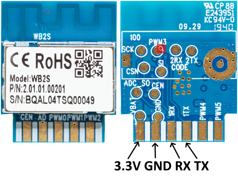

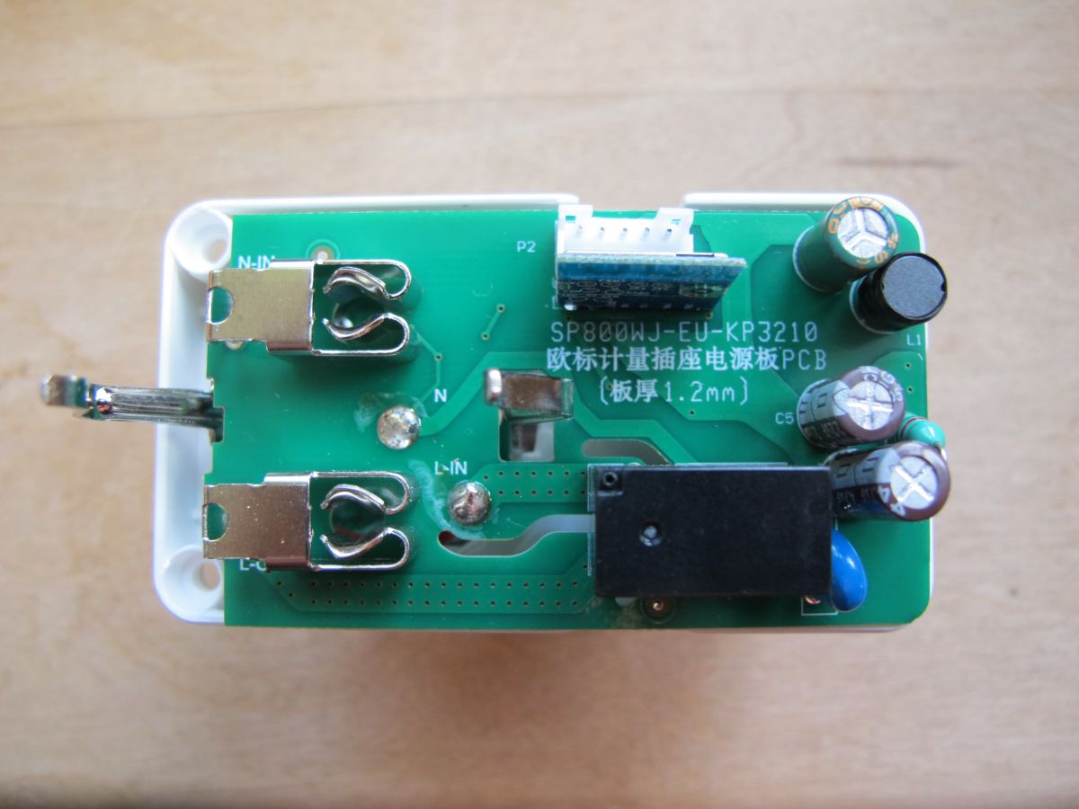

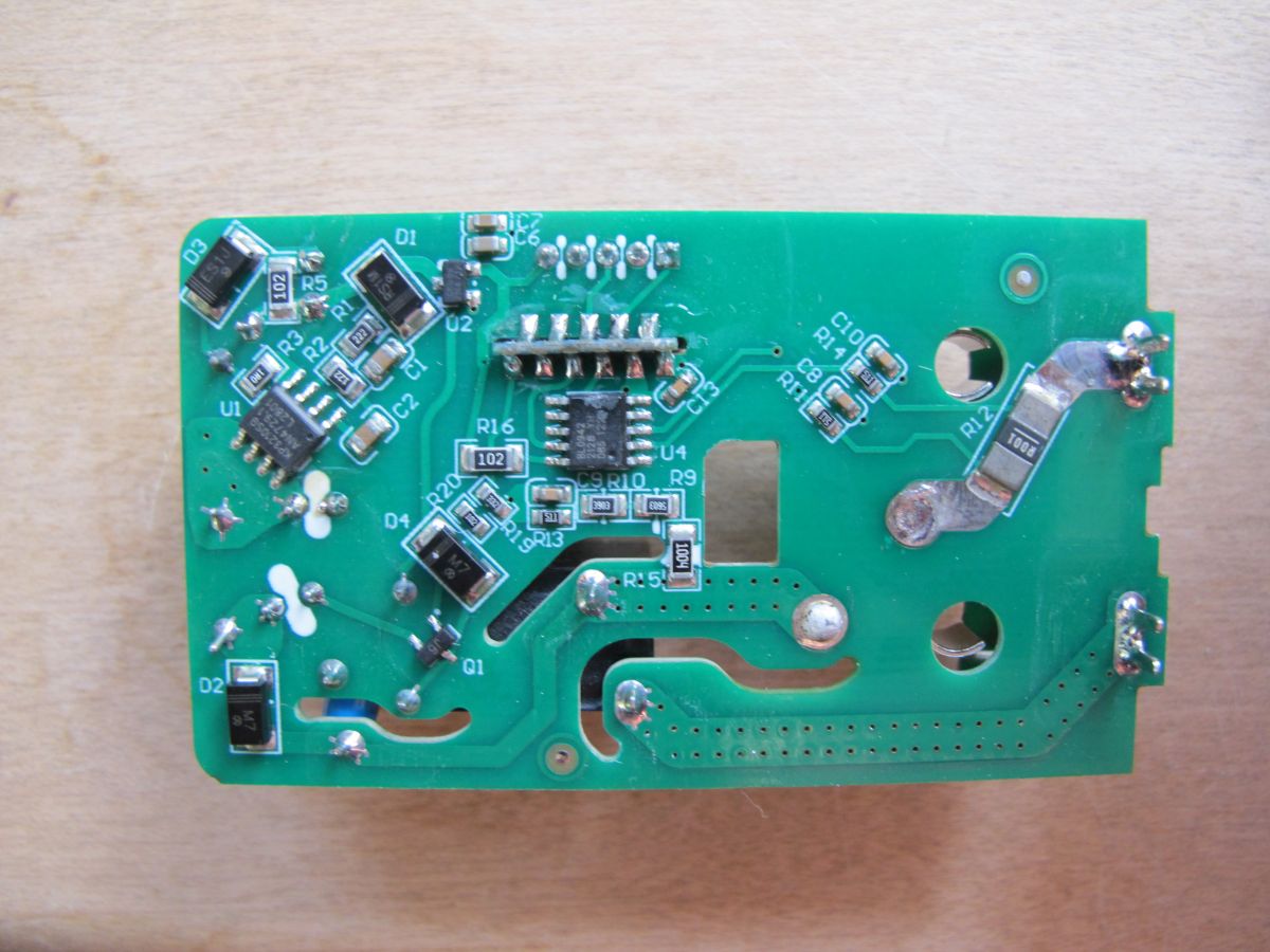

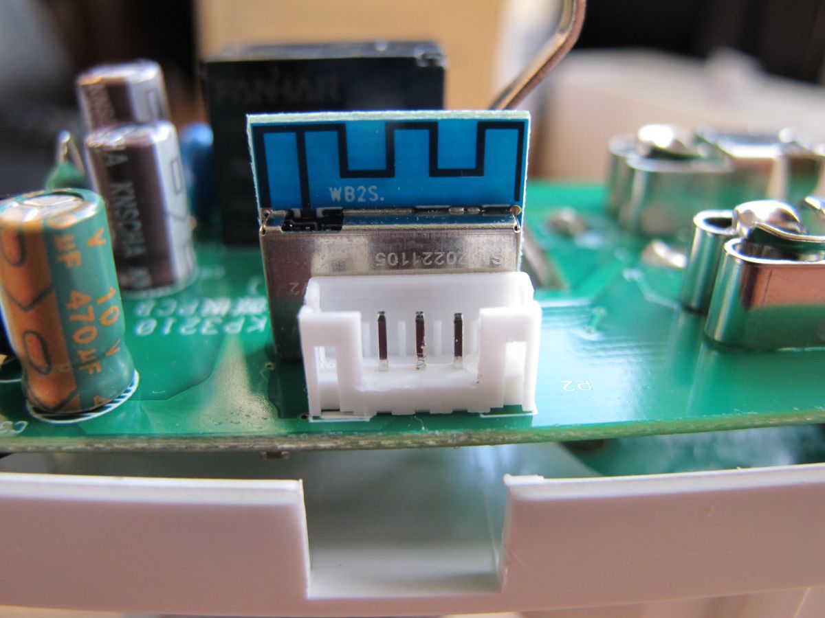

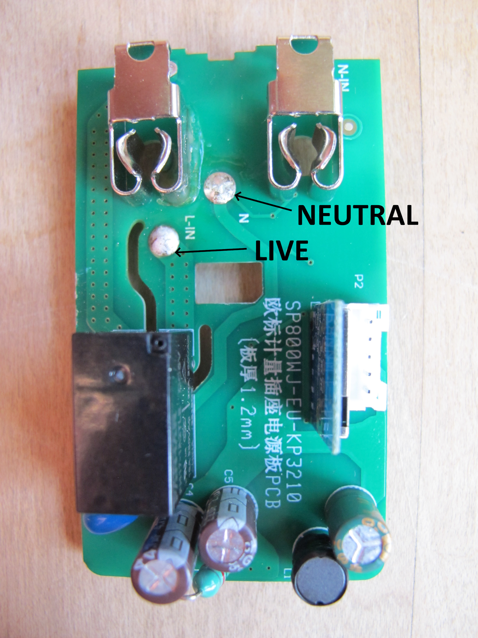

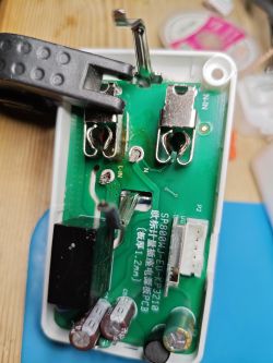

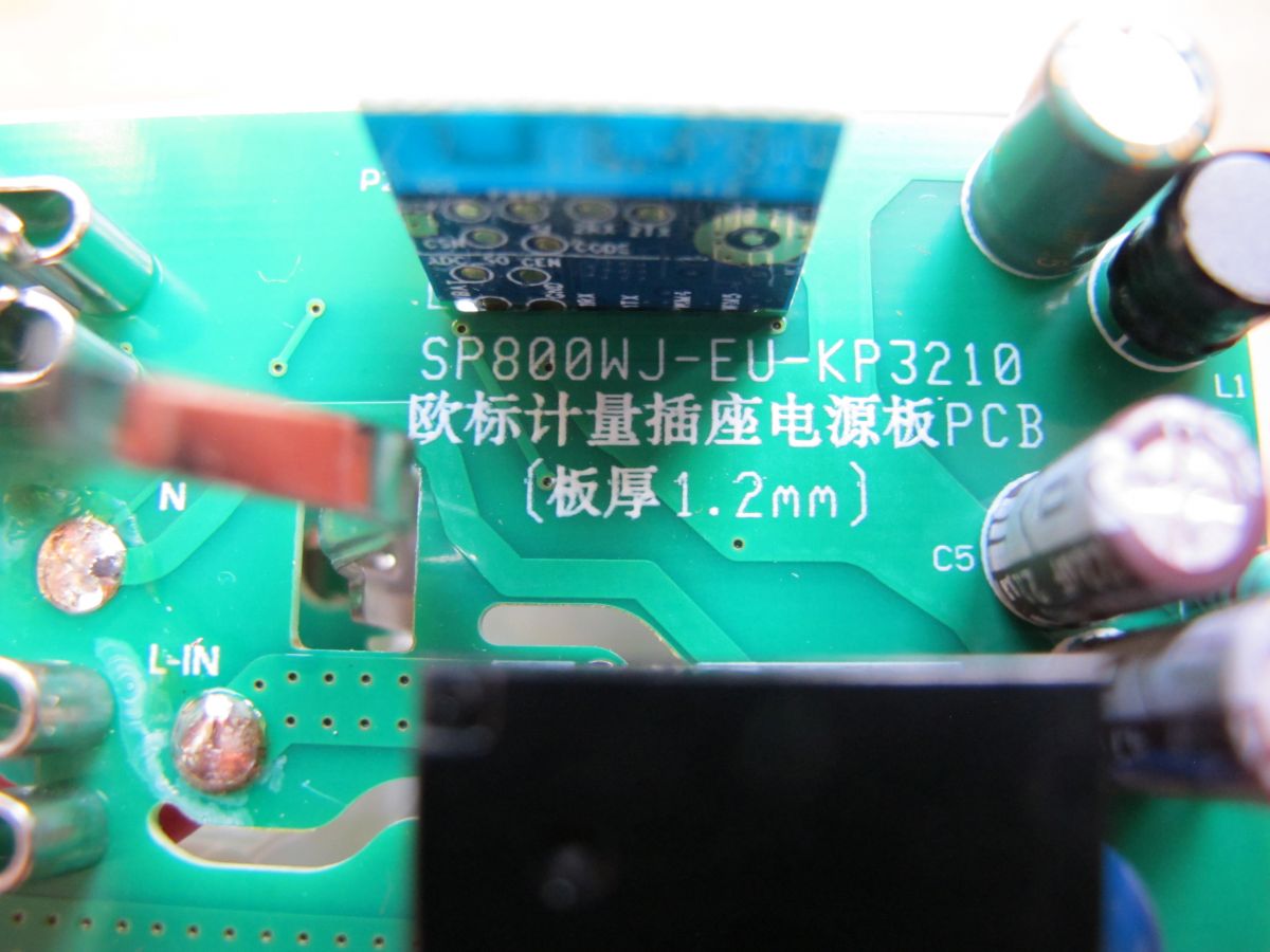

    Sticking up from the main PCB is the module we're interested in - the WB2S. Tuya WB2S has a Beken BK7231T chip under the metal RF shield.

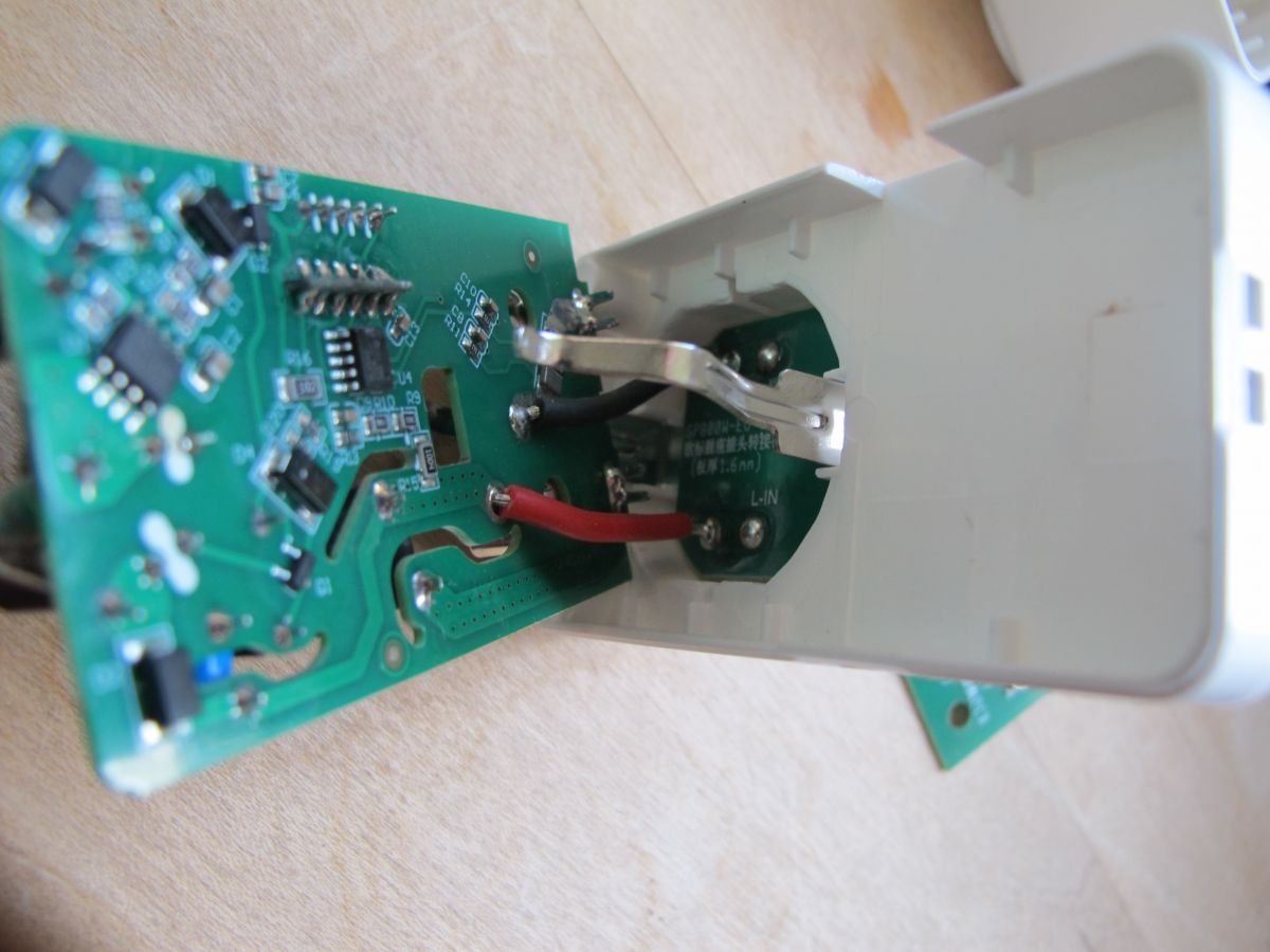

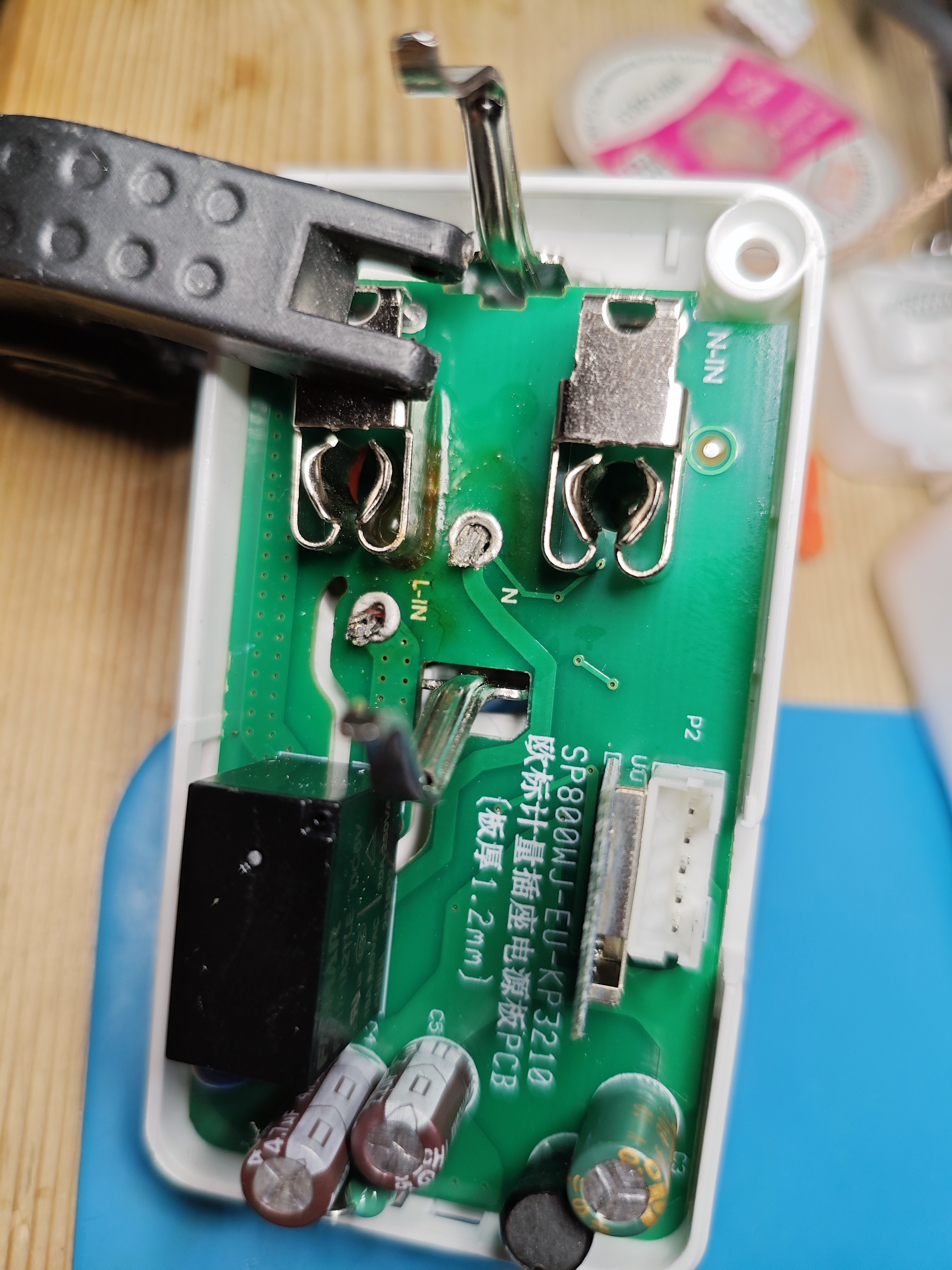

    To free the main PCB completely, so we can access the WB2S properly, the mains live and neutral wires need to be de-soldered. I achieved this with a dab of flux on each solder blob and then heating each with a soldering iron until the solder melted, allowing the wires to be removed
    Electronic module of LoraTap smart plug with NEUTRAL and LIVE labels.

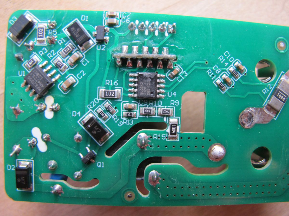

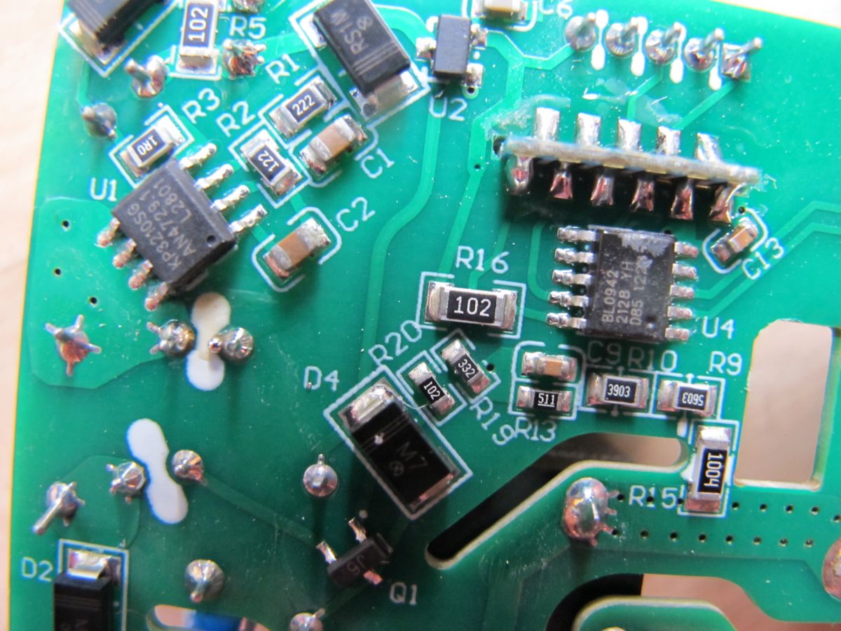

    Close-up of the circuit board from the LoraTap SP800WJ-EU smart plug showing the BL0942 module. View of the internal circuit board of the LoraTap SP800WJ-EU plug. View of circuit board with electronic components
    The WB2S RX/TX/3.3V and Ground points are easily accessible with the module kept in place, so no need to remove the whole module from the mainboard.
    WB2S module with exposed connection points for soldering on the reverse side.
    Solder those 4 up with some short thin wires
    Circuit board with wires soldered to soldering points.

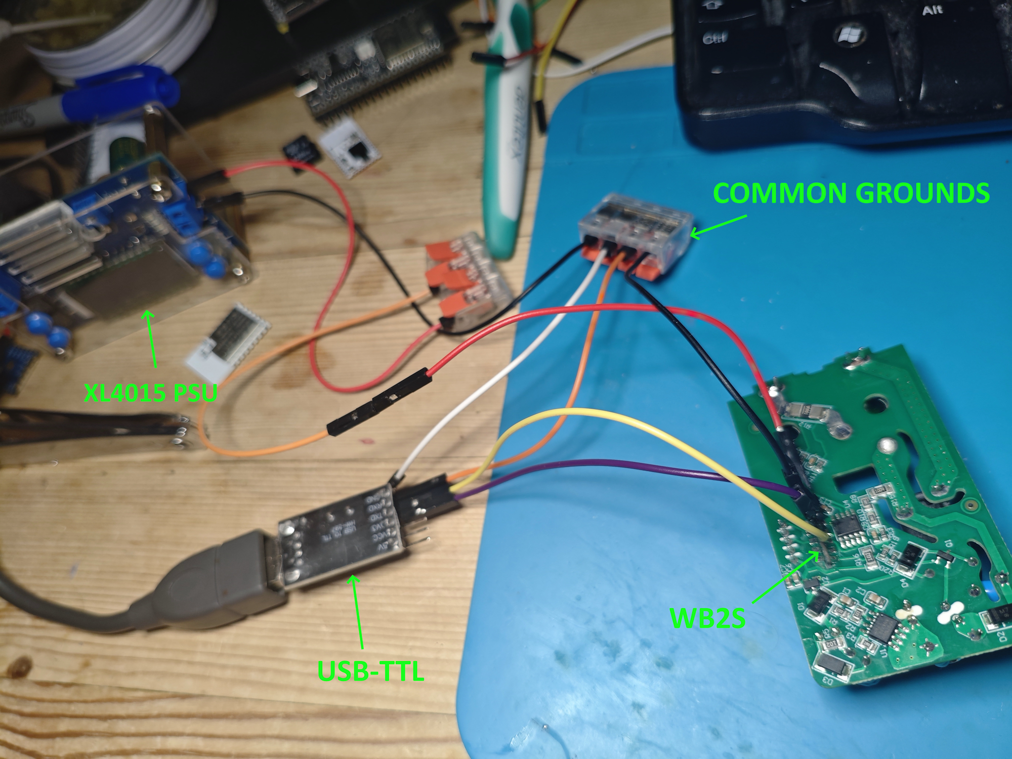

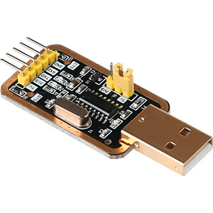

    And connect as follows to your USB-TTL adaptor and external 3.3v power supply (USB-TTL's own 3.3v line will most likely not be enough for successful firmware backup and flash).
    USB-TTL adapter with chip and pin connectors
    WB2S RX -> USB-TTL TX
    WB2S TX -> USB-TTL RX
    WB2S 3.3V -> Ext 3.3v PSU
    WB2S GND -> USB-TTL GND and Ext 3.3v PSU GND
    View of a PCB with wires connected to a WB2S module.
    My PSU is a basic hobbyist XL4015 with LCD from Ali Express

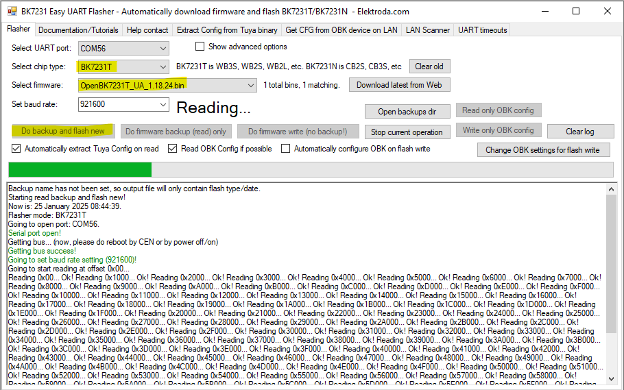

    With Easy Flasherrunning, BK7231T selected and the latest OpenBeken BK7231T firmware downloaded (EF does this for you), the backup of factory firmware and flash to OpenBeken can be started. Power on the PSU to begin the process. If the reading/writing fails, try lowering the baud rate and checking your wiring is sound and short. Ensure there is continuity between common grounds and all other points with the USB-TTL and PSU powered off.
    BK7231 Easy UART Flasher interface reading firmware data.

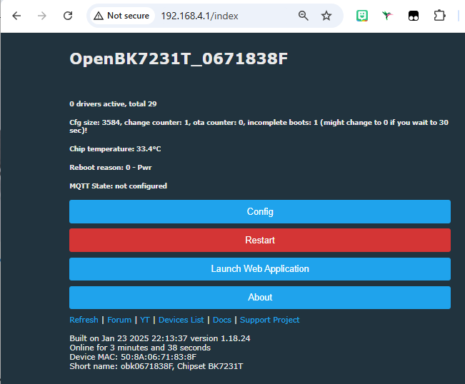

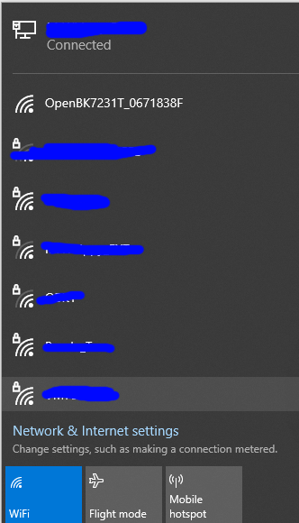

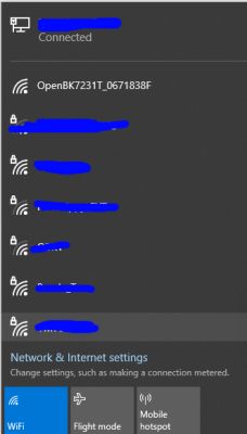

    When flashing is complete and after an off/on of power, the OpenBeken AP broadcasts:
    Screenshot of a Wi-Fi network list with the OpenBK7231T network selected.
    Join the AP to find OpenBeken gives you a client IP of 192.168.4.100. You can then browse to 192.168.4.1 to begin setup of OpenBeken.
    OpenBK7231T configuration screen with device information and configuration options.
    From this point you can configure OpenBeken to join your wifi, setup the template to control the device (button, relay, LED), configure MQTT and Home Assistant discovery, configure power monitoring etc, just like Tasmota.

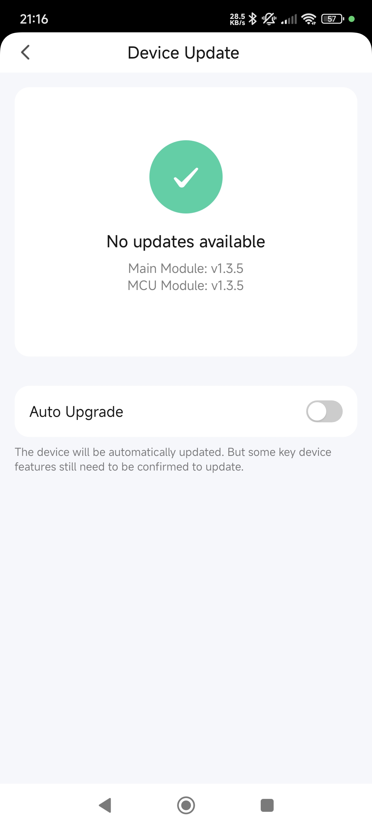

    Firmware version 1.3.5 - CloudCutter exploitable: https://github.com/tuya-cloudcutter/tuya-clou...r/devices/loratap-sp800wj-eu-plug-v1.3.5.json
    Unpaired storage area:

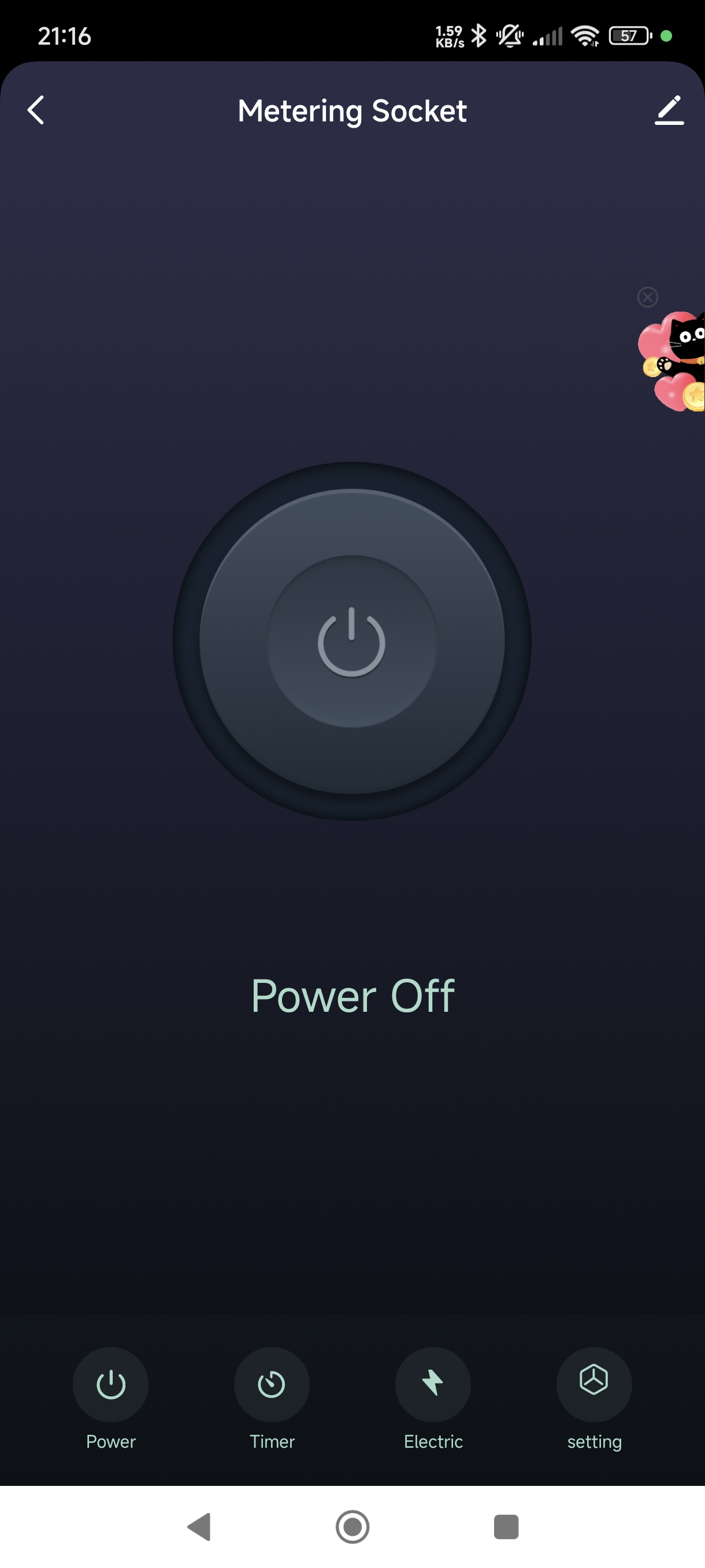

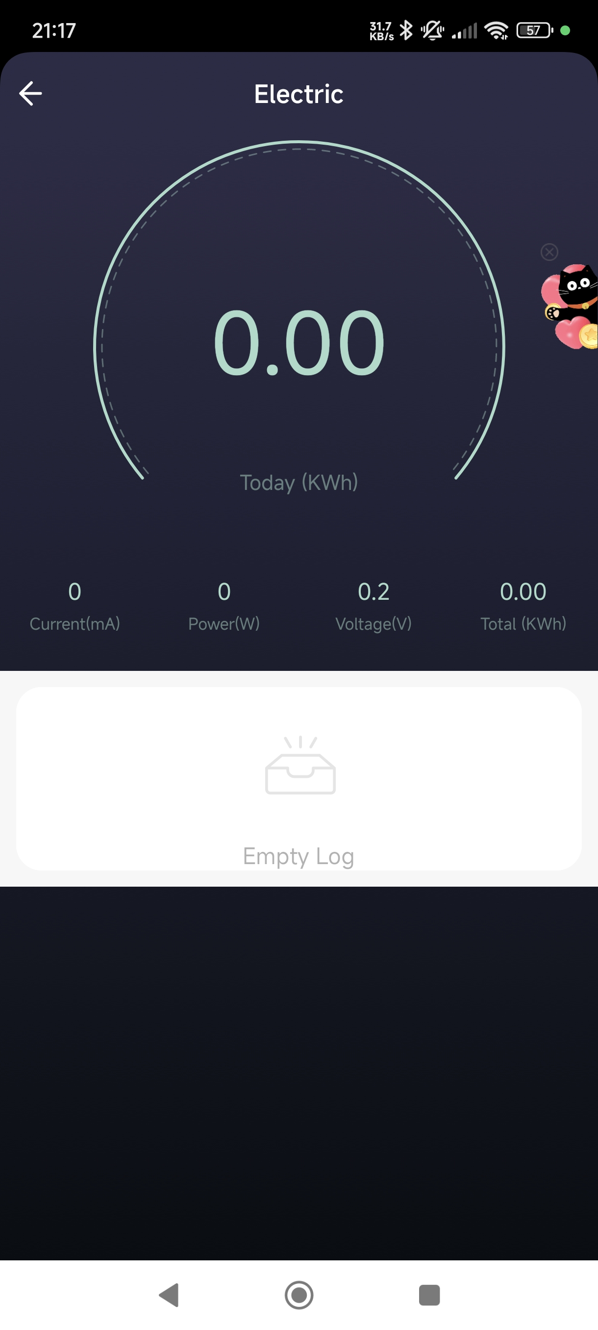

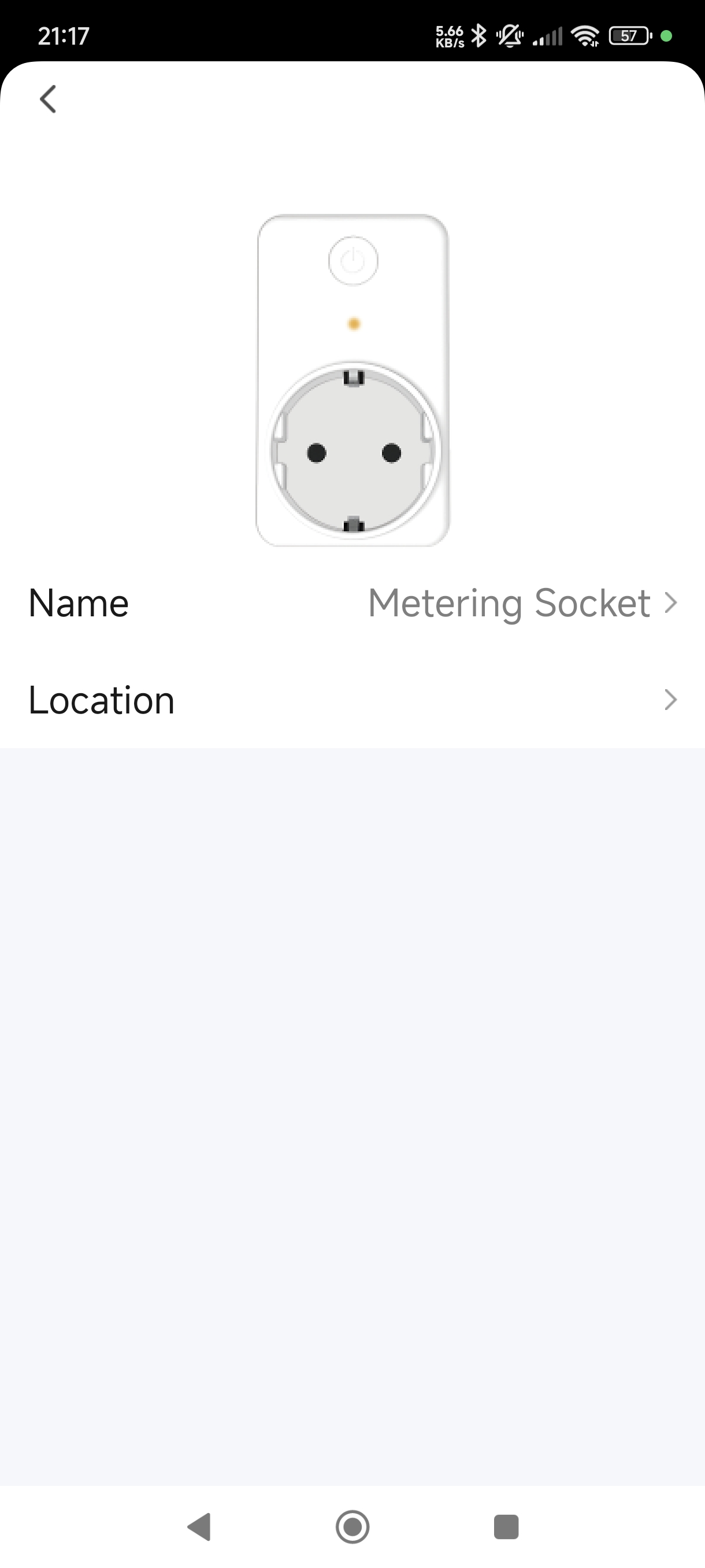

    Tuya app screenshots
    Screenshot of an app with a smart power metering socket. App screen for controlling a metering socket with the power button off. App screen showing energy consumption at 0.00 kWh. Device update screen with No updates available message.
    Factory backup Tuya_LoraTap_SP800WJ-EU_Plug_(schemaID-000002zjt3)_keym9qkuywghyrvs_1.3.5.bin https://github.com/openshwprojects/FlashDumps/tree/main/IoT/BK7231T
