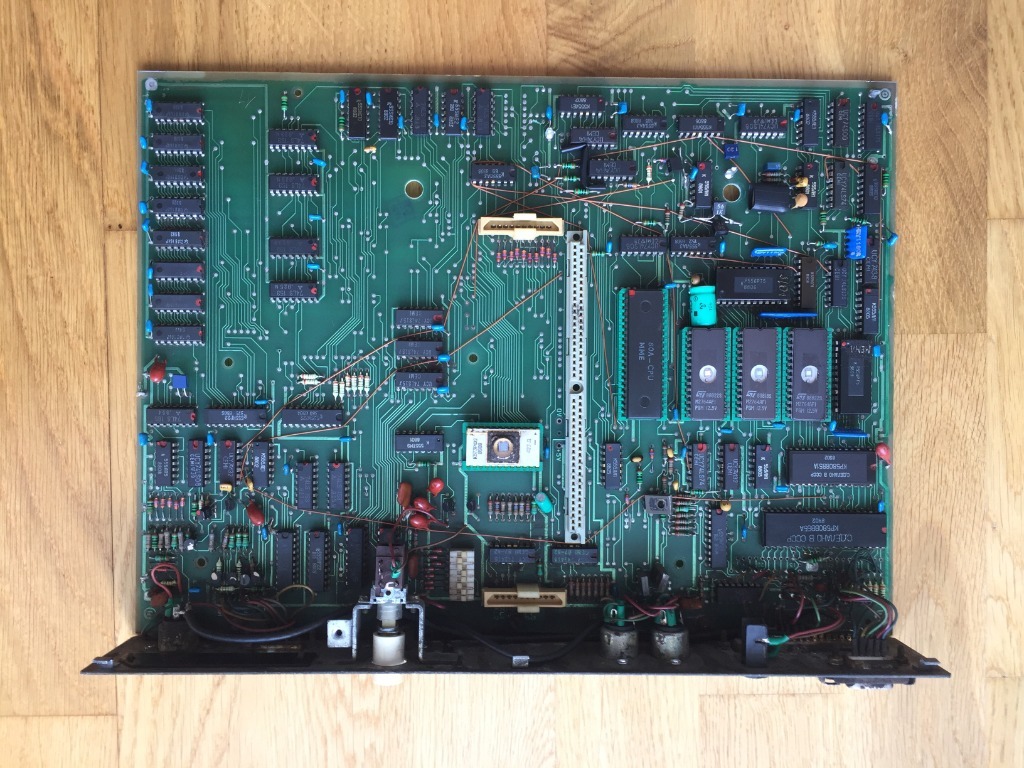

    Motherboard of the Wektor-06C computer with multiple integrated circuits.
    Wektor-06C motherboard. Retrieved from https://www.computer-museum.ru/articles/personalnye-evm/971/

    And what was the quality of the circuit board itself in this Wektor? Because there is a multitude of circuits, you wrote that they are quite fail-safe, and I see that none of them has a socket. Didn't the eventual replacement of the circuits cause the tracks to peel off?
    What was the potentiometer on the back used for?
  • Unvarnished board caused oxide short after a year
    #10 21302518
    andreyatakum
    Posts: 836
    Rate: 1156
    kris8888 wrote:
    And how was the quality of the circuit board itself in this Vector?
    Quite the quality of the circuit board was not bad. Quite thick. But it was not varnished. Because of this I had a problem - the computer stopped working after a year of operation. It turned out that it had a valve between the wires with lead oxide. A white stain like snow.
    kris8888 wrote:
    Because there is a plethora of circuits, you wrote that quite failure
    I wrote that the quality of the components was not very good. Personally I had no problems apart from that short circuit and the keyboard. I replaced the buttons in the latter, but several friends complained about the memory chips.

  • Wbudowany ROM miał tylko 512 B lub 2 KB i zawierał wyłącznie start ładowania z magnetofonu, stacji dysków lub zewnętrznego ROM-u; BASIC ładowano z zewnątrz. [#21300197]
  • Procesor KR580WM80A był odpowiednikiem Intel 8080 i pracował tu z zegarem 3 MHz zamiast typowych 2,5 MHz. [#21300197]
  • Płyta główna zawierała około 83–97 układów scalonych; dla porównania w wątku podano Commodore 64C – 16, ZX Spectrum 128K – 29, MSX2 – 37. [#21300197]

What common hardware faults affected the Wektor-06C, including keyboard problems, bad memory chips, and conductive lead-oxide buildup on the PCB?
Najczęściej zgłaszano problemy z klawiaturą, układami pamięci i przewodzącym nalotem między ścieżkami. Autor wymieniał przyciski klawiatury, a jego znajomi skarżyli się na kości pamięci. Opisał też awarię po roku pracy: biały osad z tlenku ołowiu utworzył zwarcie między przewodami na niewerniksowanej płycie. Sama płytka była gruba i mechanicznie niezła, ale brak lakieru ochronnego zwiększał ryzyko takich usterek. [#21302518]
How can you troubleshoot and repair a Wektor-06C that stopped working because of corrosion or a short between PCB traces?
Najpierw trzeba szukać białego nalotu i mostków przewodzących między ścieżkami. Autor opisał przypadek, w którym komputer przestał działać po roku przez osad z tlenku ołowiu na niewerniksowanej płycie.
  1. Obejrzyj płytę pod światło i znajdź biały osad lub zwarcie.
  2. Usuń nalot z przestrzeni między ścieżkami.
  3. Sprawdź klawiaturę i kości pamięci, jeśli usterka zostaje.
Ta sekwencja odpowiada najczęstszym problemom wymienionym w dyskusji. [#21302518]
