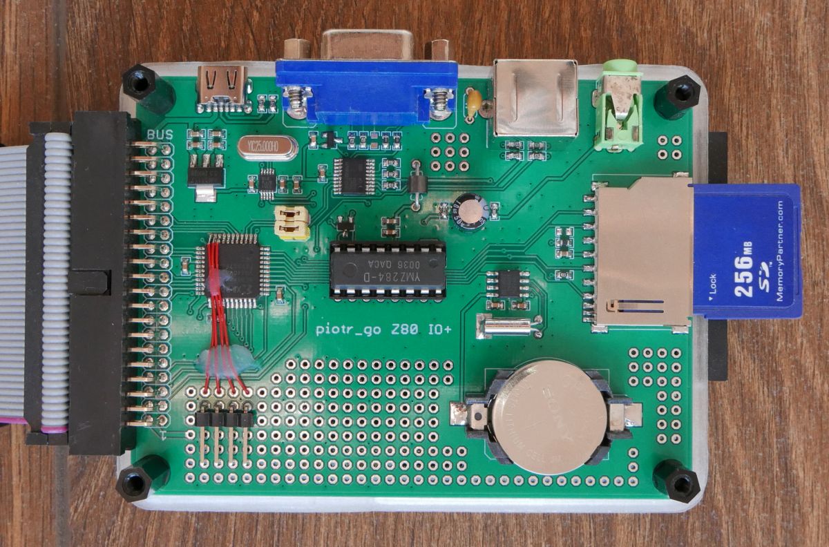

    IO board:
    Computer on Z80 with VGA by piotr_go
    XC9572XL as uart, spi and interrupt controller.
    GD32 generates the image, reads the keyboard, configures the Si5351 and generates 50Hz to interrupt.
    YMZ284 sound generation.
    DS1302Z clock.

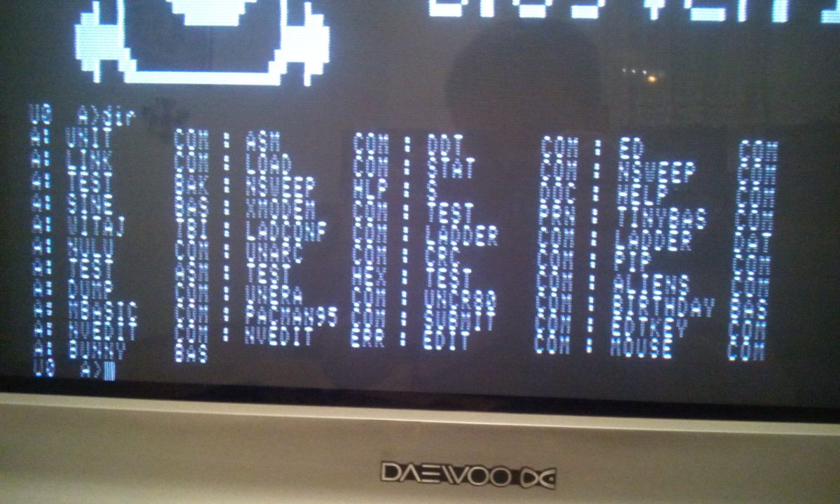

    Start screen:
    DIR command for USER 0:
