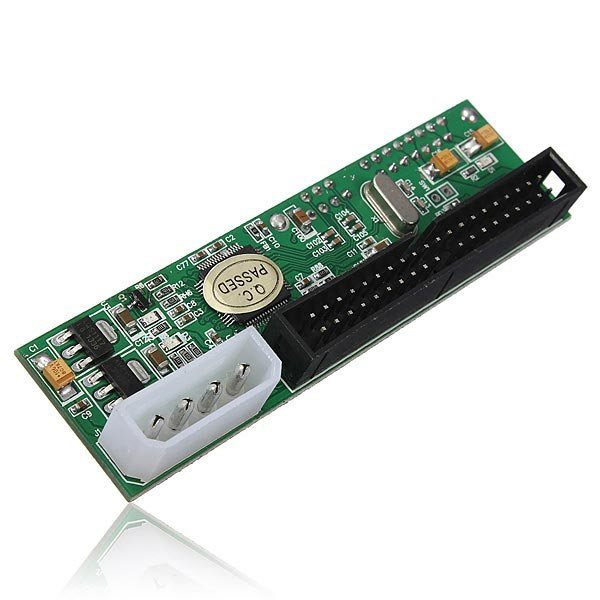

    Would you be able to read 8051 sata drives?
    ATA / SATA adapter:
    Computer with 8051 z VGA by piotr_go

    On such an adapter, the SATA-> PATA conversion will not be a speed daemon, but the 8051 is also not one of such "daemons".
