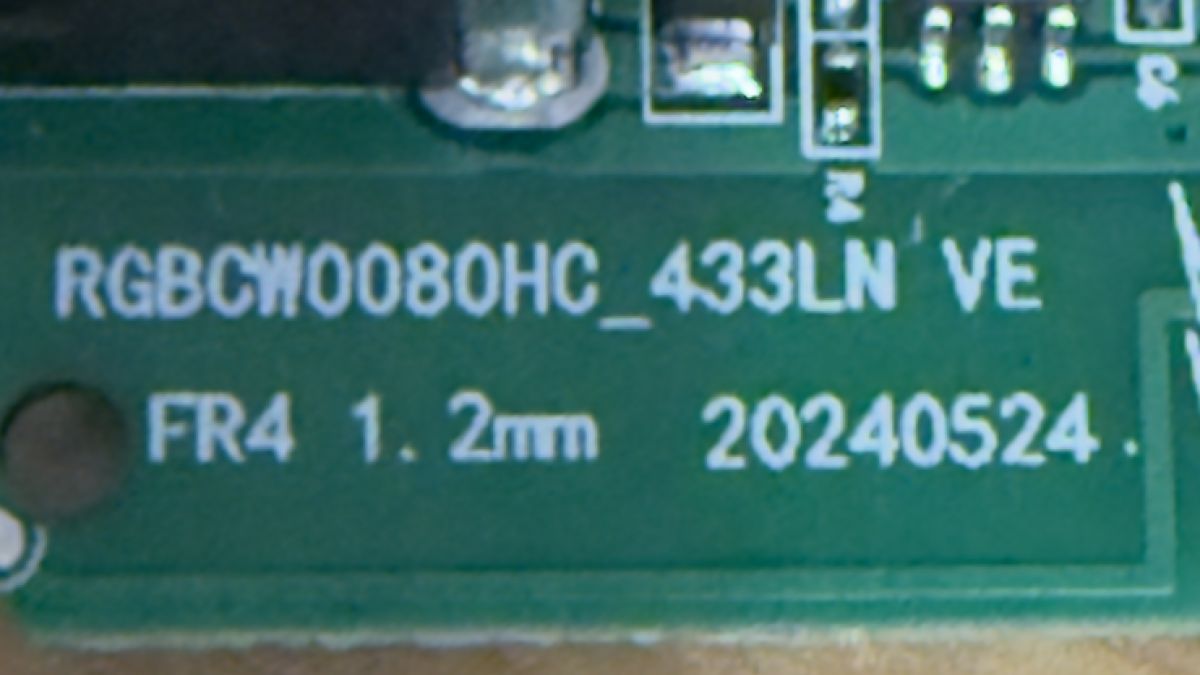

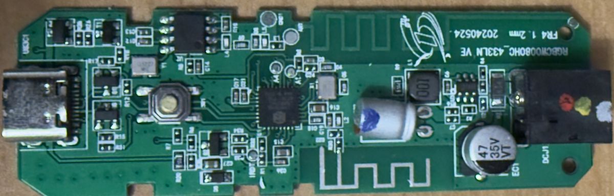

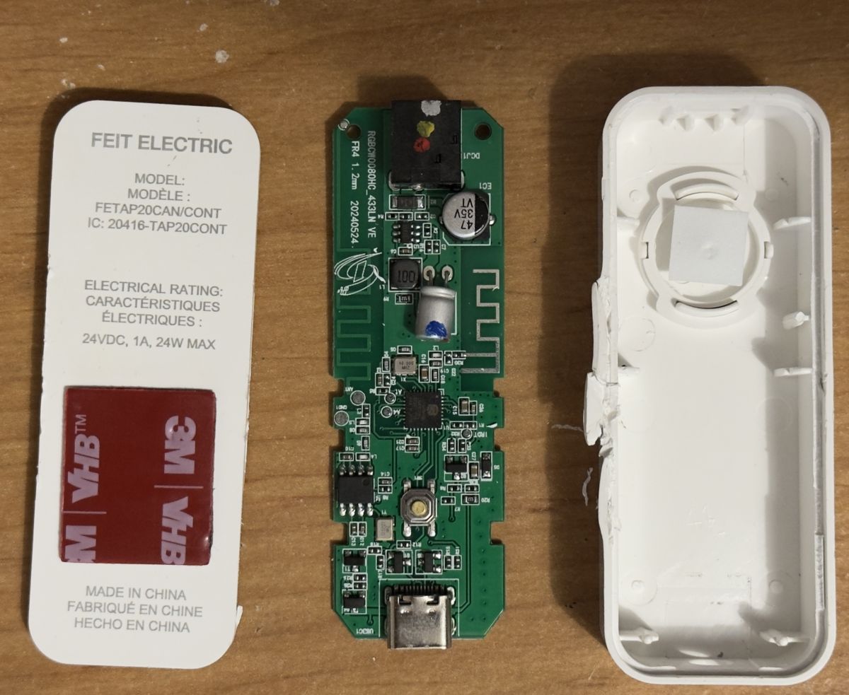

    Teardown Feit Electric Indoor 19.7 ft. Smart Colour Chasing Strip Light
    Model FETAP20CAN/CONT

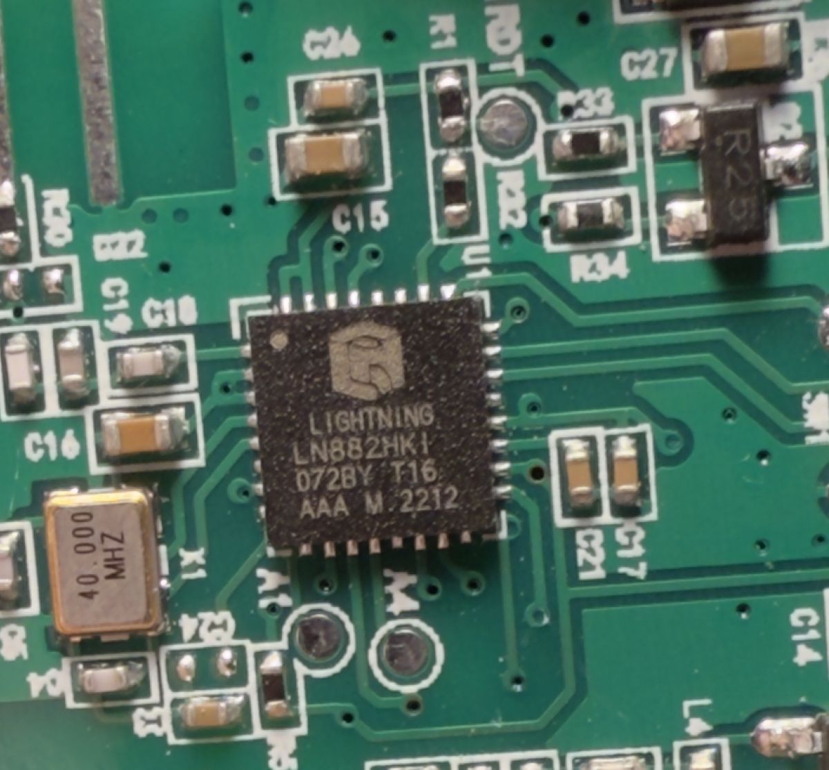

    LN882HKI chip
    The case was difficult to open without damaging it.
    Thanks to jasperro posting a very similar unit.
    https://www.elektroda.com/rtvforum/topic4083817.html

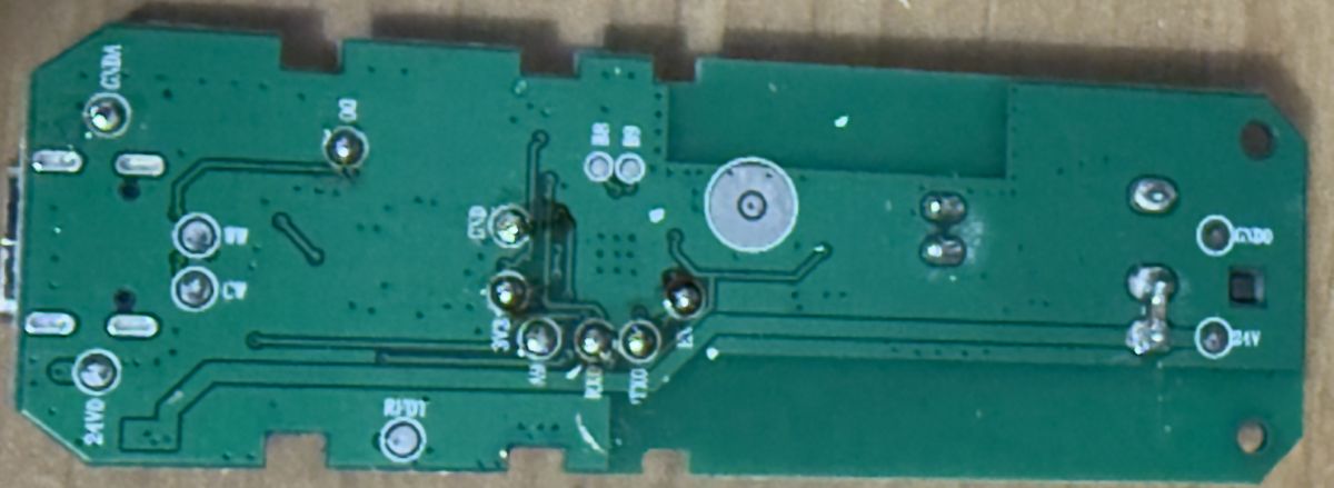

    I was able to dump the firmware via UART and attached.
    I was able to get the White LED turned on and off with White on the RGB lights. Not sure what to do next.

    ok learning lots about LED strips and the different types.
    This strip is using the SM16703 controller with separate W, WW and RGB.
    I was able to poke around and get the W and WW lite, but not consistently.
    I was reading @darconeous post on a similar strip based on the BK7231N.
    Lots of great work by many people, thanks for all the info.
