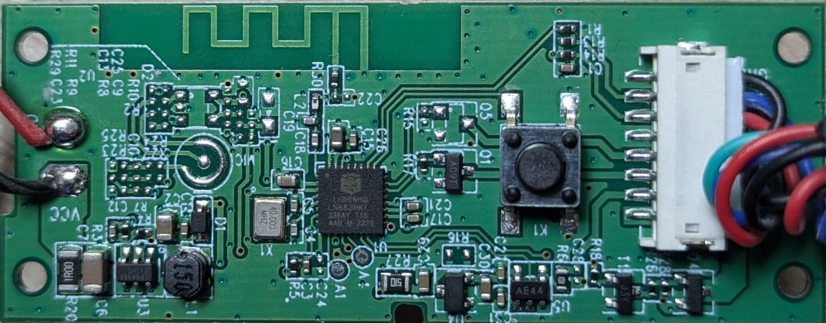

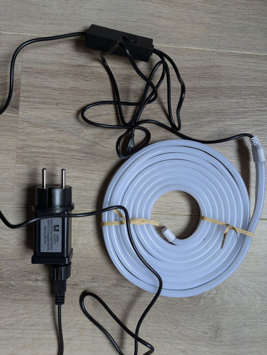

    Hi there, I got a LSC Connect Smart Neon LED Strip 3m (Model 3200654) from Action.
    There are 36 addressable zones of 6 leds each = 216 leds total.
    LSC Smart Connect Smart Neon LED Strip 3m packagingPackaging of LSC Connect Smart Neon LED Strip 3m with instructions in multiple languages.Coiled white LED strip with power adapter and cables.

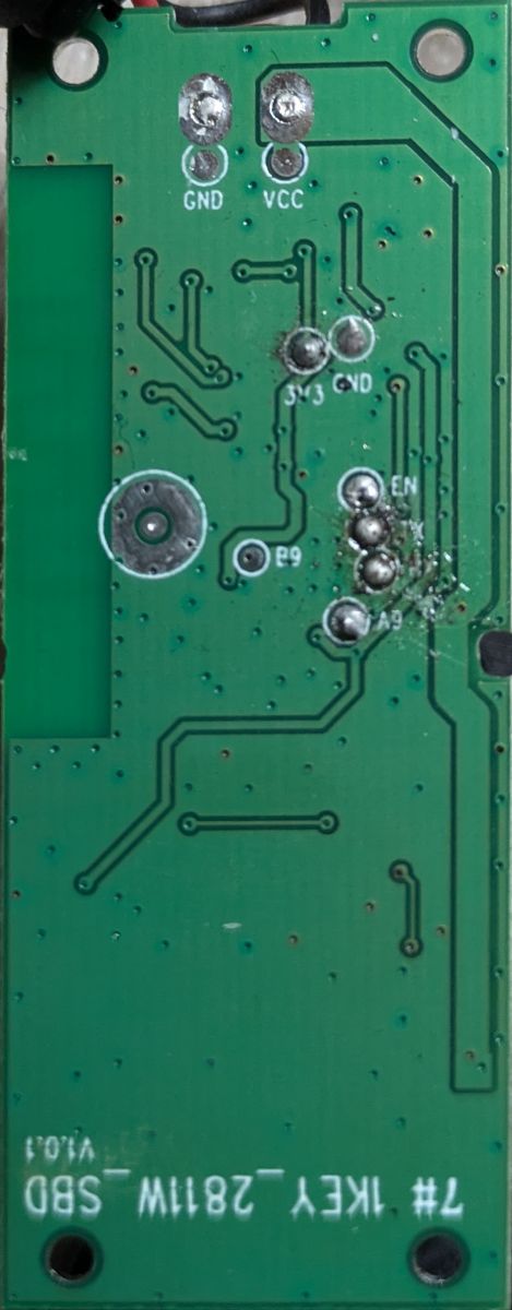

    I took the thing apart with a knife, destroying the casing a bit. The casing seems to be friction fitted, without clips. It should be possible to take the case apart by using some wide pulling pliers or a plastic pick.
    Looking inside, I found that it has an onboard LN882H chip, supported by OpenBK7231/OpenLN882H
    I referenced LN882H datasheet, pinout, WiFi modules (LN882HK, LN882HKx, LN882), Esphome/Tasmota style firmware and How to flash LN882H with open source Tasmota/Esphome style firmware - backup procedure included
    The led strip has white (one color) and also has addressable RGB with WS2811 (RGB order). This was not implemented in the app yet, so I wrote a small WIP driver for it based on the existing SM16703P driver and some test code from the LN882H sdk (jasperro/Openbk7231T_App#jasperroLN882H-WS2811). It has some built-in WS2811 DMA stuff. This is implemented since 1.18.151 with standard SM16703P driver.

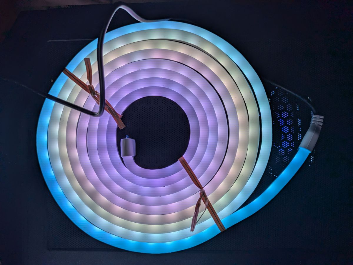

    Here is the thing showing a nice gradient. Using the DDP protocol with LedFX works as well.
    SM16703P_SetRaw 1 0 00FF993DFC8D57F9816AF6757AF26A89EF6096EB56A2E74DADE344B8DF3CC2DA36CCD630D5D12CDECC2AE6C72AEEC22CF5BC2FFCB733FFB138FFAB3EFFA74EFFA55EFFA269FF9F73FF9D7AFF9A81FF9787FF948DFF9192FF8E97FF8B9DFF88A2FF84A8FF80AEFF7CB4FF77BB
    LED strip emitting a multicolored gradient coiled in spirals.
    You need to turn pin 11 (A11) on first if you want to turn the led strip on, then send PWM signal on pin 7 (A7) for white.
    To run the addressable WS2811 leds, pin A11 needs to be set to Input Off, and pin 6 (A6) can be used for WS2811 data. In this mode, pin 7 needs to be HIGH (Same as PWM 255).

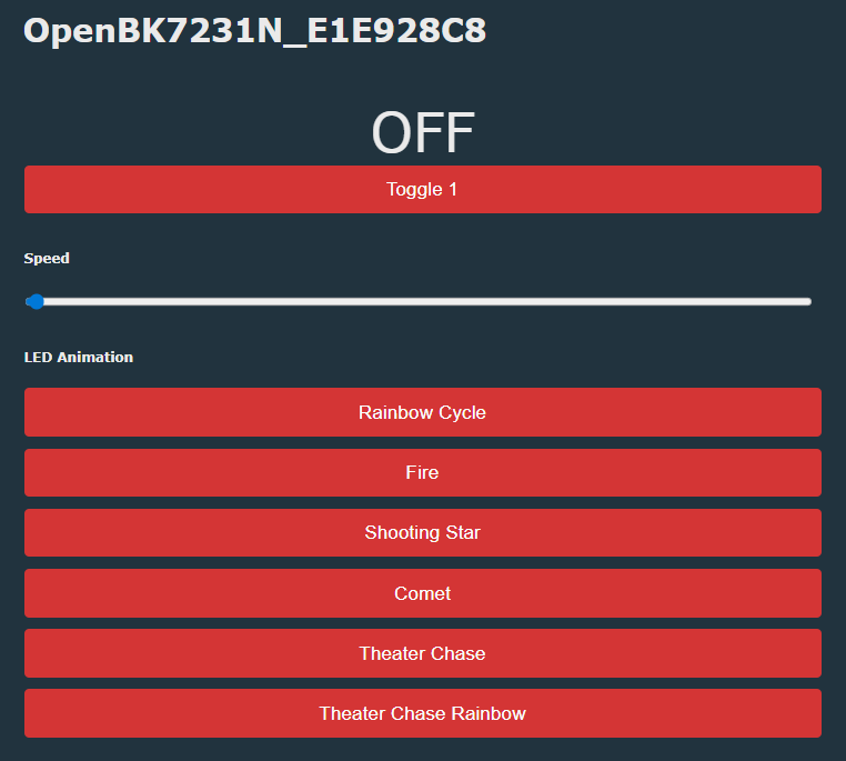

    Instruction manual for GUI
    To control the led strip through the GUI is not fully straight-forward.
    For the control to work, enable Flag 3: [LED][Debug] Show raw PWM controller on WWW index instead of new LED RGB/CW/etc picker.
    To set white: Turn off "Toggle Light", Turn on "Toggle 52" (which turns on pin 11), Now channel 10 slider controls brightness of white leds.
    To set color: Turn off "Toggle 52", Turn channel 10 slider to full brightness (PWM 255), Turn on "Toggle Light". Now you can use the color selector, WS2811_SetRaw, DDP, etc.

  • Added PixelAnim support and SM16703P commands
    #18 21391542
    jasperro
    Posts: 17
    Rate: 8
    >>21391425 Not yet. It works fine for me but openshwprojects still had some comments (the way I did the pin enum could break other configs, merging with SM16703P driver). See the PR for my reply: https://github.com/openshwprojects/OpenBK7231T_App/pull/1414. I applied some suggestions and now will await response.
    I also added PixelAnim support now (not fully implemented yet, shooting star does not work correctly). The commands are not WS2811 anymore but SM16703P (just like beken)

    >>21631511 It works great! I just flashed version 1.18.175 on this LED strip. All effects working as well (including the new theater ones). The IR receiver also works now. I set IRRecv on pin B5/21 in the module configuration. (also the event handlers for autoexec.bat)
