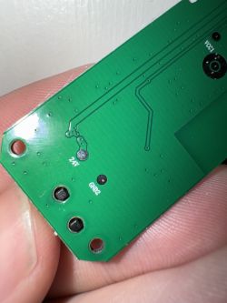

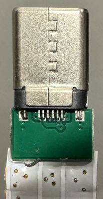

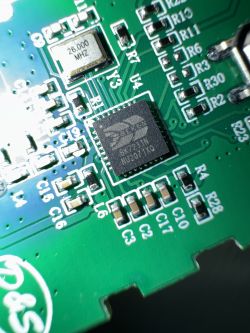

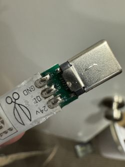

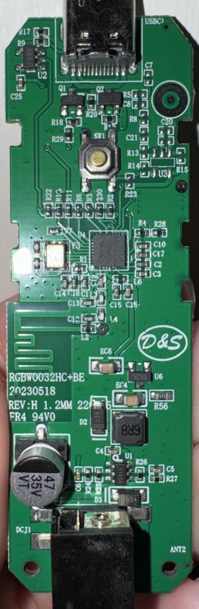

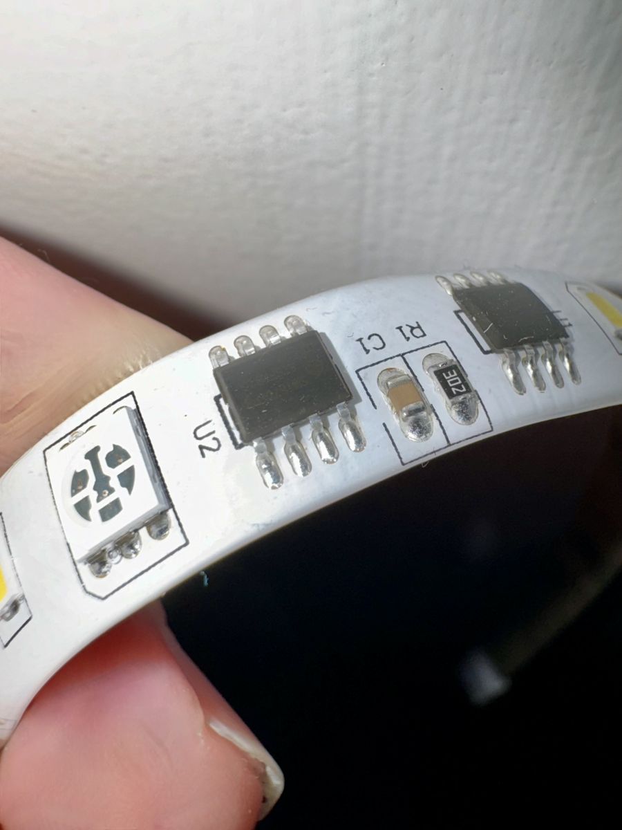

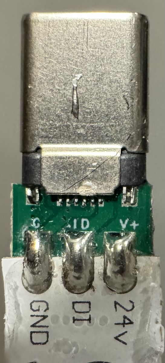

    Howdy. I just picked up a Feit Electric 20-ft LED chaser strip and promptly tore it down. Seemed to be using a BK7231N. The strip is RGBCW, but it is a little strange in that each segment has two chips: a SM16703 and a SM16704. This means there are, ua... 7 channels per segment, but I only see 5 being used. I haven't tried driving it yet, so I'm not sure what the channel order is yet.

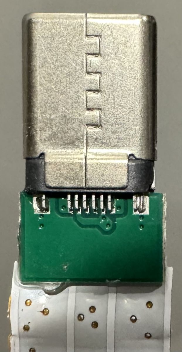

    Bizarrely, the connector for the LED strip is the same as USB-C, even though it is very clearly NOT USB-C. They are only sending three signals over it: +24v, DOUT, and GND. I'm not yet sure how they are mapping those to the USB-C pins yet, so not sure if it would fry anything if someone decided to try to connect it to their computer. Very strange decision.
    In any case, I haven't tried changing the firmware yet, but it looks like all the important pins have nicely labeled test points.
    It was something like $25 at Costco.

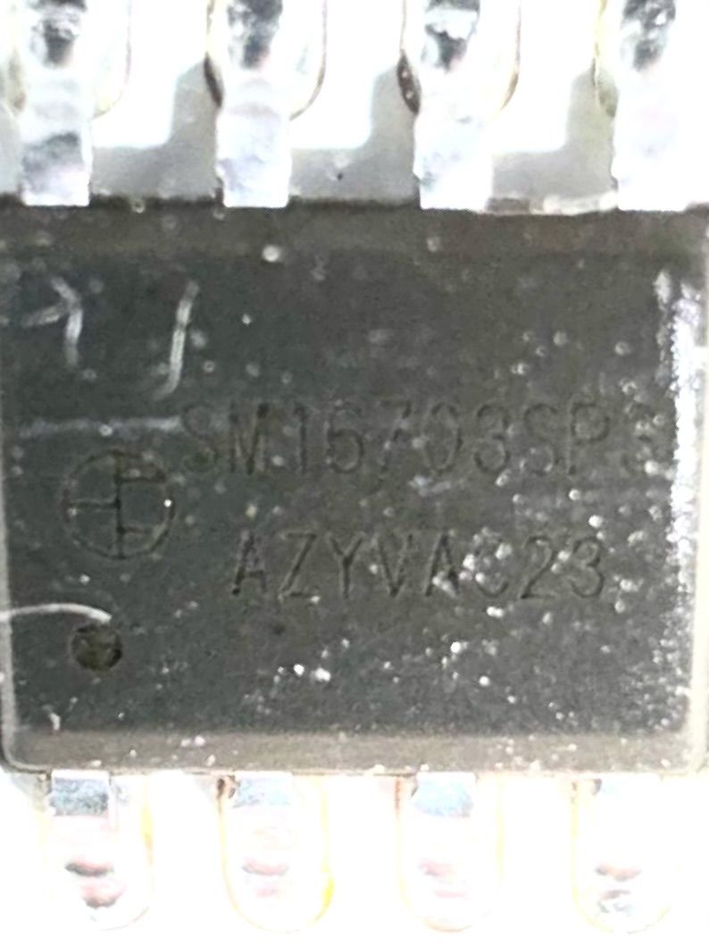

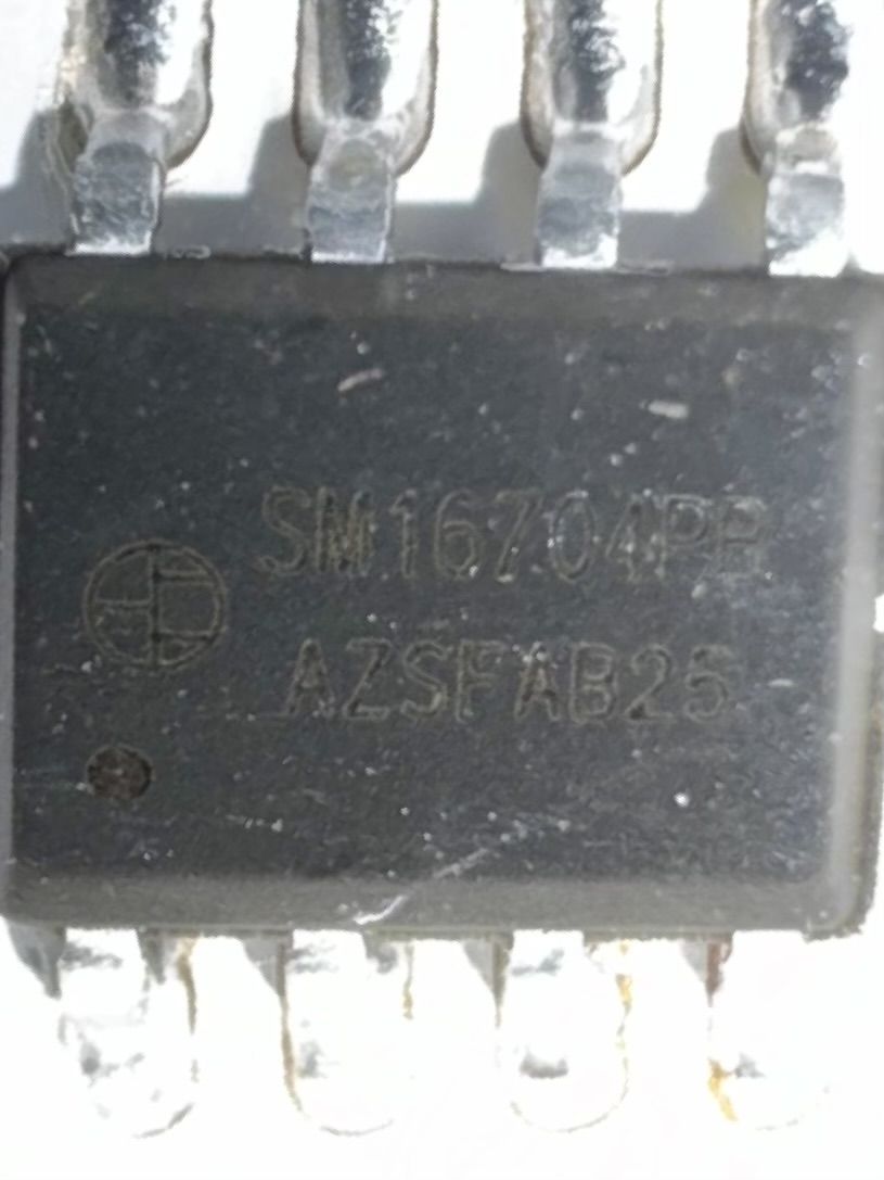

    I think that we have a SM16703 , so maybe, just make a 2MB flash backup and give it a try? I can try to guide you step by step with that.

    Will do. Maybe the weekend before I can give it a shot. I had originally planned to just toss the controller and replace it with a PicoW, but seeing your firmware has made me reconsider.
    The SM16703 is the same as the SM16704, except with an extra channel. So I expect that the protocol should be the same except with 7 channels instead of 3 or 4.
    Maybe each segment can control two sets of W and C, but only one RGB? In that case, the channel order would be something like RGBWCWC, or RGBWWCC... I guess we will find out this weekend!

    BTW: Is the BK7231N based on RISC-V? I kept trying to definitively hammer down the arch, but couldn't seem to find a decent datasheet.

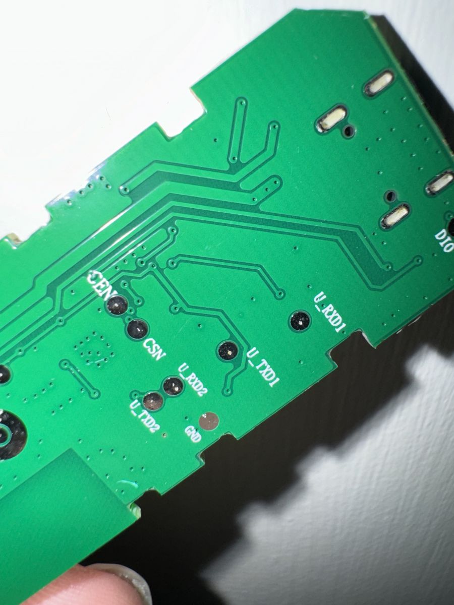

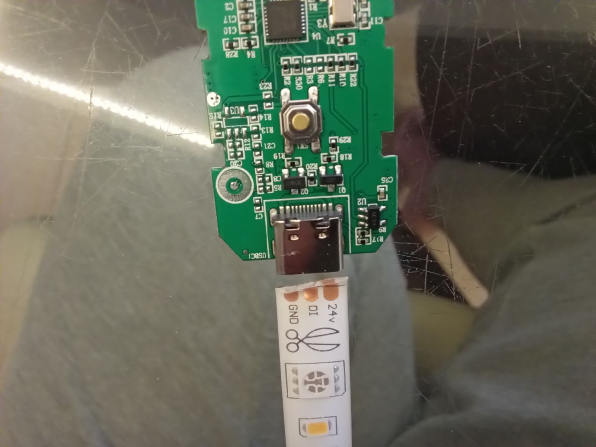

    Ok, I managed to get it flashed using the python command line tool on my Mac. I can now access the web interface without too much trouble. I did back up what I could of the firmware, but I'm not sure if I was able to extract it properly because it kept having CRC errors.
    Now I'm at the point where I need to figure out what the GPIOs are for the button and the data line. I was hoping there was a command in the OpenBK firmware that would allow me to dump the existing state of the pins so that I could at least have a straightforward path to identifying the button.
    Any suggestions or tips/tricks for how best to identify the right pins?
    Added after 18 [minutes]:
    Ah, I managed to find the GPIO finder. Pin 24 is the button. Will go looking for the other pins soon. I think there is a MOSFET for determining if power should go to the strip or not, as well as the actual data pin.

    Sorry for the late reply. If this device is using individually adressible LEDs, then data is always P16. This is because they are using SPI to push pixels with correct timings. Have you tried SM16703 driver?

    Allright, here is the pinout:
    P16: DOUT (to DIN on the strip)
    P22: 24v Power Enable (Controls the +24v pin to the LED strip)
    P24: Button (low when pressed, high when not pressed)

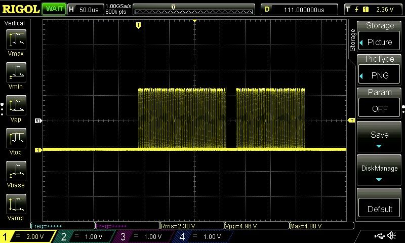

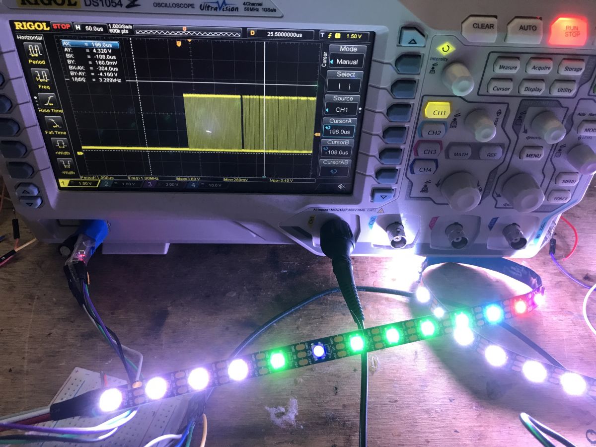

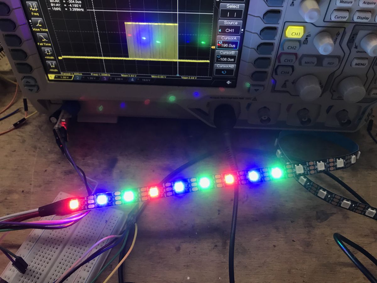

    Added after 11 [hours] 22 [minutes]:
    Argh... There seems something very strange with the SPI driver. I keep getting very strange offset/looping behavior on the SPI output, things like the channels being off by two or so, but still actually wrapping around in such a way that if you fill all of the pixels that all the pixels still get lit. The offset seems to change depending on the size of the buffer.
    My brain hurts too much to continue working on this tonight.
    UPDATE:
    Yeah, the SPI output isn't matching up with the data in the buffer:
    Oscilloscope screen showing SPI DMA test signal.
    You can see that gap in the middle: That's the "reset" pulse (extended to 7 bytes in my code) that is supposed to be at the start of the transmission. In other words, the whole transmission should just appear as a big block, not two blocks. For some reason, the "reset" pulse is in the middle!

  • P24 identified as the pairing switch
    #20 20869549
    DeDaMrAz
    Posts: 621
    Help: 34
    Rate: 130
    kevdel wrote:
    >>20868971
    if you ever need a hw to test on then I'm happy to use mine to load dev solutions.
    Thank you for commitment unfortunately we have to do tests locally so we can provide a solution. We appreciated greatly the backup you provided we are going to work with it and provide updates here.
    View of a smartphone app screen displaying LED lighting settings Chasing Tape Light. Microcontroller connected to a mobile device with an app screen showing device pairing.
    P24 is the switch on the device, used for pairing.
    @p.kaczmarek2 we should probably use our modified modules for testing, right?
    Thank you.

  • Random SPI DMA lag causing misaligned reset pulse
    #25 20937193
    Posts: 14770
    Rate: 12911
    darconeous wrote:
    UPDATE:
    If I reduce the total number of lights to 2 (7 channels each) then I can reliably get the reset pulse at the start. I'm really confused why the SPI output isn't lined up with the order in memory. Any ideas?
    I can only confirm that I've spent a day testing the SPI DMA and I arrived at the same conclusion.
    There is some strange instability that causes a random lag in transfer.
    I have tried to fix it, by, for example, doing a NOP loop until SPI DMA send everything, but it still happens.
    See WS2812B test below, correct display:
    WS2812B LED strip connected to an oscilloscope, showing display irregularity.
    Randomly, SPI DMA display is broken:
    Rigol DS1054Z oscilloscope displaying a signal and a WS2812B LED strip.
    I do not know currently what causes this issue. We need more information, any help is wanted.
  • #26 20966214
    Posts: 14770
    Rate: 12911
    The SPI DMA driver bug has been fixed. The SM16703P/WS2812B/etc LEDs should work good now. Please update your devices. For scripting configuration, please see:
    OpenBeken WS2812B driver (compatible with SM16703P, etc) - short scripting presentation
    We can continue discussion there. The more advanced animation will be added soon, stay tuned!

    sasipraveen39
    I have the same LED lights from Costco and have a lot of cut excess strips that I'm trying to solder together to form one long strip light. I'm attempting to solder the strip light directly to the controller. Does anyone know which pins on the USB-C SMD connector on the controller correspond to GND, 24V, and Dout? Thanks in advance.
    Close-up of a circuit board with a USB-C port and a LED strip labeled GND, 24V, and Dout.
  • #28 21315812
    Posts: 14770
    Rate: 12911
    Do you have a multimeter? It should be very easy to check.
    Dout is P16, hardware SPI output.
    Please check this topic to see where P16 on QFN case is:
    BK7231 datasheet, pinout, programming, specification, wiki (BK7231T, BK7231N)
    Keep in mind that first pin is marked by a dot. Futhermore, you may double check it by looking at crystal oscillator pins.
