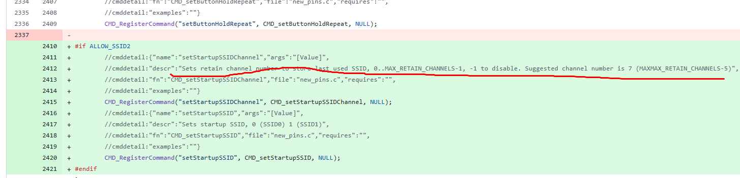

    The SSID retain modification is done and as a PR for anyone who wants to try it. Mod description:
    I have added new commands to allow preserving the last used SSID. The last used SSID is stored in the retained channel. By default, the feature is disabled.
    To enable this feature, the channel that will be used to store the last SSID must be set using the setStartupSSIDChannel command in early.bat. The recommended value is 7, values 8-12 are already used for LED brightness and so on.
    It has to be in early.bat. Autoexec.bat is processed after the wifi data is loaded.
    To disable this feature, set setStartupSSIDChannel -1
    There is also a setStartupSSID command that will force the SSID to be used on the next reboot. 0=SSID1, 1=SSID2.
    [early.bat]
    setStartupSSIDChannel 7
    https://github.com/openshwprojects/OpenBK7231T_App/pull/1440
    New Commands:
    setStartupSSIDChannel [-1 or RetainChannelIndex]
    Description: Sets retain channel number to store last used SSID, 0..MAX_RETAIN_CHANNELS-1, -1 to disable. Suggested channel number is 7 (MAXMAX_RETAIN_CHANNELS-5), because channels MAXMAX_RETAIN_CHANNELS-4 . .MAXMAX_RETAIN_CHANNELS-1 are used for LED brightness etc.
    Examples:
    - to enable SSID retain function on channel 7 - It has to be in early.bat.
    - to disable SSID retain function (or just remove activation in early.bat)
    setStartupSSID [0/1]
    Description: Sets startup SSID - 0=SSID1 1=SSID2 - which SSID will be used after reboot. The value is stored in flash, so it will be so until next change or until the module connects to another SSID. For this to work, setStartupSSIDChannel and SSID2 must be set.
    Examples:
    - to force use SSID1 at startup
      setStartupSSID 0
    - to force use SSID2 at startup (SSID2 must be set)
      setStartupSSID 1
  • #6 21321497
    Posts: 14796
    Rate: 12954
    It seems like a nice change. I've reviewed the PR and I can accept it on my side.
    @XJ_ , do you consider it ready to merge?
    @divadiow ,@max4elektroda ,@insmod any other things to watch for, or shall I merge it already?
    PS: Please link to this discussion topic here:

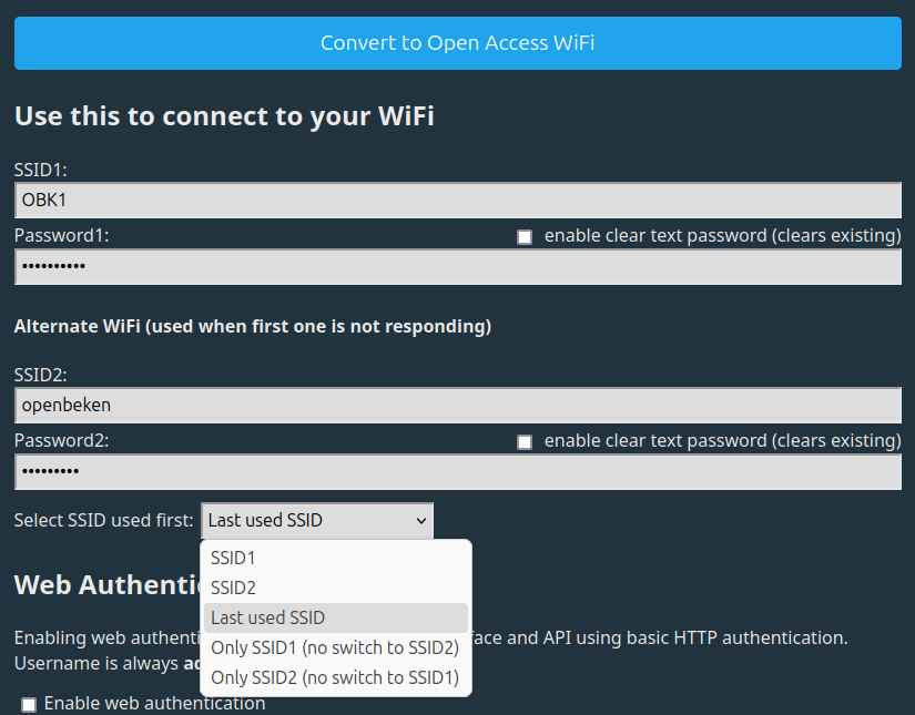

    Goal is to allow the last active SSID used as starting SSID on next device start?
    I really think this is a great idea!
    If we can agree on making a constraint about the channel used for this feature (like "use channel 7"), I think this great feature can be simplified (regarding the usage):
    If there is no (more) need to set the retaining channel with a command, it's only to decide wether to retain or not.
    If I'm right, this could also be a simplified to just a tick box on the SSID config page.
    Or do I miss(understand) something?
  • #10 21328184
    max4elektroda
    Posts: 758
    Help: 49
    Rate: 189
    I tried to code my idea in PR #1448.
    Basic idea is to store everything to channel 7.
    There probably is some room for improvement, but it's a working approach - I really like the idea and think there might be more users, if they don't need to generate/modify autoexec.bat or use commands ;-)
    Screenshot of a WiFi connection settings interface with options for selecting SSID and network authentication.

What happens after I run setStartupSSID 1?
It forces SSID2 on the next reboot and stores the choice in flash. The setting persists until changed or until the module connects to another SSID. It requires both setStartupSSIDChannel and SSID2 to be set. [Elektroda, XJ_, post #21320298]
Can we reserve channel 7 or auto‑detect a free retain channel?
Not yet. Channel 7 was identified from a code review, but its availability is not guaranteed. That is why the early.bat configuration approach was chosen. A formal retain‑channel reservation mechanism has been proposed for future discussion. [Elektroda, XJ_, post #21328326]
Is using a 'magic number' in the retain channel recommended?
It was explored as a safeguard (e.g., magic 42) to detect conflicting use. With a defined reservation or dedicated bits, a magic value is unnecessary. It served only as a first try. [Elektroda, max4elektroda, post #21328525]
What if I already use all 12 retain channels?
Using the last slot for SSID state can conflict in that situation. The maintainer suggests documenting this behavior to avoid surprises. If you truly need all 12, you may disable SSID retention or reassign usage. [Elektroda, p.kaczmarek2, post #21312956]
