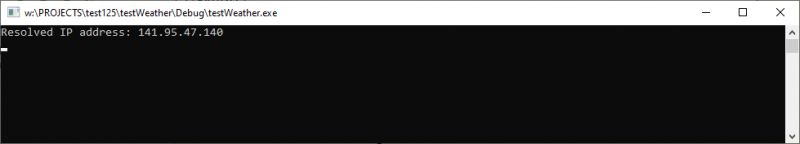

    To retrieve the IP for a domain name, the function gethostbyname is used, which is available both on Windows/Linux and, for example, in the popular LWIP network library.
    Running sockets on Windows still requires a call to WSAStartup, which I have also included in the code:
    Code: C / C++
    Result:
    Console screen showing IP address 141.95.47.140. .

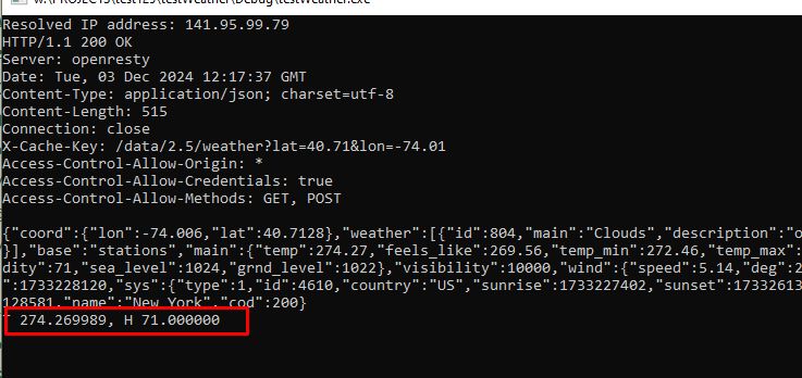

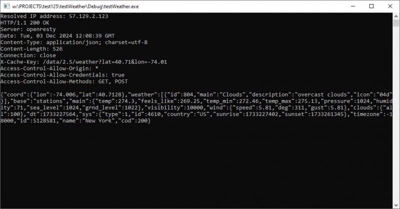

    Then all that was left was to receive the response and display it on the screen:
    Code: C / C++
    Of course, let's not forget to close the socket:
    Code: C / C++
    Result:
    Windows console with weather information from OpenWeatherMap .

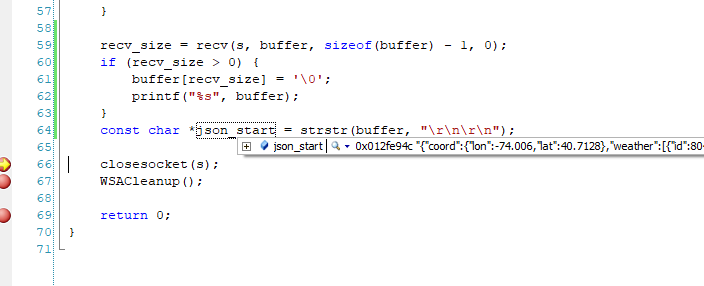

    Now it is time to process the response. In the case of the off-the-shelf library-based method, we were getting the JSON file itself straight away, but here the response also contains an HTTP header. We have to skip it. The matter is simple - two passes to the next line in a row mark the end of it:
    Code: C / C++
    A screenshot, this time from the Visual Studio debugger:
    Screenshot of C code with Visual Studio debugger

    It works! Just why is this temperature value so strange?

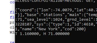

    To obtain results in °C, please add your choice of unit to the query:
    Screenshot showing JSON code and data processing result. .

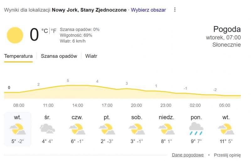

    Slightly better, is it really one degree in New York now?
    Current weather forecast for New York, showing temperature, chance of precipitation, and wind speed. .
    Well, almost. Let's just say it's right.

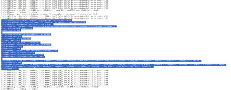

    Starting on the microcontroller (here for the BK7231 example) .
    In the case of the BK7231 I mainly had to include other headers, here the sockets are provided by the aforementioned LWIP:
    Code: C / C++
    In addition, I had to put the whole thing in a thread, because the send, recv and even connect operations are blocking here:
    Code: C / C++
    The result (on my OBK platform):
    Screenshot displaying the results of an application retrieving weather data from OpenWeatherMap using an HTTP request. .
    The JSON is correctly received, it is now left to parse it as desired.
