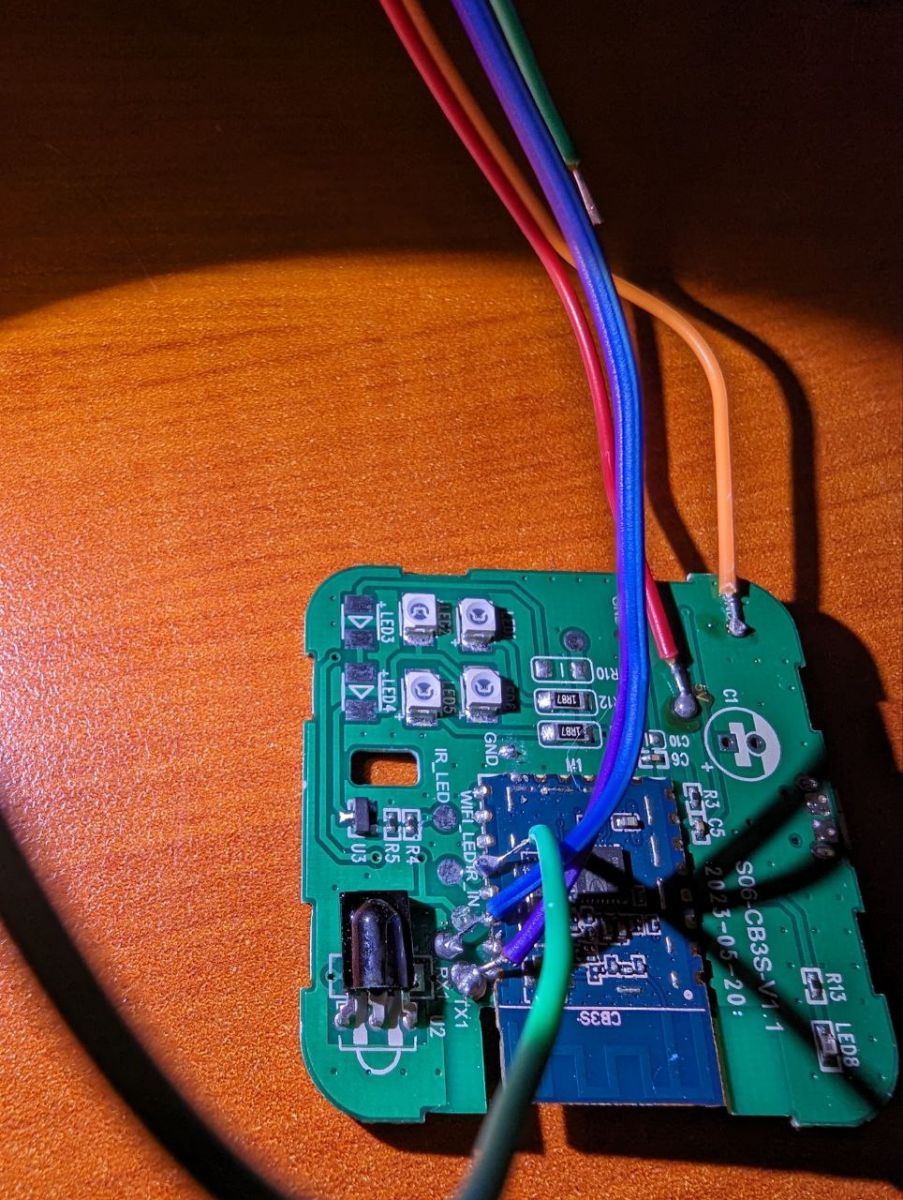

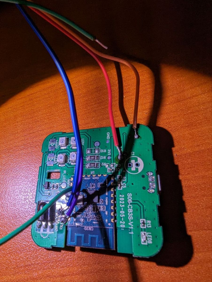

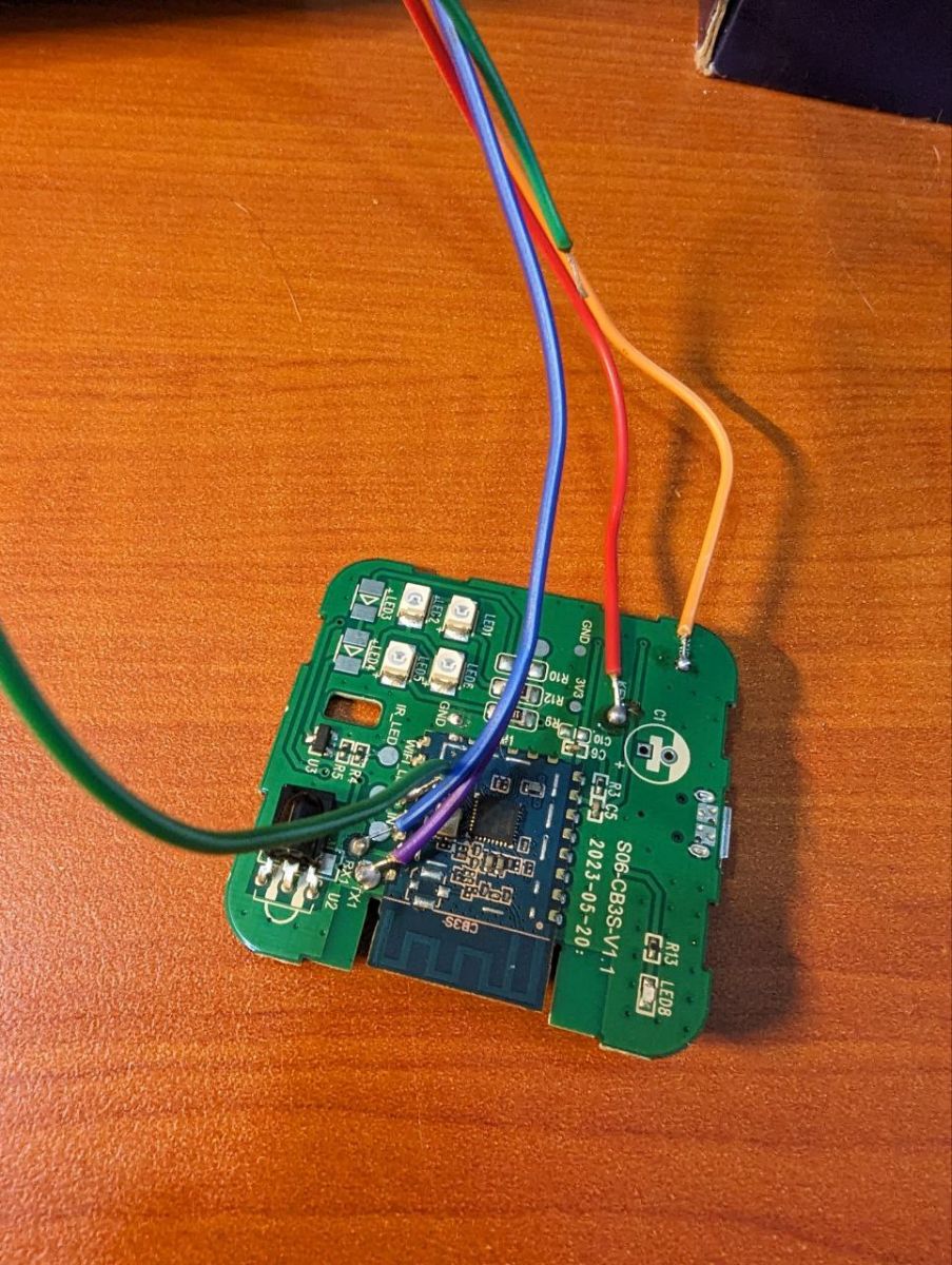

    This device can be bought from: https://www.aliexpress.com/item/1005003177081....order_list.order_list_main.95.21ef1802A6eGob. I think this blaster is an older revision of another blaster that has already been torn down and documented on this website: https://www.elektroda.com/rtvforum/topic3983995.html
    ## Flashing

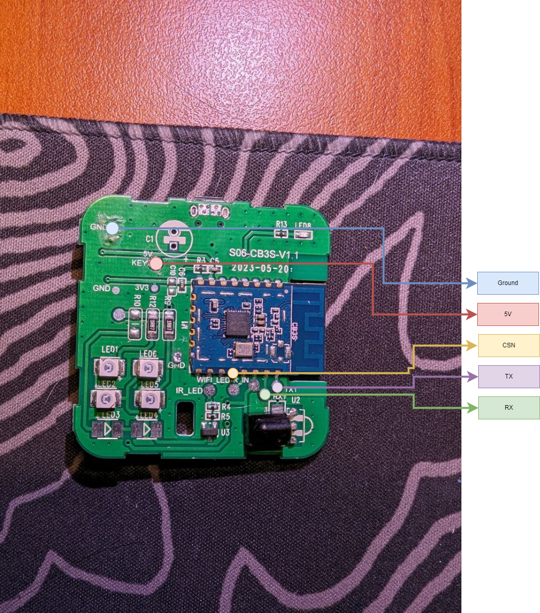

    I know I soldered the CSN pin but I didn't have any luck flashing it by grounding the CSN pin. I had to cut power off to the board momentarily. Other than that, I had no issues at all backing up the original firmware and rewriting the new one.
    ## Pin Configuration
    After some testing and following the traces on the PCB, I've found the following mapping works for the IR blaster, receiver, and the reset button.

    CSN method also doesn't seem reliable for me. I always do just the power on/off cycle.
    Thanks for the config. I will add it to templates list.
