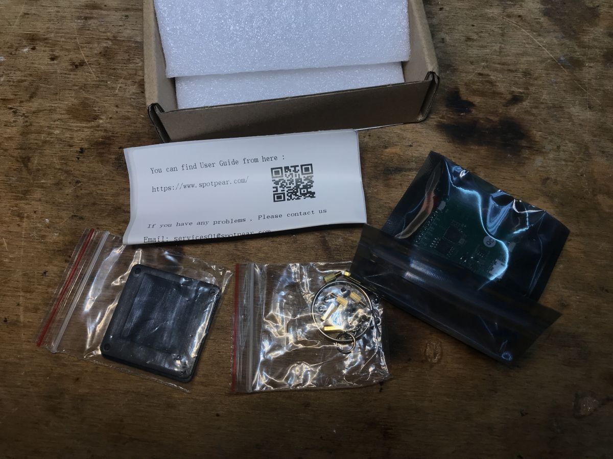

    Box with label of ESP32 C3 module with display Small brown box with a label and CE mark. .
    Also included is a simple case based on spacers and a key fob:
    ESP32-C3 module kit with accessories in packaging. .
    The attached sticker (why sticker?) with QR code refers us to information from the vendor .
    Informational leaflet with contact details and QR codes from Spotpear .

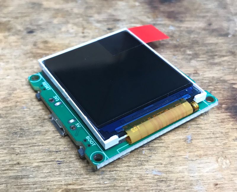

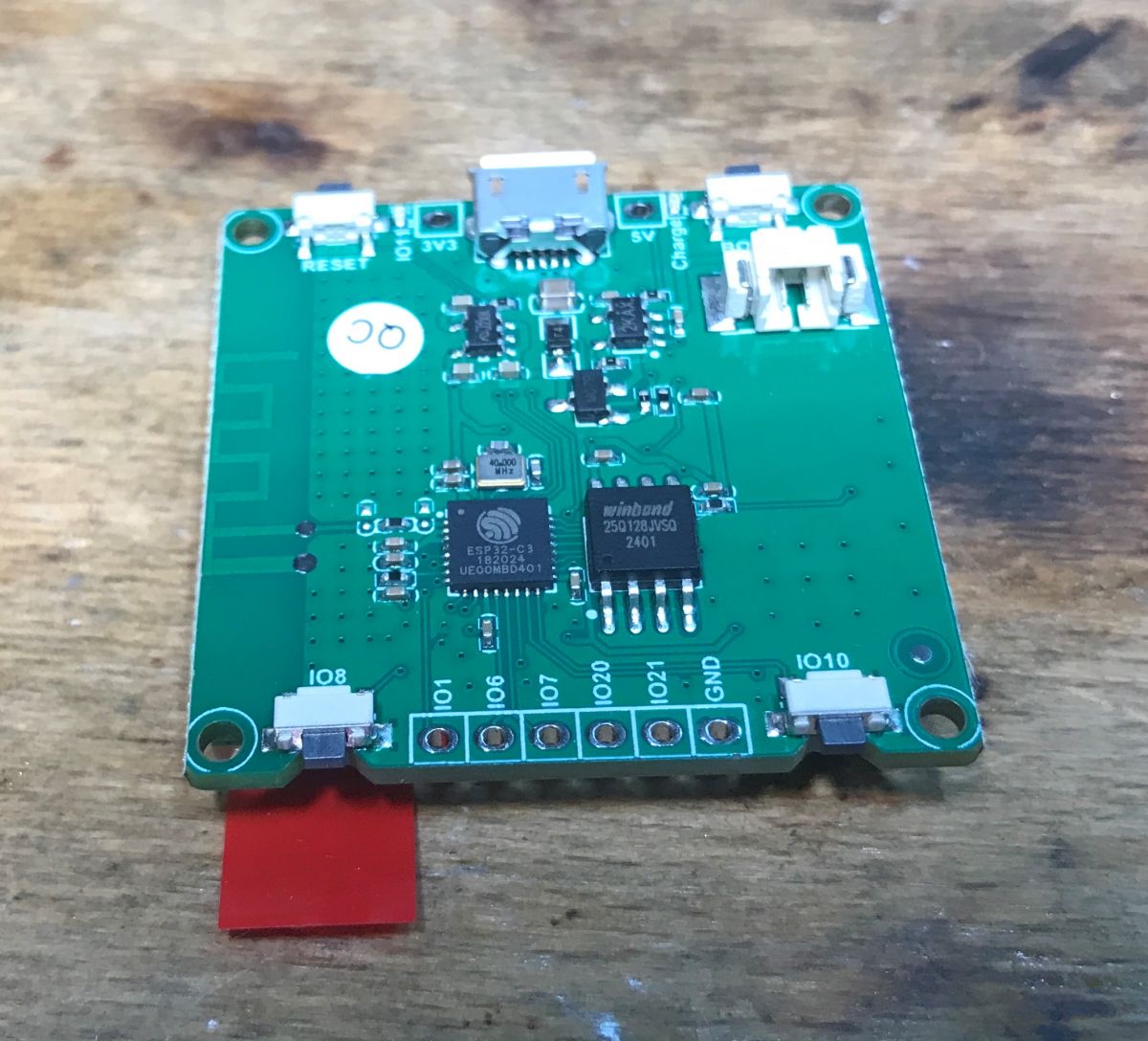

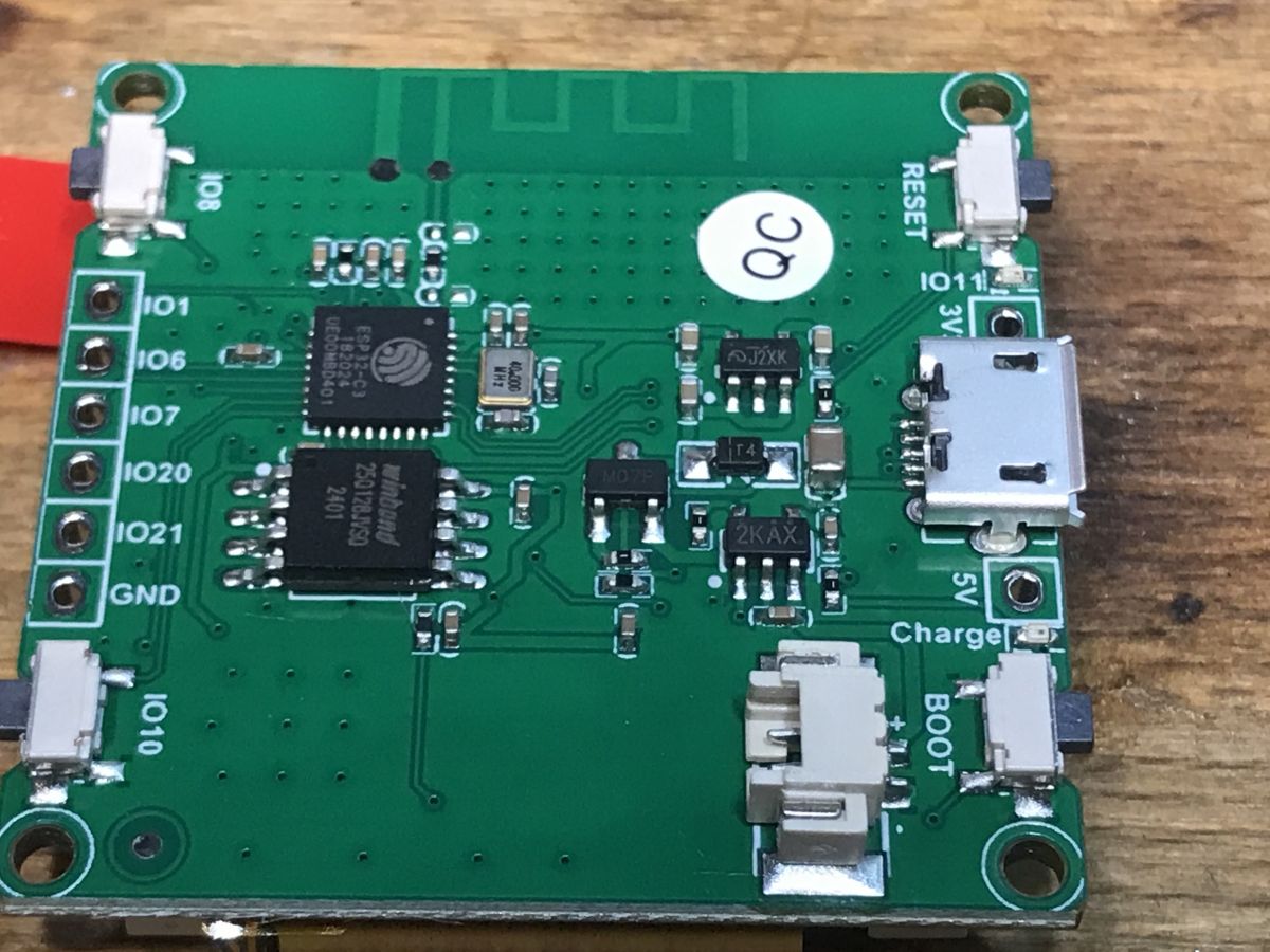

    And here is the module itself:
    Close-up of a PCB with electronic components, including a micro USB socket, integrated circuits, and I/O connectors. LCD display module on a wooden table. Image of a green circuit board with an ESP32-C3 and Winbond chip. Close-up of a circuit board with an ESP32-C3 microcontroller and Winbond chip. .

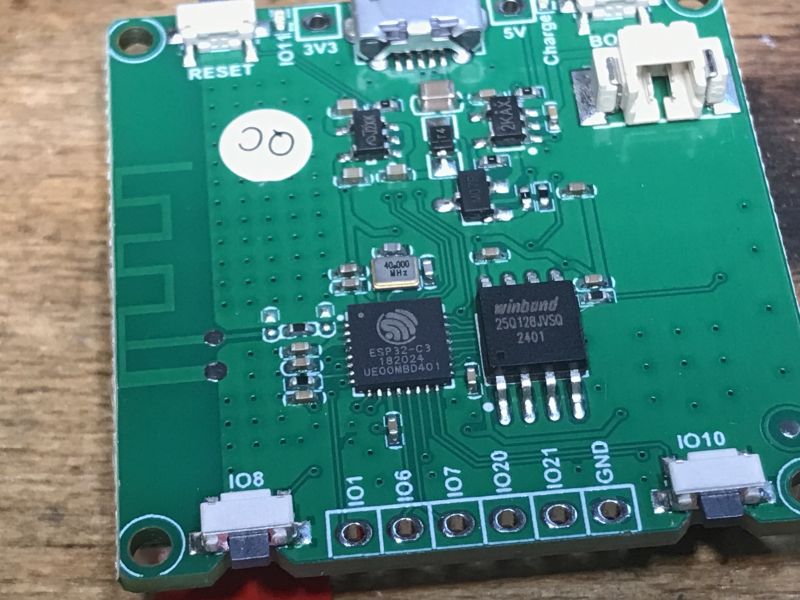

    In addition to the classic BOOT (bootloader mode) and RESET buttons, here we also have two additional buttons on IO8 and IO10, as well as having pads from several pinouts.
    You can see the 25Q128JVSG memory (all 16MB of it) and of course the ESP32-C3. There is also a 1.27mm connector for connecting a Li-Ion cell and a micro USB connector.

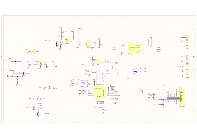

    Information from the vendor leads to a short tutorial/documentation at:
    https://spotpear.com/wiki/ESP32-C3-desktop-tr...ortable-Pendant-LVGL-1.44inch-LCD-ST7735.html

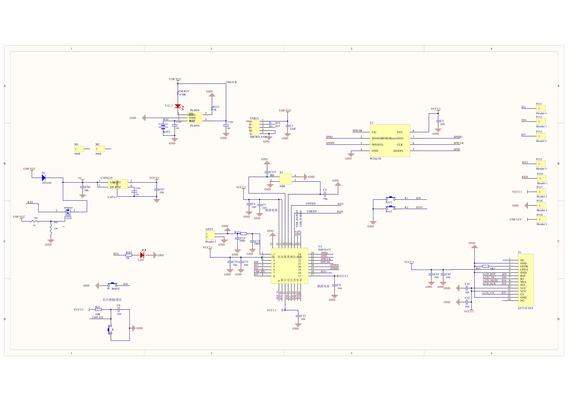

    Diagram:
    Schematic of the ESP32 C3 module with ST7735 display .
    Li-Ion battery support is handled here by the PL4054. 3.3V (with 5V from USB) is provided by the CAT6219. Flash memory is, as mentioned, the W25Q128, and the display.... you know

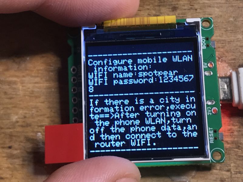

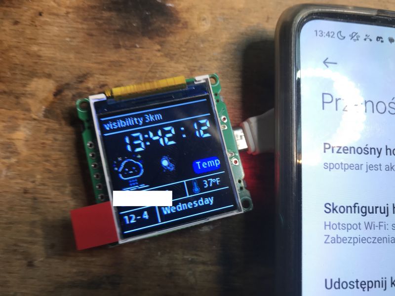

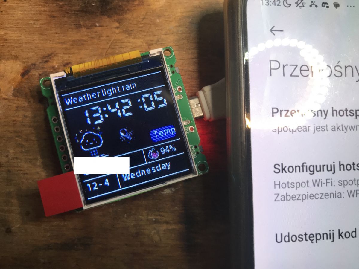

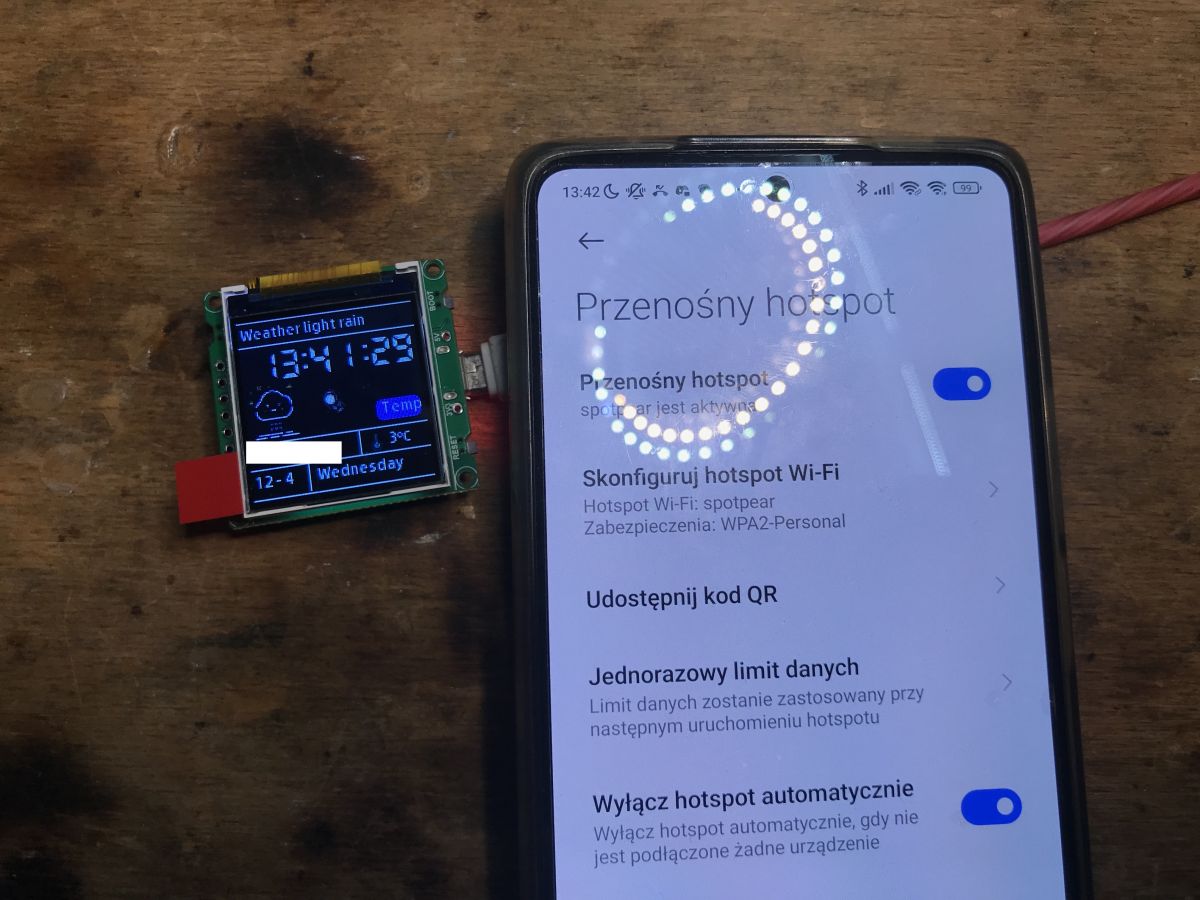

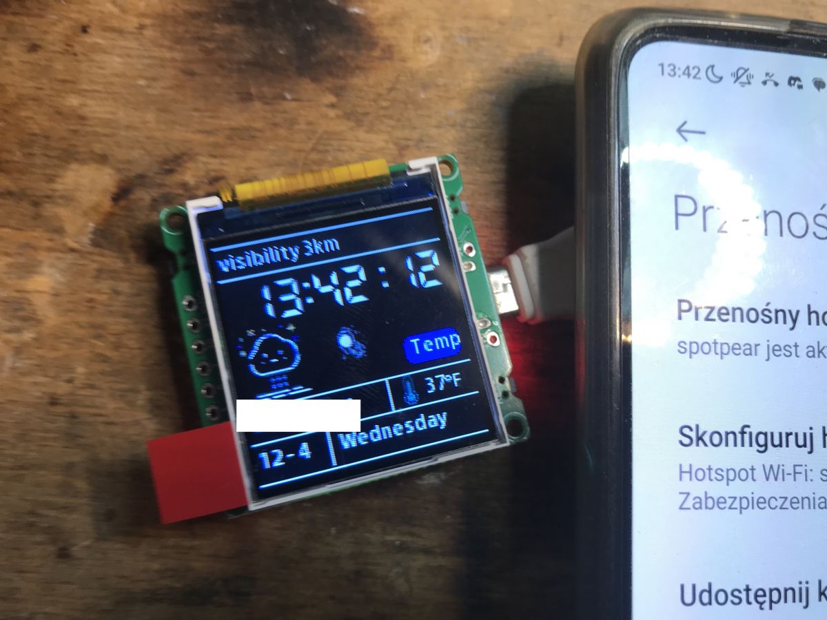

    Demonstration program .

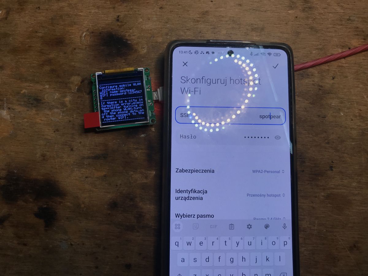

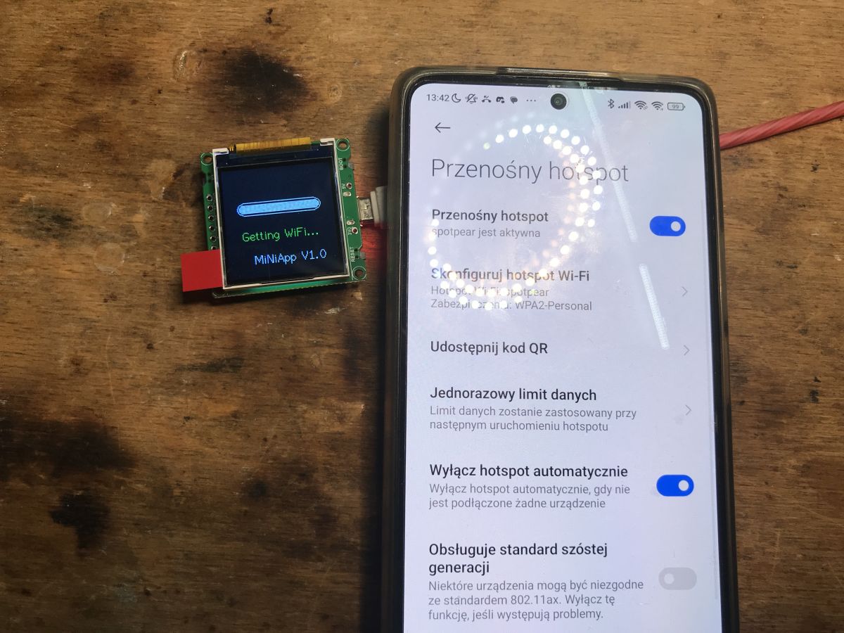

    The demonstration program is pre-loaded on the board and displays the image as soon as power is applied:
    Module displaying WLAN setup instructions on a small screen. .
    I couldn't find an English-language manual for its use on the web, but basically it just requires a WiFi access point to be set up on our phone with the data:
    spotpear
    12345678
    It then connects to it and then downloads weather information for our location via our phone's internet connection:
    ESP32 C3 module with display and phone set up as a Wi-Fi hotspot ESP32-C3 module with a display next to a smartphone set as a WiFi hotspot. ESP32-C3 module with display and smartphone with Wi-Fi hotspot settings. .
    The top bar successively displays the downloaded data.
    ESP32 C3 display showing weather data next to a smartphone with hotspot settings. ESP32 C3 module with a color display next to a phone. Miniature ESP32-C3 display module showing weather information next to a phone. .

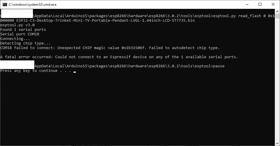

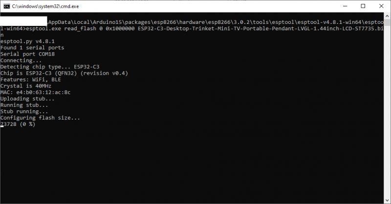

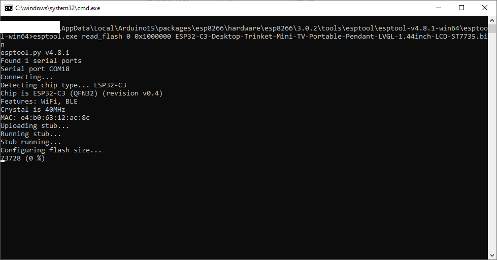

    Flash copy and error Unexpected CHIP magic value 0x1b31506f .
    To start with I started by making a copy of the original factory program and by then I had already encountered the problem. I used my tried-and-tested esptool.py, which I installed once along with the ESP support for Arduino:
    esptool.py read_flash 0 0x1000000 ESP32-C3-Desktop-Trinket-Mini-TV-Portable-Pendant-LVGL-1.44inch-LCD-ST7735.bin
    pause
    However, this esptool does not recognise this board:
    Screenshot of esptool.py error message .
    This is because it is version 3.0.2, as indicated by the path itself:
    esp8266\hardware\esp8266\3.0.2\tools\esptool
    Therefore, it is better to download the latest esptool from Github - you can already in exe form:
    https://github.com/espressif/esptool/releases
    The newer esptool-v4.8.1-win64.zip was able to rip the batch without any problems .
    Screenshot of a terminal during esptool operation. .
    esptool.exe read_flash 0 0x1000000 ESP32-C3-Desktop-Trinket-Mini-TV-Portable-Pendant-LVGL-1.44inch-LCD-ST7735.bin
    pause

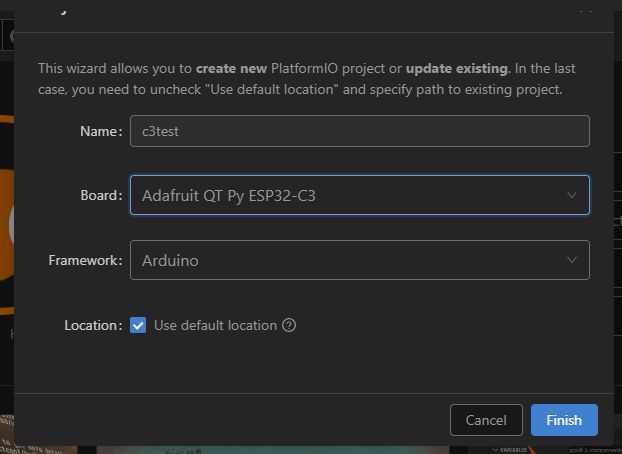

    I have created a new project. I couldn't find this particular one from the topic in the boards, so I used another one from ESP32-C3.
    PlatformIO wizard window for creating a new project for Adafruit QT Py ESP32-C3. .

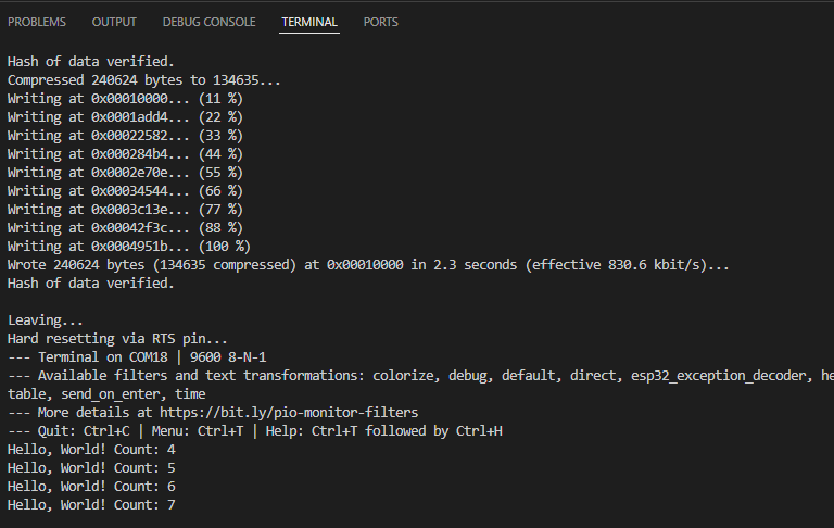

    To start, I ran the UART alone, without the display.
    Code: C / C++
    My platformio.ini
    [env:adafruit_qtpy_esp32c3]
    platform = espressif32
    board = adafruit_qtpy_esp32c3
    framework = arduino
    One call to "Upload and Monitor" later, everything started working as expected:

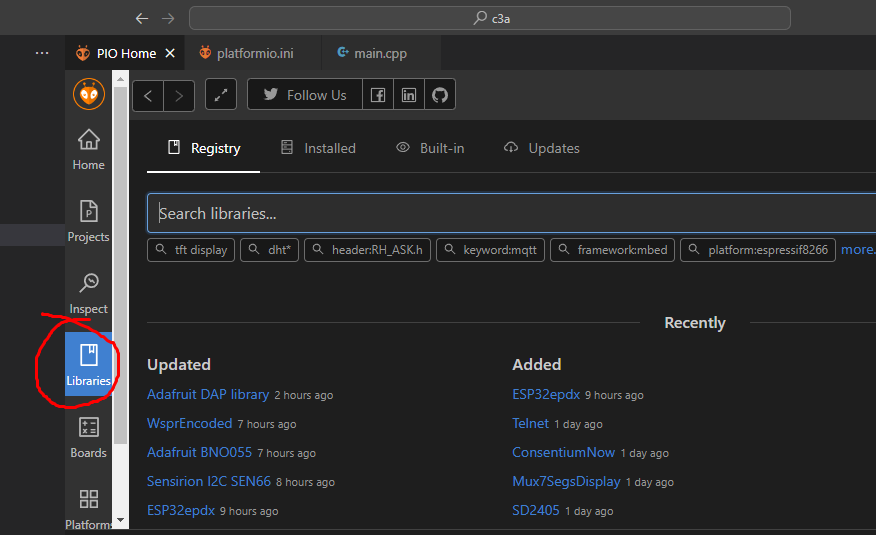

    You will need two libraries for this:
    - adafruit/Adafruit ST7735 and ST7789 Library .
    - adafruit/Adafruit GFX Library .
    These can be added via the PlatformIO GUI:
    Screenshot of the PlatformIO interface with the Libraries tab open and a menu icon highlighted on the left. .
    ... or simply add them to our platformio.ini and PIO will download them itself:

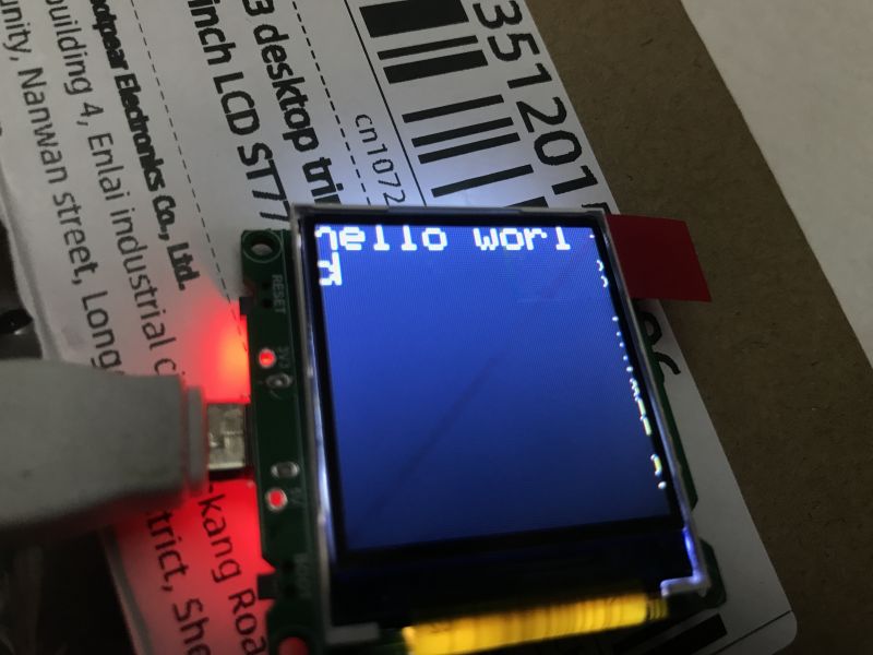

    Then we can start Hello World ST7735. Here it is important to set the pin indices appropriately, as they may differ between modules:
    Code: C / C++
    Here we have in sequence:
    - Adafruit_ST7735(int8_t cs, int8_t dc, int8_t mosi, int8_t sclk, int8_t rst) - runs the display in software SPI mode (bit-bang).
    - tft.initR(INITR_BLACKTAB) - initializes display with appropriate configuration for ST7735
    - tft.fillScreen(color) - fills the entire screen with the specified colour
    - tft.setCursor(x, y) - sets the cursor position
    - tft.setTextColor(color) - sets text colour
    - tft.setTextSize(size) - sets text size
    - tft.print(text) - displays the text at the current cursor position
    Result:
    Small LCD display connected to an ESP32-C3 module showing hello world text..

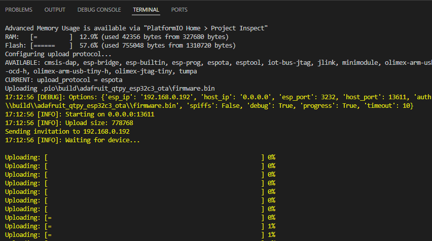

    Updating the batch over the network .
    Let's not forget the Arduino OTA - I've already presented it here, among others:
    How to program a Wemos D1 (ESP8266) board in the shape of an Arduino? ArduinoOTA in PlatformIO .
    Let's modify my project to add a remote update. New PlatformIO.ini:
    framework = arduino
    lib_deps =
        ArduinoOTA
    [env:adafruit_qtpy_esp32c3_ota]
    extends = env:adafruit_qtpy_esp32c3
    upload_protocol = espota
    upload_port = 192.168.0.192
    New code:
    Code: C / C++

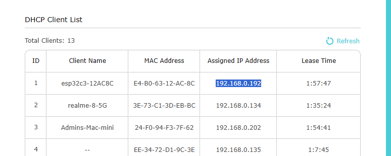

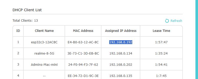

    The added ArduinoOTA.begin(); initiates the OTA system, and in turn the regular call ArduinoOTA.handle(); that handles the update itself is equally important.
    After the first upload, we check the board's IP on the router and enter it into the aforementioned platformio.ini:
    Fragment of DHCP client list showing assigned IP addresses .

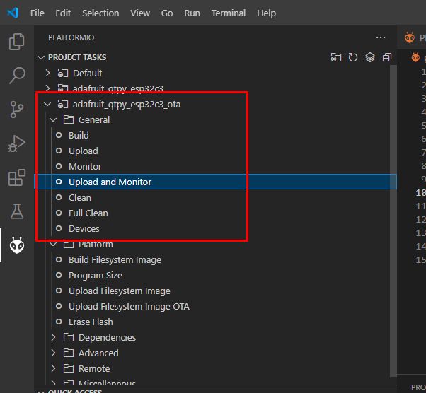

    Now we have two task groups on the sidebar, we start the upload from the OTA group:
    Screenshot of the PlatformIO interface in Visual Studio Code with highlighted Upload and Monitor tasks. .
    The programme is updated remotely:
    Terminal showing firmware update progress on ESP32-C3. .

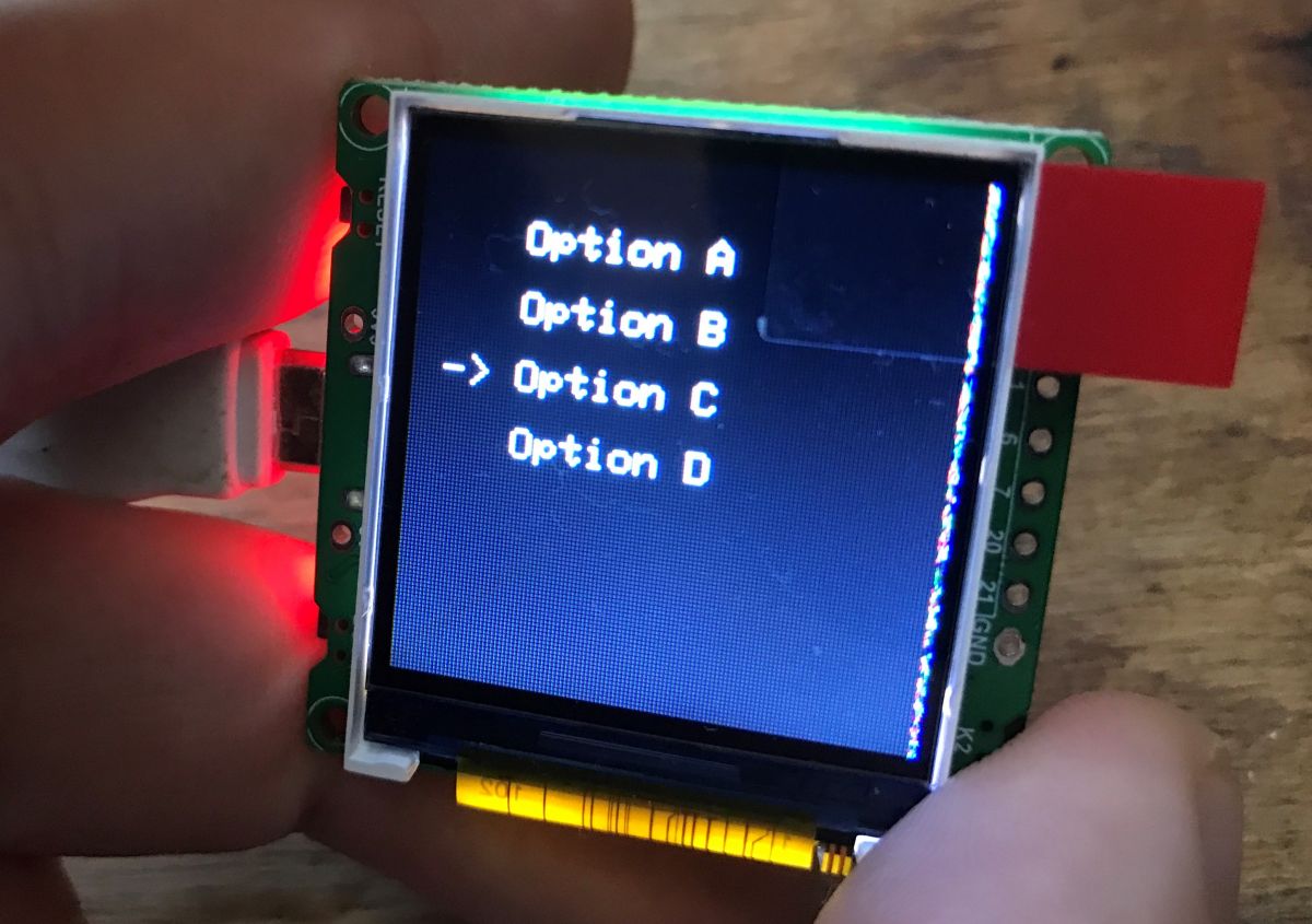

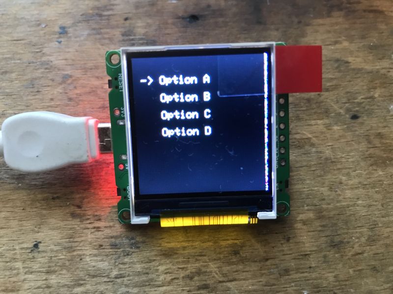

    Buttons and their operation .
    Finally, it is worth showing the use of the buttons on pins IO8 and IO10. In the simplest version, you can use pinMode and the usual digitalRead to operate them. I won't worry about contact vibration here, I will solve the problem by adding a blocking delay in the code. Menu navigation, for example, can be implemented based on these buttons:
    Code: C / C++
    The above code could be significantly improved, first of all by removing the blocking delay , as well as by optimising the display of the menu - instead of drawing it all over again every time, you could just paint over the arrow and draw it in a new place. The result:
    ESP32 C3 module with a 1.44-inch LCD display and on-screen menu. Small module with LCD display showing menu options. .

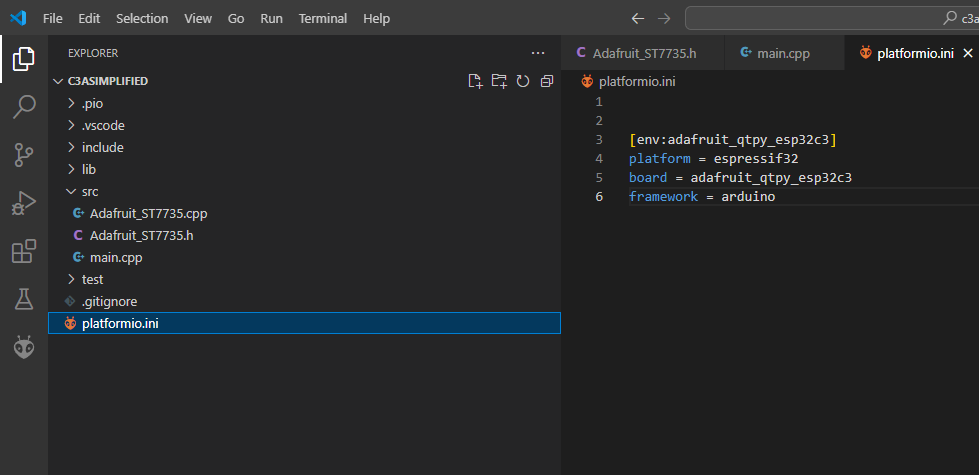

    Much simplified ST7735 support library in one file/project .
    Here without much commentary, but maybe someone will find it useful.
    I wanted to get more familiar with the ST7735 support, and I reworked myself a library from Adafruit so that it has just 600 lines of code and in C style (no class). The whole thing only supports software SPI (bit-bang) and can only draw simple shapes, there is no font. Everything is in one PlatformIO project:
    View of Visual Studio Code editor with an open platformio.ini file for the ESP32 C3 project. .
    My simplified demo:
    Code: C / C++

    Thank you so much for this tutorial, you made me buy this device and I am really happy with it.
    I have one remark. With this setup, there are some anomalies that I see on my device, as well in your videos.
    - on the right side, there is a column of pixels not filled;
    - on the left and upper side there are 2 rows / columns of pixels not visible. You should set cursor to 2,2 in order to clear see the text. "Benchmark" is clear visible, "hello world" not;
    - the function tft.height() return 160 instead of 128. In your examples, the clock is not in the center, but a little down.
    - colors are 5-6-5 but with red on the least significant 5 bits and blue on the most significant 5 bits. For example tft.fillScreen(ST77XX_RED) will fill the screen with blue. Your clock hand is blue, green, red, cyan, starting from first quadrant, instead of red, green, blue, yellow as expected.
    The good news is that all of this can easily be fixed by using
    tft.initR(INITR_144GREENTAB);
    instead of
    tft.initR(INITR_BLACKTAB);
    (this is for 1.8" screen).

    That would be amazing! LVGL setup for this specific board is what I'm failing to achieve or find information about. I’d really appreciate it if you could help, but I’d feel bad making you go through all that effort.
    Added after 1 [hours] 20 [minutes]:
    We've just managed to make LVGL work on the device using the Adafruit ST7735 and ST7789 Library you mentioned. The problem was the TFT_eSPI alternative Spotpear was using in their project. Unfortunately, the refresh rate with Adafruit's library is really slow for our project. We're trying to make it work with TFT_eSPI which is supposed to be much faster.
