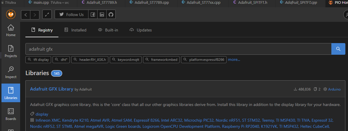

    Adafruit offers an off-the-shelf solution to support this display, but you must first configure it properly.
    Install first Adafruit_GFX (common graphics base) and then Adafruit_ST7798 :
    PlatformIO search window with adafruit gfx query. .

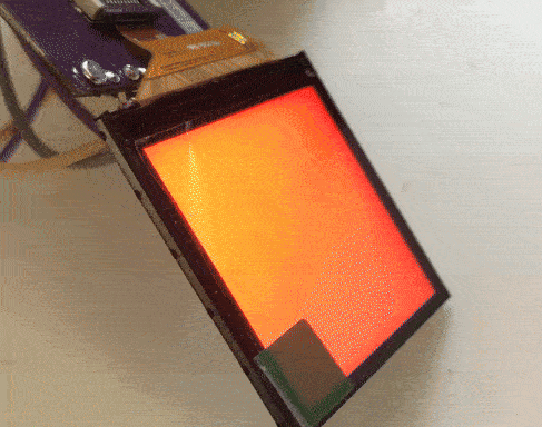

    I alternate the screen between two colours for demonstration in a loop:
    Code: C / C++
    ST77XX_RED and ST77XX_GREEN are predefined colour values from the presented library, later I will show how to generate my own RGB.
    Full code:
    Code: C / C++
    Result:

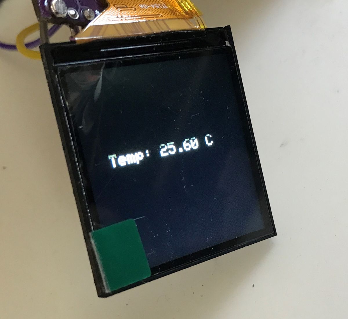

    The library from Adafruit, however, offers much more. For example, it already has fonts uploaded, so you can also display text. First position the cursor on the screen, and then display the subtitles one by one. You can also display a number. Everything is done automatically, the cursor also moves itself.
    Code: C / C++
    Here is an example program displaying some random temperature value on the screen:
    Code: C / C++
    Result:
    2.5 display showing temperature 25.6°C

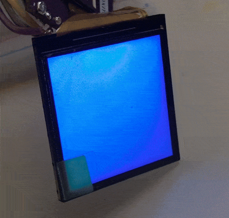

    However, let's not forget that this display is in colour. The function tft.colour565 creates a 16-bit colour code for R, G and B data from the ranges [0,255]. For demonstration purposes, I have developed a simple colour loop generation based on sine functions:
    Code: C / C++
    Result:
    LCD display changing colors from blue to green .

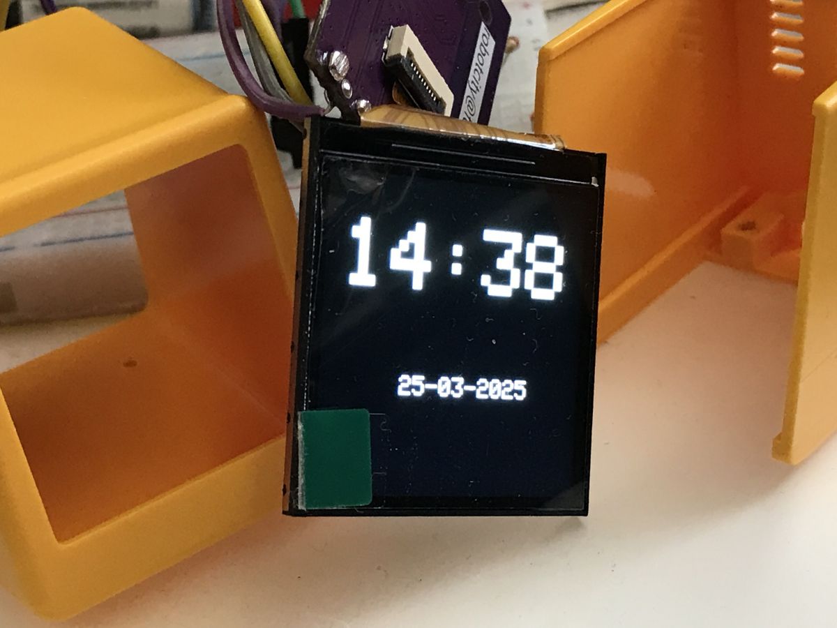

    The clock from Adafruit_ST7789 .

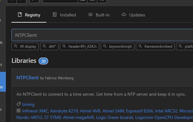

    You can also create a simple clock. We will need a client for the NTP service, or Network Time Protocol. It will retrieve the current date and time from the Internet. We install the NTPClient:
    PlatformIO user interface with a search for the NTPClient library. .

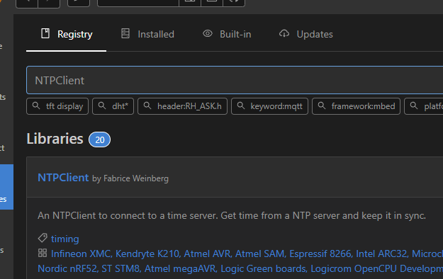

    In addition, we similarly install TimeLib to be able to process time more conveniently and extract a bit more information from the time_t type.
    We include the headers:
    Code: C / C++
    We create objects:
    Code: C / C++
    In the constructor, the address of the NTP server from which we retrieve the time is given. It remains to run the client:
    Code: C / C++
    and updating it:
    Code: C / C++
    Now the time needs to be displayed. In order to reduce screen flashing, I added a condition in the refresh so that it only executes when the current minute changes. I retrieve the time from the NTP client in epoch form (time_t) and then extract the individual date and time values from it.
    Code: C / C++
    It is worth noting the use of tft.printf, this function allows you to format the displayed text just like a normal printf. These 02 means that we want two-digit values.
    The result:
    Small display showing time and date. .
    The full downloadable project is at the end of the topic.
