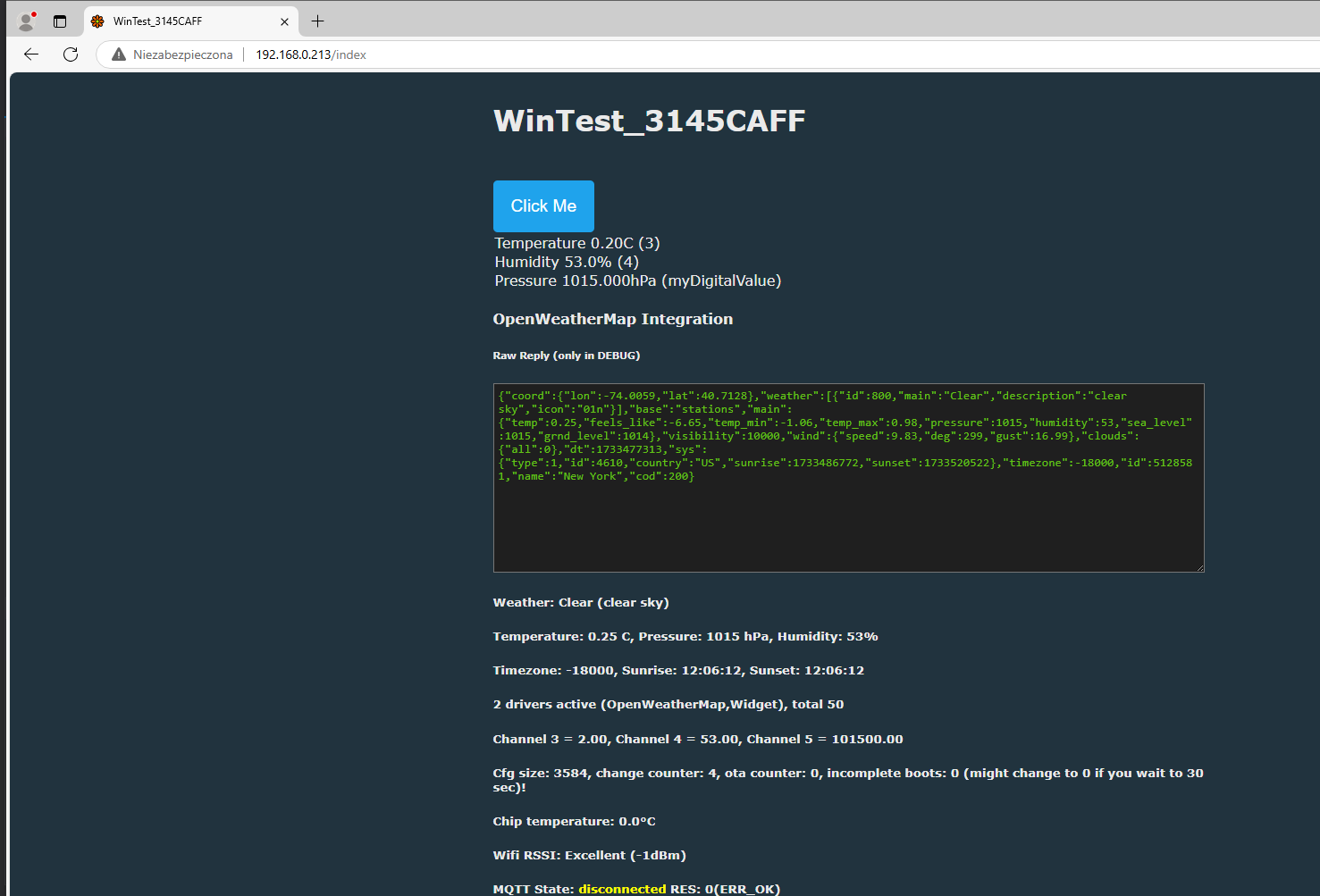

    I also did a OpenWeatherMap integration
    Hi, I cannot get it to work. OBK log:
    Info:CMD:[WebApp Cmd 'owm_setup xx.2826381 yy.0207111 a0......f4' Result] OK
    Error:HTTP:GET /data/2.5/weather?lat=xx.2826381&lon=yy.0207111&appid=a0......f4&units=metric HTTP/1.1
    Host: api.openweathermap.org
    Connection: close
    Internet is ok, for the first hour the api returned a 401 json error (should wait for the API key to be activated), and it was visible in the OBK log.
    If I try it in the browser, result is ok
    https://api.openweathermap.org/data/2.5/weather?lat=xx.2826381&lon=yy.0207111&appid=a0......f4&units=metric%20HTTP/1.1

    #4 21335335
    Posts: 14771
    Rate: 12914
    That's very strange. It works on my side.
    Webpage displaying OpenWeatherMap integration test results.
    Screenshot of a command console showing weather information and debugging data from the OpenBeken program.
    My LittleFS content, autoexec.bat:
    startDriver OpenWeatherMap
    owm_setup 40.7128 -74.0060 d6fae53c4278ffb3fe4c17c23fc6a7c6
    setChannelType 3 Temperature_div10
    setChannelType 4 Humidity
    setChannelType 5 Pressure_div100
    // temperature humidity pressure
    owm_channels 3 4 5
    owm_request
    Note: this will NOT WORK on physical device without adding a DELAY or WAITFOR to wait for WiFi connection

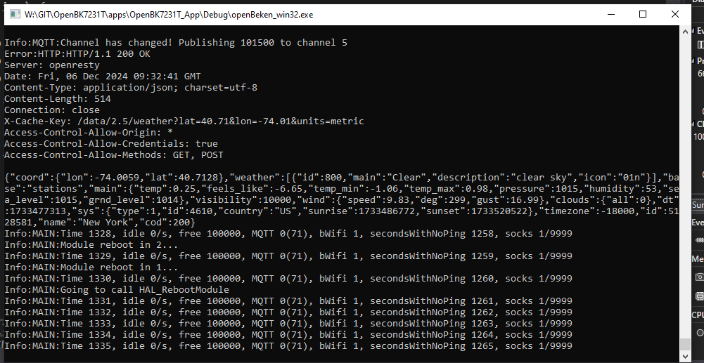

    XJ_
    Posts: 141
    Help: 13
    Rate: 39
    use it anyway you want.
    It's some kind of "free" APIID, because the free APIID has a limit of, as far as I know, 1000 requests, after which it's paid.
    Added after 13 [minutes]:
    I found the reason, I didn't count on this not being an error:
    Error:HTTP:GET /data/2.5/weather?lat=40.7128&lon=-74.0060&appid=d6..........6&units=metric HTTP/1.1
    I saw the error, and I didn't try anything else. The error is here below too, but it's OK.
    Error: HTTP/1.1 200 OK helped me find it. ;-)
    Info:CMD:[WebApp Cmd 'owm_request' Result] OK
    Error:HTTP:Resolved IP address: 57.129.2.123
    Error:HTTP:Rec 858
    Error:HTTP:HTTP/1.1 200 OK
    Server: openresty
    Date: Fri, 06 Dec 2024 13:24:54 GMT
    Content-Type: application/json; charset=utf-
  • #8 21335676
    Posts: 14771
    Rate: 12914
    That's a key made with throwaway mail.
    So what was the error? Or... you took the log message as error, I see. I need to comment out that logging or move it to EXTRADEBUG

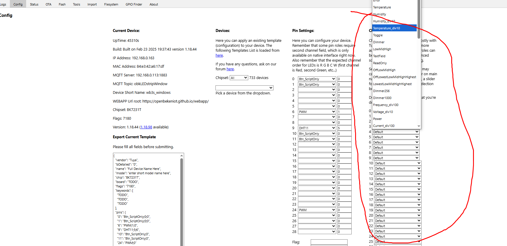

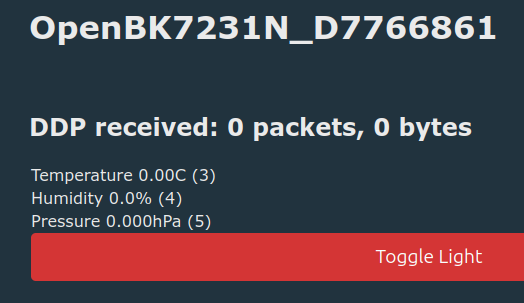

    cijoml
    Posts: 81
    >>21448888 Hello there is a bug managing weather plugin. I setup it without support within firmware, then removed it, however I still see remains in the UI
    Screenshot of OpenBK7231N control panel showing temperature, humidity, pressure readings, and a Toggle Light button.
  • #13 21538771
    Posts: 14771
    Rate: 12914
    This is not a bug, you just have still set channel types. You can change them back to Default in the Web App.
  • #14 21539199
    cijoml
    Posts: 81
    Where are those channels defined? I went through all settings and didn't find any. My autoexec.bat is free of those options
  • #16 21540489
    cijoml
    Posts: 81
    thank you it is removed now :). however I still think that there should be check whether functionality is present within fw and if not do not show it
  • Channel types are separate from drivers by design
    #17 21540493
    Posts: 14771
    Rate: 12914
    I'm afraid it's not really possible to do this, with a current design... channel types are totally separate from drivers. There are many drivers which can "write temperature" to given channel, or "write humidity", etc, etc. This is designed in such a way because we needed a common storage for data like that temperature and humidity so we can create scripts easily. Now also with Berry Scripting Language.
