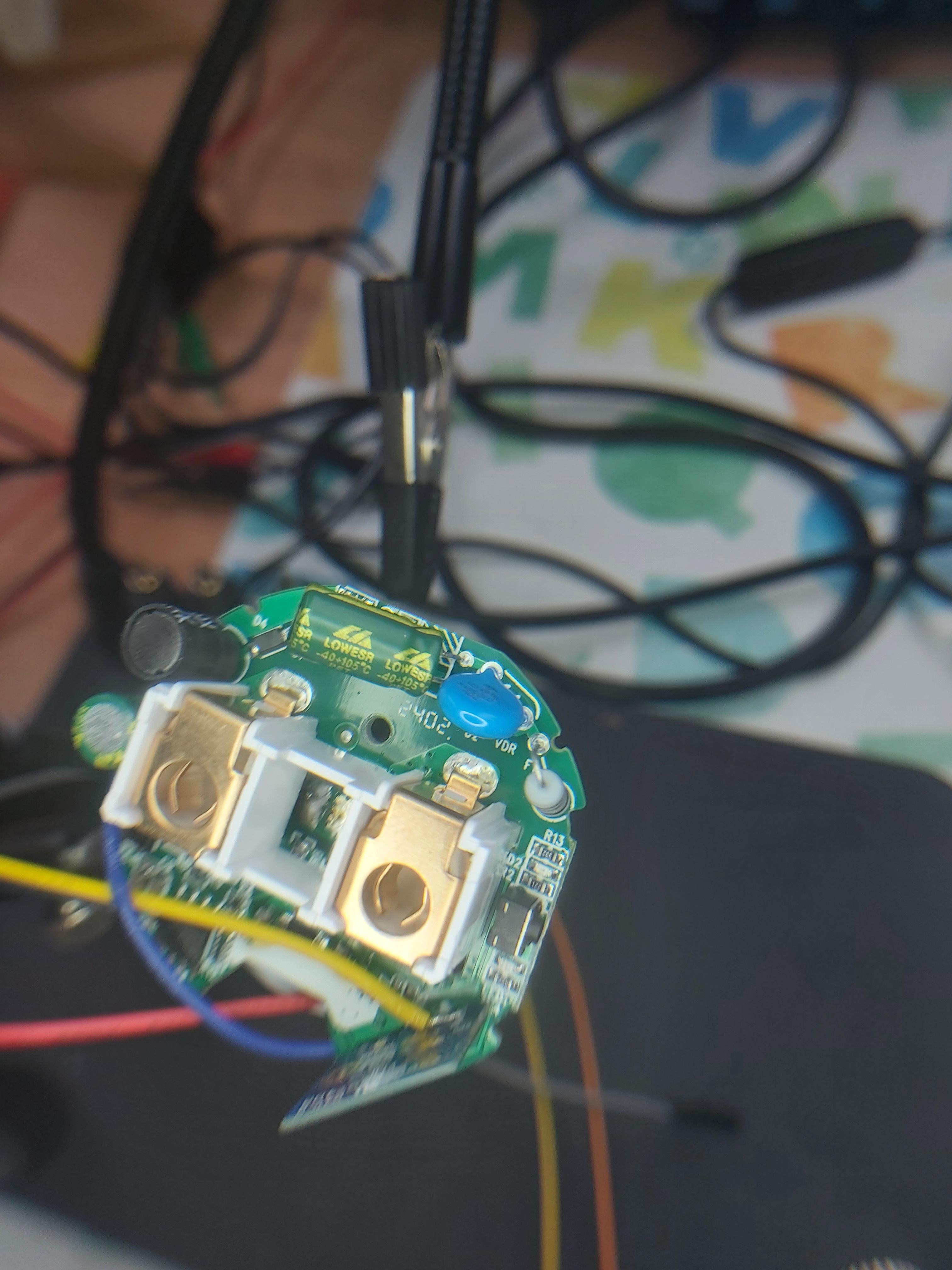

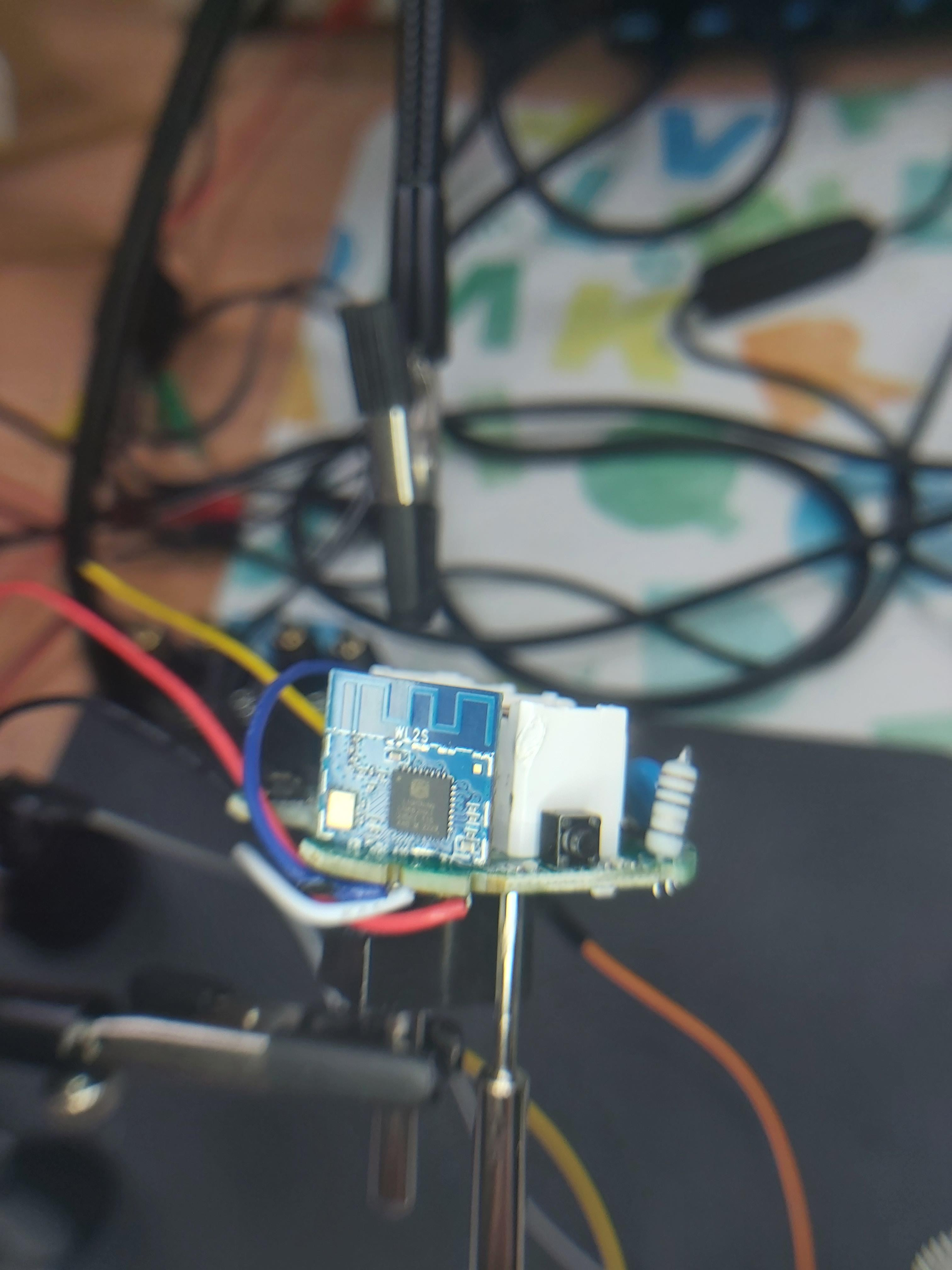

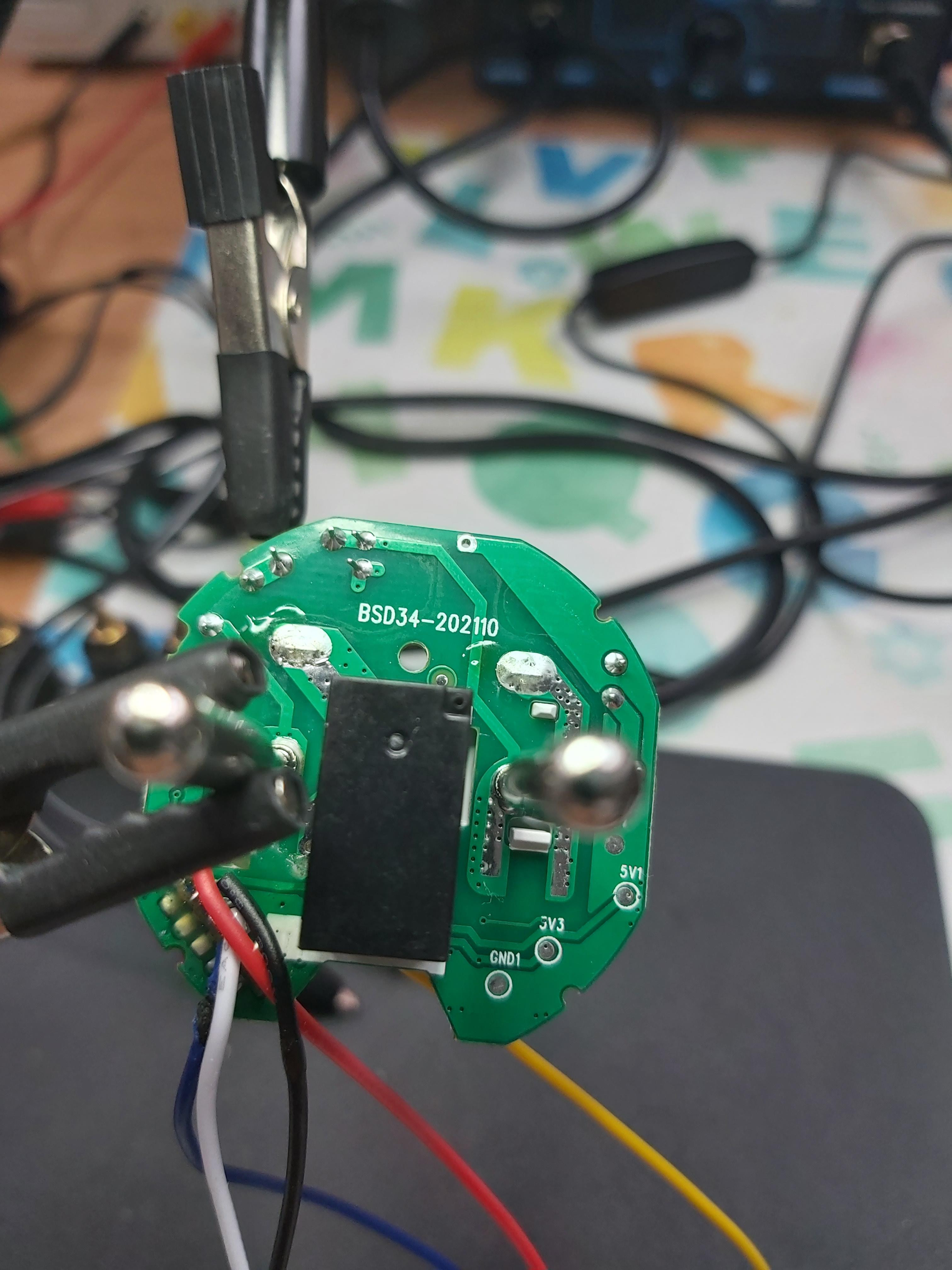

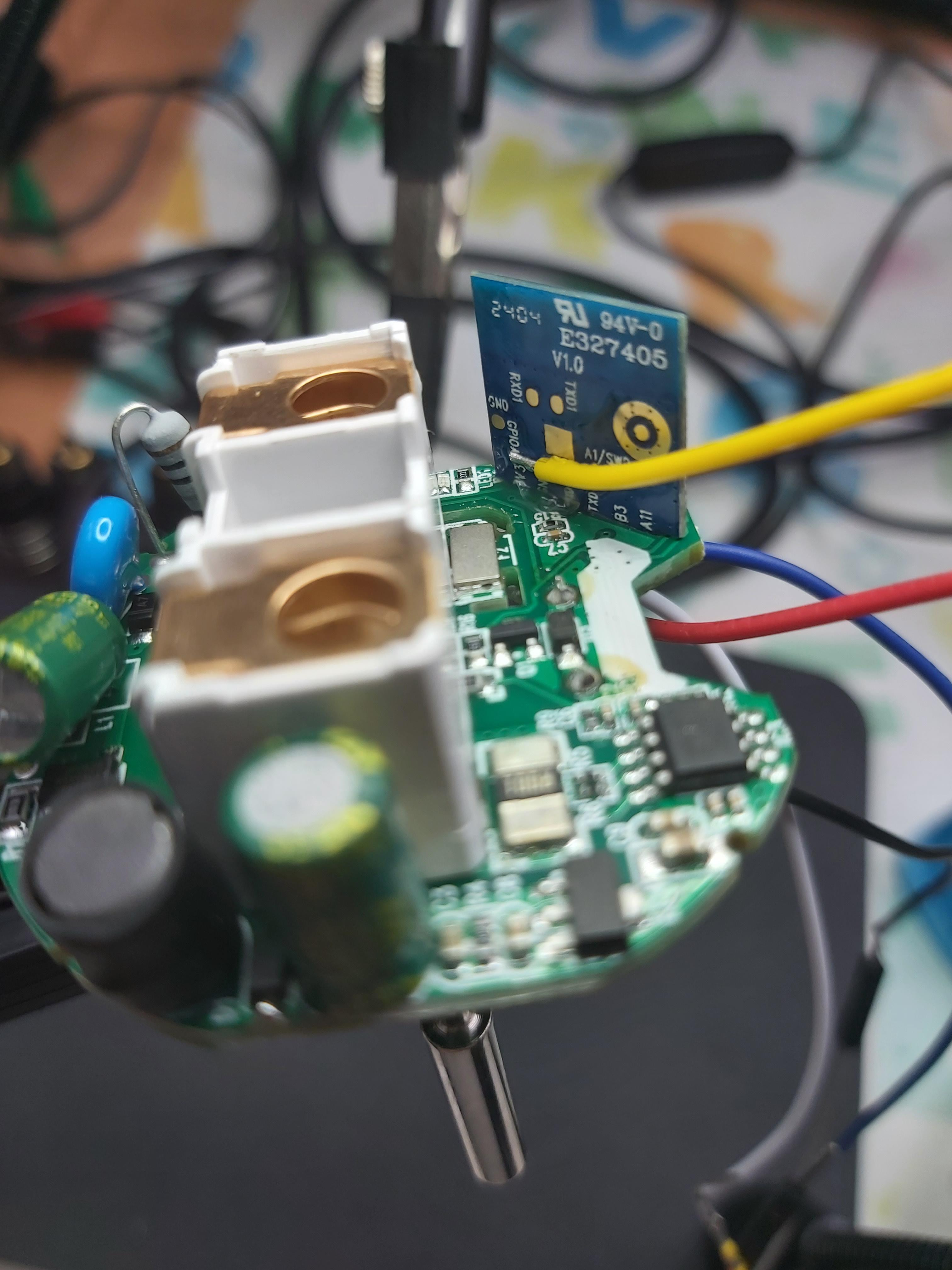

    Internal photos
    • Amazon SURFOU Type E Smart WiFi Socket: Alexa/Google Compatible, 16A, Tuya App Control 20241208_125332.jpg (933.99 KB) You must be logged in to download this attachment.
    • Amazon SURFOU Type E Smart WiFi Socket: Alexa/Google Compatible, 16A, Tuya App Control 20241208_125253.jpg (929.31 KB) You must be logged in to download this attachment.
    • Amazon SURFOU Type E Smart WiFi Socket: Alexa/Google Compatible, 16A, Tuya App Control 20241208_125214.jpg (965.67 KB) You must be logged in to download this attachment.
    • Amazon SURFOU Type E Smart WiFi Socket: Alexa/Google Compatible, 16A, Tuya App Control 20241208_125200.jpg (779.76 KB) You must be logged in to download this attachment.

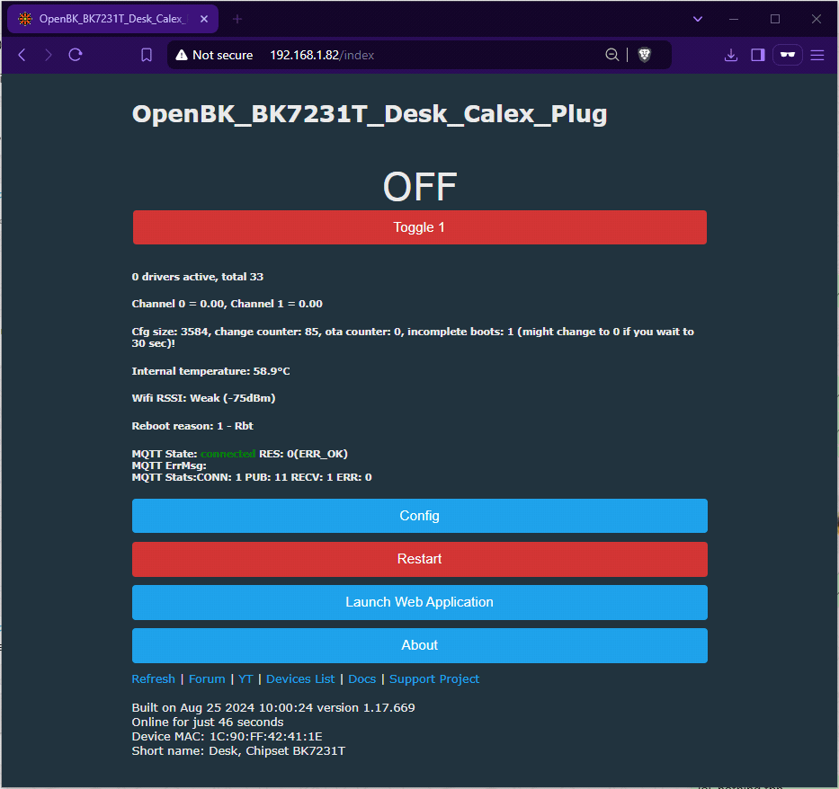

    I attached the Tuya config bin file from the web application, when I'm trying to import it to BK7231Flasher to extract the GPIO json an error appears. I think this application doesn't recognize LN882H format yet.
    How can I extract the GPIO template for this device?

    I'm afraid the Tuya config extraction feature is only for Beken based devices. Easy Flasher does not extract data from LN882H firmware backups.
    You've already worked out all the pin assignments and have a fully working device with OpenBeken?

    added. I do note though that it is almost the same as other LN882H BSD34 type devices in the device list.
    eg
    is it possible you've missed P0? Does using one of the other templates give you behaviour more like that of the factory firmware?
    https://github.com/OpenBekenIOT/webapp/commit/d307216cfb0a5445149a451aa61ad2a4c3554ffb
