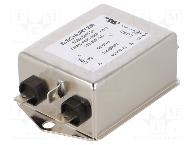

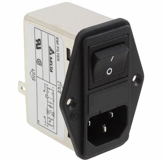

    Janusz_kk wrote:
    This is a better filter
    And such filters, either as stand-alone modules or integrated into the socket, can be bought without any problem:
    Schurter electrical filter shown on a white background. EMI filter module with a power switch and socket. .

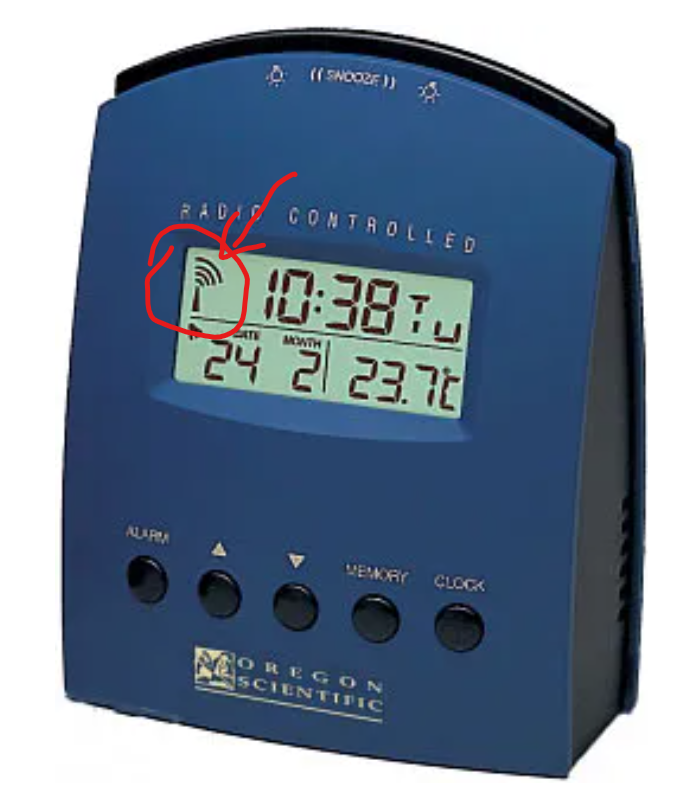

  • DCF77 watches can include reception quality indicator
    #23 21341209
  • #24 21341440
    -rafal-
    Posts: 141
    Help: 12
    Rate: 55
    For all those to whom DCF77 does not arrive, I recommend an app from the google shop: "DCF77 Emulator" emulates the DCF77 signal using a speaker coil.
    PS. Before you write that it has no right to work, first check ;) Only prerequisite is that the original DCF77 does not arrive, otherwise the frames will overlap and it will not work (I recommend testing in a metal box).
  • Most devices now add radio-band interference

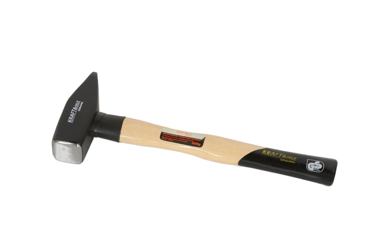

    There is only one "repair" method for such power supplies
    Hammer with a wooden handle and metal head by KRAFT&DELE. .

    Rate: 1672
    ledo99 wrote:
    >>21341818 Did he forget to say that you have to or did he forget to install ? - for me EMC/EMI filters are not optional and should be an integral part of the device.
    Some yes, some no. The manufacturer can write buy the A or B filter you prefer there, EMC meets with both, A meets the A standard, B meets the stricter B standard - buy what suits you. But it won't force you to buy any. At least I've seen inverters sold that way.
    What does the manual for the pump say?
    And the installer... Well, it was supposed to be cheap - it is cheap. It's supposed to be good? It's cheap. "Lord, nobody buys it, it's a rip-off from the EU, it's pointless, there's no interference, the standards are cheated, the earth is flat, after all you can see" :) :) :) after all we know how it works in practice. DPFs are bad too, and the ozone hole is a superstition like climate change.
