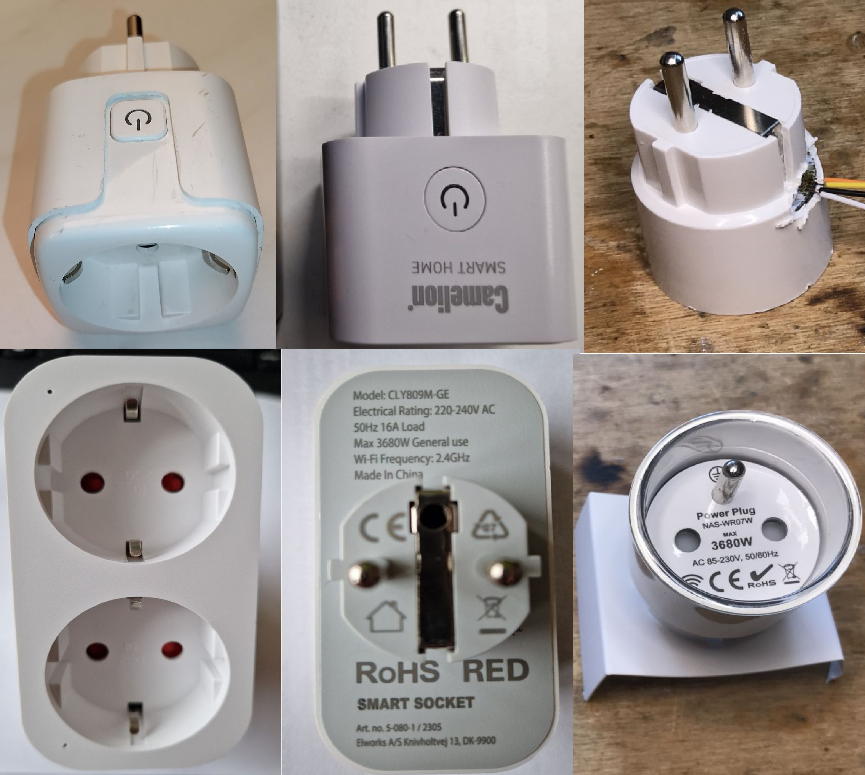

  • Various smart plugs and sockets for energy measurement. .
    Various types of plugs, modules and sockets that offer energy measurement and normally work with the manufacturer's cloud can be bought cheaply on the web. Here I will show how such a socket can be freed from the cloud and configured independently, including how events can be triggered when, for example, a given voltage value is exceeded, and how measurements can be visualised in the form of graphs held on the same device. This topic will not be about a specific device, but rather more generally about a group of devices manufactured in China and available for cheap purchase from portals with names often starting with 'A'....

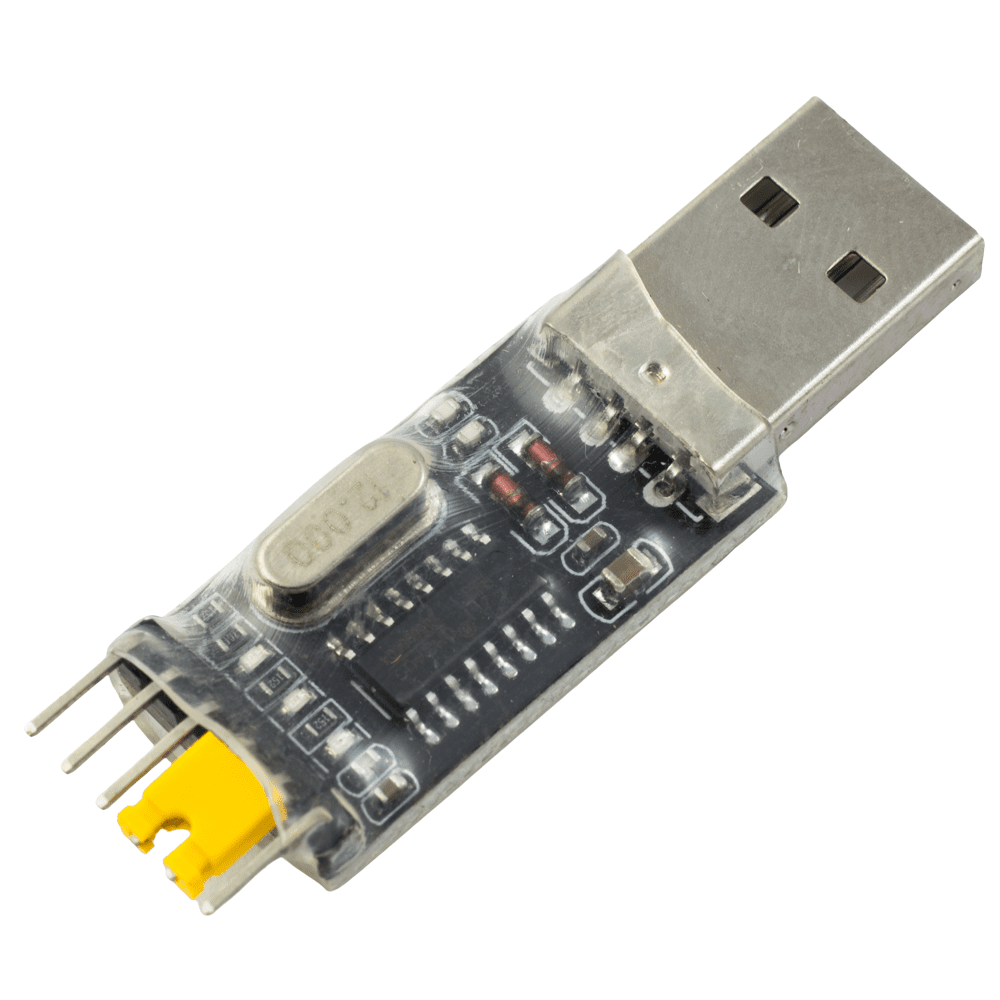

    The procedure for changing the firmware in each case requires a USB to UART converter:
    USB to UART converter with CH340 chip in a transparent plastic casing. .
    I am using the CH340 version. For this you will need an external power supply with a 3.3V LDO. The power supply from the CH340 is not sufficient, it does not have the current capacity.

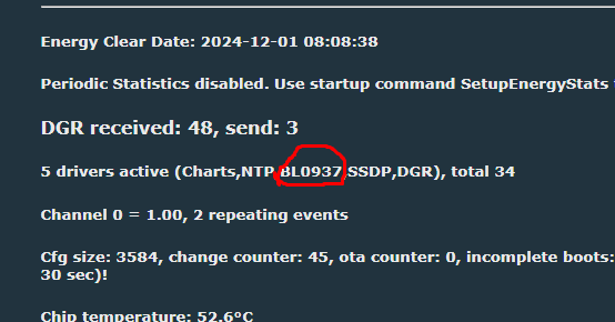

    In the case of BL0942, in the firmware itself, we enter the command:
    startDriver BL0942
    e.g. in autoexec.bat , and in the case of BL0937 it is sufficient to set the corresponding pin roles. In both cases it is worth performing a reboot. We will find out from the web panel that the controller has booted:
    Screenshot of device interface with active BL0937 driver. .

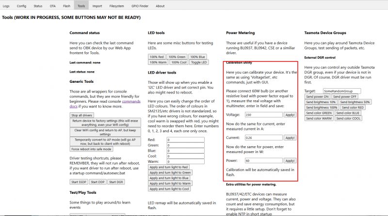

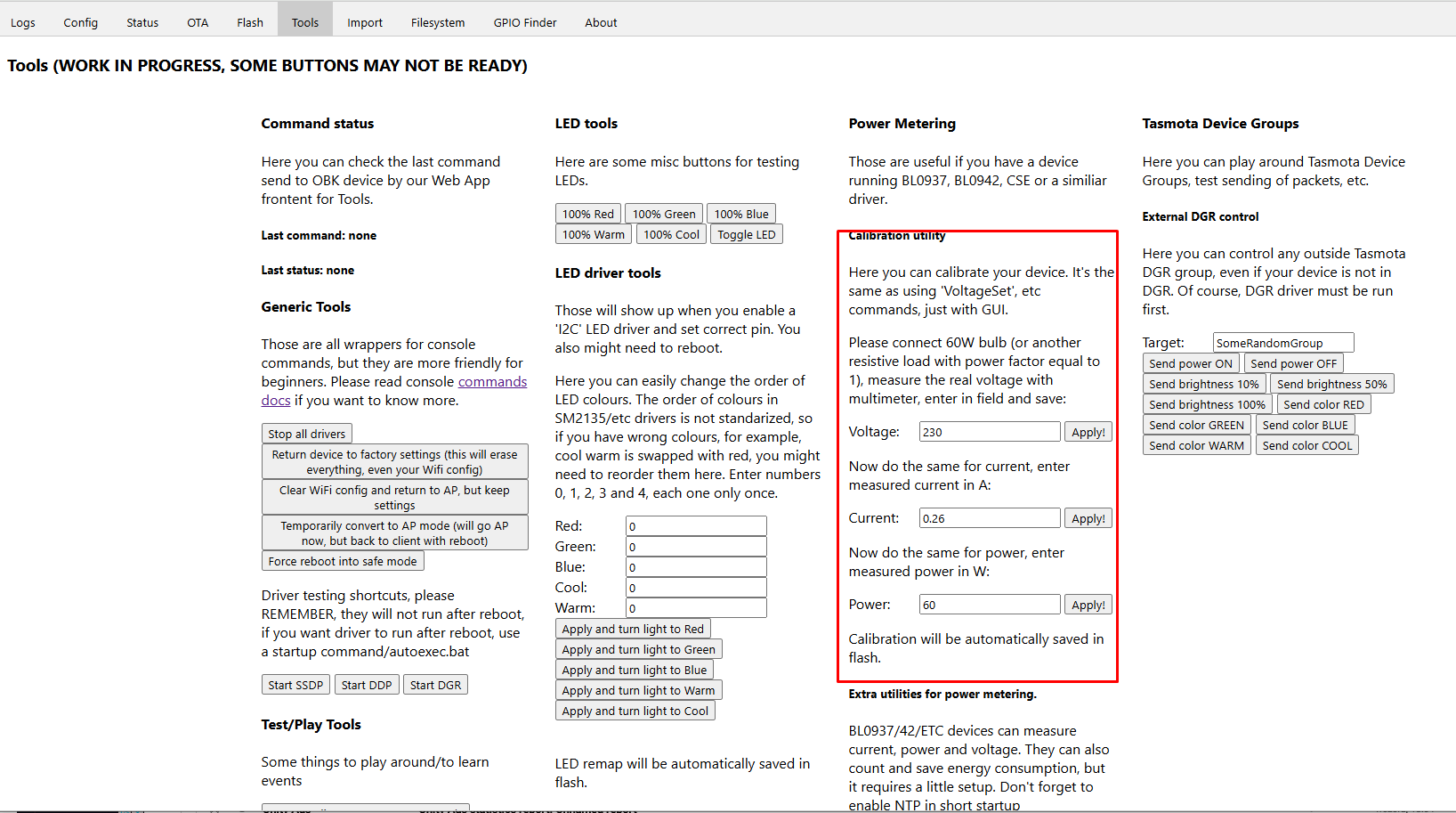

    Calibration of energy measurement .

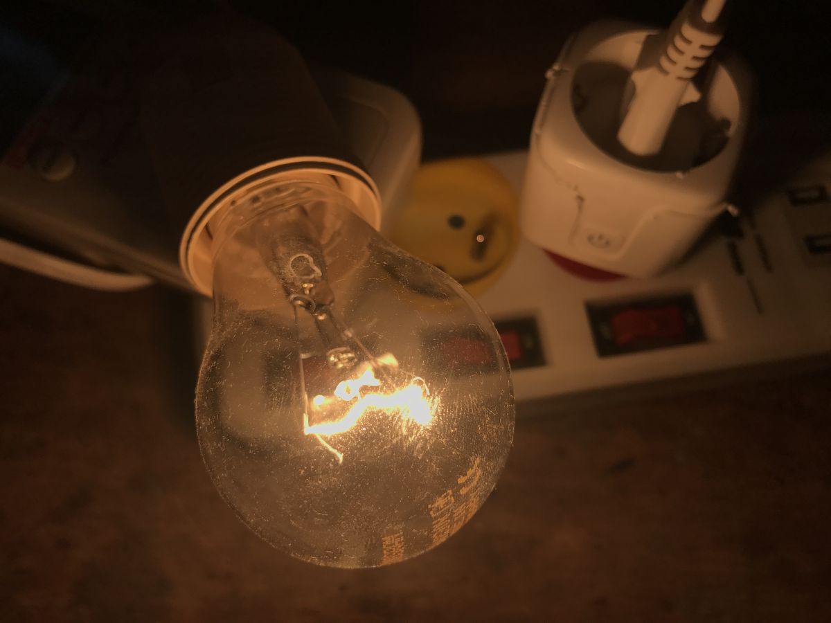

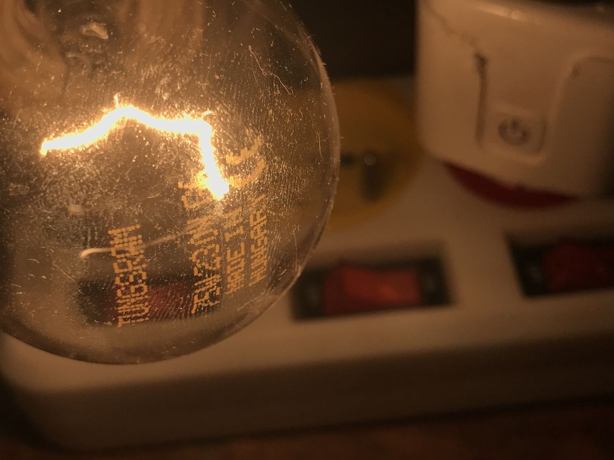

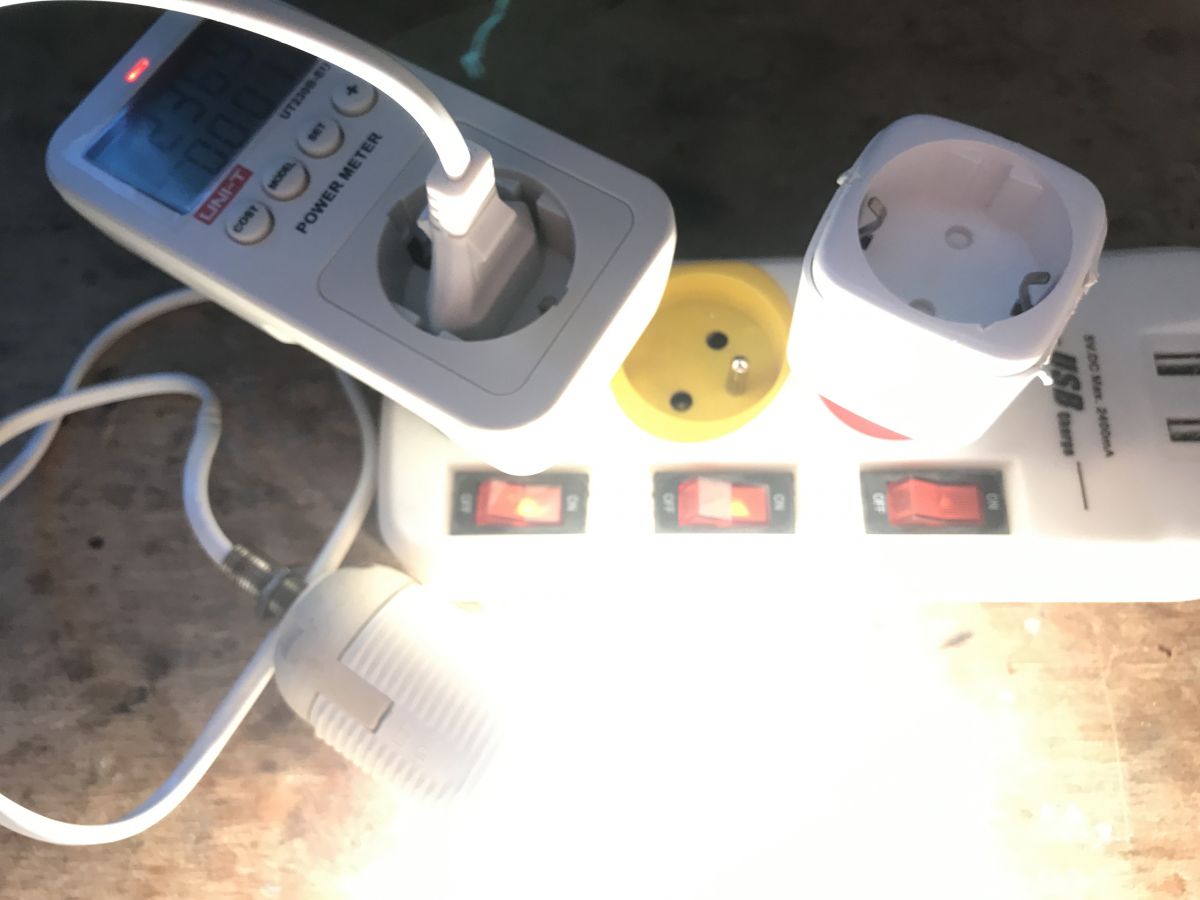

    Calibration is done in a similar way to the Tasmot. We take a higher-end energy meter, connect a resistive load in the form of a 60W light bulb, measure the voltage, current and power on it, and then enter these values into our product (having that light bulb connected and lit at all times).
    Smart socket with connected energy meter Close-up of a lit light bulb connected to a power strip with other electronic devices. Light bulb with visible filament and markings, power strip in the background. .
    The commands to enter are:
    - VoltageSet 230
    - PowerSet 60
    - CurrentSet 0.236
    You used to have to manually write the results, but now the firmware will remember this itself.
    If you do not want to write commands, there is a form for this in the Web App under Tools:
    Screenshot of energy calibration tools in an IoT device configuration panel. .

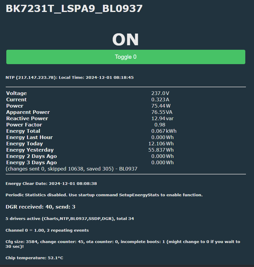

    This is what the device panel looks like after calibration:
    Energy measurement screen on an IoT device with BK7231T and BL0937 .

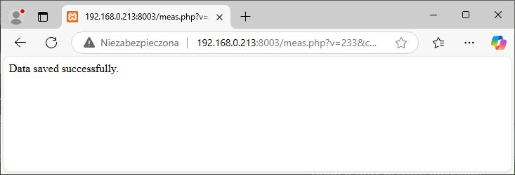

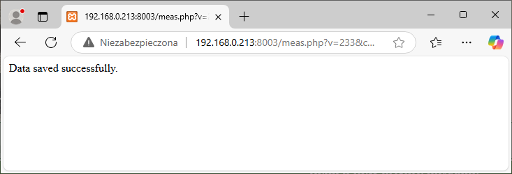

    Sending measurements to HTTP server .
    The firmware is also able to send a GET request with the contained measurements, which we can direct to our publicly available or locally accessible server. Such GET arguments can, for example, be processed in PHP and saved to a database or file.
    Example script that writes the values of the v, c and p arguments from the GET to data.csv with the current time:
    Code: PHP
    This can be tested from within the browser:
    http://192.168.0.213:8003/meas.php?v=233&c=0.44&p=75
    Data saved successfully message in browser. .
    As a check, this can also be called from the OBK command line. Ultimately from a script:

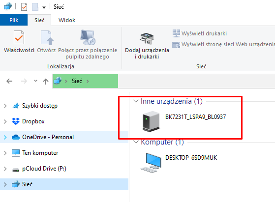

    Integration with SSDP .
    The multi-platform SSDP driver makes devices with OpenBeken visible by, for example, Windows computers:
    Screenshot showing the device BK7231T_LSPA9_BL0937 detected in the network. .

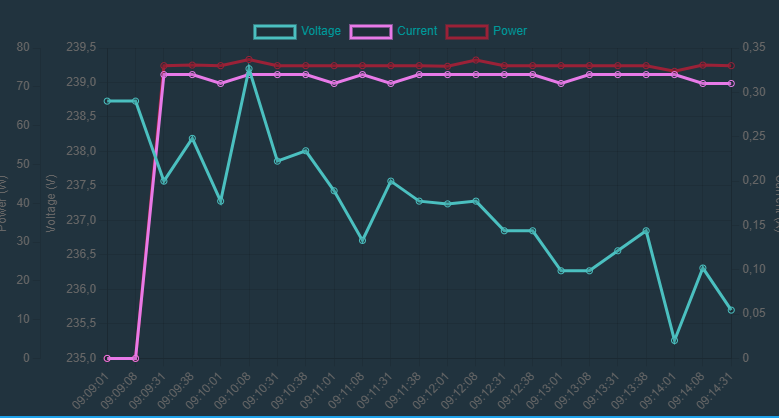

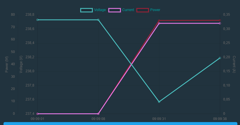

    As documented in the charts:
    Charts in OpenBeken - configurable measurement history hosted on IoT device .
    I have created an autoexec.bat script:
    startDriver charts
    startDriver NTP
    waitFor NTPState 1
    // chart with max 100 samples, 3 variables and 3 separate vertical axes
    // TODO: tune samples count
    chart_create 100 3 3
    // set variables along with their axes
    chart_setVar 0 "Voltage" "axvolt"
    chart_setVar 1 "Current" "axcurr"
    chart_setVar 2 "Power" "axpower"
    // setup axes
    // axis_index, name, flags, label
    chart_setAxis 0 "axvolt" 0 "Voltage (V)"
    chart_setAxis 1 "axcurr" 1 "Current (A)"
    chart_setAxis 2 "axpower" 2 "Power (W)"
    // every 30 seconds, -1 means infinite repeats
    // TODO: tune time here

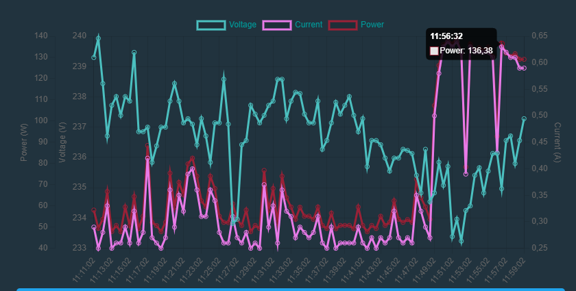

    addRepeatingEvent 30 -1 chart_addNow $voltage $current $power
    Example graph, you can see the voltage fluctuation and the moment the 75W bulb is switched on:
    Chart showing voltage, current, and power measurements. Graph showing measurements of voltage, current, and power over time. .

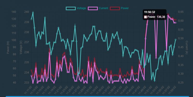

    And here's a tidbit - guess at what point I enabled the Stable Diffusion model to generate images on my laptop?
    Graph of voltage, current, and power measurement

Which USB-to-UART adapter and power supply should I use to flash BK7231-based sockets safely, and why is the CH340's 3.3 V output not enough?
Use a USB-to-UART adapter such as a CH340, but power the target from an external 3.3 V LDO supply. The author explicitly uses a CH340 version and warns that the adapter's own 3.3 V output is not sufficient because it lacks the required current capacity. That means the UART adapter is fine for data lines, but the module should not rely on it as the main flash-time power source. [#21327535]

How do I calibrate voltage, current, and power readings in OpenBeken using a reference meter and a 60 W bulb?
Calibrate it with a known resistive load and three entered values. 1. Connect a higher-end energy meter and a 60 W bulb. 2. Measure the live voltage, current, and power while the bulb stays on. 3. Enter those numbers with commands such as VoltageSet 230, PowerSet 60, and CurrentSet 0.236. The thread adds that firmware now remembers calibration automatically, and the Web App also provides a calibration form under Tools. [#21327535]

How can I send voltage, current, and power measurements from an OpenBeken socket to a local HTTP or PHP server as GET parameters?
Use SendGET and pass the live variables as URL parameters. The thread shows a PHP example that reads v, c, and p, adds a timestamp, and appends the values to data.csv. The matching OpenBeken automation is addRepeatingEvent 60 -1 SendGET http://.../meas.php?v=$voltage&c=$current&p=$power, which sends updates every 60 seconds to a local or public server that can process GET requests. [#21327535]
What steps are needed to store energy measurements in CSV and visualize them as charts hosted directly on the OpenBeken device?
You need one server-side logger and one on-device chart script. The PHP logger stores timestamped v, c, and p values into data.csv. For charts, the sample autoexec.bat starts the charts and NTP drivers, waits for NTPState 1, creates a chart with 100 samples, 3 variables, and 3 axes, then adds a new point every 30 seconds with chart_addNow $voltage $current $power. The result is local history and local visualization on the device. [#21327535]
