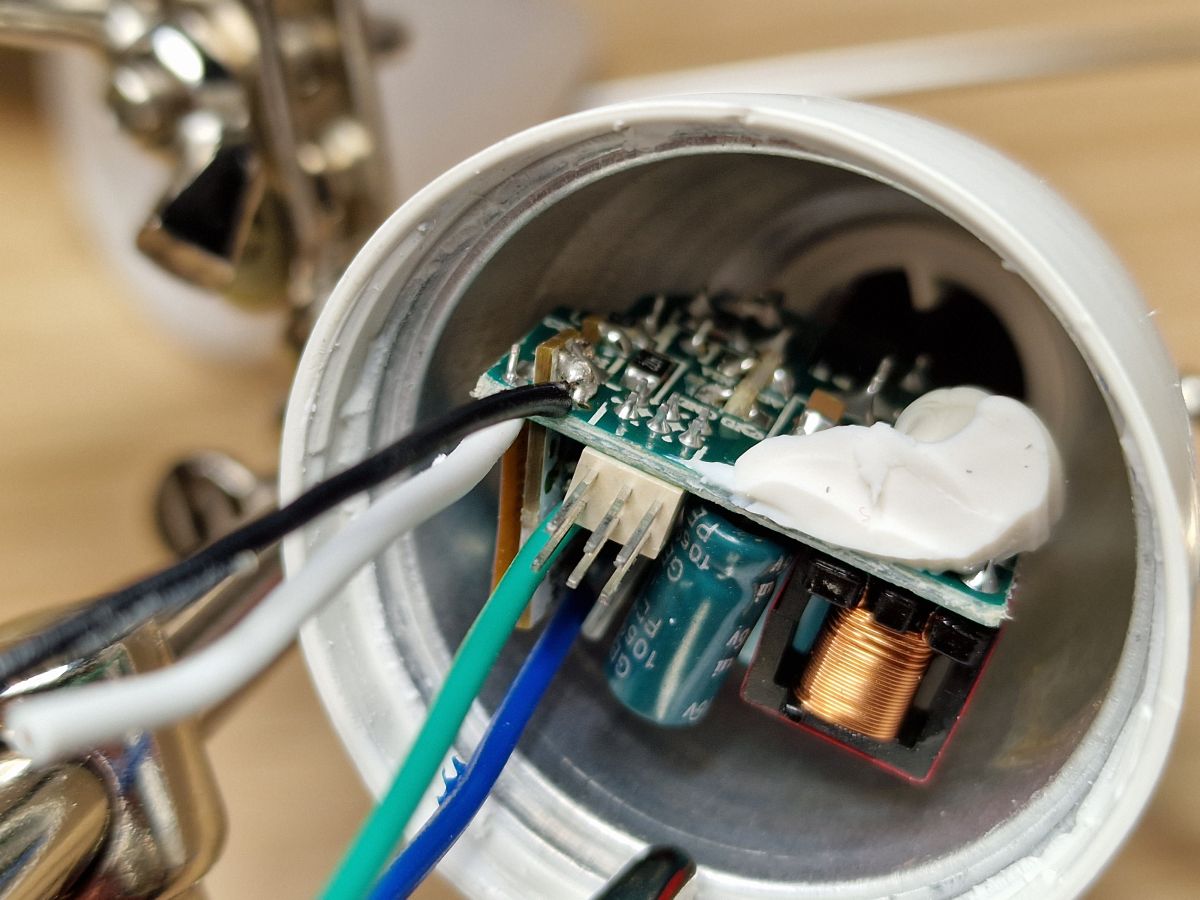

    Now second hard part. Soldering!
    Since we cannot pull the base out, we need to solder it as it is. Here is where your steady hand comes in.
    There is CBLC5 module and UART pins are in the back, in that tight space:
    [BK7231N] 6W RGBCCT E14 LED candle bulb with reassembly (Immax Neo LITE)
    But it's doable!
    Now I just soldered GND because I was too lazy to find which of those 6 pins is GND:
    Then I screwed it in my desk lamp (yes, I was also lazy to find VCC :) ), connected UART and flashed. Easy!
    Don't connect anything to mains unless you know what you're doing! Or rather even if you know what you are doing.

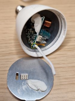

    This is what it looks like when you pull it all out, so you don't have to:
    And this is where AC wires were - live under the bottom pin and neutral under that "thing" on the top:
    Now reassembly. Quite easier process.
    I used thin string, put it under / around the Tuya module and pulled it through the WiFi hole:
    [BK7231N] 6W RGBCCT E14 LED candle bulb with reassembly (Immax Neo LITE) [BK7231N] 6W RGBCCT E14 LED candle bulb with reassembly (Immax Neo LITE)
    This was so I can pull the base module up with the string and push the LED module on those pins again. If you just try to push on it, the base module will "spring down", because it's just holding on wires and doesn't have any support.
    Now just pull the string out and done!
