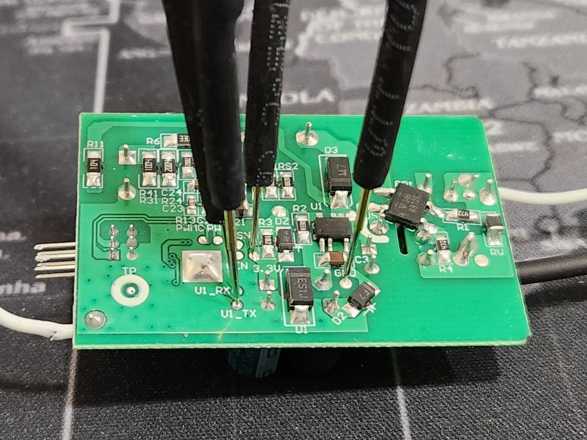

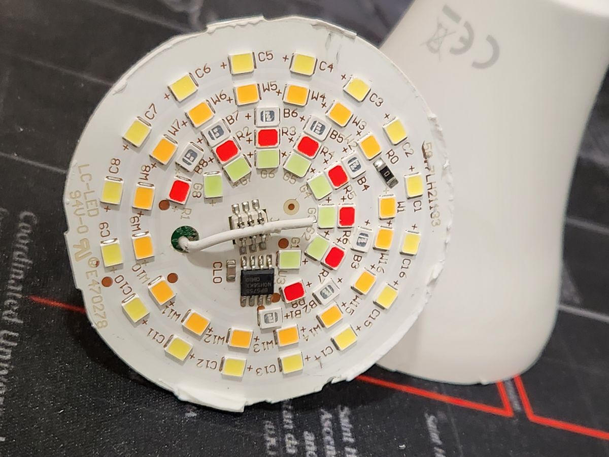

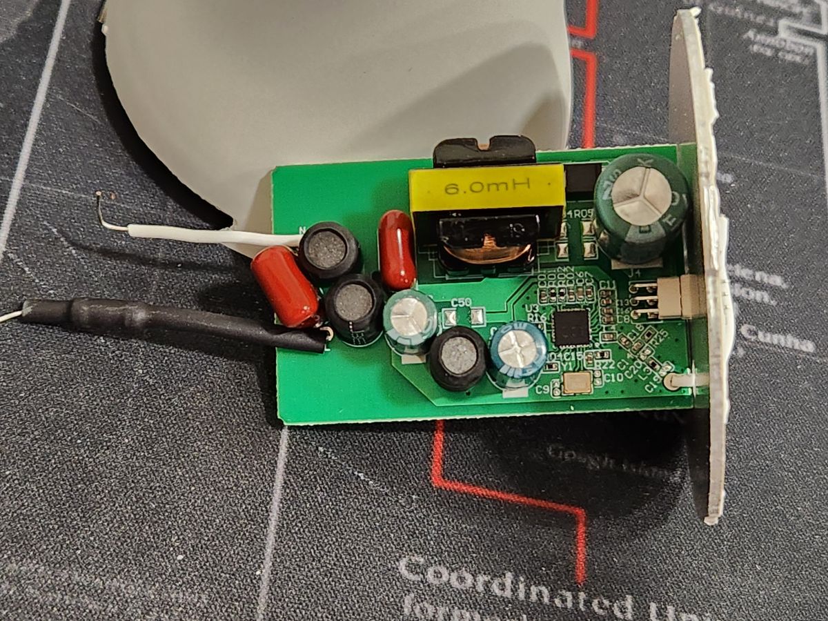

    Got a new bulb today Moes 14W RGB C+W E27.
    Moes 14W RGB C+W E27 smart bulb with Wi-Fi control features.
    https://www.aliexpress.com/item/1005003473033...order_list.order_list_main.134.2ef51802DzWf4I
    Close-up of a circuit board with visible electronic components and probe pins. Close-up of a circuit board with LEDs inside the Moes 14W RGB C+W E27 bulb. Interior of the Moes 14W RGB C+W E27 bulb with visible circuit board and components.
    The chip is BK7231N and it's not removable but you can easily access the flashing pins in the back. No tuya-cloudcutter available (V1.5.32).
    For flashing, I highly recommend these BDM Frame it makes flashing so much easier than soldering.
    https://www.aliexpress.com/w/wholesale-BDM-Frame.html?spm=a2g0o.detail.search.0
      "vendor": "Tuya",
      "bDetailed": "0",
      "chip": "BK7231N",
      "board": "TODO",
      "flags": "5120",
      "keywords": [
        "TODO",
        "TODO",
        "TODO"
      "pins": {
        "24": "BP5758D_CLK;0",
        "26": "BP5758D_DAT;0"
      "command": "backlog BP5758D_Current 5 29",
