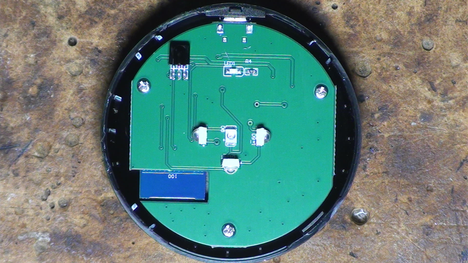

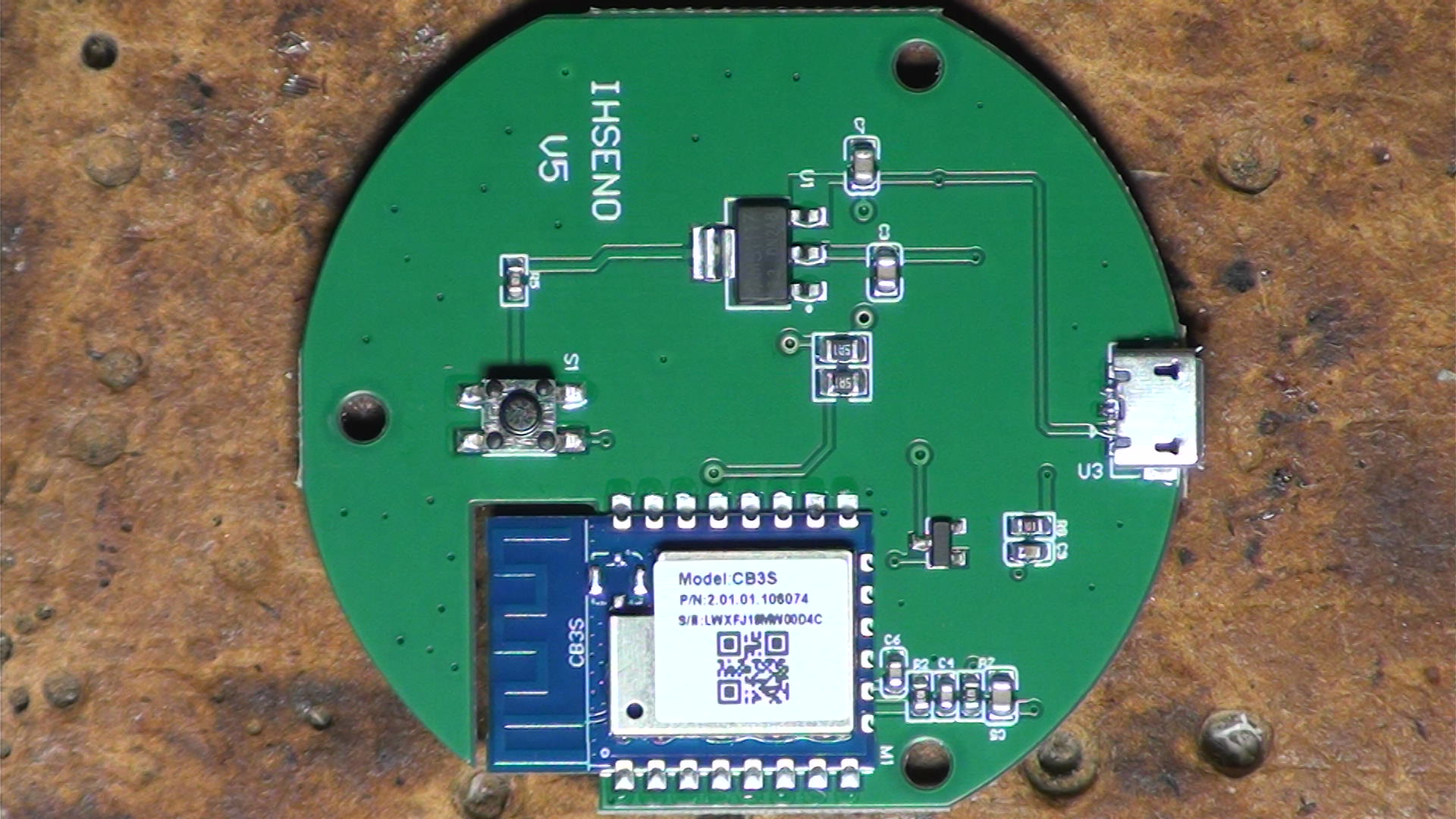

    A couple of more pics of the inside that I took:
    View of the interior of a round electronic module with a green PCB and soldered components. Close-up of a printed circuit board with a CB3S WiFi module and electronic components.

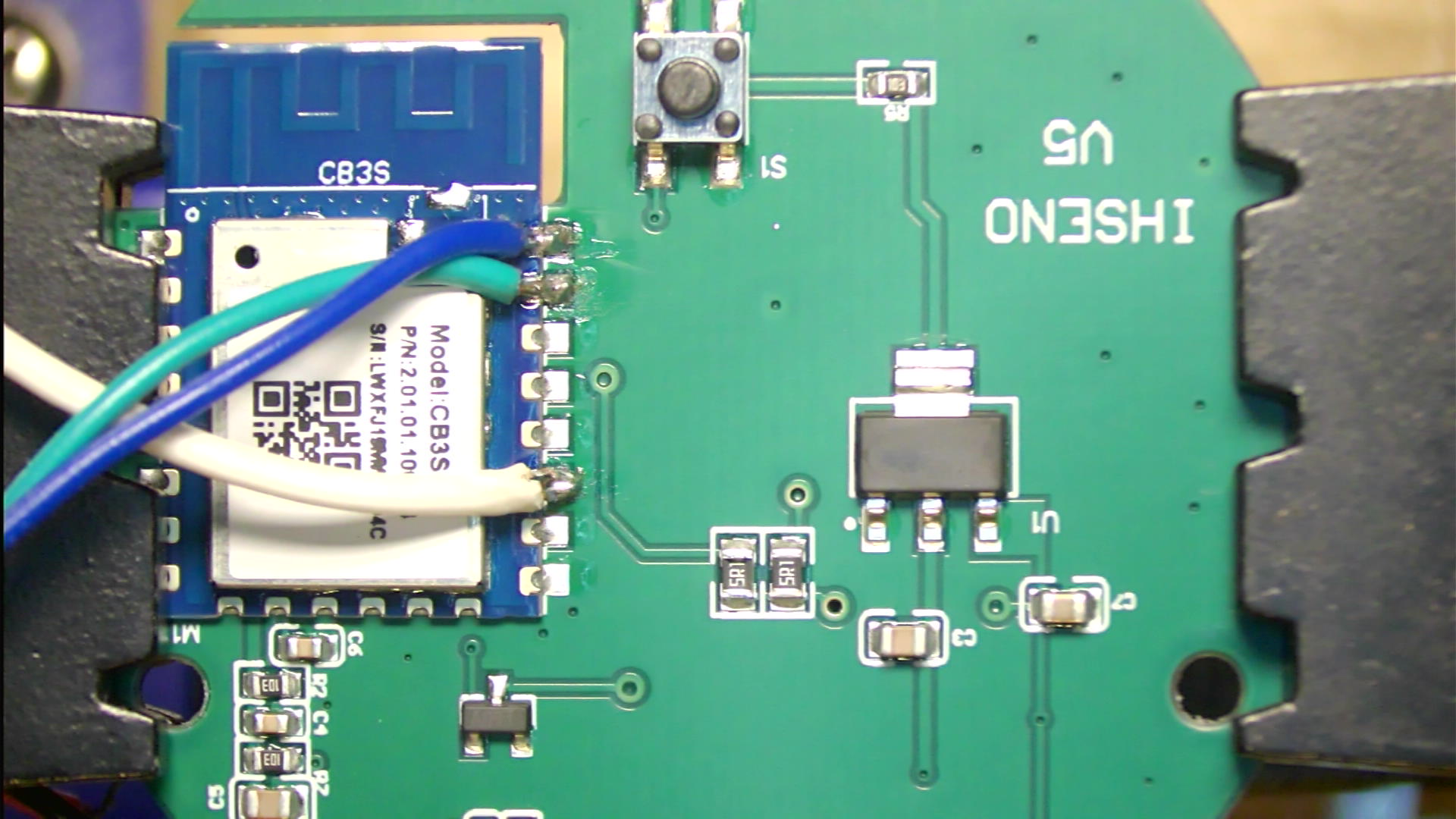

    Only a few wires are needed to be soldered on:
    Image of a printed circuit board with a CB3S WiFi module and soldered wires.
    Blue: Tx, Green: Rx, White: Tx (monitoring)
    We can use the provided USB cable to power the device during flashing/configuration.
    Flashing is done the usual way.
    Here is the configuration the is working for me:
      "pins": {
        "6": "Btn;0",
        "7": "IRRecv;2",
        "8": "WifiLED;1",
        "26": "IRSend;3"

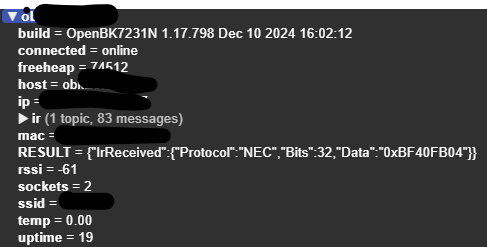

    The Autoexec.bat file is very simple:
    startDriver IR
    Other config to taste - and ready!
    Screenshot of OpenBK7231N interface displaying protocol results.
