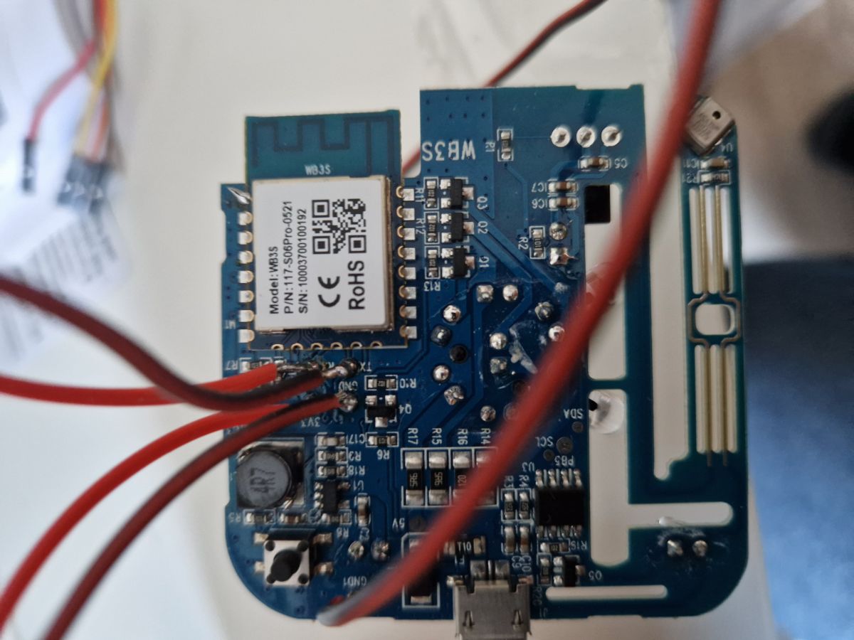

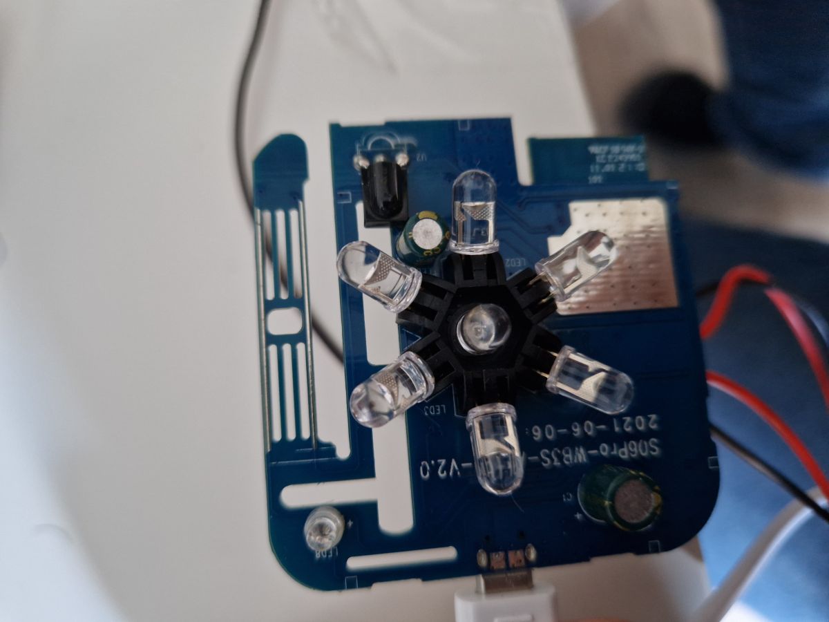

    Hi,
    all. I wanted to buy auvisio and use tasmota to use IR via MQTT. However, my version was sentimental with WB3S, thus, I want to switch to openbeken. I managed to update the firmware successfully, but have no idea how to configure so I can, e.g. read button and/switch LED before activating ir.
    Any suggestion on how to start my investment?
    Regards
    Electronic circuit board with several LEDs and electronic components.
    Close-up of a circuit board with a WB3S module and wires.
    AI: Could you please specify the exact model of your Auvisio device?
    S06 Pro

    I think you can start with Tuya Config extraction. This will tell you which GPIOs are used for IR diode and receiver:
    https://www.youtube.com/watch?v=WunlqIMAdgw&ab_channel=Elektrodacom
    Then it depends on what exactly do you want to do, do you want IR events to go through Home Assistant? Do you want to send IR commands or do you want to receive them?
  • #3 21445478
    aldaris1
    I tried to read config. Furthermore, the Template Tuya IR matches, so I choose that one. With that template, I can switch LED as well as see IR signals from TV remote in the log
    Info:IR:IR IR_RC5 0x10 0x33 0 (13 bits)
    My goals is to
    A) Send These ir detected event via mqtt
    B) Send IR Signals Based on a mqtt message
    MQTT is up, running and connected.
    The ir Event (See above) I do not see in mqtt and I don't what topic to send to emit the same event
