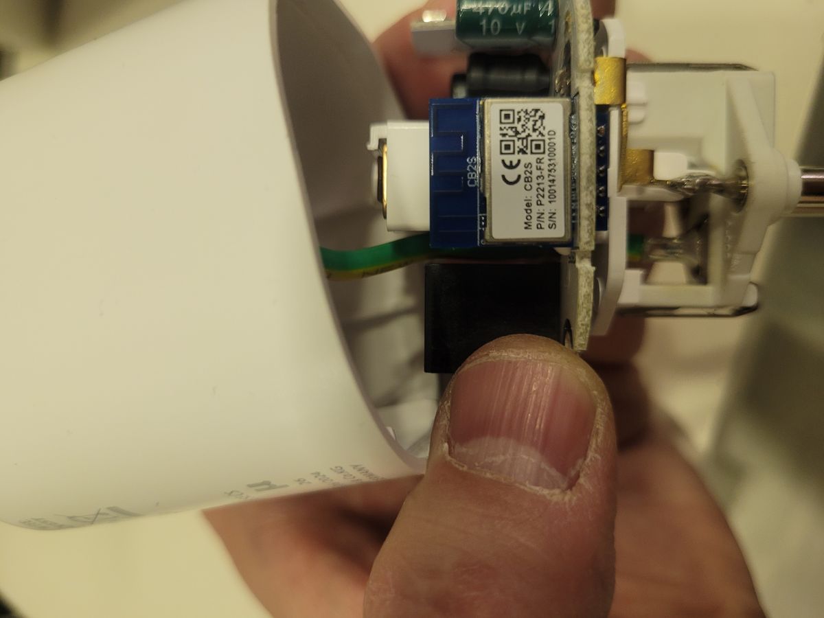

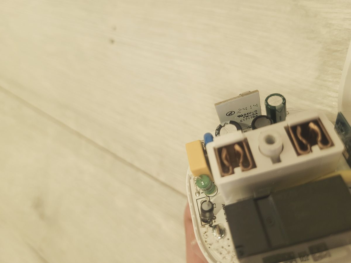

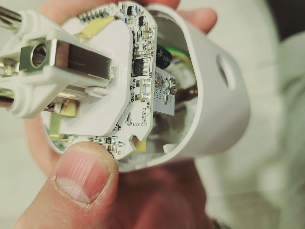

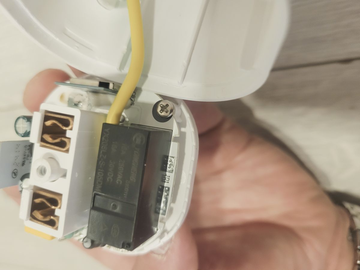

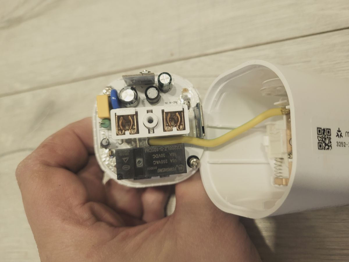

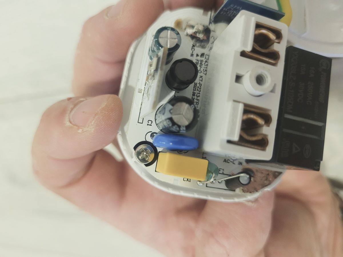

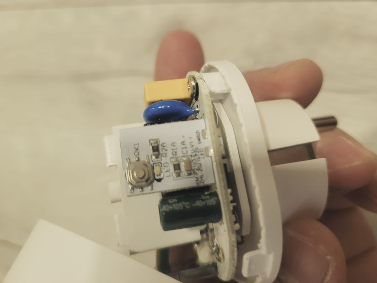

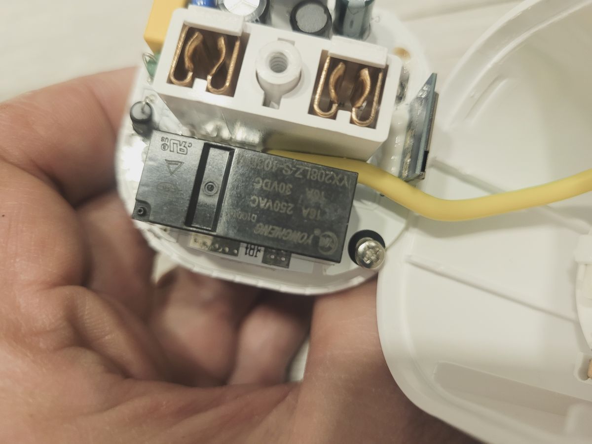

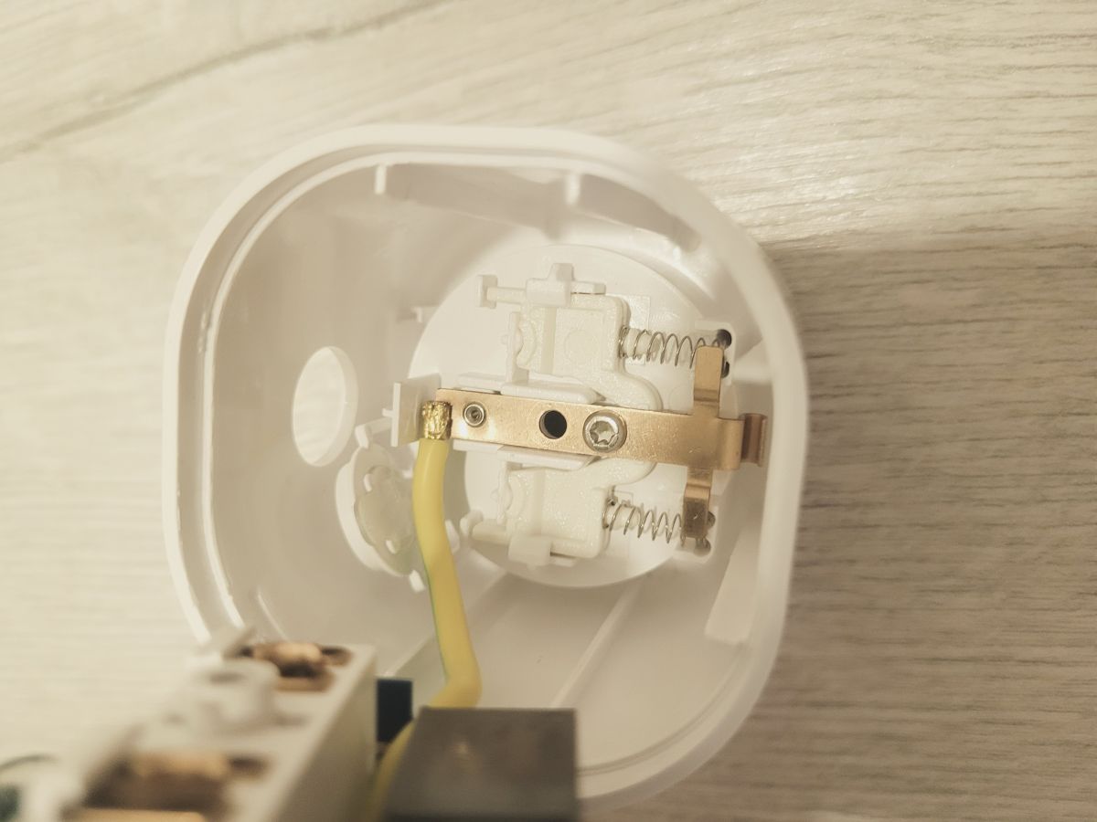

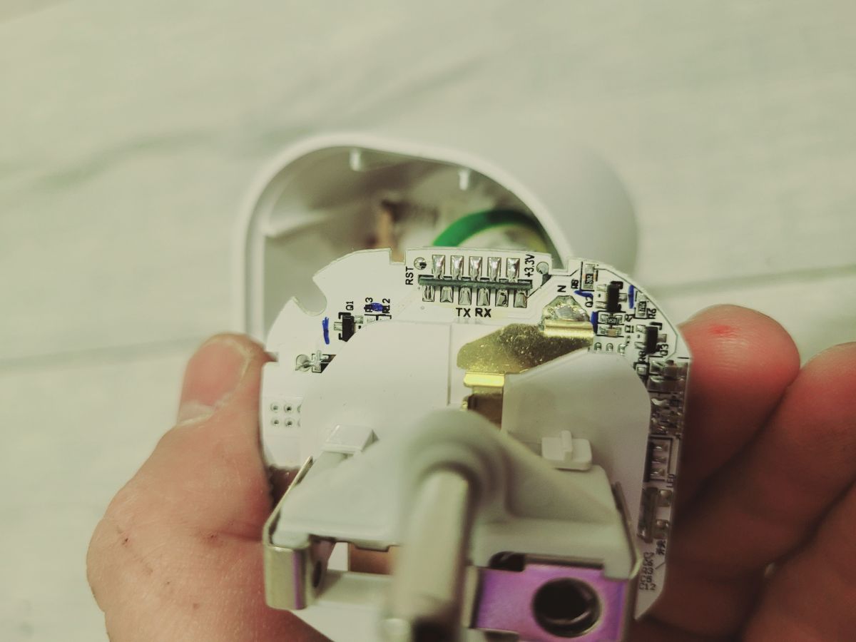

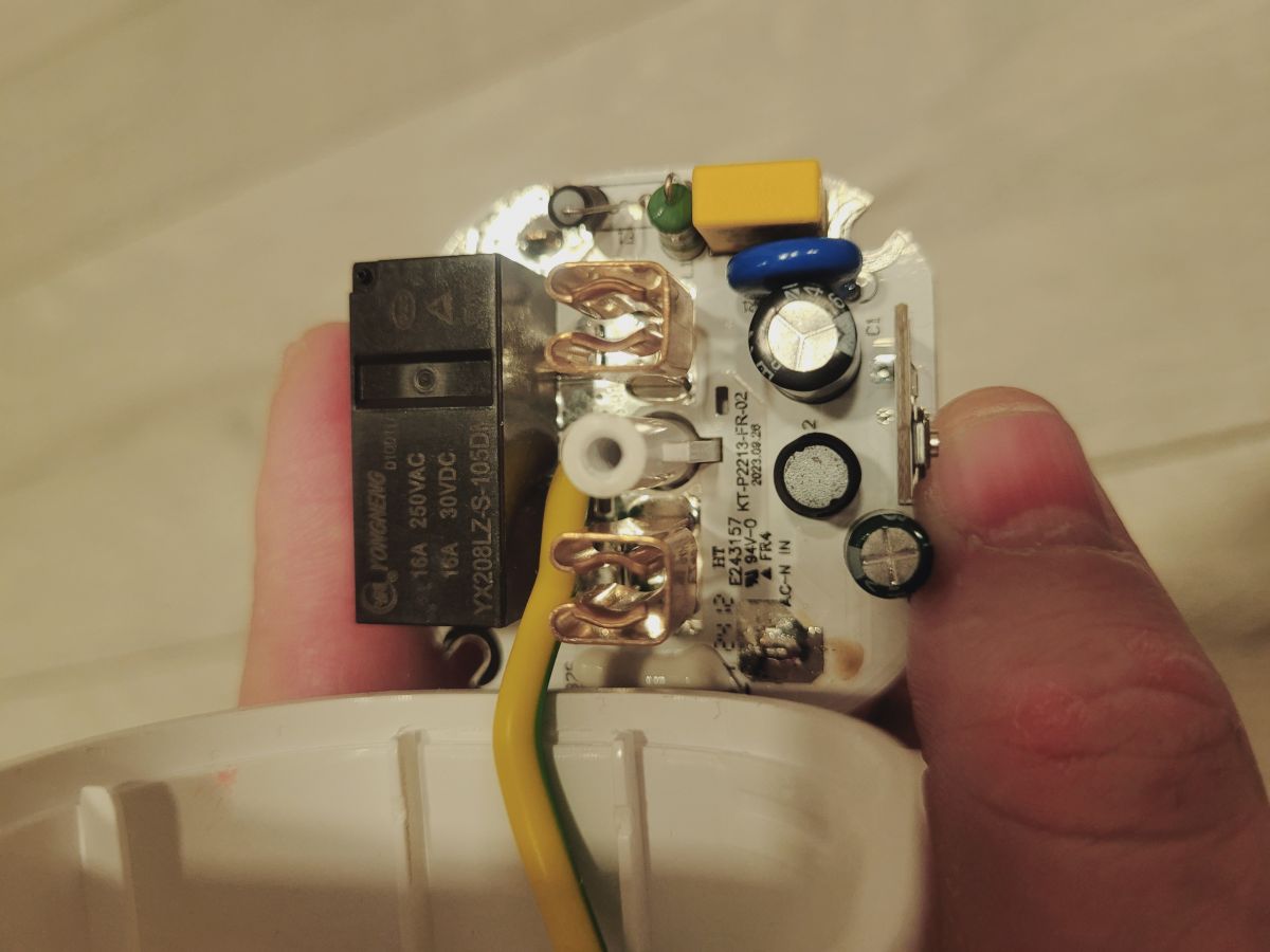

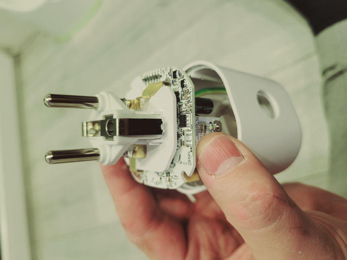

    Here are images from inside of LIDL SAPM 1 A1 matter over wifi clever socket
    AI: What specific information or feedback are you seeking regarding the internal images of the LIDL SAPM 1 A1 clever socket?
    photos to teardown database
    AI: Are you experiencing any specific issues or problems with the device's WiFi or Matter protocol capabilities?
    haven't tried flashing it yet

    Very interesting! Give it a go and first make a 2MB flash backup.

    I guess that chip inside may be BK7231M? The non-Tuya one?

    could well be. or something new maybe. I've been looking for signs of a link to Tuya but don't see any in pics or the manual. I see the OP is posting about it here too https://www.vodnici.net/community/postid/40586/ :)
    https://www.lidl.cz/p/silvercrest-zasuvkovy-adapter-s-mericem-energie-smart-matter/p100380458
    The model number is HG10491-FR which produces a few hits if Googled.

    Hello I finally got time to try play with the device. I desoldered the module prom board. The device is 7231N device.
    However during flash with the newest flasher 186 I got write error. I got successfull write with old v50 and 1.18.175 OBK.
    There is a problem with device. The MAC is probably stored within FW so my device get MAC Device MAC: C8:47:8C:00:00:00
    BTW I cannot do OTA to the newest FW 1.18.231
    downloaded fw is in the attachment. Decoded fw:
    - WiFi LED on P23
    - Button (channel 1) on P24
    - Relay (channel 1) on P26
    Device seems to be using CB2S module, which is using BK7231N.
    And the Tuya section starts at 2052096, which is a default T1/XR806 and some T34 offset.
