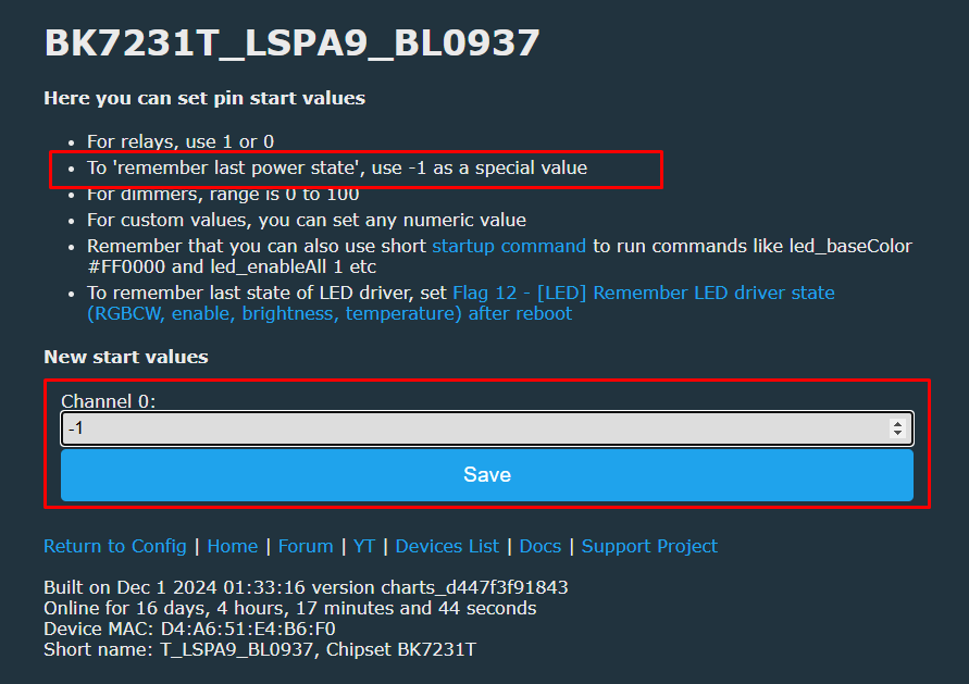

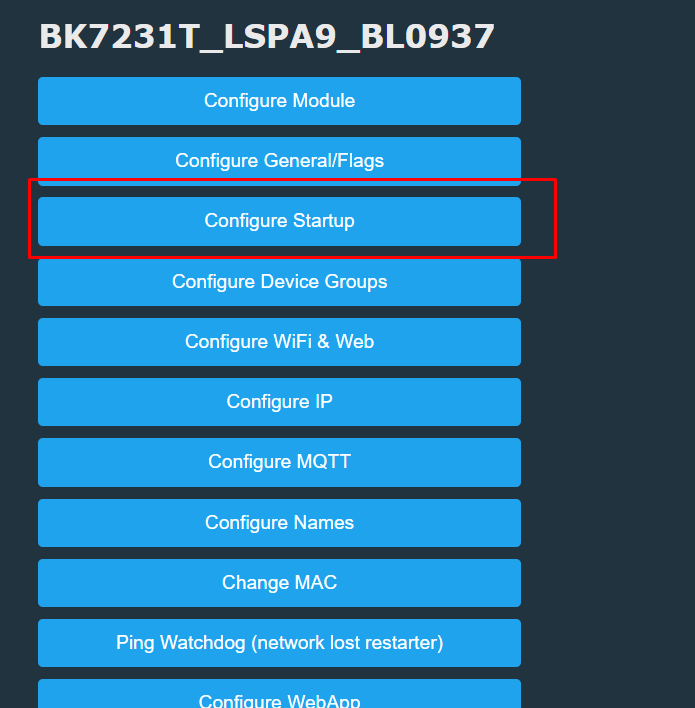

    You can set it in startup menu:
    Configuration menu for device BK7231T_LSPA9_BL0937 with the Configure Startup button highlighted.
    User interface displaying start settings for device BK7231T_LSPA9_BL0937, with channel 0 set to -1.

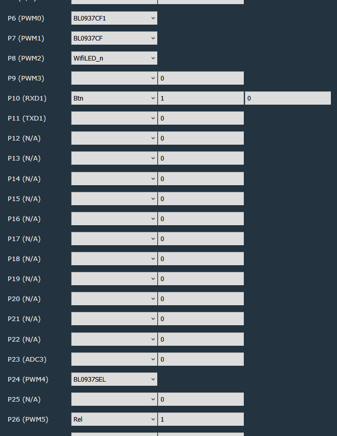

    kantora98
    >>21352243
    Given the situation when 2 channels are used and configuration of pins as shown below, which channel should I set to -1 for the relay to remember its last state after power restored?
    - BL0937 VI on P6
    - BL0937 ELE on P7
    - WiFi LED on P8
    - Button (channel 1) on P10
    - BL0937 SEL on P24
    - Relay (channel 1) on P26
    Screenshot of a configuration interface for various pins of an electronic circuit.

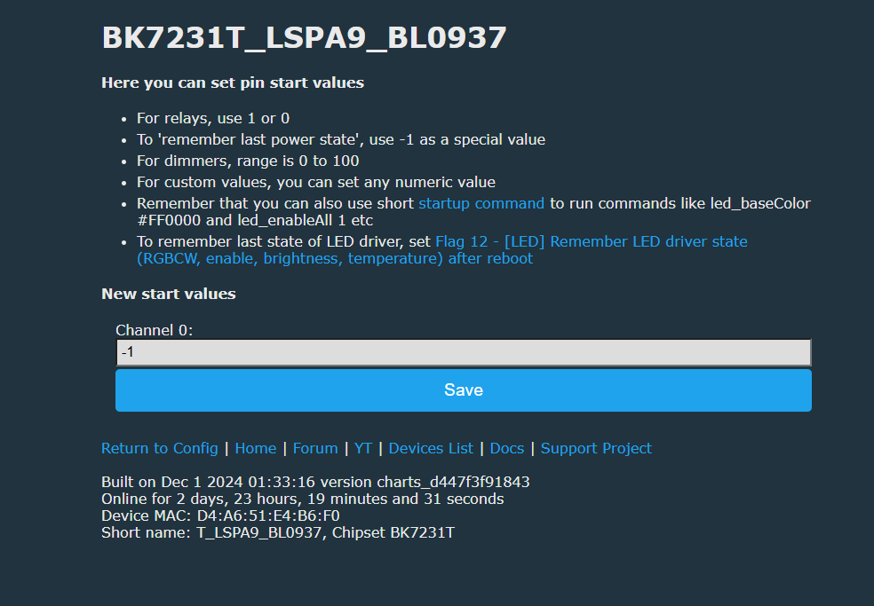

    You have a menu for that:
    Screenshot of the BK7231T_LSPA9_BL0937 module pin start settings.
    You don't set channel to -1, you set start value to -1.
  • #6 21517203
    kantora98
    >>21515225 but relay in my config is on channel 1.
  • #7 21517434
    Posts: 14750
    Rate: 12862
    Well, if your relay is on channel 1, then you want to retain channel 1 value, right? The UI should update itself to contain channel 1, it checks which channels are used. And if you don't want to use UI, you can always use command SetStartValue - https://github.com/openshwprojects/OpenBK7231T_App/blob/main/docs/commands.md
