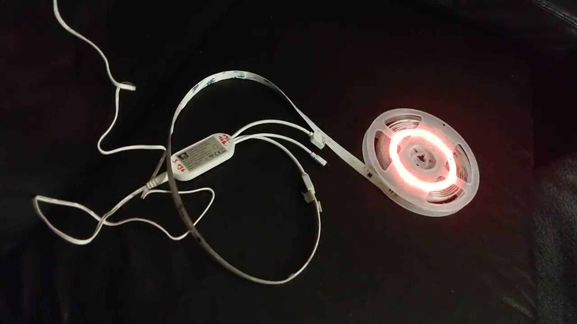

    I tried successfully to control a RGBIC device that was flashed with openbeken by xlights using the network protocol DDP. By this several effects can easily be programmed over the network.
    Here are the corresponding files: xlightsKni...tRider.zip (6.6 kB)You must be logged in to download this attachment.
    What I have not tested yet is if and how xlights can be driven by the beat of my music....
    AI: Could you provide the brand and model of the RGBIC device you're using?
    LSC Smart Digital LED Strip 2x5m, part no. 3008407 from Action but any other device with programmable LEDs (for example with SM16703P Chips) flashed with OpenBeken should work.
