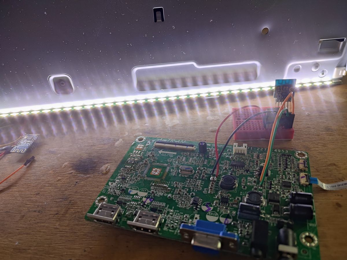

    In a previous topic I showed the inside of an Acer S236HL LCD monitor along with its LED backlight. Here I will convert the remnants of this monitor into a WiFi controlled LED strip. For this I will use a WiFi module with a chip similar to the ESP8266 (BK7231). My chip will allow me to control the brightness of the strip and turn it on and off. By using OpenBeken, the whole thing will also be compatible with Home Assistant, allowing this strip to be controlled from any other supported switch and grouped together with other LED strips.
    Previous topic: Acer S236HL LCD monitor - interior, design, potential use of LEDs .

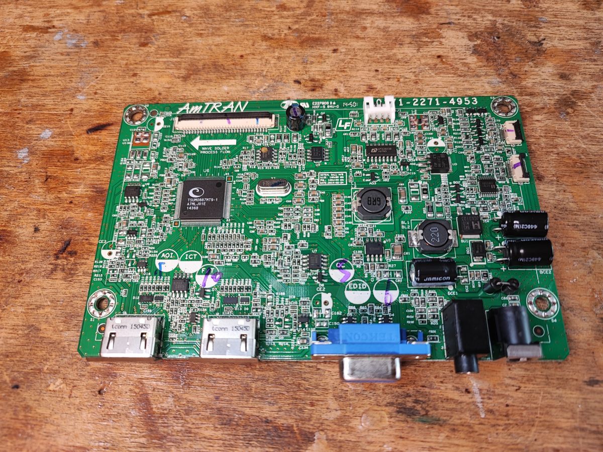

    So back to the board:
    LCD monitor motherboard with visible connectors and electronic components. .
    The board connected loosely to the backlight and power supply (no buttons, LVDS, etc) still lights up the backlight.

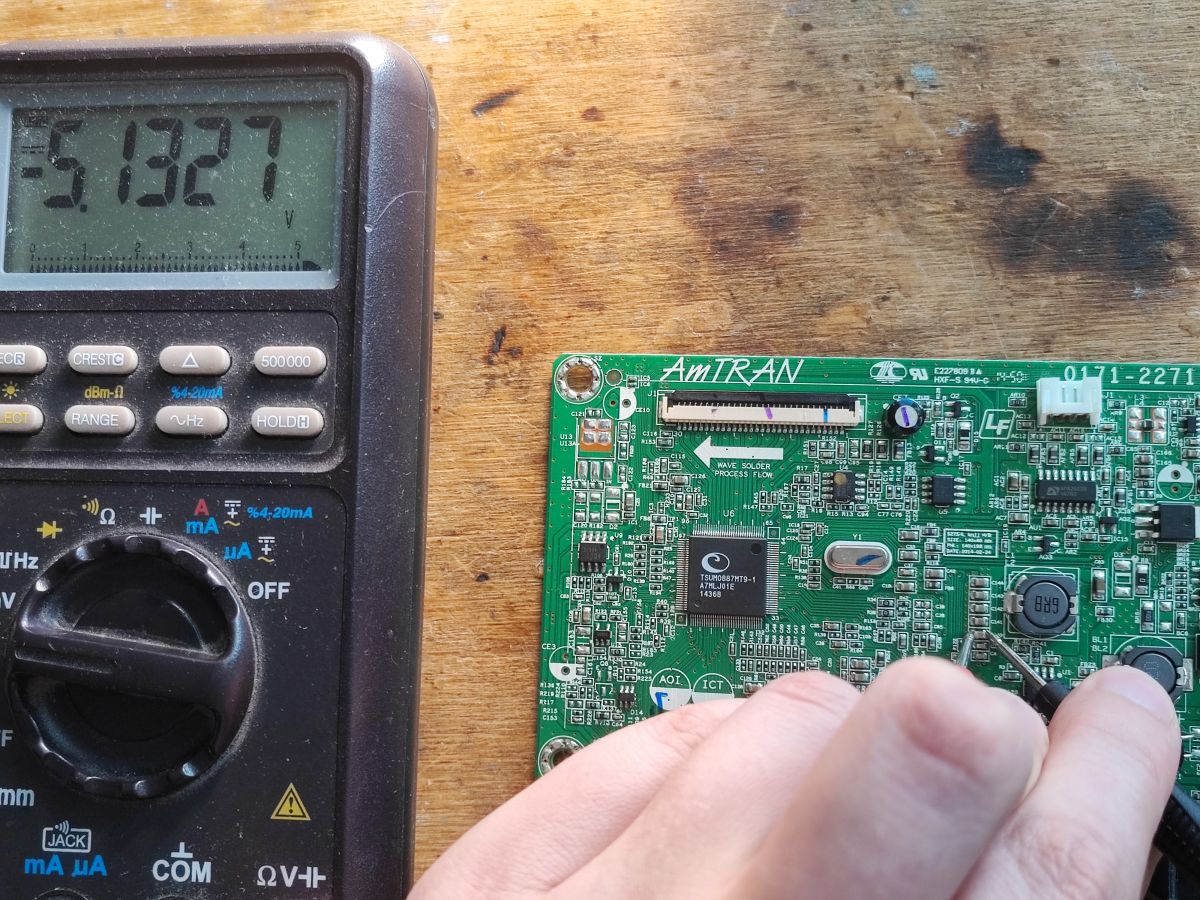

    To start with I checked what the voltages were on the board. I found 3.3V, but had doubts about its current capacity. The WiFi module sometimes needs more than 100mA at 3.3V. In the end I decided to use the 5V line but together with the 3.3V LDO:
    Circuit board with a multimeter displaying 5.1327V. .
    So the power supply we have.

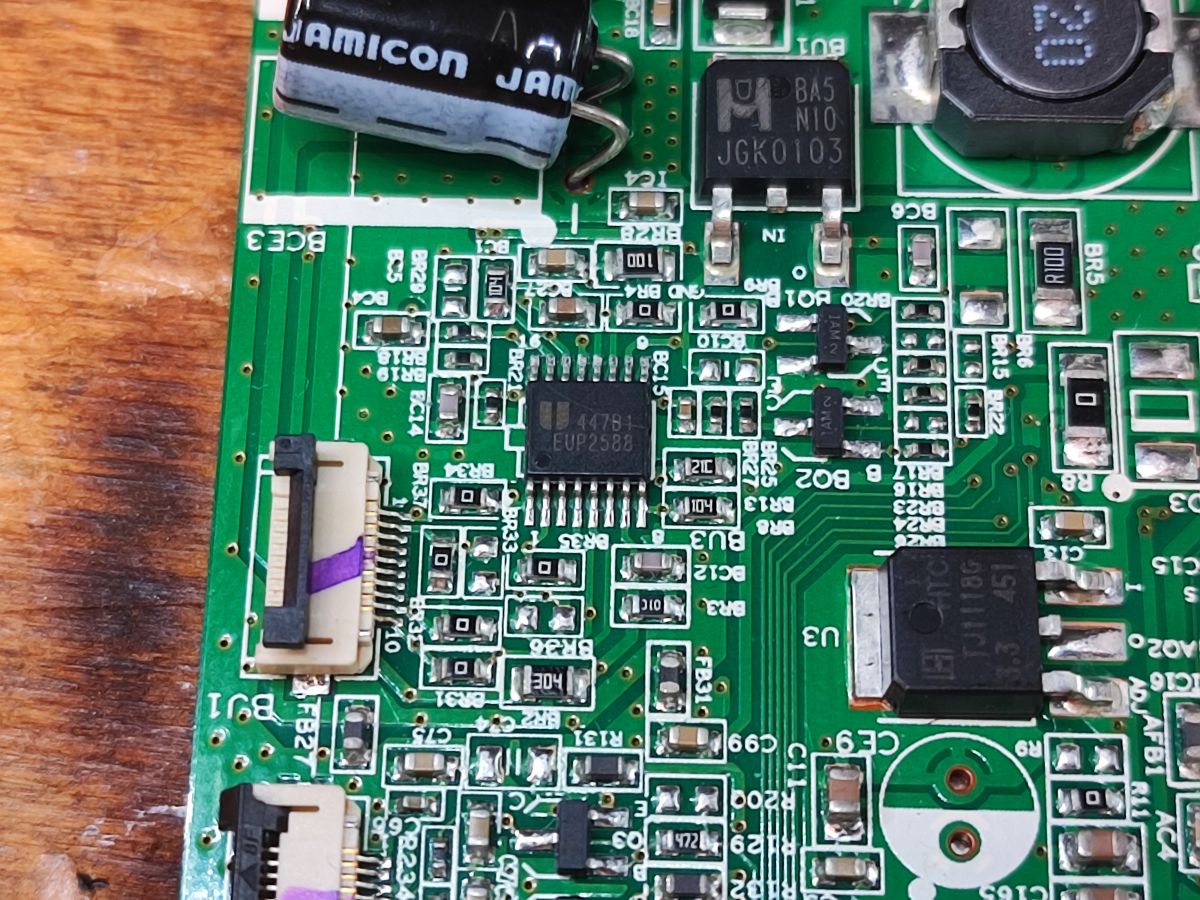

    Printed circuit board with electronic components in a monitor. .

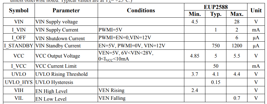

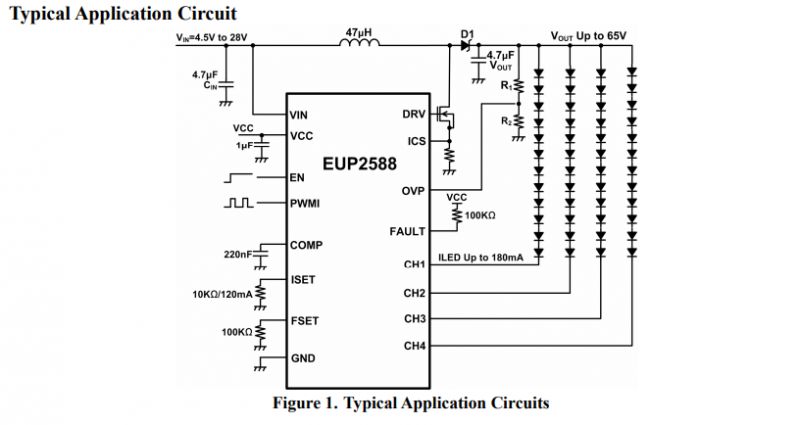

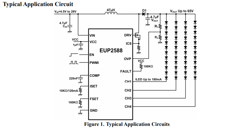

    EUP2588:
    Conversion of an LED strip power supply from an old TV to a WiFi-controlled LED strip .
    We need the EN (enable) and PWM (brightness control) signals.
    EN requires a high state to enable:
    Excerpt from technical documentation of EUP2588 chip showing the description of the EN pin. .
    And PWM:
    Section of the documentation on LED brightness control using PWM signal on the EUP2588 chip. .
    Only question now, how is this connected to the main controller?
    Need to see if this can be driven from the MCU:
    Technical specifications table for EUP2588 chip .
    The high level is from 2.4V, so an MCU running at 3.3V will be able to drive this.

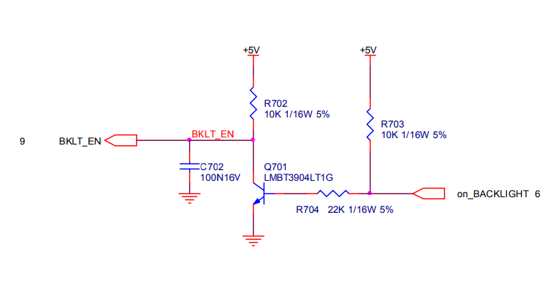

    I also looked for a schematic. This particular board was not available, but I looked at similar schematics:
    Electrical schematic with transistor and resistors for BKLT_EN signal. .
    I was a bit surprised that there is a pull-up here with a transistor, now a high state on the base of this transistor will result in a low state on BKLT_EN.... but this can be corrected in the firmware.

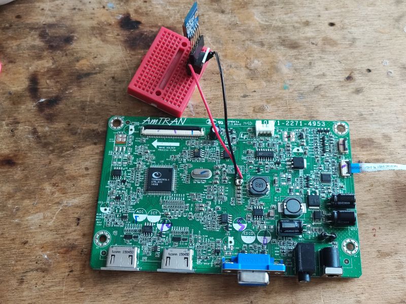

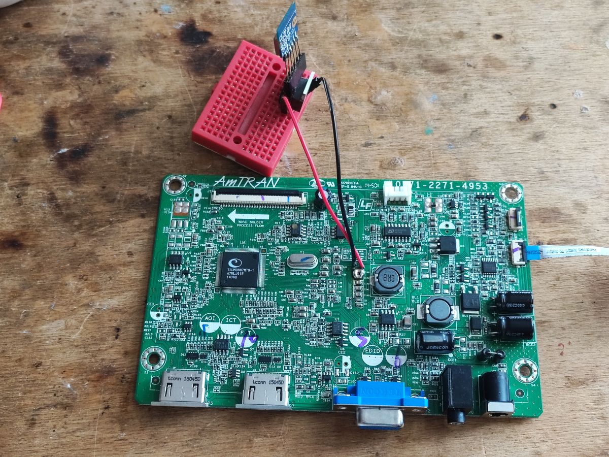

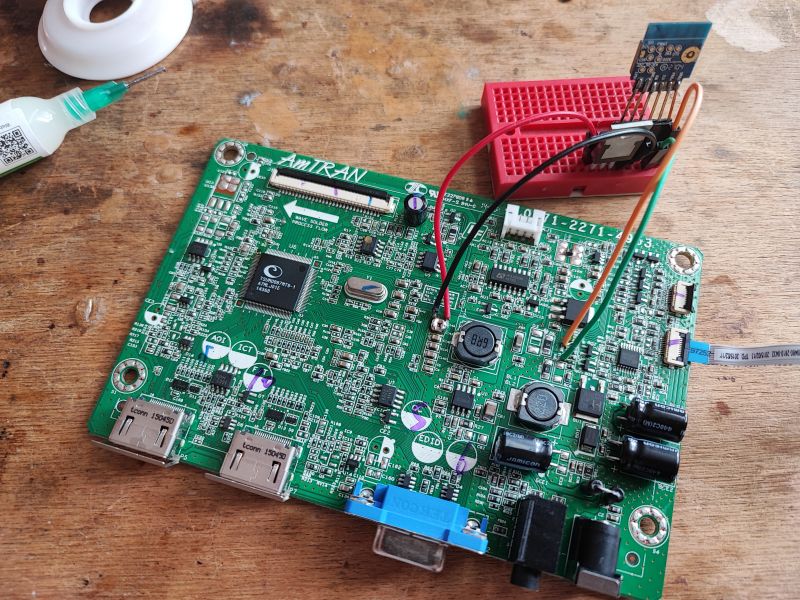

    This starts with the power supply:
    PCB board with a WiFi module connected on a red breadboard. .
    The WiFi module has checked into the network, it works.

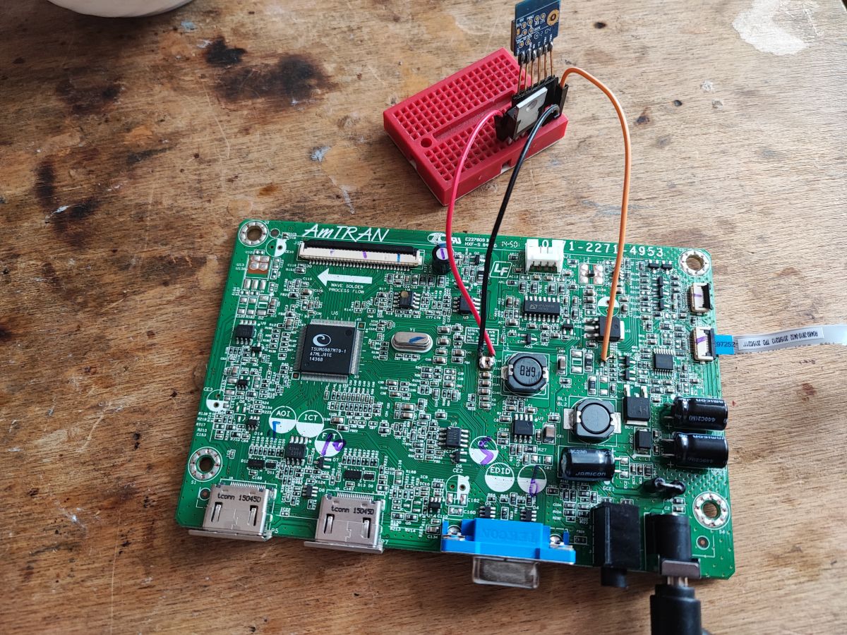

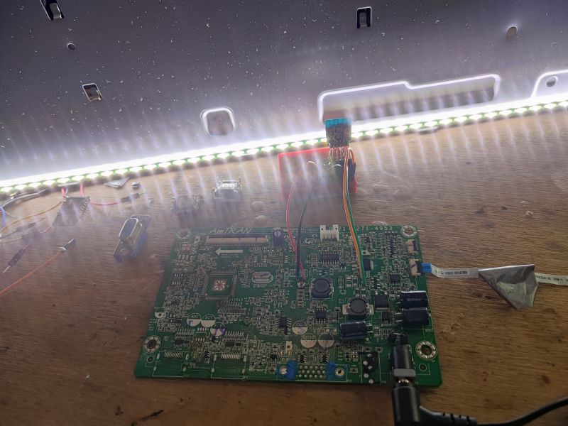

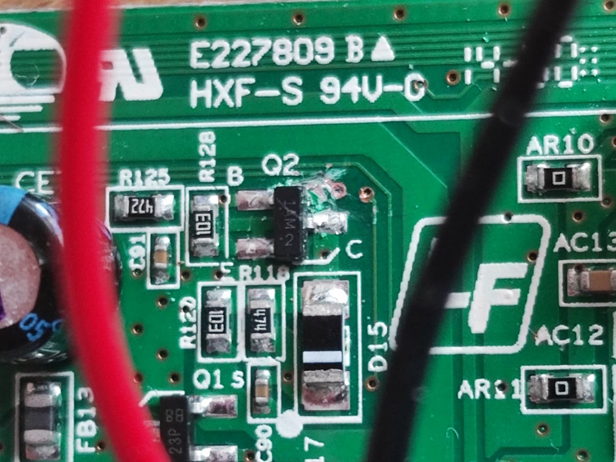

    Now EN and PWM - I examined the paths and came to the conclusion that, as in the schematic attached above, the main MCU here controls them via transistors. In addition, they do indeed have pull-up resistors.
    So I cut the path:
    Printed circuit board with electronic components and connected wires. Close-up of an open circuit board with a connected WiFi module. .

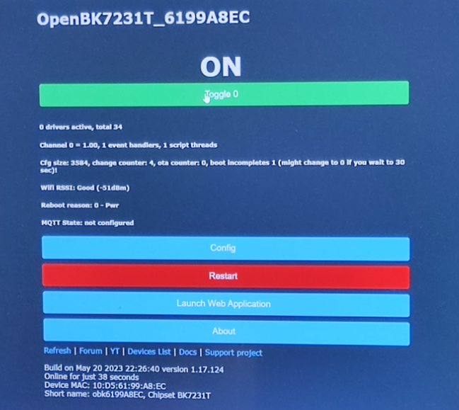

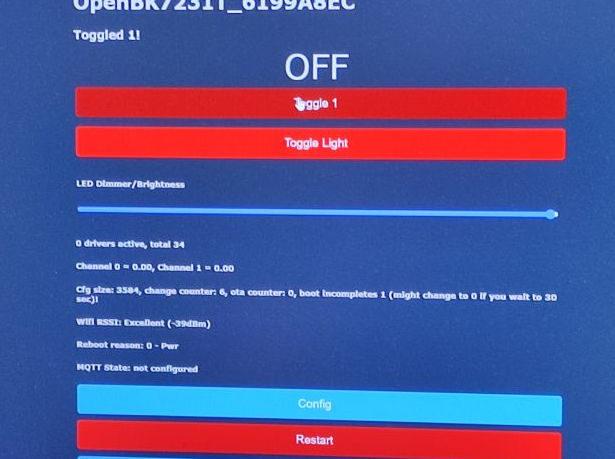

    On/Off works:
    OpenBeken control screen with device information. .
    LEDs can be controlled.

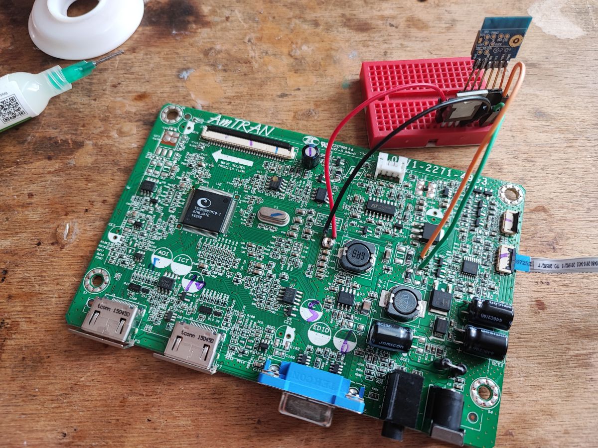

    I have connected the PWM similarly:
    Circuit board from a monitor with a connected WiFi module. .
    In the OBK I enabled the PWM (the two buttons are a side effect of the PWM and Enable pins separately):
    OpenBeken user interface with settings on screen. .

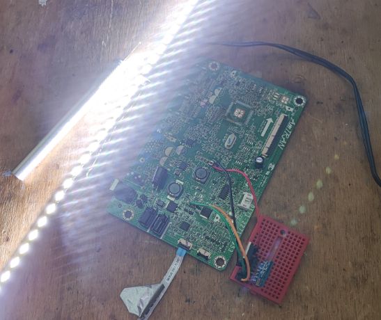

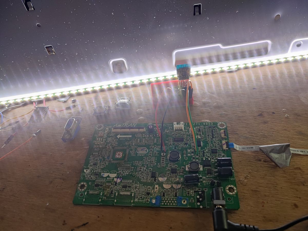

    Finally, I gradually soldered the unnecessary components off the PCB:
    PCB board and illuminated LED strip on a table PCB with WiFi module connected to LED strip on a workbench. .
    I had concerns that the main processor was controlling something else, that maybe there was a transistor along the way and that I would have to short or switch it, but no. The isolated LED chip continues to work.
    The video doesn't show the effect very well, as the camera adjusts to the brightness of the strip and you can't see the dimming very well....

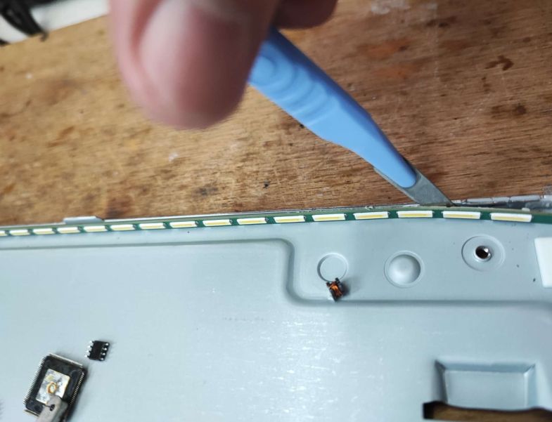

    What remains is to free the LED strip from the housing. It is glued to it with a special double-sided tape. All you have to do is lever it up with a thin knife:
    A person is prying a LED strip from a monitor casing with a thin knife. .
    This way you get a freed LED strip:
    A circuit board with a WiFi module and a glowing LED strip on a wooden surface. .
    Only now note - the belt in this form is not able to dissipate heat effectively and will damage itself quickly! Now you need to find some way to cool it properly, maybe stick it on some angle iron etc.
