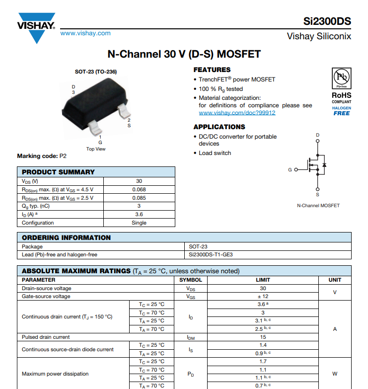

    That's a very nice strip controller, from what I can see, it's using '2300' MOSFETs for channel control?

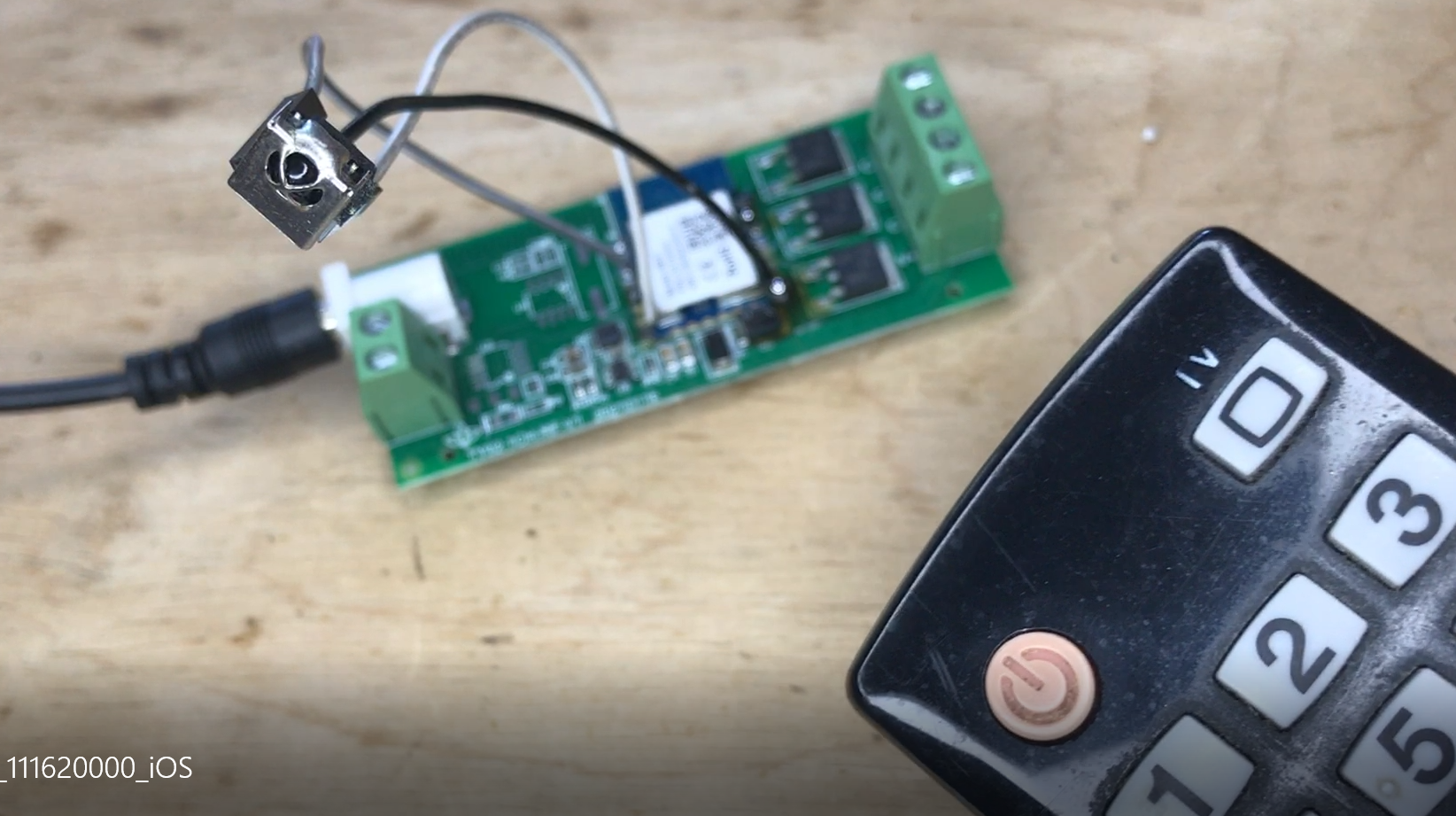

    And also... if you are up to some DIY, remember that with OpenBeken you can easily add IR to any LED strip:
    [BK7231T] Lenovo Smart LED Lightstrip SE-243SC RGBWW
    It looks like it.
    I'm aware but currently I'm using these with Home Assistant, so I don't really have a use for the buttons because I prefer my motion sensors :)
