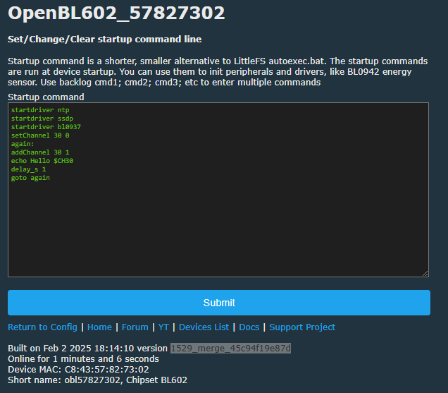

    divadiow wrote:
    OTA in console GUI isn't in place for RTL
    Oh, there's no line for the OTA image extension in obk_config.h for this platform, so it's seen as unsupported in the GUI.
    #define OBK_OTA_EXTENSION       ".img"
    is missing for PLATFORM_RTL87X0C
  • #64 21406718
    Posts: 5195
    Help: 446
    Rate: 913
    Solution - remove startup commandline text and then do OTA. Does it work?
    yes :)
    I must be thinking this issue went on longer than just experiences with this PR. nm.
    I have now flashed from GA->PR and added multi-line back in. it works as expected. I believe this completes the basic multline check back and forth GA/PR for RTL8720
  • #65 21407088
    Posts: 14743
    Rate: 12839
    Merged, now, can we merge RTL as well?
  • #66 21423602
    Posts: 5195
    Help: 446
    Rate: 913
    @miegapele 's PR 1529_merge_45c94f19e87d 1529
    OpenBL602 interface screen with startup command window.
    boots ok
