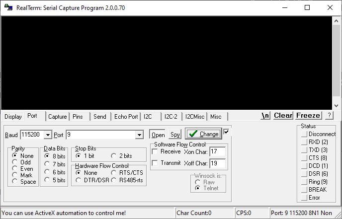

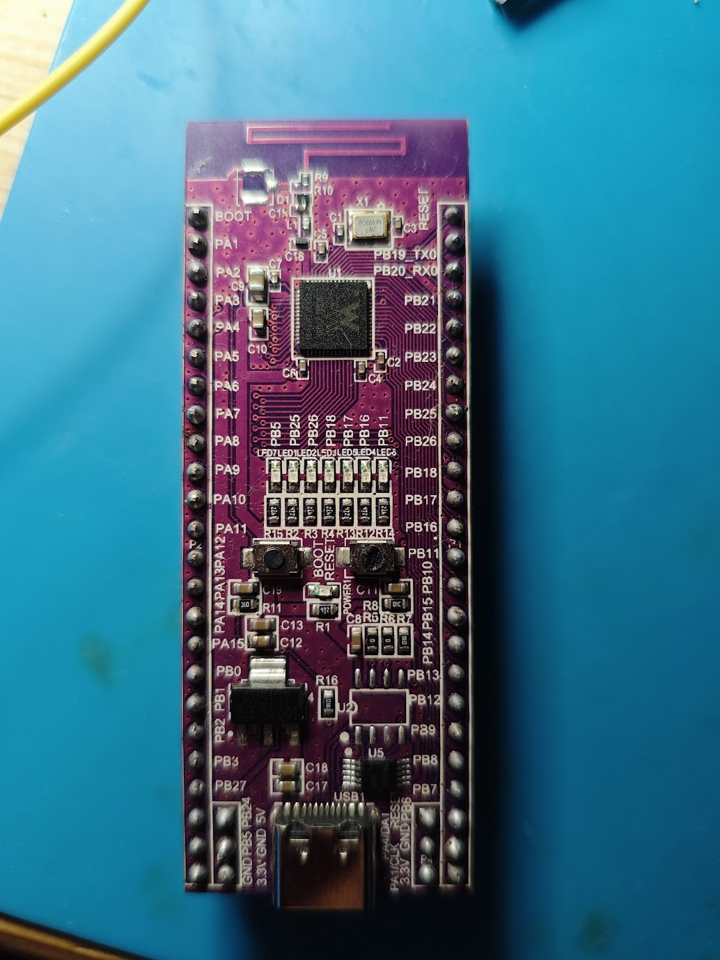

    Mine is silent but PCB seems slightly bent and I wonder if it's broken already, or is it firmware or user (my) fault?
  • #32 21385201
    Posts: 5195
    Help: 446

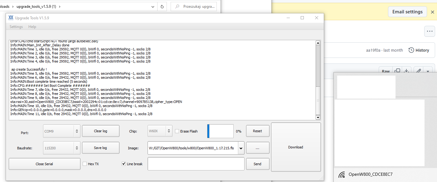

    Rate: 913

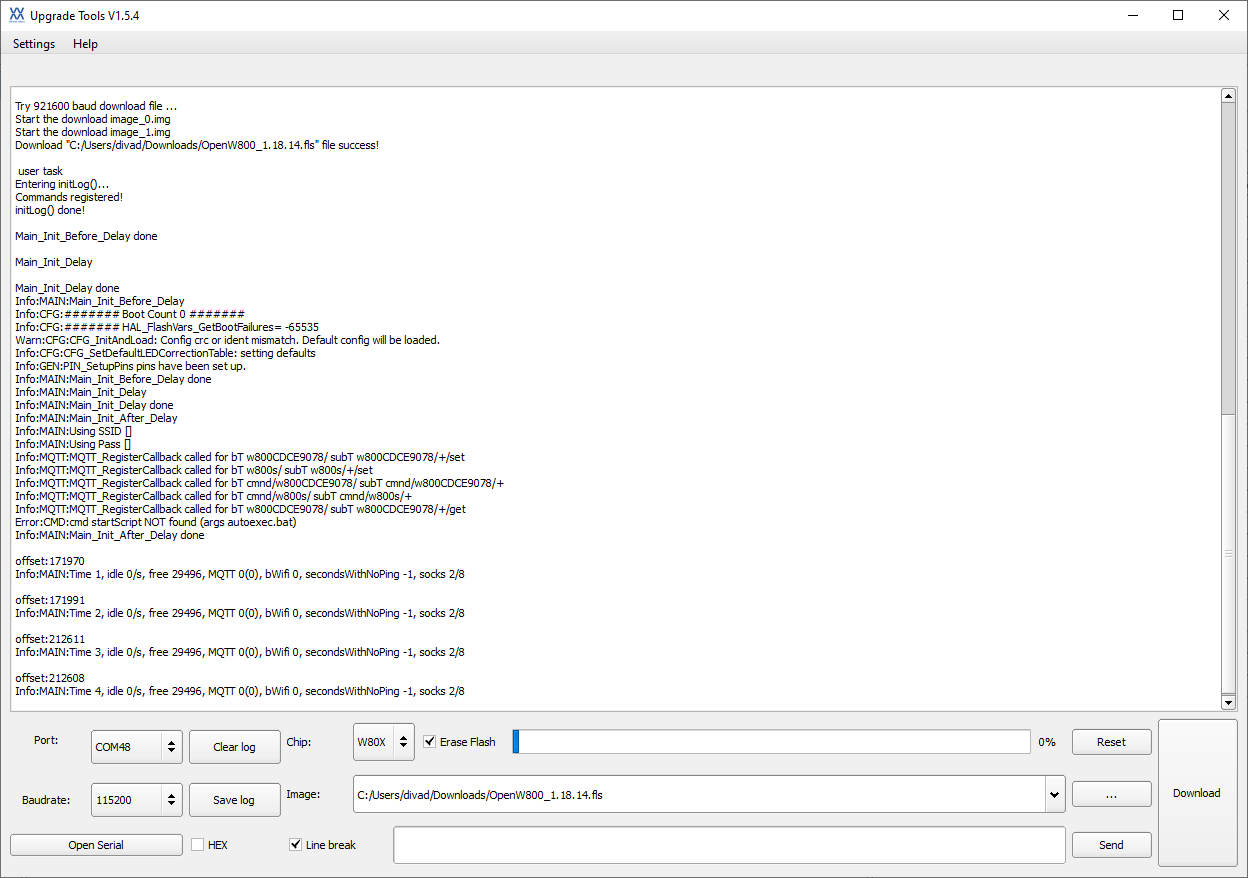

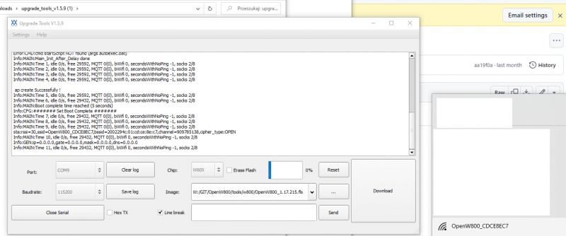

    flash then open port with log in same session HLK-W801-KIT
    Screenshot of Upgrade Tools V1.5.4 software with operational log.
    >>21385195
    doesn't sound good :(

    Iirc the logging was only visible on TX0 (PB19) - only when sending update over USB-C logging stopped and there was some "noise". I don't recall logging on the USB port.
    But @divadiow should have the same device ;-)
    Sorry to hear that. Probably it was not packed correctly during shipping :-(

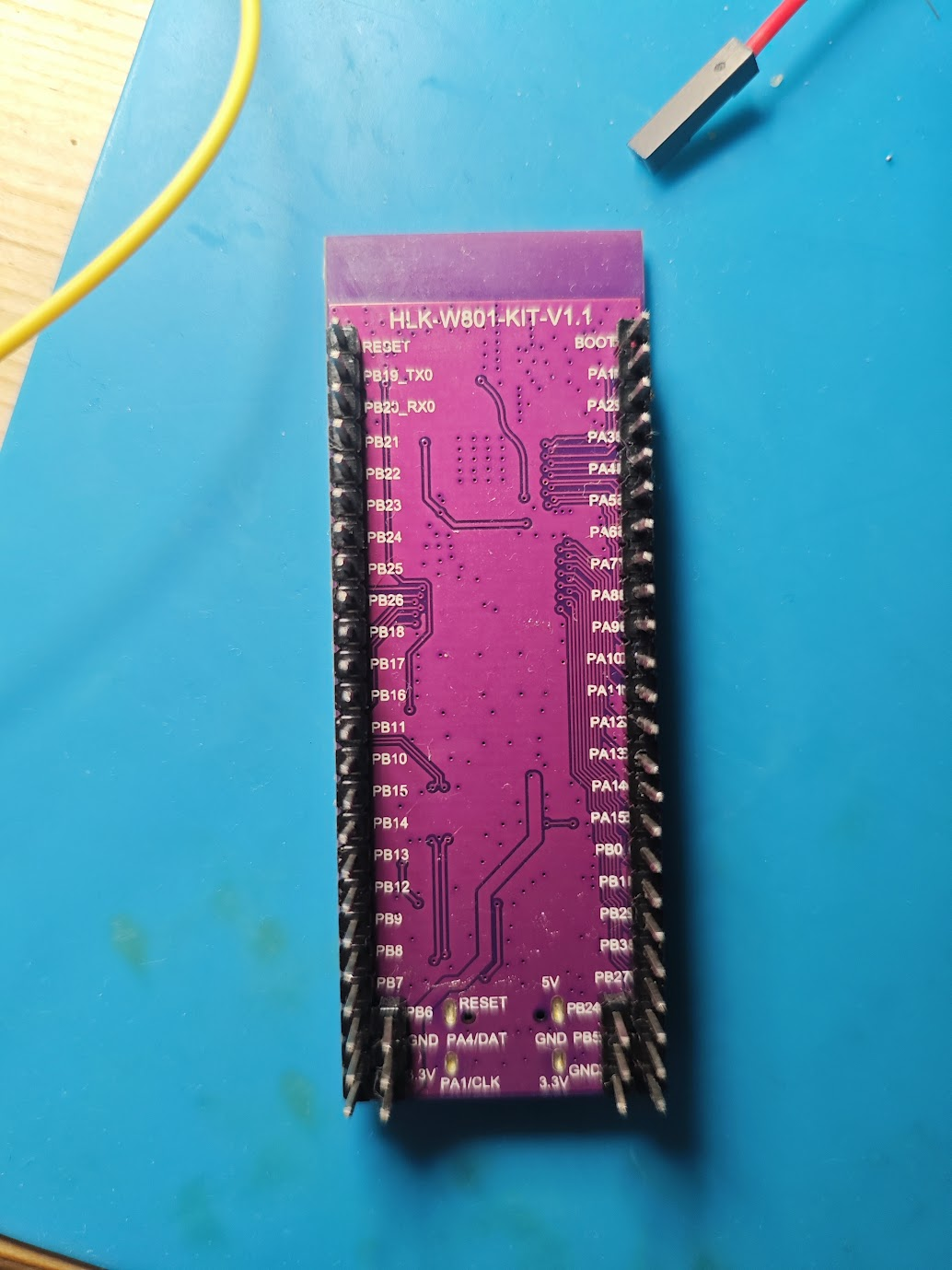

  • #34 21385216
    Posts: 5195
    Help: 446
    Rate: 913
    >>21385201
    yes. 801.
    Printed circuit board with purple laminate on a blue background. HLK-W801-KIT-V1.1 electronic module on a blue work surface.
  • Realterm open-port action pulls reset low

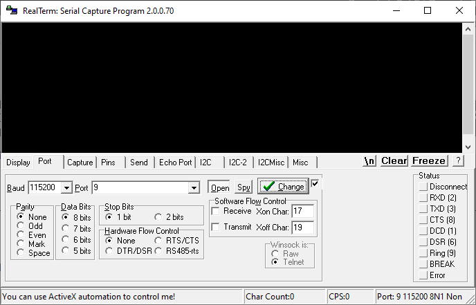

    #35 21385223
    Posts: 14743
    Rate: 12839

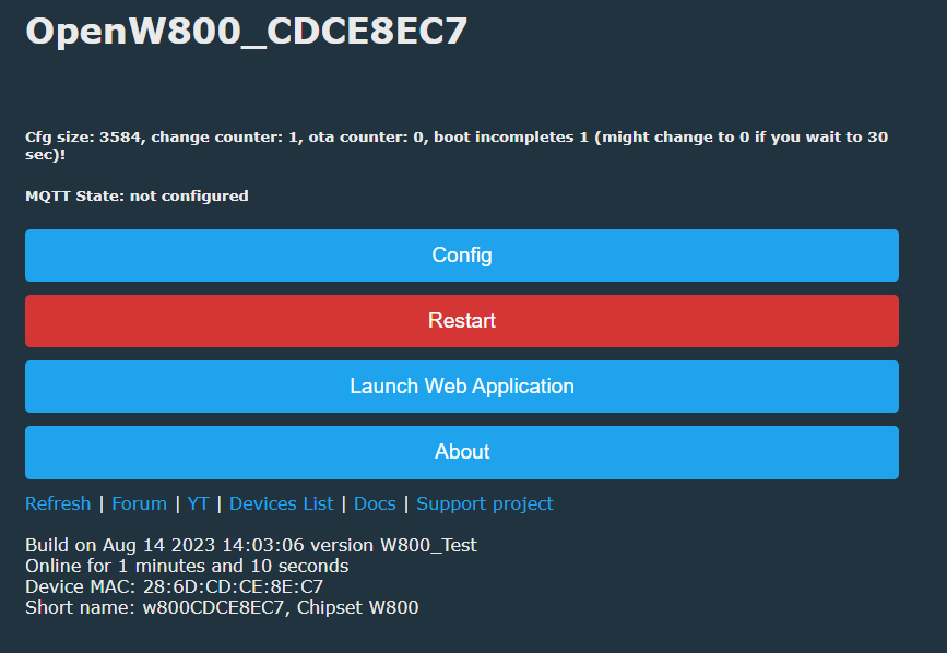

    Huh, it seems the problem is solved accidentally, but I don't know how.
    I just plugged again board, only opened tools, and got that:
    User interface of software update tool with open log and settings.
    I didn't even flash, it's still flashed by wm_tool.exe

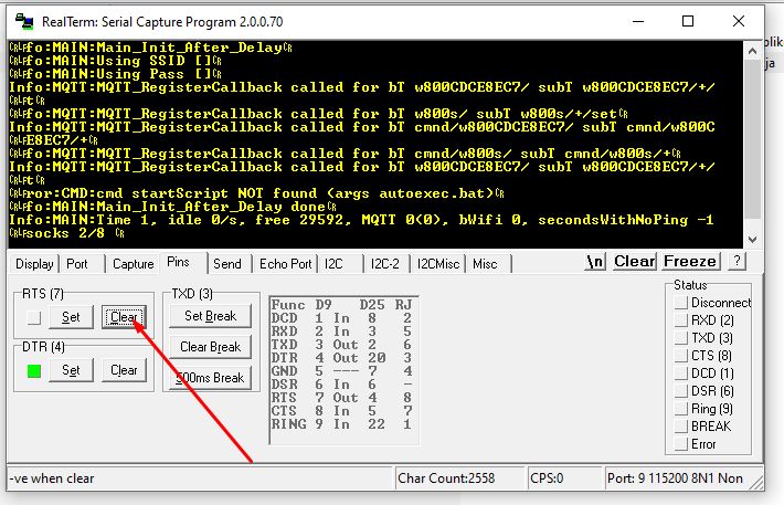

    However... it is still silent in Realterm?
    Screenshot of the RealTerm serial capture program.
    It died as soon as I stopped Upgrade Tools...
    With upgrade tools log open, it works:
    OpenW800_CDCE8EC7 user interface with navigation buttons.
    I just checked with multimeter and I can see that opening Realterm (Open port button) brings RESET from 3.3V to 0V, what's going on?
    Ah, I had to press here:
    Screenshot of RealTerm program showing terminal interface with connection data and RTS/DTR buttons.
    It seems that Realterm has played a trick on me, I didn't expect that. Does this particular board has somehow DTR/RTS role inverted or did this setting change on it's own in my Realterm?

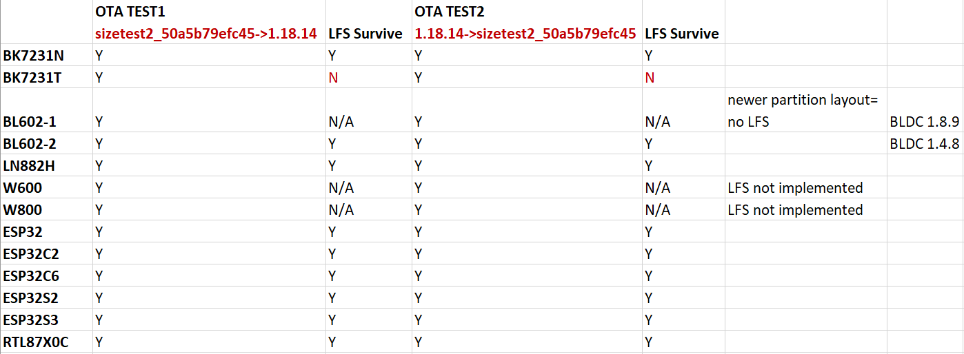

    Table with OTA tests and statuses for various chip models.

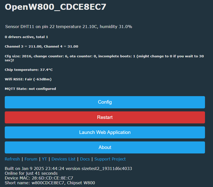

    #37 21385914
    Posts: 14743
    Rate: 12839

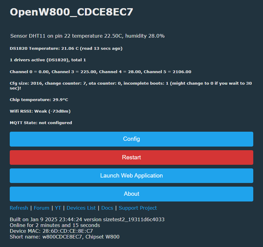

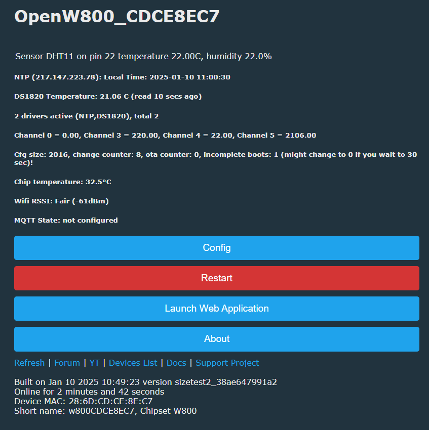

    So it seems my W800 board works. Thank you for sending it, @max4elektroda , as it's from you, unless my memory fails me...
    Now it's time for DHT test. I think it's a final thing I'll do before merging size PR:
    https://github.com/openshwprojects/OpenBK7231...mits/0094aa678b57c4855f5658c388e83977cb045a51
    Added after 46 [seconds]:
    Ok, so makefile needs update:
    Code: C / C++
    Did anyone run DHT on W800, actually?
    Ok:
    CSRCS += $(_SHARED_APP)/driver/drv_dht.c
    CSRCS += $(_SHARED_APP)/driver/drv_dht_internal.c
    Added after 9 [minutes]:
    Works:
    OpenW800_CDCE8EC7 interface screenshot displaying DHT11 sensor and system configuration information.

    updated to include BL602 with old partition layout/LFS

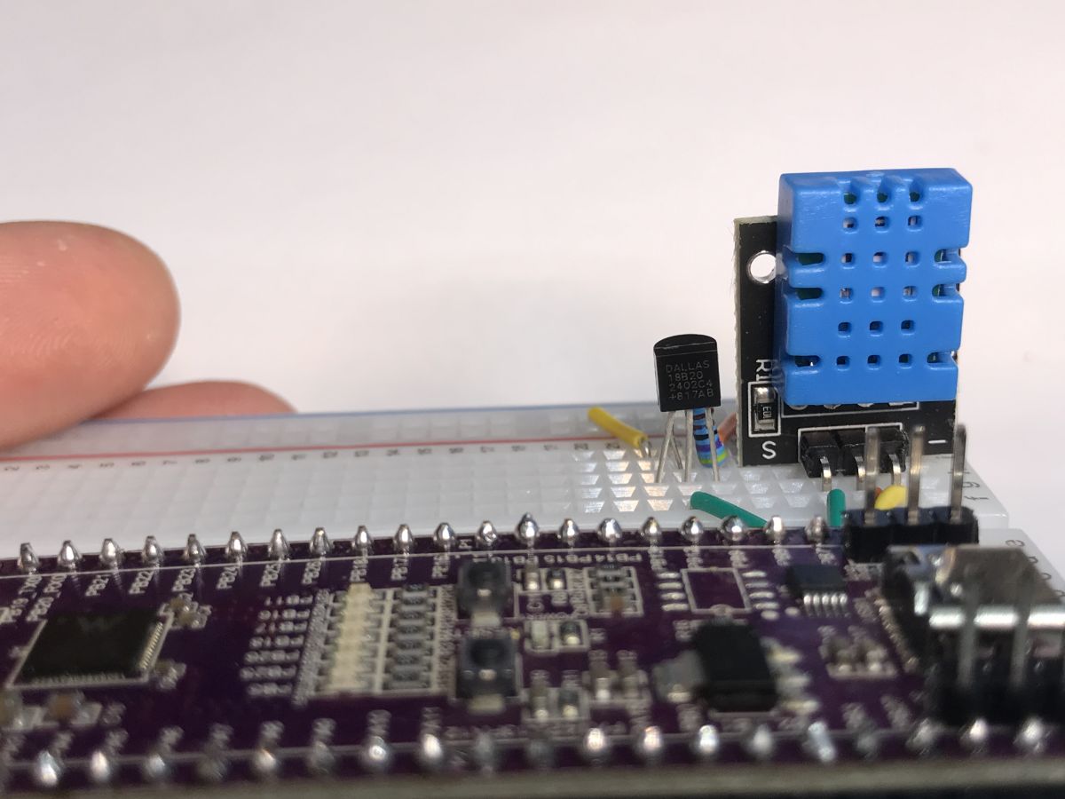

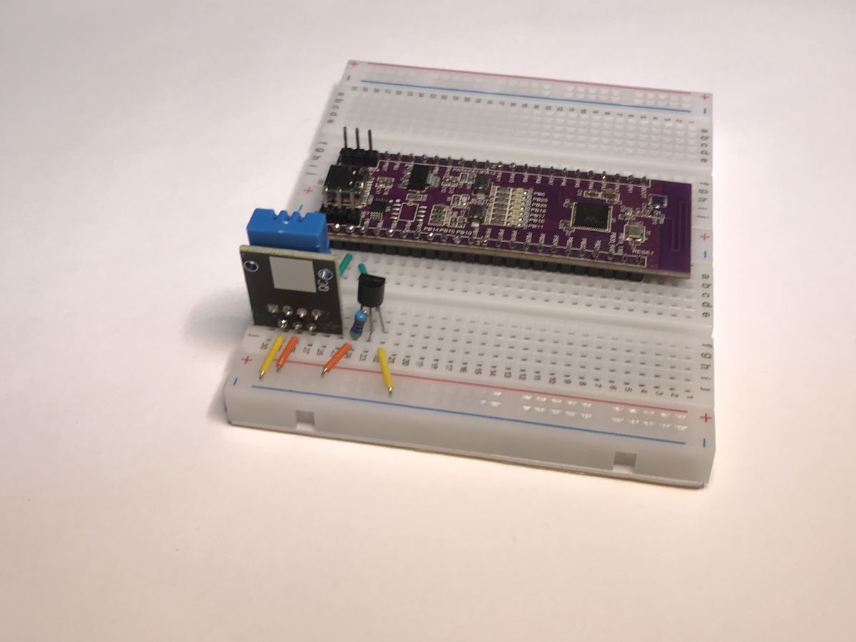

    For now, I've tested DS18B20 with W800:
    Screenshot of OpenW800 interface showing sensor data
    Test setup:
    Breadboard with a module and electronic components
    DHT11 sensor module and DS18B20 thermometer on a breadboard.

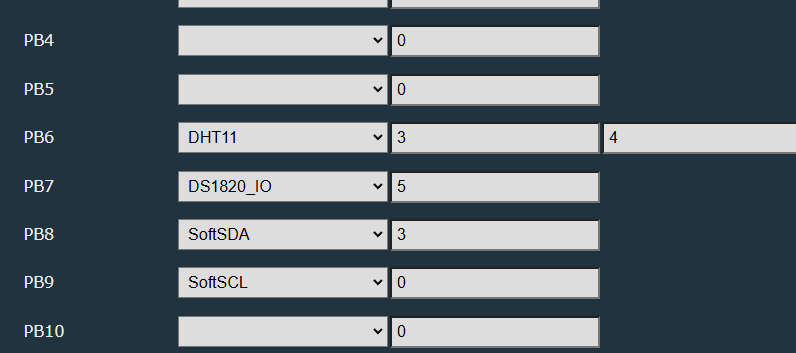

    I think I forgot about something. HASS Discovery is not enabled on W800:
    Device configuration interface with setting options.
    I need to enable it in this PR before merging...

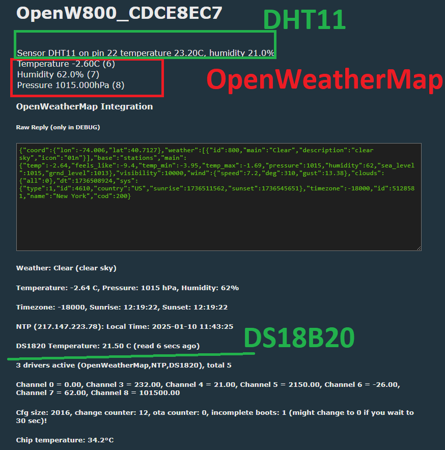

    Added after 10 [minutes]:
    Obviously, unresolved, gotta update makefile:
    ./bin/build/w800/lib/libuser.a(json_interface.o): In function `http_tasmota_json_status_TIM':
    (.text.unlikely.http_tasmota_json_status_TIM+0x8): undefined reference to `NTP_GetCurrentTime'
    (.text.unlikely.http_tasmota_json_status_TIM+0x8): relocation truncated to fit: R_CKCORE_PCREL_IMM26BY2 against undefined symbol `NTP_GetCurrentTime'
    (.text.unlikely.http_tasmota_json_status_TIM+0xe): undefined reference to `NTP_GetCurrentTimeWithoutOffset'
    (.text.unlikely.http_tasmota_json_status_TIM+0xe): relocation truncated to fit: R_CKCORE_PCREL_IMM26BY2 against undefined symbol `NTP_GetCurrentTimeWithoutOffset'
    collect2: error: ld returned 1 exit status
    Added after 14 [minutes]:
    NTP:
    Screenshot of the OpenW800 control panel displaying sensor information and configuration options.

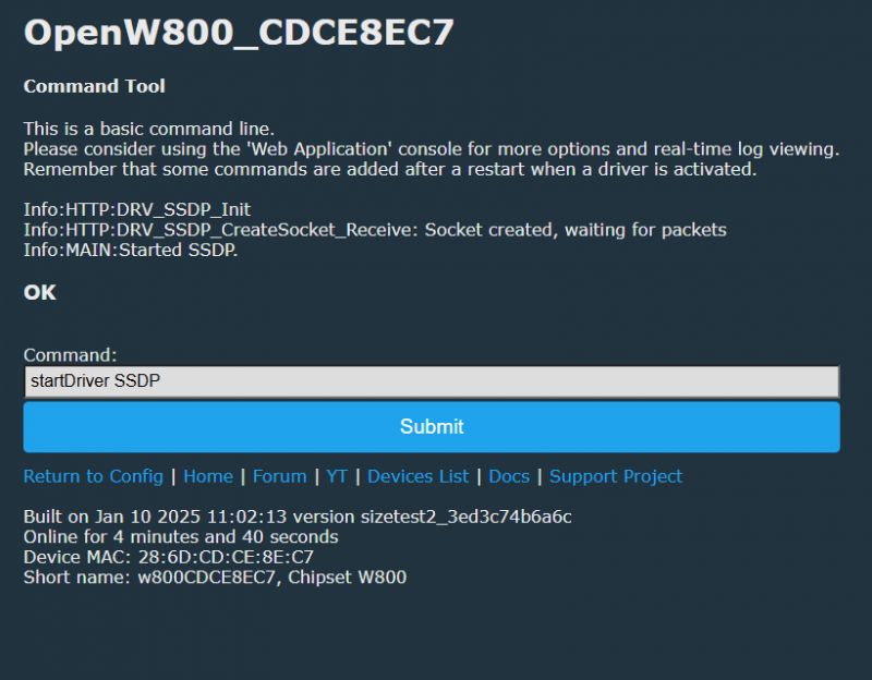

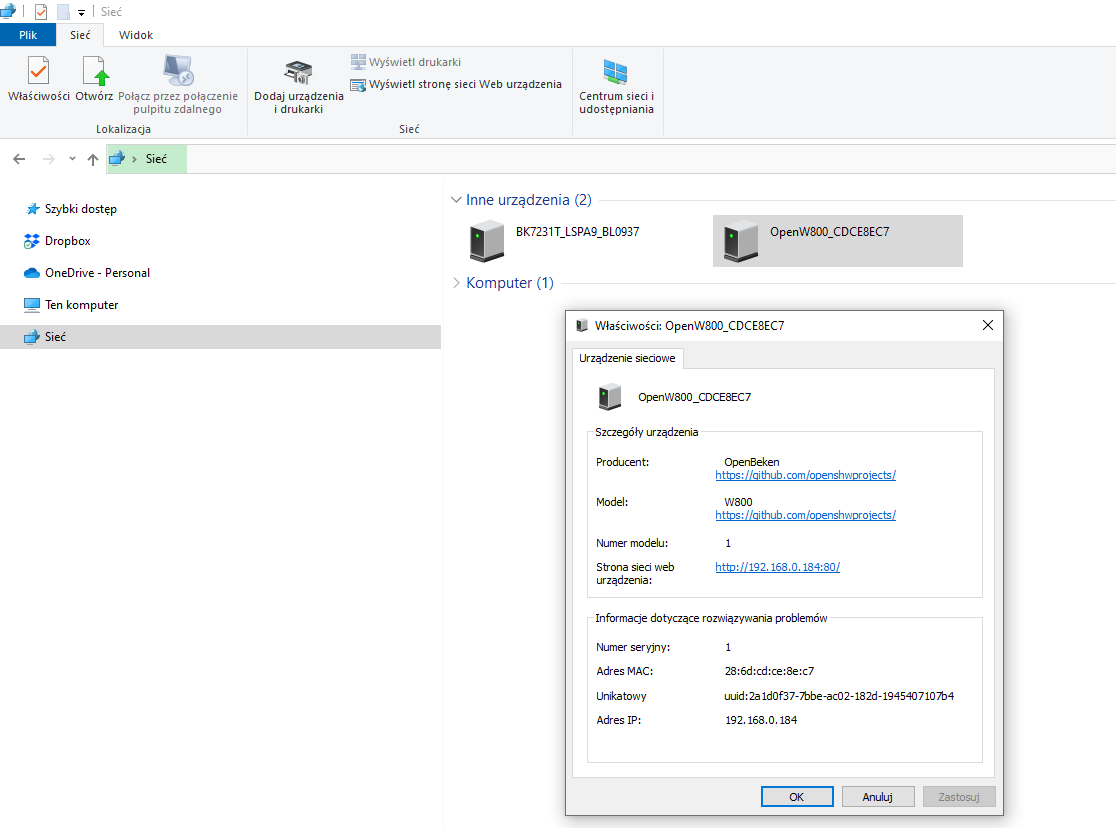

    OpenW800 command tool interface with SSDP enabled.
    Window showing network device properties of OpenW800 on a Windows computer.

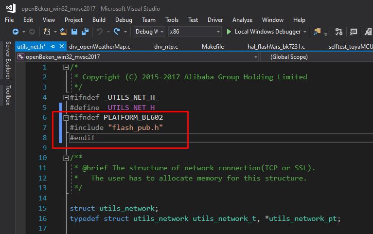

    Trying to get OpenWeatherMap to compile. What's that?
    Screenshot from Microsoft Visual Studio showing C source code related to the BL602 platform.
    I will try to sort out those includes as well in few moments.

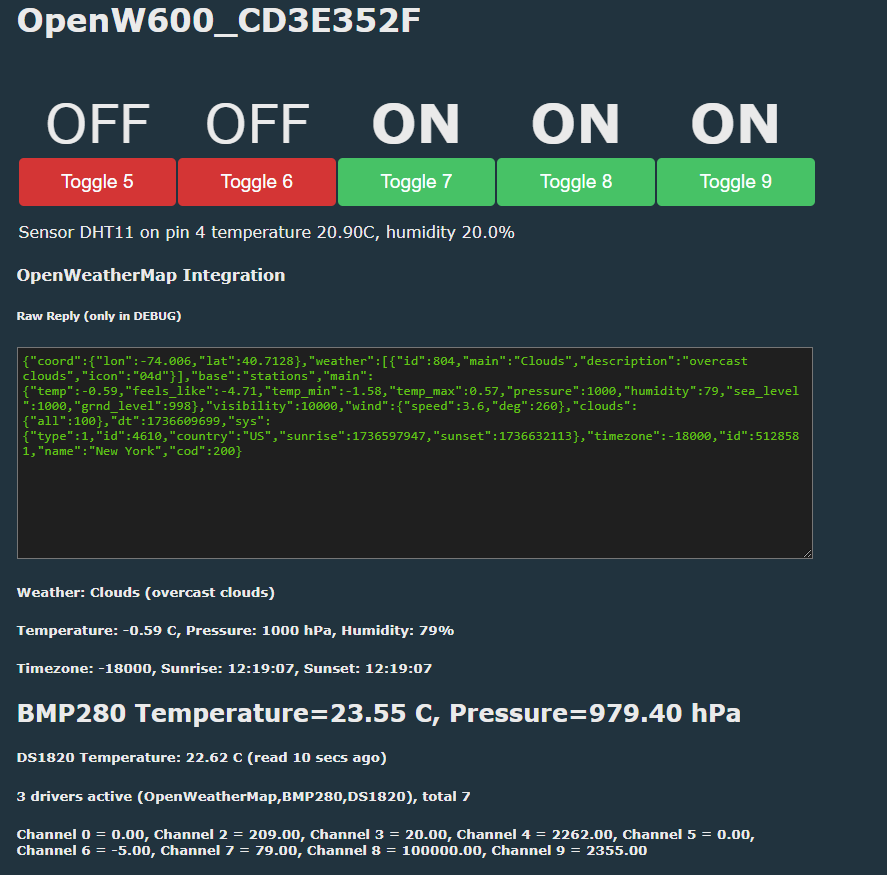

  • OpenWeatherMap setup works with channel mapping
    #42 21386446
    Posts: 14743
    Rate: 12839

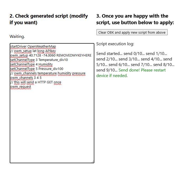

    OWM:
    startDriver OpenWeatherMap
    // owm_setup lat long APIkey
    owm_setup 40.7128 -74.0060 REMOVEDMYKEYHERE
    setChannelType 6 Temperature_div10
    setChannelType 7 Humidity
    setChannelType 8 Pressure_div100
    // owm_channels temperature humidity pressure
    owm_channels 6 7 8
    // this will send a HTTP GET once
    owm_request
    The image shows a user interface for generating scripts for OpenWeatherMap with script text and sending log.
    All works:
    Screenshot of the OpenWeatherMap integration and sensor readings from DHT11 and DS18B20.

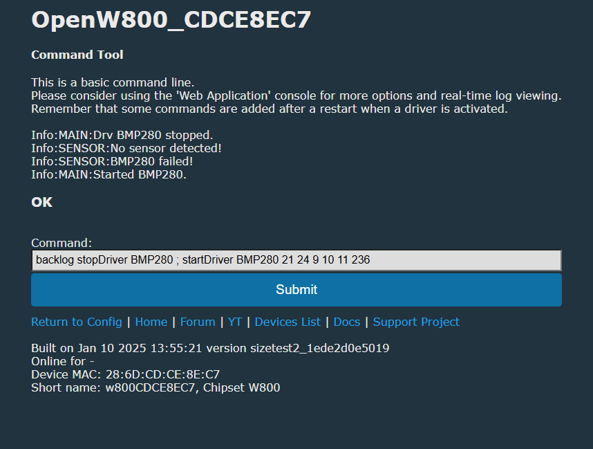

    New mail arrived, just in time:
    Two plastic bags with BMP280 and AHT20 sensors.

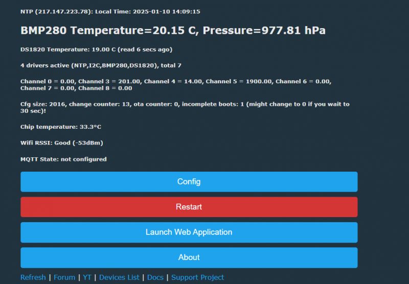

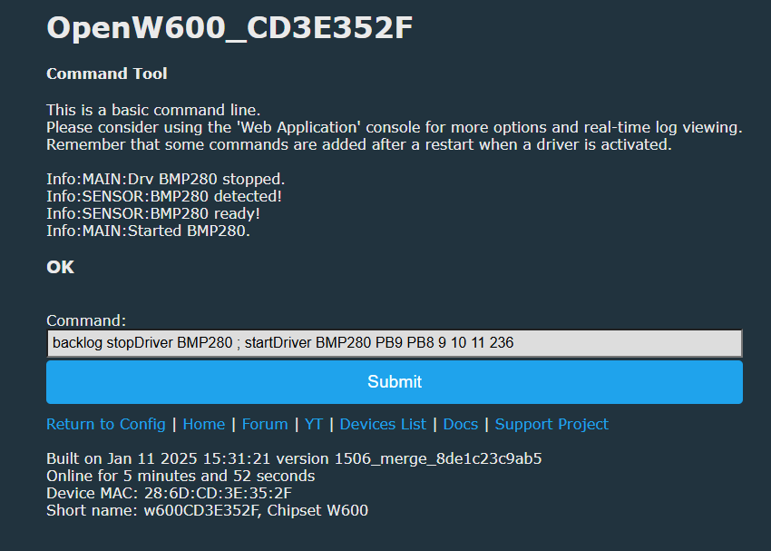

    Added after 1 [hours] 51 [minutes]:

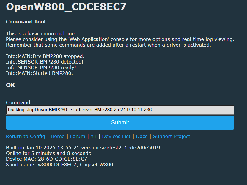

    Testing I2C software
    Table showing pin configuration for electronic devices.
    OpenW800 command tool interface displaying I2C status.
    Added after 3 [minutes]:
    backlog stopDriver BMP280 ; startDriver BMP280 25 24 9 10 11 236
    Bad pins:
    OpenW800 tool interface with BMP280 driver information.
    Correct pins:
    Screenshot of OpenW800_CDCE8EC7 tool showing a command line interface with a command to the BMP280 driver.
    Screenshot of a control panel displaying BMP280 temperature and pressure data.
    Added after 4 [hours] 41 [minutes]:
    Merged, but you can still give feedback...

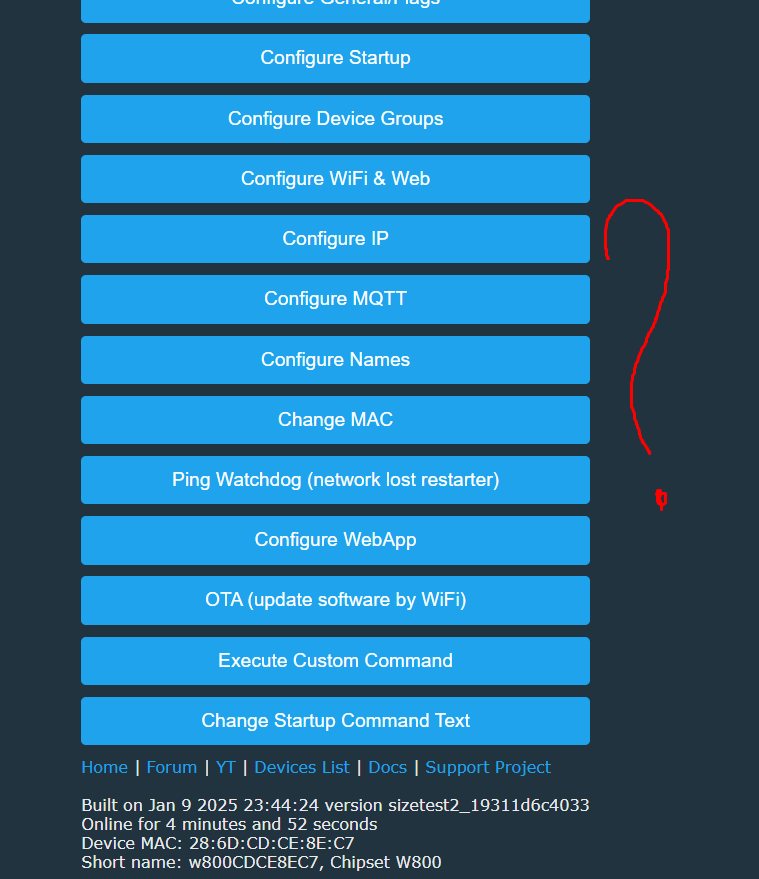

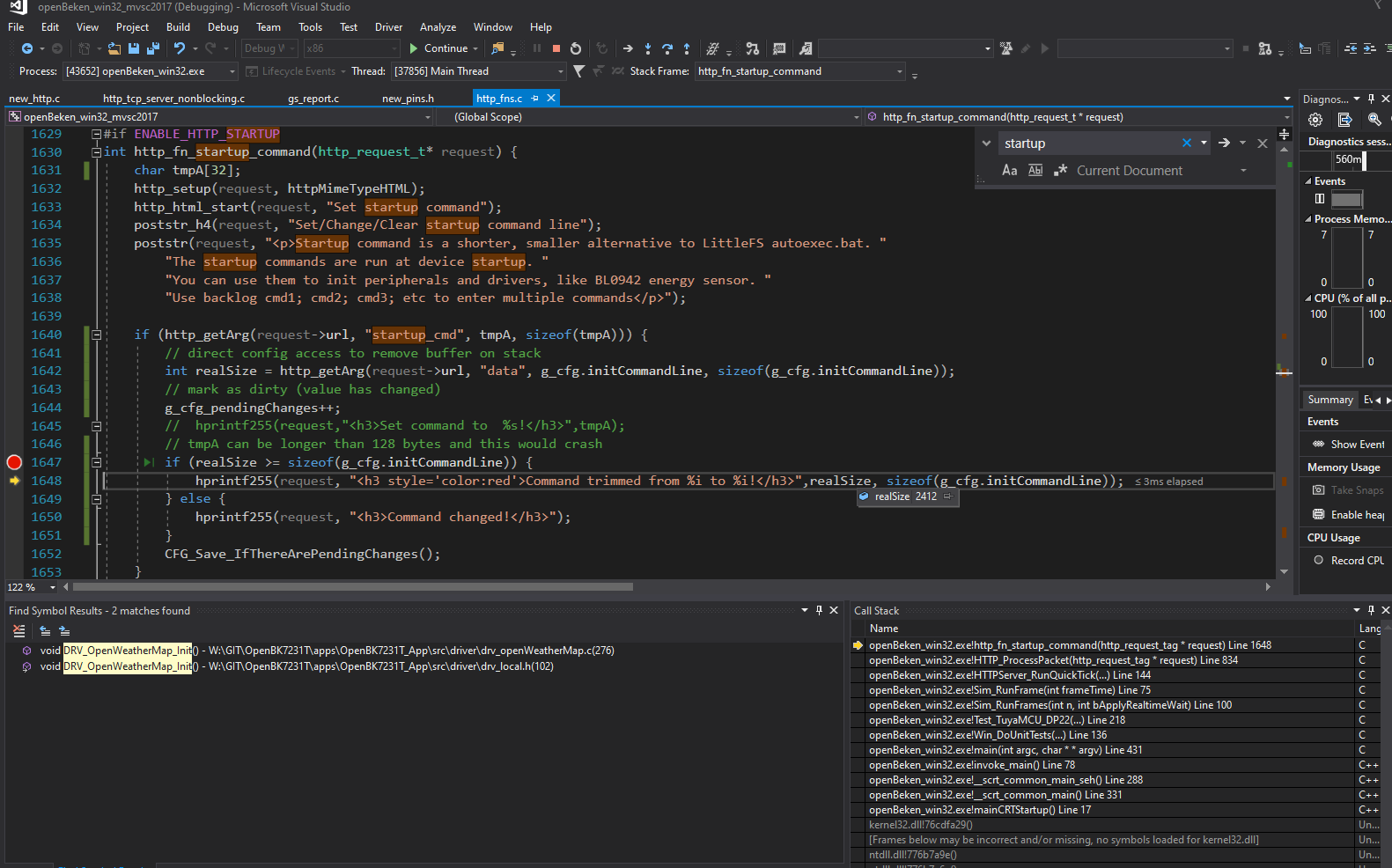

    I'm making Startup Command multiline now. If Scripting is enabled, startup will be run at script. I'm planning to merge it today, but if there is anything against it, let me know.
  • #47 21387150
    max4elektroda
    Posts: 758
    Help: 49
    Rate: 189
    That will make backlog obsolete or at least nor needed for multiple commands?
    That's a good idea!
  • Shorter binary name fixes compiler error
    #48 21387167
    Posts: 14743
    Rate: 12839

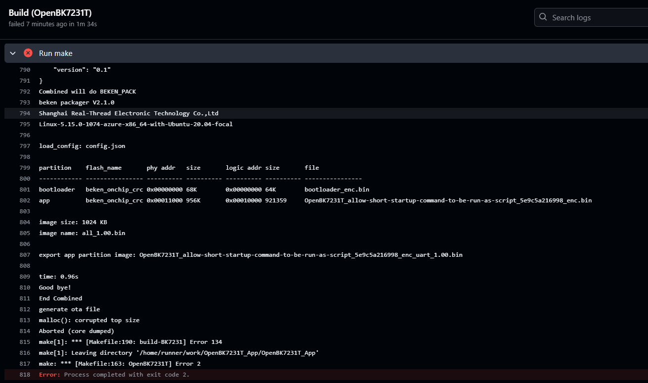

    Backlog can still be used, no problem there. I really hope I won't break stuff. I need to maintain compatibility with previous versions. I also hope that running script from there won't cause stack overflow.
    For now, I'm struggling with a strange error:
    https://github.com/openshwprojects/OpenBK7231T_App/pull/1505
    Screenshot of compilation logs for the OpenBK7231T project in Ubuntu environment, ending with an error.
    This looks like a compiler bug, not a compile error. I'm checking step by step in separate PR what causes that:
    https://github.com/openshwprojects/OpenBK7231T_App/pull/1506
    Maybe I made some silly typo, but again, the error message is so confusing.
    Added after 47 [seconds]:
    .. wait, maybe it's the long name of binary that is at fault? That would be silly!
    Added after 28 [minutes]:

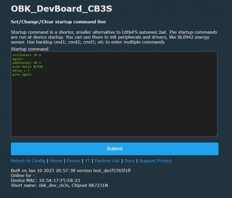

    It really works with shorter names:
    Added after 8 [minutes]:

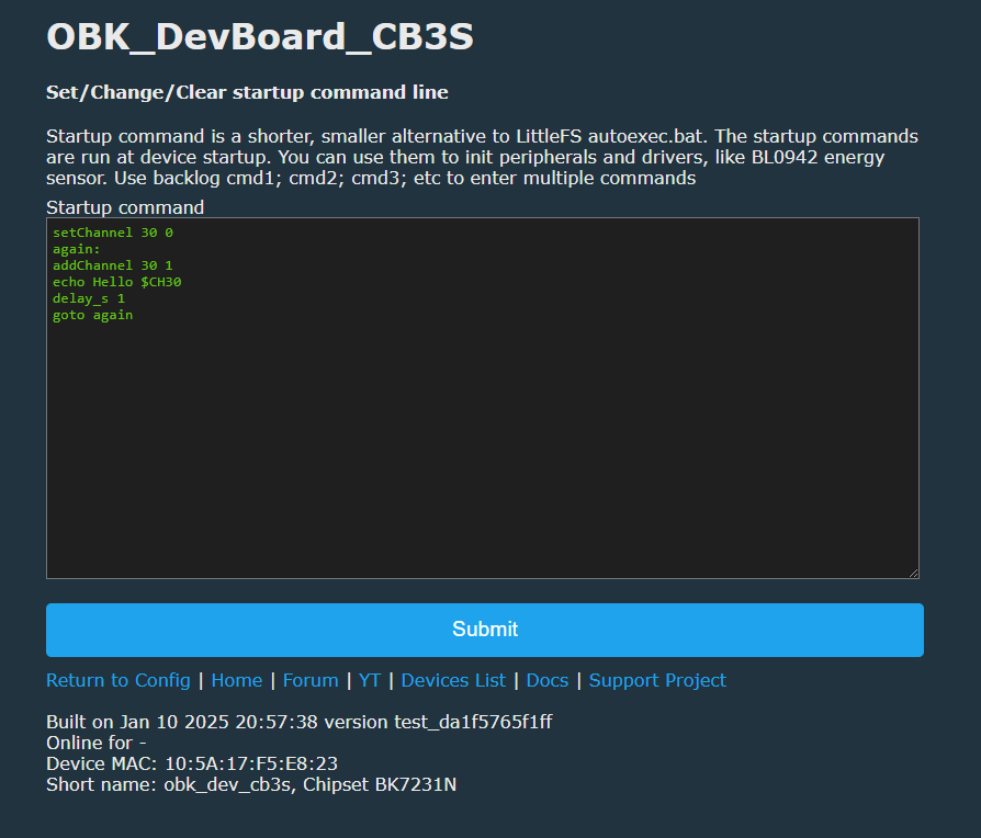

    Testing:
    Screenshot of the OBK_DevBoard_CB3S configuration panel with startup commands.
    Screenshot showing a log with information about channels and network settings.

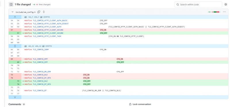

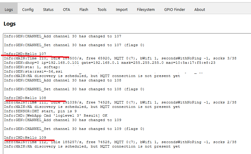

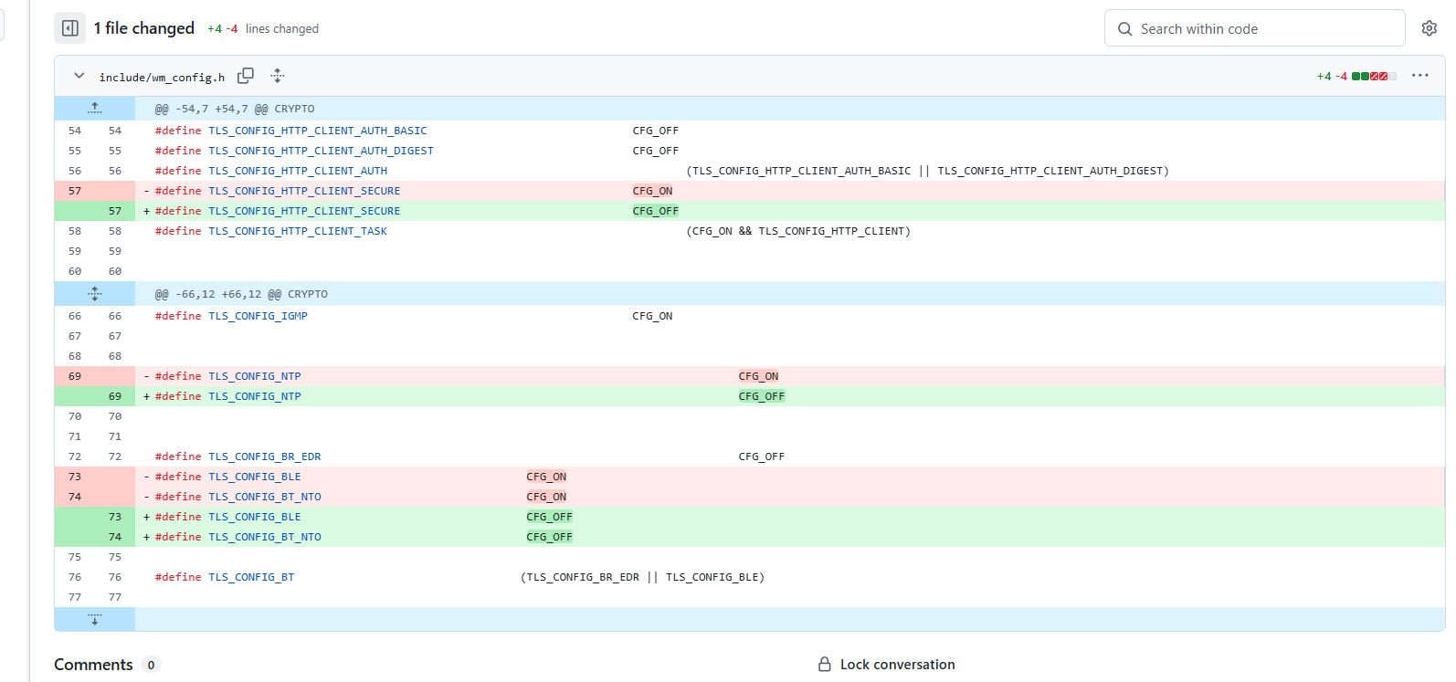

    It works now, but now W800 binary is over 1MB and OTA is broken.
    It seems its' time to disable some stuff in W800 itself:
    Code: C / C++
    So W800 comes with TLS enabled? No wonder it's 900kB without OBK drivers.
    Added after 20 [minutes]:
    I got W800 binary from 1MB to 0.55MB:
    Screenshot of changes in the configuration file from source code.
    Added after 37 [seconds]:
    Here is test script:
    setChannel 30 0
    again:
    addChannel 30 1
    echo Hello $CH30
    delay_s 1
    goto again
  • #51 21387414

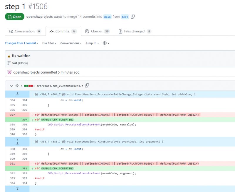

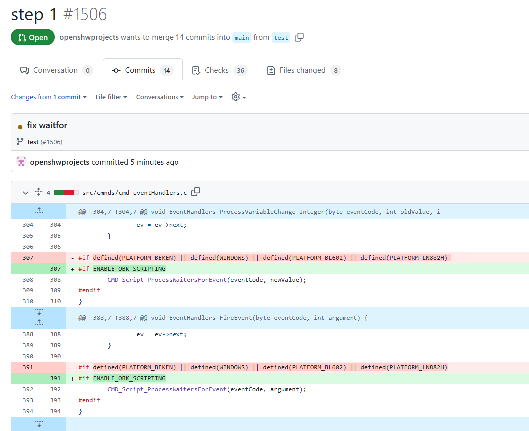

    I forgot about waitFor. waitFor was broken on new platforms:
    Screenshot of a pull request on GitHub concerning a fix for the waitFor function.
    I need testing again. Can anyone check if the new "startup command" behaviour is the same as previous? I'm worried that we might get random stack overflow at some commands that I didn't test.

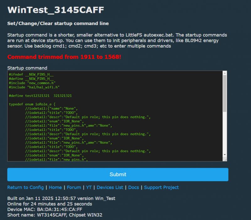

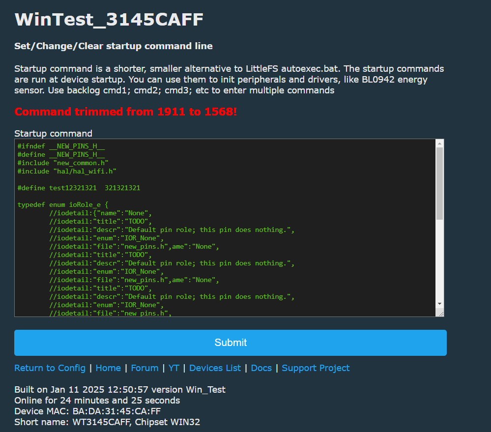

    I've found a problem.
    For this call:
    http://192.168.0.151/api/info
    JSON newlines of startup command has to be escaped.
    Added after 16 [minutes]:
    Another issue - crash.
    Steps to repro:
    - set long script in new textArea startup command
    - OTA to release
    -release crashes on boot:
    fo:MQTT:MQTT_RegisterCallback called for bT cmnd/w800s/ subT cmnd/w800s/+
    Info:MQTT:MQTT_RegisterCallback called for bT w800CDCE8EC7/ subT w800CDCE8EC7/+/
    ror:CMD:Too many args, skipped all after 32nd.
    fo:MAIN:Started DS1820.
    fo:CMD:CMD_StartScript: failed to get file autoexec.bat
    fo:MAIN:Main_Init_After_Delay done
    fset:213923
    CPU Exception : 3
    r0: 00000017	   r1: 00000000	   r2: 2000aea0	   r3: 00000000	   r4: 00000017
    r5: 20000868	   r6: 2000ae9c	   r7: 2000aea5	   r8: 2000b4d4	   r9: 09090909
    r10: 10101010	  r11: 11111111	  r12: 0000004e	  r13: 200232d4	  r14: 200232a4
    r15: 080ecbdc
    epsr: 80000341
    In safe mode you can remove startup command and reboot.
    It works now again.
    It seems like current release W800 does not like long startup commands?
    should I be entering this into the new multi-line startup command line on any particular platform you haven't tested it on?
  • Added pin-name parsing and security checks for OBK configs
    #55 21387790
    Posts: 14743
    Rate: 12839
    Wait, I am adding security checks, you can test later today:
    Screenshot of Visual Studio with source code and diagnostics window open.
    The bad thing is that I still am not sure why W800 crashed when I first set long startup command in my PR, and then updated it to old Release. Still, it seems like a somewhat rare scenario, and it's easily recoverable in safe mode. Most likely I'll just ignore that, because who would first set long script and then downgrade to old version?
    Screenshot of WinTest_3145CAFF software interface with startup command.
    Added after 3 [hours] 34 [minutes]:
    Next change - not size related, but I'm adding:
    - HAL_PIN_Find (find pin obk index by string name)
    - Tokenizer_GetPin (parses pin by string name like RB8)
    For now implemented for W800 and W600.
    Added after 12 [minutes]:
    Excellent:
    Screenshot of the OpenW600_CD3E352F interface with command inputs.
    backlog stopDriver BMP280 ; startDriver BMP280 PB9 PB8 9 10 11 236
    W600 config:
    startDriver DS1820
    // wifi wait
    waitFor WiFiState 4
    owm_setup 40.7128 -74.0060 qqqqqqqqqqqqq
    owm_channels 6 7 8
    owm_request
    setChannel 30 0
    again:
    addChannel 30 1
    echo Hello $CH30
    delay_s 1
    goto
    OpenW600 interface screen with weather information and toggles.
  • #56 21398800
    Posts: 14743
    Rate: 12839
    @divadiow can you give a quick check to this before I merge?
    at least on Beken
  • #57 21398861

    Posts: 14743
    Rate: 12839
    Just do some random tests, it should work good.
    If you have Beken with UART programmer, try flashing my PR, then set some startup command (use my loop code?) and then flash back current release and see if it works or breaks
  • GA startup command parser collapses multiline scripts
    #59 21399329
    Posts: 5195
    Help: 446
    Rate: 913

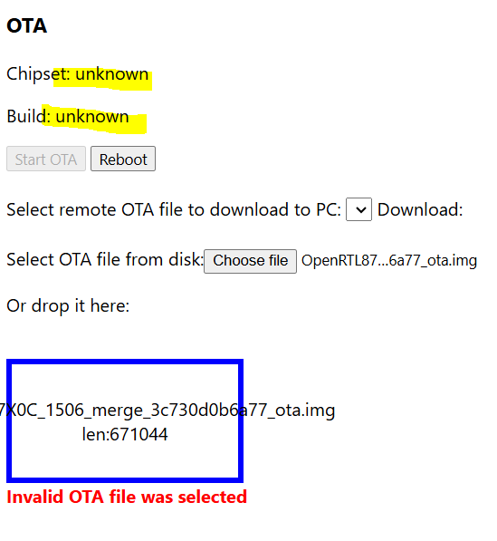

    OK,
    so with this on BK-N with 1506_merge_3c730d0b6a77
    you get all drivers starting and the looping echos
    flash back to GA and this is the startup command content
    and of course only ntp starts with that
    flash back to PR again and the startup command is back to multi-line, all drivers load and the loop runs
    Added after 43 [minutes]:

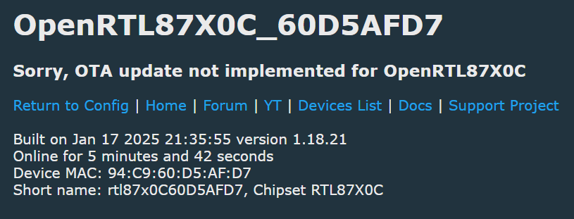

    RTL87X0C is the same up to the point where I've gone from PR->GA (with the exception of SSDP start - I guess this isn't enabled) but I can't finish with GA->PR to check multi-line is still present because sometimes this happens:
    OTA update window with invalid file selected for update.
    so you can't choose an OTA file. different browsers, incognito, device reboots, different APs (Wndows hotspot and real AP - both with internet) - at the moment OTA in console GUI isn't in place for RTL, which is usually the workaround.
    Message about the lack of OTA update implementation for OpenRTL87X0C
    Maybe it's something to do with PR builds #s? I think I've only ever seen it in testing. Not taken enough of a note to get a pattern for why.
    Anyway, that's a different thing. Also, I don't actually have BK-T with me at the moment, as previously stated.
  • Removing startup command line to fix OTA bug
    #60 21399371
    Posts: 14743
    Rate: 12839
    This OTA problem is a known bug. This is because multiline startup command can have newline characters, also known as \n, but those characters should be escaped in JSON. And they are not escaped in JSON in older builds. So, the "get chip info" API call of Web App fails, so Web App is broken as long as you have old startup command line, so it doesn't know what the platform is and can't check OTA.
    Solution - remove startup commandline text and then do OTA. Does it work?
