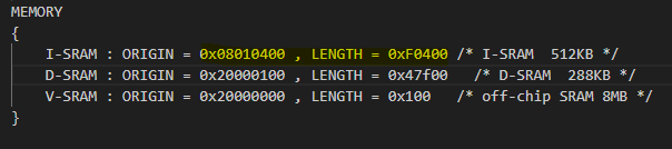

    What's going with this PR @divadiow ? Is W806 different than W800/W801?

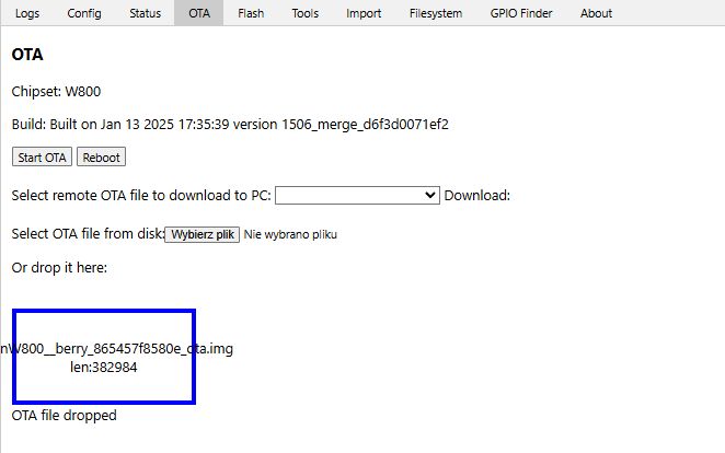

    Btw, to answer OTA question - W800 has HTTP server based OTA (old OTA style), the Web App OTA is missing.
  • W806 needs SDK changes to fit 1 MB flash

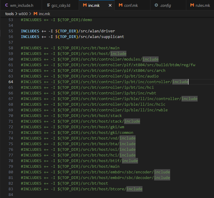

    good morning!

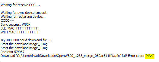

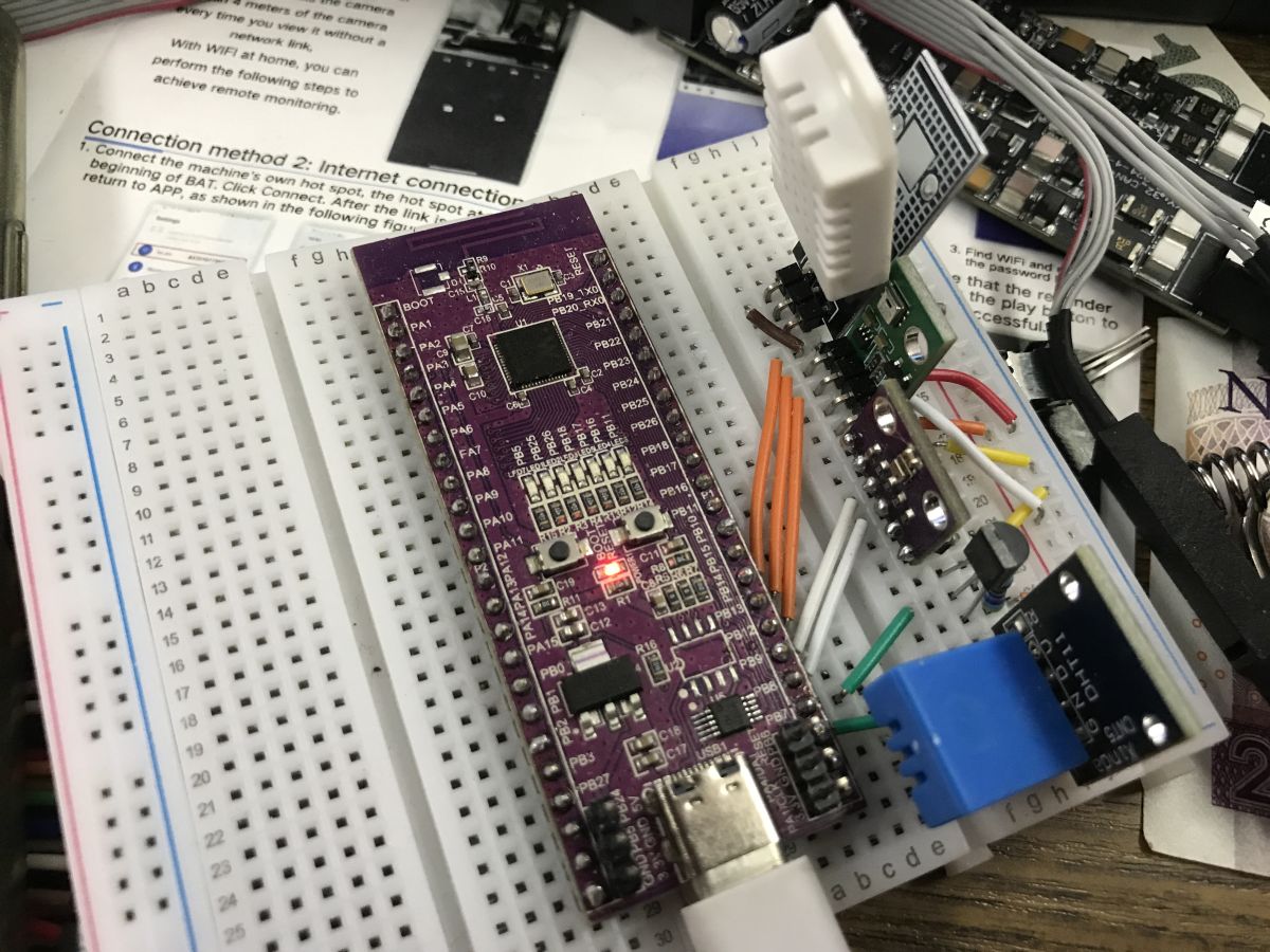

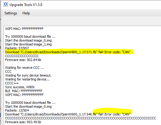

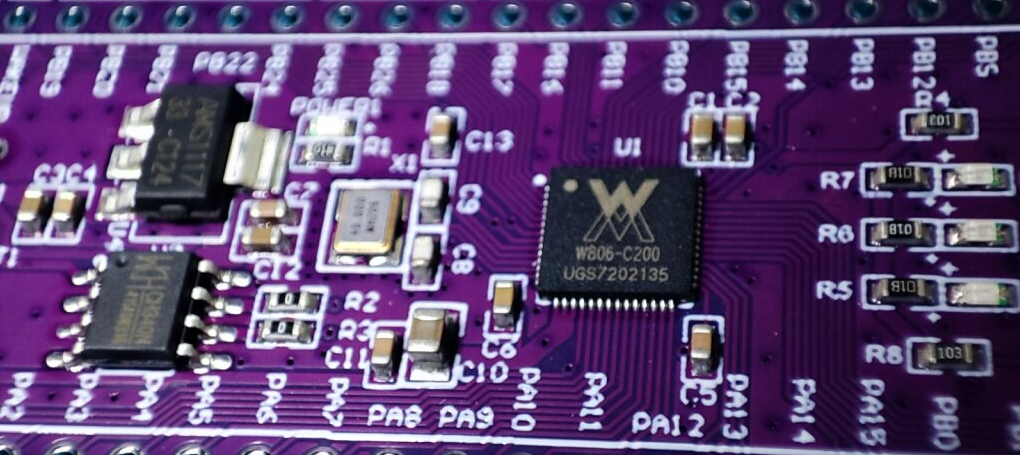

    yes, I grabbed a Hi-Link HLK-W806-Kit-V1.0 board from Ali Express a week ago as it looked just like it's sister board the HLK-W800-Kit-1.0 and I wanted to see if OBK had any chance on it. I didn't really look at the spec when I bought it, but it doesn't have wifi/BT and it only has 1mb flash!
    OpenBeken W800 vs W806 Differences and OTA Update Methods
    Without any research I tried flashing the W800 OBK but this unsuccessful, failing with this error
    which led here http://ask.winnermicro.com/question/131.html
    But then this caught my eye http://ask.winnermicro.com/question/720.html which led to this http://ask.winnermicro.com/article/186.html where this was stated:
    followed by the modifications to make to adjust SDK, which is where these initial changes were committed. https://github.com/openshwprojects/OpenBK7231...mits/53288ad592b05de359db926d30b770ef7a17e2d9
    There were some failures because of size. This I think was the size that built
    but then it would fail with
    which I can't find mention of yet. Assuming this related to size I then set about trying to exclude bits to reduce flash total bytes, but you can see from subsequent runs this has not been successful yet. I've been commenting-out bits in the SDK relating to the demo, BT etc, but nothing I've tried has reduced size.
    Even with a working OBK the 1mb flash probably makes it very limiting driver-wise, but still, it would be another supported chip to add to the list. Suggestions welcome!

    How do you know that NAK error means that flash is too big?
    What is the current flash size?
    I can add some #define for you to for example allow turning off features like Tasmota JSON emulation
  • NAK likely from missing flasher acknowledgement
    #4 21081639
    Posts: 5214
    Help: 446
    Rate: 914
    I don't. Just a stab in the dark. But maybe it's related to NACK and it's that the flasher didn't receive an acknowledgement after Packets: 57/957? I've tried different uart speeds.
    1mb!
    well that would be cool, but I am also happy to just keep playing myself if you've no time/other priorities. W806 was just a little adventure with no stakes.

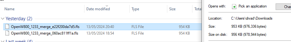

    I don't think it's exactly 1MB, what is the current size of build files?
    Can we get somehow some other binary for testing W806? I can try to help, I have linux vm, maybe we can build/compile something else together..
    I can try to add more size build reduction within 3 to 6 hours from now so you can test more.
    Screenshot showing two FLS files downloaded on a Windows computer.

    I'm trying to find evidence the W806 really does have wifi/bt cores. unsure yet
    I have a working LED blinky demo from https://github.com/tehniq3/w80x_duino?tab=readme-ov-file
    woop

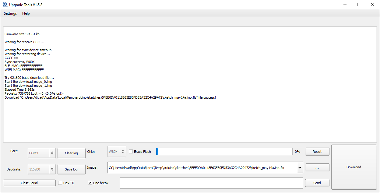

    Screenshot showing a file named sketch_may14a.ino.fls saved in FLS format, dated May 14, 2024, at 08:04, with a size of 92 KB.
    tiny arduino sketch
    Added after 42 [seconds]:
    flashes successfully in upgrade tools too
    Screenshot of Upgrade Tools V1.5.8 with uploaded Arduino sketch.

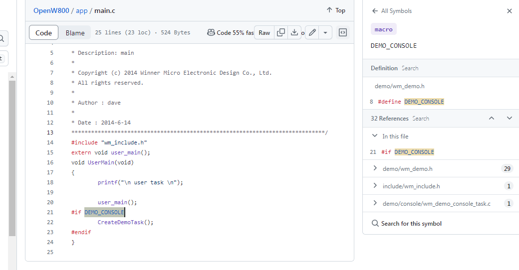

    I'd suggest trying to make a simple AP demo with that Arduino thing. I will be able to make OBK build smaller in about 2h.
    Added after 1 [hours] 51 [minutes]:
    I added ability to disable Tasmota API:
    https://github.com/openshwprojects/OpenBK7231T_App/pull/1236
    But it doesn't seem make much difference:
    W800 FLS (not OTA) - 966 824
    W800 FLS (not OTA) - 976 336

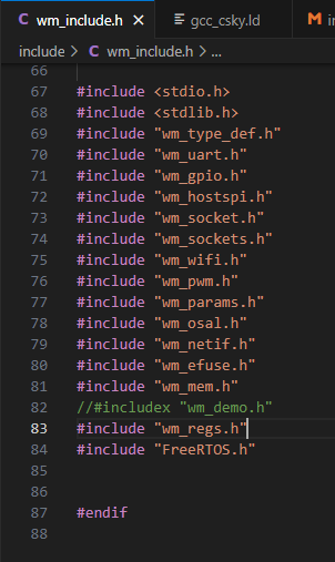

    I don't think it's OBK making that much of a difference, maybe we need to check there:
    https://github.com/openshwprojects/OpenW800
    Added after 1 [hours] 25 [minutes]:
    maybe disable that:
    Screenshot of program code in the main.c file of the OpenW800 project with a symbol search option.
  • #13 21082792
    Posts: 14756
    Rate: 12883
    So what is your current size of the build? Maybe can I help more?

    still
    Screenshot showing file size and size on disk.
    i'm probably doing something wrong. I'm commenting out/undefining but that doesn't seem to be making a difference. I'm making the changes to my OpenW800 submodule then pushing to my fork then pushing to remote main. it's triggering the workflow with the open PR so I guess my changes are making it up to the right place...
    eg https://github.com/openshwprojects/OpenBK7231...mits/492f5436757622c5e304f465f9d41e616df82927

  • Flash download fails with CAN error after erase

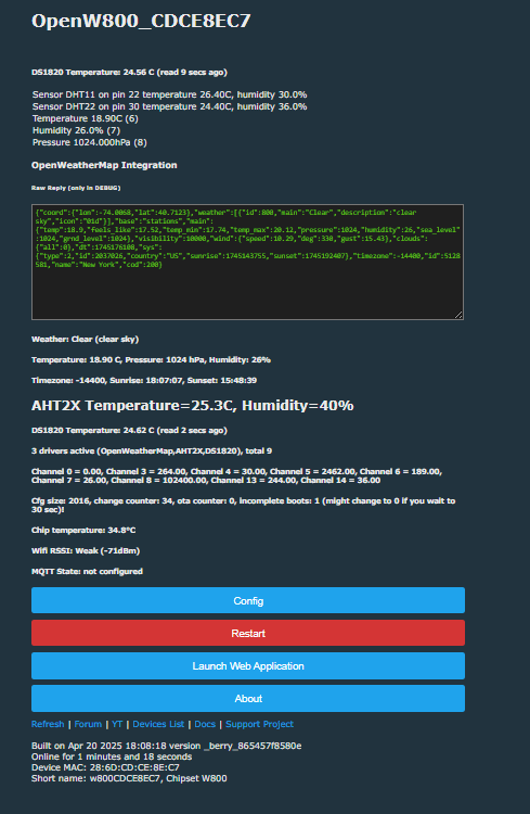

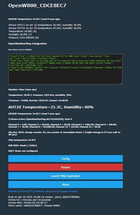

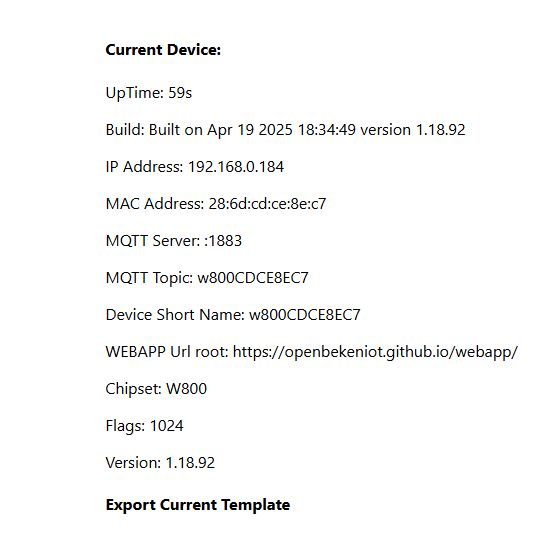

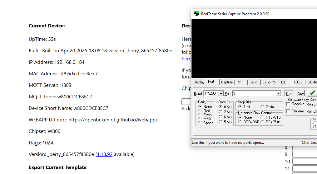

    @divadiow can you check if this version works?
    https://github.com/NonPIayerCharacter/OpenBK7231T_App/actions/runs/14562038220
    I tried to replace gcc with newlib one
    Added after 45 [minutes]:
    I found my W800 board, how to take a backup?
    It apparently came with tuya firmware, which is odd for a dev board.
    Boot log
    [01-01 18:12:15 TUYA Info][mqc_app.c:337] mqc app init ...
    -01 18:12:15 TUYA Info][uni_thread.c:205] thread_create name:sys_timer,stackDepth:4096,totalstackDepth:4096,priority:5
    18:12:15 TUYA Info][uni_thread.c:205] thread_create name:cmmod,stackDepth:4096,totalstackDepth:8192,priority:4
     TUYA Debug][mqc_app.c:148] mq_pro:5 cnt:1
    A Debug][mqc_app.c:148] mq_pro:31 cnt:2
    [01-01 18:12:15 TUYA Err][log_seq.c:849] log status is empty
    01-01 18:12:15 TUYA Debug][svc_online_log.c:293] svc online log init success
    UYA Info][uni_thread.c:205] thread_create name:wk_th-0,stackDepth:5120,totalstackDepth:13312,priority:3
    rr][tuya_ws_db.c:324] kvs_read fails gw_bi -1
    TUYA Debug][ws_db_gw.c:141] gw base read finish:-18
    12:15 TUYA Debug][tuya_bt_sdk.c:84] ty bt cmmod register finish 1
    [tuya_ble_api.c:345] ble sdk inited
    [01-01 18:12:15 TUYA Notice][tuya_os_adapt_bt.c:219] tuya_hal_bt_port_init
    a
    port inited
    YA Notice][tuya_ble_api.c:381] ble sdk re_inited
    15 TUYA Notice][tuya_bt_sdk.c:125] ty bt sdk init success finish
    0.00_PT:2.2_LAN:3.3_CAD:1.0.3_CD:1.0.0 >
    < BUILD AT:2021_07_28_00_28_32 BY maht FOR ty_iot_wf_bt_sdk_rtos AT w800 >
    IOT DEFS < WIFI_GW:1 DEBUG:1 KV_FILE:0 SHUTDOWN_MODE:0 LITTLE_END:1 TLS_MODE:2 ENABLE_LOCAL_LINKAGE:0 ENABLE_CLOUD_OPERATION:0 ENABLE_SUBDEVICE:0 ENABLE_ENGINEER_TO_NORMAL:0 OPERATING_SYSTEM:2 ENABLE_SYS_RPC:0 TY_SECURITY_CHIP:0 RELIABLE_TRANSFER:RELIABLE_TRANSFER ENABLE_LAN_ENCRYPTION:1 ENABLE_LAN_LINKAGE:1 ENABLE_LAN_LINKAGE_MASTER:0 ENABLE_LAN_DEV:1 ENABLE_LAN_DEV_MASTER:0 >
    0_light_5_rgbcw_v2 | [HW]: TW03_V2.0 | [SW]: V1.0.7 (Mar 24 2022 18:30:50) | [PID]: yqqc3anxrn4lgsyt
    ce][tuya_device.c:792] free_mem_size:86016
    APP: TLS_BLE_GAP_EVT_ADAPTER_ON
    Starting advertising
    GAP procedure initiated: advertise; _mode=2ddr_type=0 adv_filter_policy=0 adv_itvl_min=120 adv_itvl_max=120
    APP: TLS_BLE_GAP_EVT_ADV_STARTED
  • #24 21525673
    Posts: 5214
    Help: 446
    Rate: 914
    Hi thank you. I can't test until tomorrow.
    Sadly I don't believe there's any XT804 known backup method. None I've been able to find anyway. Maybe there's some xmodem way, no idea :(
  • #25 21525675
    insmod
    Posts: 1432
    Help: 168
    Rate: 455
    Then i will test it myself, i wanted to preserve the firmware before flashing, but since there is no known way...
  • #26 21525676
    Posts: 14756
    Rate: 12883
    i may have w800 if i manage to find it in this mess
  • #27 21525679
    insmod
    Posts: 1432
    Help: 168
    Rate: 455

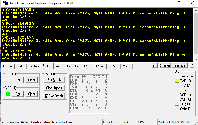

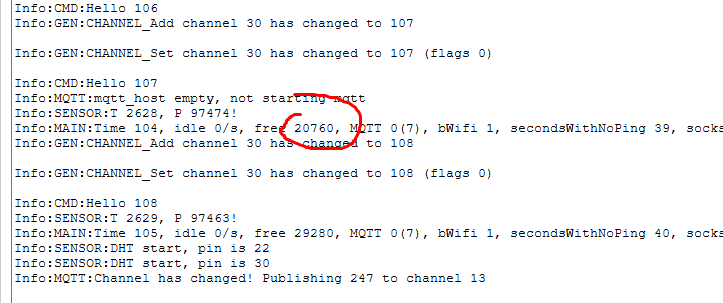

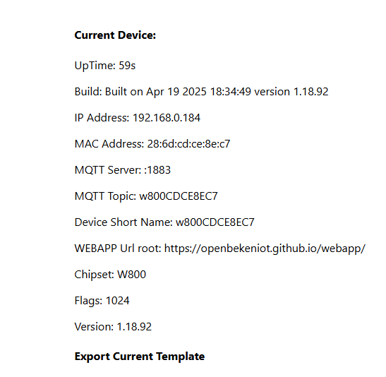

    Flashed it.
    No log output, but it boots and connects to wifi.
    The free heap space is depressing, only 29k is available.

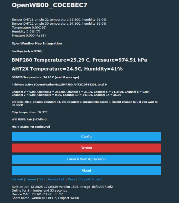

    My board:
    Breadboard with a microcontroller and several sensors connected by wires.

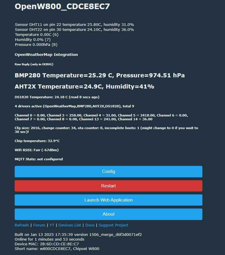

    Before flash:
    Screenshot of the OpenW800 control panel showing temperature, humidity, and pressure sensor data.
    Startup command (I am saving it mostly for myself, so I don't get lost it if I brick board):
    waitFor WiFiState 4
    startDriver DS1820
    startDriver BMP280 PB9 PB8 9 10 11 236
    startDriver AHT2X PB12 PB13 11 12
    startDriver OpenWeatherMap
    owm_setup 40.7128 -74.0060 d6fae53c4278ffb3fe4c17c23fc6a7c6
    setChannelType 6 Temperature_div10
    setChannelType 7 Humidity
    setChannelType 8 Pressure_div100
    owm_channels 6 7 8
    owm_request
    setChannel 30 0
    again:
    addChannel 30 1
    echo Hello $CH30
    delay_s 1
    goto again
    Doing OTA:
    OTA update panel for W800 chipset with uploaded update image file.
    Done, works?
    Screenshot of a web interface showing device system and network information, including IP address, firmware version, and status.
    Screenshot of an IoT device control panel showing temperature and humidity sensor readings and configuration options.

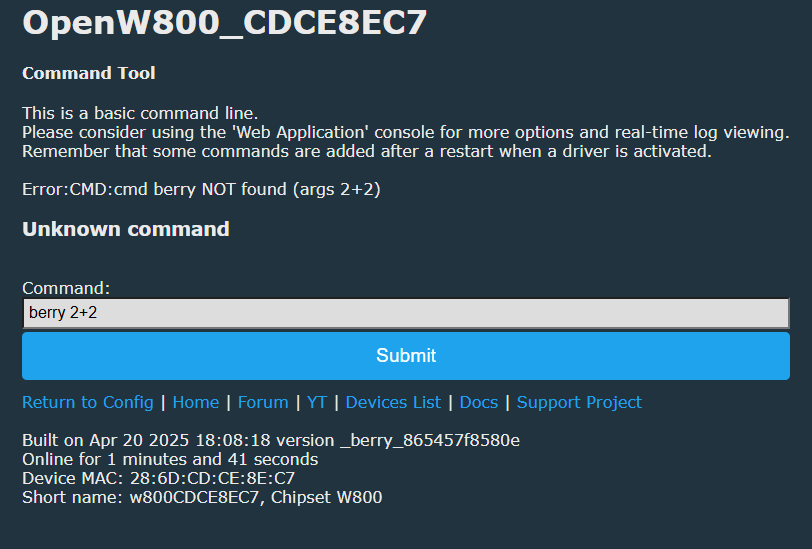

    Well, PR has "berry" in name but it has no berry I guess:
    Screenshot of the OpenW800 panel showing an error after entering the command berry 2+2 in the command line.
    Heap on your "berry":
    Info:MAIN:Time 248, idle 0/s, free 29280, MQTT 0(16), bWifi 1, secondsWithNoPing 183, socks 2/8

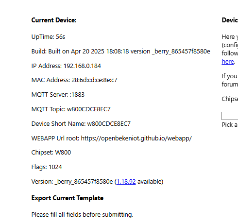

    let's flash main release and compare. Doing OTA to 1.18.92...
    Screen with hardware and network details of W800 device, including IP address and firmware version.
    Info:MAIN:Time 49, idle 0/s, free 29280, MQTT 0(3), bWifi 1, secondsWithNoPing -1, socks 2/8
    Well actually, I see no difference in heap size..
    I can get it lower with HTTP refreshes:
    Screenshot of a system log window with the number 20760 circled in red.

    Does release OBK print anything on TX0?
  • Berry build lacks log output
    #30 21525689
    Posts: 14756
    Rate: 12883
    Log output is present on main release:
    Window of RealTerm program showing serial communication logs and port control panels.

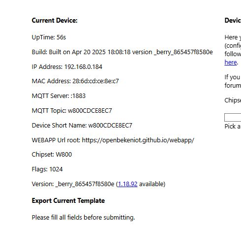

    Oops I managed to somehow break config and it's now in brand new AP state. Probably I reseted it (on main release) while it was saving flash and it has corrupted. But still...
    Back on berry:
    Screenshot showing W800 device info and an open RealTerm program window.
    I can confirm there is no log output on your "berry " build...
