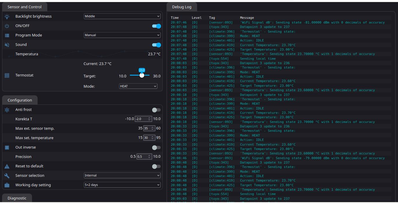

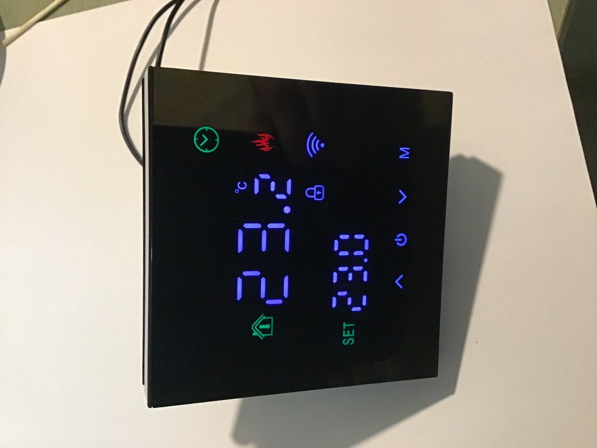

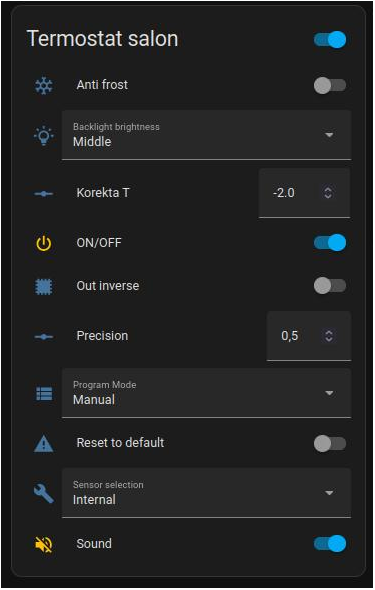

    It took a while to get it working. I ran the thermostat on ESPHome with ESP12e.
    The only thing still missing is the ability to program the days of the week. The thermostat has a choice of dividing the week into working and non-working days.
    The working day is divided into 6 time periods and the days off into 2 time periods, e.g:
    working day
    1. early morning HH:mm T
    2. morning HH:mm T
    3. midday HH:mm T
    4. afternoon HH:mm T
    5. evening HH:mm T
    6. night HH:mm T
    day off
    1. day HH:mm T
    2. night HH:mm T
    I have no idea how to make this programmable and send it to the MCU.
    But the thermostat itself is already working.

    select:
      - platform: "tuya"
        icon: mdi:view-list
        enum_datapoint: 4
        optimistic: true
        options:
          0: Manual
          1: Program
          2: Temporary program
          3: Leave home
      - platform: "tuya"
        name: "Backlight brightness"
        icon: mdi:lightbulb-on-30
        enum_datapoint: 106
        optimistic: false
        options:
          0: Dark
          1: Low
          2: Middle
          3: High
      - platform: "tuya"
        name: "Sensor selection"
        icon: mdi:wrench
        entity_category: config
        optimistic: true
        enum_datapoint: 110
        options:
          0: Internal
          1: External
          2: Both
      - platform: "tuya"
        name: "Working day setting"
        icon: mdi:briefcase
        optimistic: true
        enum_datapoint: 107
        options:
          0: Not active
          1: 5+2 days
          2: 6+1 days
          3: 7 days
      - platform: "tuya"
        icon: mdi:alert-circle
        entity_category: diagnostic
        enum_datapoint: 11
        options:
          0: No errors
          1: Err 1-Ext. sensor error
          2: Err 2
          3: Err 3

    Living room thermostat configuration panel with various settings. .
    ESPHome thermostat control panel with debug log. .
