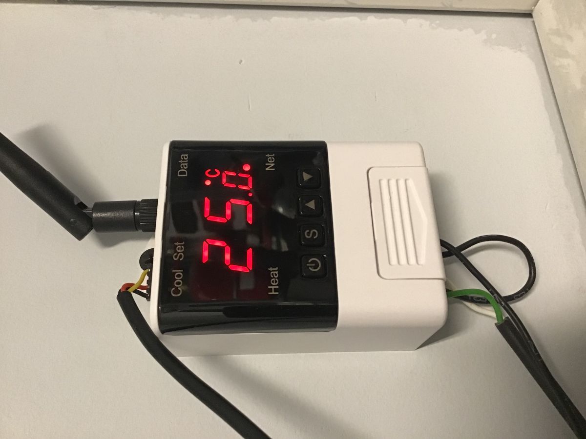

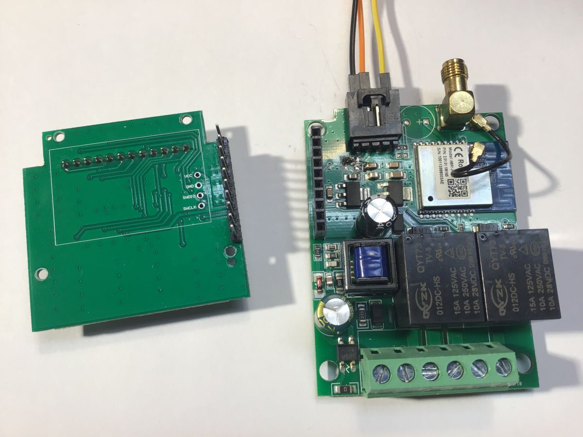

    Is it possible to do anything with the WBR1 module? Is it possible to upload an OBK? I have such thermostats for controlling underfloor heating. They are convenient because they also work without the cloud. This piece theoretically works, it has lost communication with the cloud and I cannot add it again. It turns on the pairing, the Tuya app detects it, but before it manages to add it to the cloud the pairing mode shuts down and the operation fails.
    There are integrated circuits under the display, probably one of them is an MCU. After removing the display board and MCU, the WBR1 pins are free.
    Electronic thermostat with a display showing 25 degrees Celsius, an antenna, and buttons. Electronic module with a display and buttons. Electronic module with exposed circuit board containing integrated circuits and connectors. Close-up of a circuit board with a WBR1 module, antenna, and wired connector. WBR1 module on a circuit board with visible electronic components and pins. Close-up of a circuit board with a WBR1 module, antenna, and wired connector. WBR1 module on a circuit board with visible electronic components and pins.

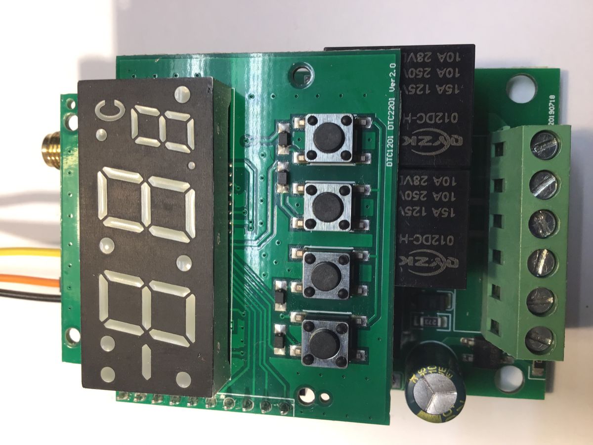

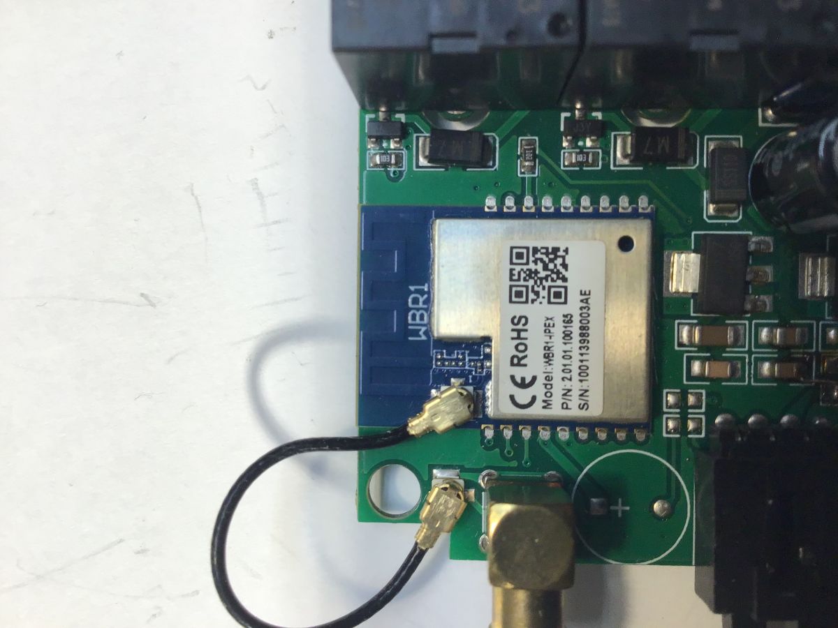

    I took the display out to see what was underneath.
    HC32F005C6PA - I think that would be the MCU, and 74HC595D - that's the driver for the display.
    Printed circuit board with electronic components on a pink background. .

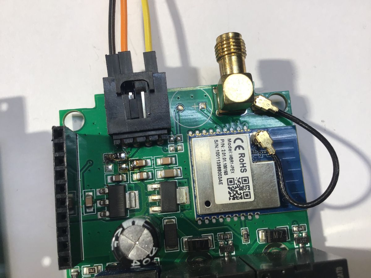

    The cloud connection issue is also now cleared up, my WBR1 is faulty as it gets a 5V supply. I converted the DS18B20 power supply to 5 volts because the controller is in the boiler room, and the DS18B20 sensor itself on a long cable and at 3.3 volts was reporting errors - I didn't notice that by hooking up the DS to 5 volts I was also powering the WBR. It worked like this for over a year. The question is whether it is possible to replace the WBR1 with something?
  • WBR1 appears to be only a UART bridge
    #3 21371186
    GAAD
    Posts: 289
    Rate: 19

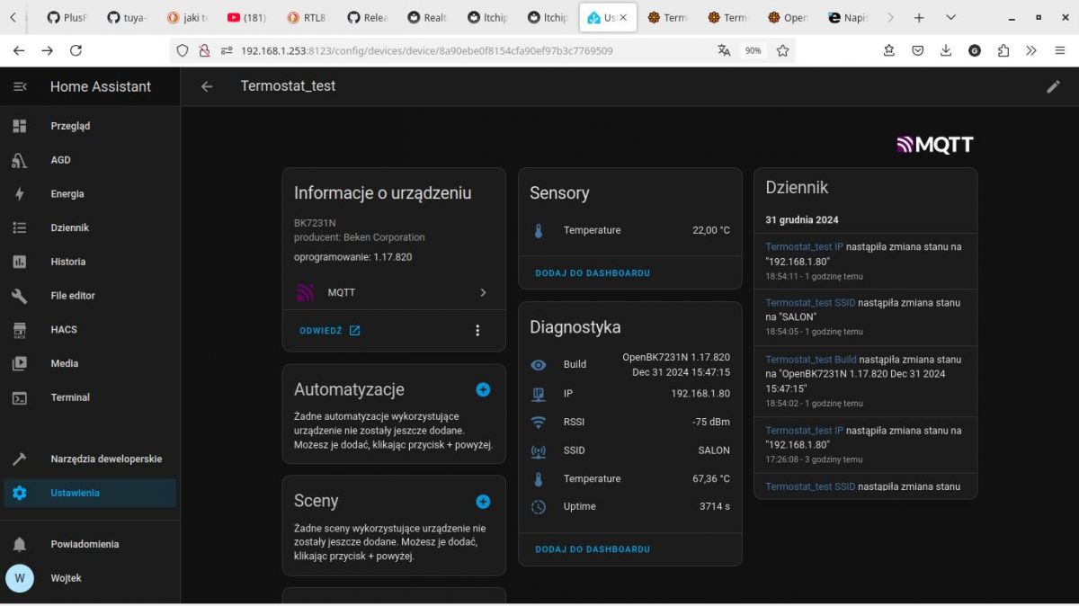

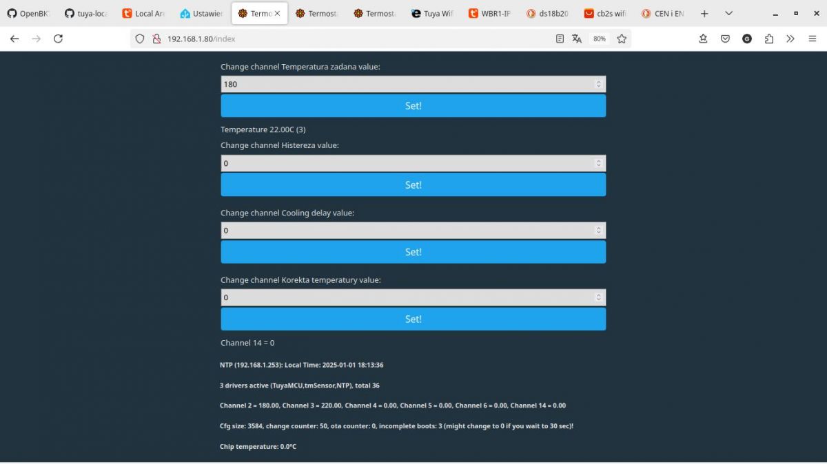

    Instead of the WBR1, I connected a Wi-Fi module removed from another Tuya device.
    OBK uploaded.
    It seems to me that the WBR1 itself is only used here for communication, it only has power, Rx, Tx for communication with MCU and EN connected.
    OBK configuration:
    startDriver NTP
    ntp_setServer 192.168.1.253
    waitFor NTPState 1
    ntp_timeZoneOfs 1
    startDriver TuyaMCU
    startDriver tmSensor
    setChannelType 3 temperature_div10
    linkTuyaMCUOutputToChannel 3 val 3

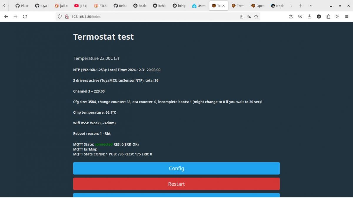

    That is, the temperature measurement works, it even displays itself correctly in the HA.
    The thermostat itself "in manual mode" too.

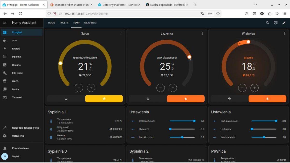

    Is there any chance to refine the commands to make it a fully functional thermostat in HA?
    Thermostat test configuration page with temperature and connection information. .
    Home Assistant user interface displaying thermostat BK7231N information

    Info:GEN:dhcp=0 ip=192.168.1.80 gate=192.168.1.1 mask=255.255.255.0 mac=1c:90:ff:cd:73:cd
    Info:GEN:sta:rssi=-70,ssid=SALON,bssid=10:fe:ed:76:04:0c,channel=6,cipher_type:Error
    Info:TuyaMCU:Received: 55 AA 03 07 00 08 03 02 00 04 00 00 00 DB F5
    Info:TuyaMCU:ProcessIncoming[v=3]: cmd 7 (State) len 15
    Info:TuyaMCU:ParseState: id 3 type 2-val len 4
    Info:TuyaMCU:ParseState: int32 219
    Info:GEN:CHANNEL_Set channel 3 has changed to 219 (flags 0)
    Info:TuyaMCU:Received: 55 AA 03 07 00 08 03 02 00 04 00 00 00 DA F4
    Info:TuyaMCU:ParseState: int32 218
    Info:GEN:CHANNEL_Set channel 3 has changed to 218 (flags 0)
    Info:TuyaMCU:Received: 55 AA 03 04 00 00 06
    Info:TuyaMCU:ProcessIncoming[v=3]: cmd 4 (WiFiReset) len 7
    Info:TuyaMCU:ProcessIncoming: 0x04 replying
    Info:GEN:sta:rssi=-69,ssid=SALON,bssid=10:fe:ed:76:04:0c,channel=6,cipher_type:Error
    Could the cause be an unconnected EN?
    autoexec:
    startDriver NTP
    waitFor NTPState 1
    ntp_timeZoneOfs 1
    startDriver TuyaMCU
    SetChannel 2 keywords
    SetChannelLabel 2 "Temperatura zadana"
    GetChannel 2
    SetChannel 4 keywords
    SetChannelLabel 4 "Histereza"
    linkTuyaMCUOutputToChannel 4 val 101
    SetChannel 5 keywords
    SetChannelLabel 5 "Cooling delay"
    linkTuyaMCUOutputToChannel 5 val 102
    SetChannel 6 keywords
    SetChannelLabel 6 "Korekta temperatury"
    linkTuyaMCUOutputToChannel 6 val 103
    Thermostat configuration screen with channels and values. .
    Is it possible to configure channels above 100 to read/set these parameters via Wi-Fi? It is not necessary, but it may be possible.
    How to configure channel 14 to read the operating status of the heating relay?
    How to configure the OBK to report to the HA as a thermostat? Perhaps it would be possible to control it via BetterThermostat?

    It works and I think it's the way I wanted it to but on ESPHome.
    I haven't configured cooling because I control the floor valves purely as heating.
    Home Assistant dashboard displaying temperature and heating data for various rooms. .

    I had to replace the WBR module with ESP02.
    But I have successfully replaced the original software in many devices.
    I mostly use the programmer:
