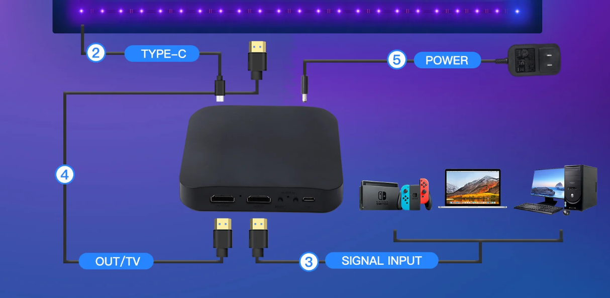

    Hi. I have a Samsung QE55Q77DAT 55 TV and have purchased a MOES Smart WiFi Ambient Lighting TV Backlight 4K HDMI 2.0 Sync Box and an HDMI 2.1 4x1 SWITCH 8K 4K. How do I hook this up so it works with my 2 consoles and TV decoder?
    AI: What models of consoles and TV set-top box do you want to connect to the TV? .
    Xbox Series and PS5

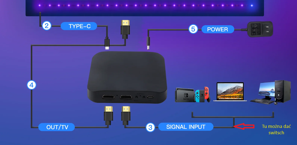

    The first, is a fab that uses the name Ambient ( not even lying next to the real one ) . ( no offence to my esteemed colleague )
    As for the connection, the pics will probably explain everything
    Diagram showing the connection of a multimedia device to a TV and other devices.
    Diagram showing the connection setup for a device with HDMI, Type-C, and power ports. .

    >>21394121 It's just that when I hook it up like this, it doesn't work, hence my post here. There is no image. Yes, I know it's an imitation.

    >>21394791 Now there was another attempt to hook up. Cables new and old all work. As it plugs in with the switch, there is a picture for 5 seconds, after 5 seconds the TV recognizes by itself what device is plugged in and changes the name of the HDMI port to Xbox or PS5.
    After this automatic operation, because unfortunately it is not possible to switch it off (unless I cannot find it in the options), it shows a message that there is no connected equipment and an icon that the device is switched off (of course it is switched on). If I plug the console directly into the switch, it works. That's why I bought the swich, so I don't have to rewire the cables.

    You have used the Connection Guide function ( HDMI troubleshooting )
  • #7 21395000
    lukasz10874
    Posts: 8
    >>21394985 of course it does. There are no problems at all. When I unplug the switch, the bar lights up.

    Have you tried the on/Off HDMI-CEC option on this HDMI input.
    Unless you have hit ... on a state not liking this TV equipment
    - TV reset
    - update
    - reconfiguration
    - manual addition of equipment
    - faulty HDMI cables
    - TV does not like this device
    End of possibilities

    The switch is working normally. I’ve now connected the switch and the consoles to it, but there was no automatic device detection. When I changed the source on the switch, the devices weren’t detected. The TV is new and up to date. The cables are new. When I connect the Moes to the switch, and then connect the consoles or the TV to the switch, the devices are added automatically. I don’t have the option to turn this off. I looked in the manual yesterday, as well as on various forums, but couldn’t find any information on this.

    There’s just one setting that doesn’t make any difference. I gave it another go before heading off to work. I reckon it’s down to the refresh rate of the TV or the console.

    After a few days, I now know more. The problem was that the bar supports 60 fps. Now almost everything works, because, for example, in a game you can change frames, but the TV recognizes the possibility to play in 120 frames and then the bar does not work. Changing the image from game mode to HDR or other modes does not help. So far only one case of this has happened with Monster Hunter Rise on PS5.
