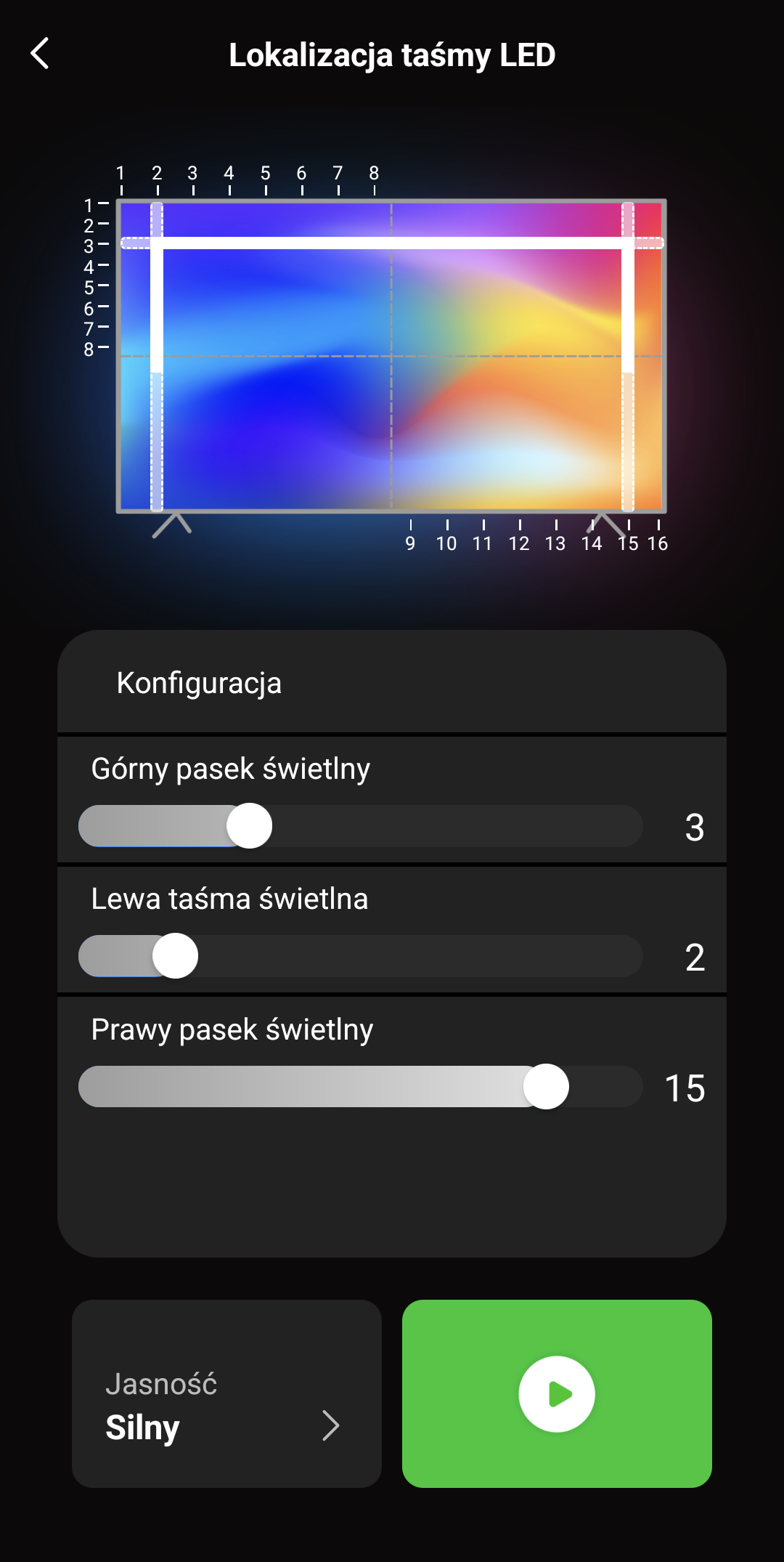

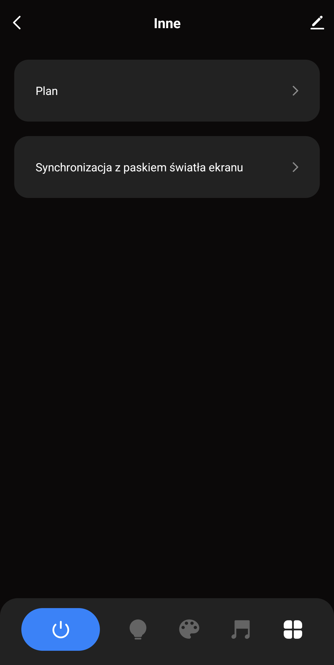

  • It supports HDMI HDCP2.2 and 4k@60Hz HDR10+, and ships with an 84-piece 5050RGB LED strip for 2.6 m, priced at 129.99zł.

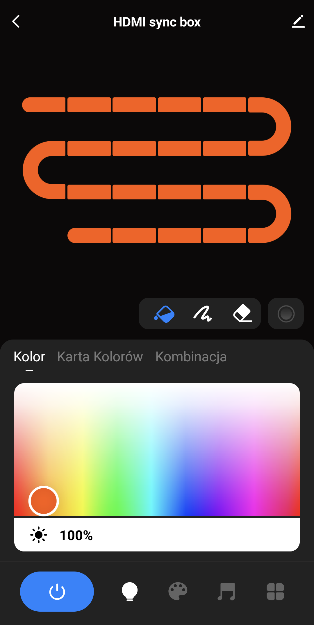

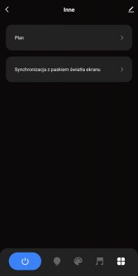

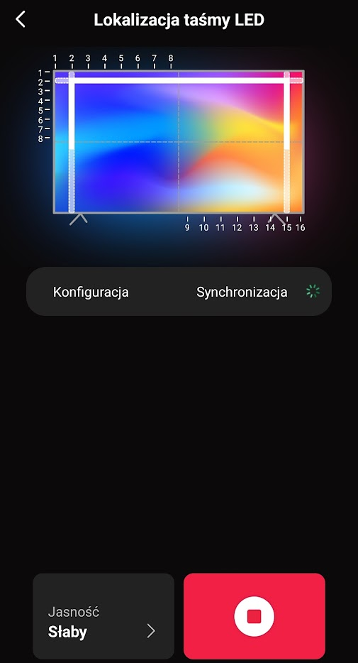

  • The Tuya Smart app exposes row-and-column sampling settings for the LED effect, but the software and instructions seem limited to a 65" TV, not smaller or larger sets.

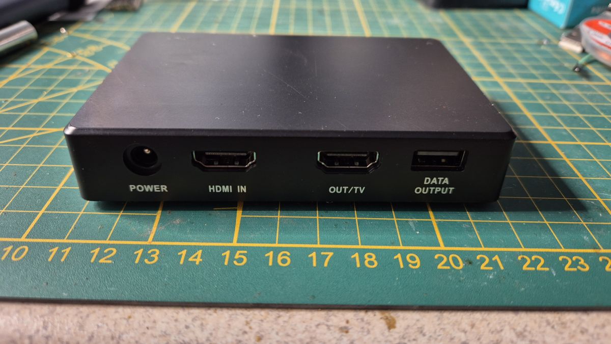

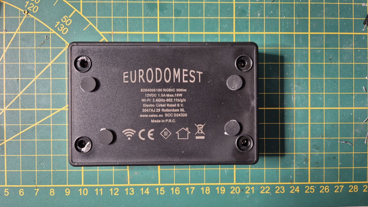

  • I present a teardown of a new device from Action namely the HDMI sync box for 129.99zł.
    https://shop.action.com/en-nl/p/8712879162889/hdmi-sync-box-with-light-strip
    Model: 6204000100
    Supports HDMI: HDCP2.2, 4k@60Hz HDR10+

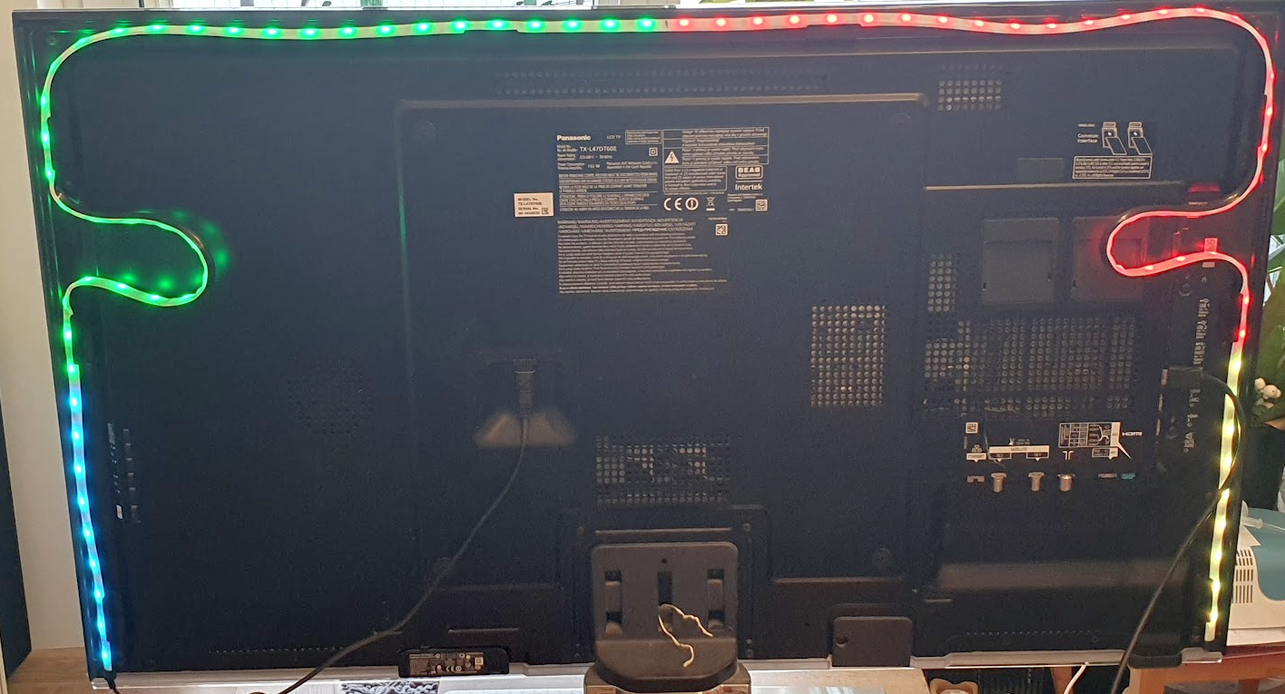

    The device is connected between, for example, a console or satellite receiver and the TV.
    To it we connect the LED strip (84pcs 5050RGB LED for 2,6m) and mount it on the 65" TV on 3 edges (left, top, right) which in the end makes us lighting like Ambilight in Philips TVs.
    Cons: it looks like the software and instructions do not provide for mounting on a larger or smaller TV than 65" :( - mine is 48" :( .

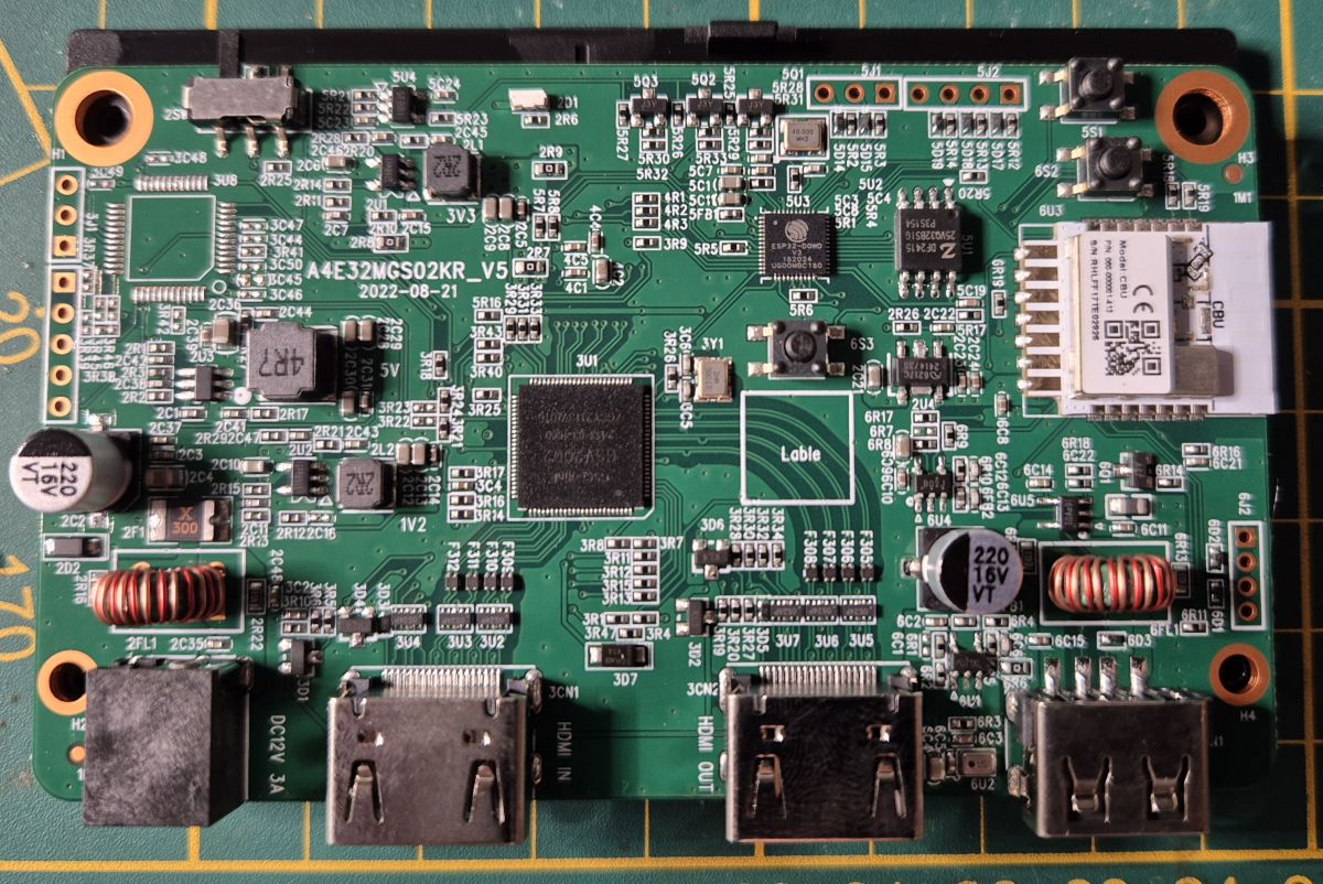

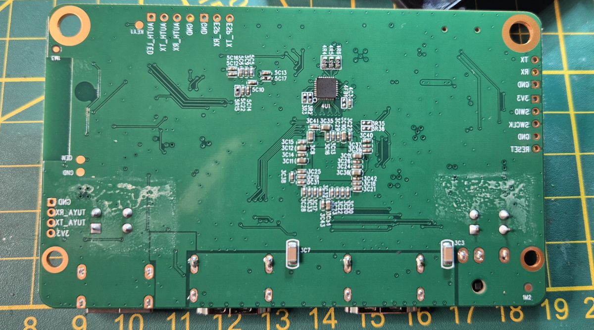

    The case is bolted together with four screws.
    Inside you will find the three main chips:
    BK7231N/CBU
    ESP32-D0WD-V3
    HDMI video extraction chip: GSCoolink GSV2002
    [BK7231N/CBU]&[ESP32] Teardown HDMI Sync Box from Action - interior and circuit analysis [BK7231N/CBU]&[ESP32] Teardown HDMI Sync Box from Action - interior and circuit analysis [BK7231N/CBU]&[ESP32] Teardown HDMI Sync Box from Action - interior and circuit analysis .

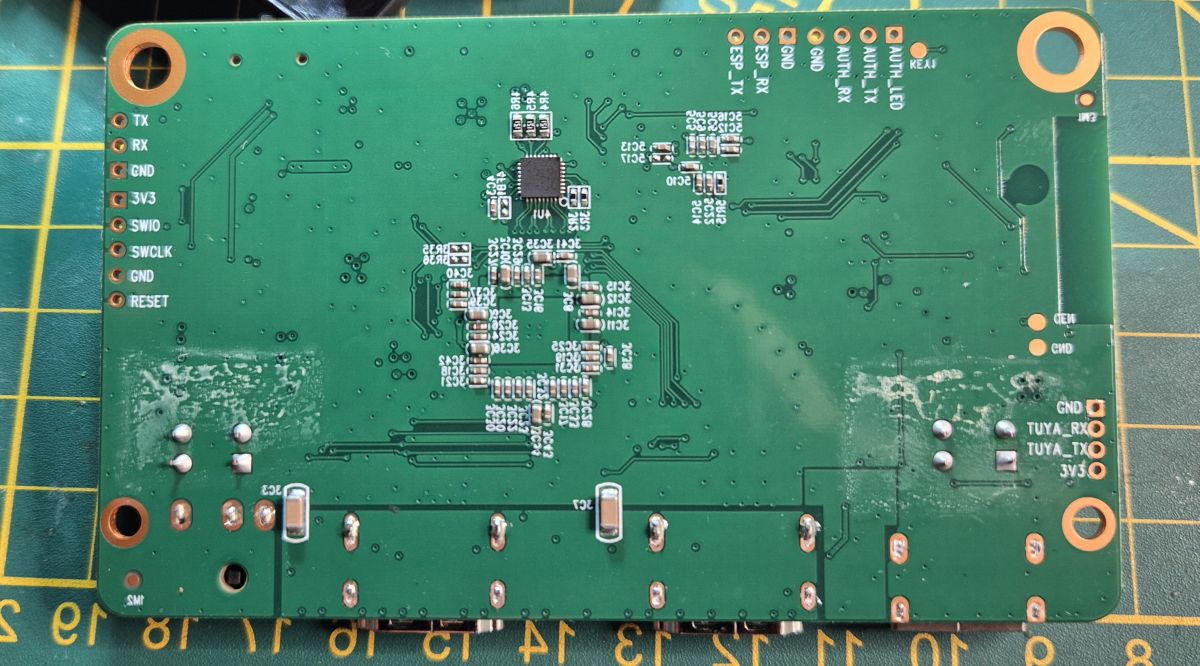

    When reversed on the computer
    On the PCB there are pulled goldpin sockets for each circuit (even the one they didn't solder) with RX TX GND and 3V3.
    In addition, soldered (not pulled on the case) are three microswitches
    - the top one connected to GPIO0 of the ESP32 (ideal for Flashmode)
    - lower left connected to CBU pin P6
    - bottom right connected to CBU pin CEN (ideal for Flashmode)
    I managed to rip the original firmware from the CBU, but no longer from the ESP32 (presumably busy RX/TX), but I tapped into the logs of both chips after boot.

    As you can guess, the ESP is the brains behind the processing of the image into the correct colours, while the CBU is responsible for communicating with the TUYA servers, outputting the signal to the LED strip and there is no TuyaMCU intermediate circuit.
    In the Tuya Smart application, the device looks like this, along with the configuration from which row and column it should take the image for generating the LED tape light:

    I haven't tested the tape yet because I have a 48" TV, but looking at the PCB tracks, there is some voltage coming through and I doubt it's more than 5V.
    If I found some way to adapt to a smaller TV or configuration after LAN I would probably already mount :) .

    Rate: 20
    In the application regarding the TV, it is only possible to set at what distance from the edge of the screen it should take the colours for processing for the LED strip.
    There is also nothing in the instructions regarding the adjustment or information that it is TO 65" - everywhere there is information that it is 65".
    So far, I have 3 ideas to use on a smaller TV, i.e.
    1. arrange the tape in waves
    2. start slightly from the bottom edge and end the same way
    3. find another LED strip - with a different density of LEDs
    4. buy a 65" TV :-P (which I have been thinking about for some time)

    I've owned this sync-box for about 3 weeks now, which I acquired by overpaying a whole 20PLN ;-) (it was originally at Action for about 150PLN). And I bought it mainly in order to personally test the ambilihgt (or ambilight-like) function in my own home, as I'm also slowly moving towards a new TV. The original Ambilight as we know it only has Philips and I wasn't sure whether to bother with it at all. As usual, opinions are divided on the Internet, with some praising it to the skies and claiming that they can no longer imagine watching TV without it, while others have turned it off, claiming that it irritates them.
    As for the editing, on my already old, but still alive 47" Panasonic, I hung the tape like this:
    I don't know if this is optimal for this screen size, maybe I needed to corrugate the tape more, etc.. Anyway, I figured it out like this and it's already ;) Aha for the purpose of mounting the tape I created a "test image" on the fly in Painter - A screen divided into four coloured rectangles.
    The signal source at my place is a SAT decoder. The signal is in FHD 1080p resolution, the TV does not support 4k. Here a small remark - I have read on the Internet that some users complain about high heating of the box, and even a few seconds of breaks in the signal. In my case, the box does heat up a little, but not excessively. I wonder if the reason for the overheating lies in the resolution - if someone connects a 4k/60fps signal, the signal processing will certainly have more work than with FHD. For now, I have no way to test this theory - my 4k TV may not have made it yet ;) .
    By the way, as a result also of one of the net disputes, out of curiosity I tried to measure the power consumption. Unfortunately the only "instrument" for measuring power I had at my disposal was... a wifi socket, notabene also from Action ;) The result is a bit strange especially for the state let's call it: "standby". That is, when the box is switched off in the application, the SAT decoder also (i.e. no signal reaches the HDMI input of the box, nothing is processed) the power consumption is... about 4.5W. This seems quite a lot to me. Interestingly, after disconnecting the LED strip, the consumption drops to about 2W - which is also strange, because, after all, in the aforementioned "standby" the LEDs do not light up.
    Apart from that, in normal operation mode, with the "ambilight" effect switched on, the appliance consumes on average about 8-9-17W, depending on the set "strength" of the effect (there are 3 degrees), the content of the image, etc. When I forced in the application the brightest illumination "at max white" - about 20W. And these values seem fairly plausible and reasonable to me.
    Then I repeated the measurements with yet another wifi socket and an old, probably with 10 years old power consumption meter acquired in Lidl - the results were similar.
    Still regarding the "ambilight-like" effect itself - admittedly, I don't have a reference to a "real Philips" (although yes, I've seen it at friends' houses or in consumer electronics stores), or to other such set-top boxes (I know that there are also those with cameras, which don't require a "pass-through" signal connection via HDMI), but it seems to me that technically it works quite well. I.e. it is reasonably "responsive", keeps up with changes in image content, etc.
    Subjectively... I now know that my new TV does not necessarily have to be from the Philips stable. I.e. yes, the effect is nice, it actually gives the illusion of "zooming in" on a wall scene beyond the TV screen. But in my, I repeat _my_ opinion it works best when the images change gently, slowly e.g. usually in nature films, . On the other hand, when scenes change more rapidly, e.g. in action films, the "flashing wall" effect becomes a bit irritating. In any case, the attachment also allows you to set a static colour, e.g. soft warm colour, and can thus be used as a substitute for a lamp behind the TV (incidentally, the box also has a million other effects, including a'la colourophone to the rhythm of music).
    And because it works with Tuya it also allows a certain amount of automation. At my place, for example, it switches on as a soft, slightly orange light at sunset and switches off at midnight (I don't usually watch TV for longer). And to tell the truth - after a momentary fascination with "ambilight" - it is now the mode used most often....

    Whether "help" I do not know, but I will try to help ;) .
    1.Firstly, primo, when you connect the set-top box via HDMI, do you have an image from the source on the tv screen? (e.g. tv set-top box, console, computer, etc.).
    2.In the application, have you enabled - so to speak: the effect in the effect itself? Did you click on the green button at the bottom, a sort of 'play' function symbol? You have a screenshot in the 1st post of the topic, where the distance from the edge of the colour sampling screen is configured.
    The button should turn red ('stop'), and a little above it you should see the word Synchronisation with a green circle rotating next to it. This indicates that the attachment is in sync mode with the HDMI signal.
    EDIT
    When the effect is running, it should be as shown in the screenshot below:
    App screen for LED strip configuration with color diagram. .

  • Question about firmware dumping and CBU pin P6 button
    #29 21708825
    morozaw
    Posts: 230
    Rate: 42
    Great work, I also bought one recently but am disappointed with the tape AND configuration options.
    I'm thinking of ripping the firmware as a backup and seeing what more could be done with it here by creating my own, to maybe use it with hyperhdr. As a hdmi front end it looks pretty ok - I guess, looking for adapters, usb cards AND struggling with hdcp out of the way. A finished vga signal should already be available, I wonder what quality and how it handles hdr.
    Have you tried maybe ripping the firmware from the Esp32 later or analysing something more? Any tips? Will it work without having to read the memory directly?
    Do you perhaps know what the button is for
    "lower left connected to CBU pin P6"?
