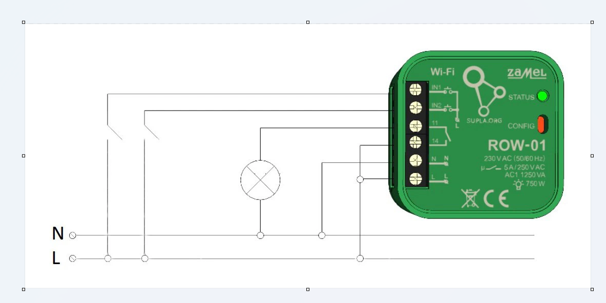

    Hi. I have a light installed in the roof soffit and would like to make it so it can be switched on via Wi-Fi. I found something like this https://allegro.pl/oferta/odbiornik-jednokana..._unit_id=a6f2eadd-e01f-42ac-b015-a052ef6d8cdd and I have a question. I have a light switch on the ground floor, but it's very cramped in the box :/ will it work if I plug in a wire somewhere on the first floor, rather than immediately in the box behind the switch? It seems to me that it should work normally, but maybe I'm wrong?

    You can but it will work ( only on Wi-Fi ) , the switch will have to be permanently on .
    - ( here it is a question of how many wires you have coming up to the lamps on the floor )
    - ( when more you can and leave the switch running and after WI-FI ) .
    Connection diagram of Zamel ROW-01 module with electrical installation. .

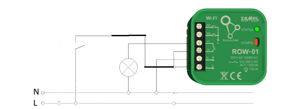

    >>21405461 there is 1 wire going to the lamps from the switch, but there is an option to run one phase wire from the switch and another separate phase wire. Would this then work as it should for the switch and Wi-Fi? I have a shell on the first floor so I can do anything with the wires.

    Diagram of connecting the ROW-01 module to the electrical installation. >>21405490 .
    An extra wire as much as possible will work both .
