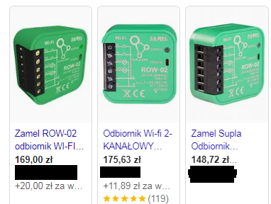

    To start with, the product seems to be quite expensive:
    Brief test, pairing and interior of the Zamel ROW-02 (double-overhead light switch) .
    So what do we get for a whole PLN150?

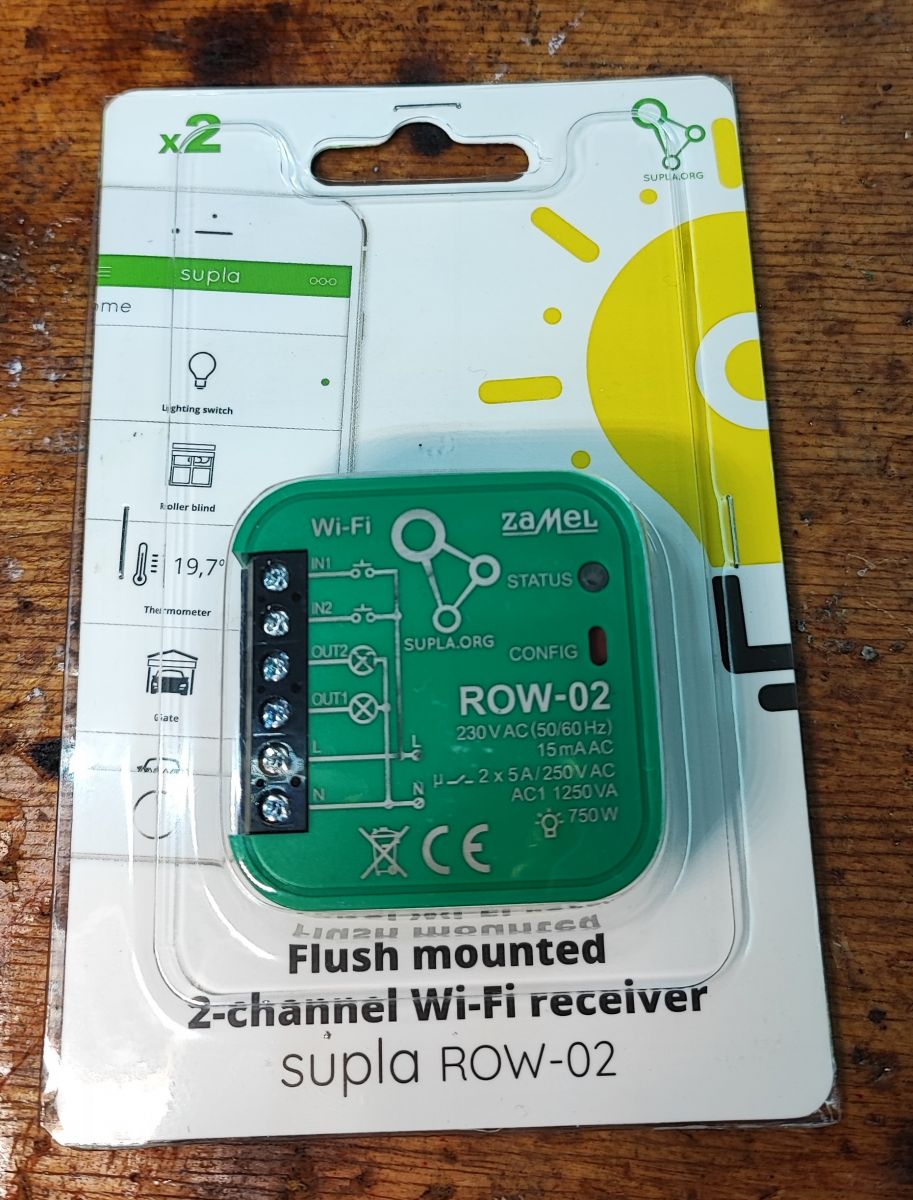

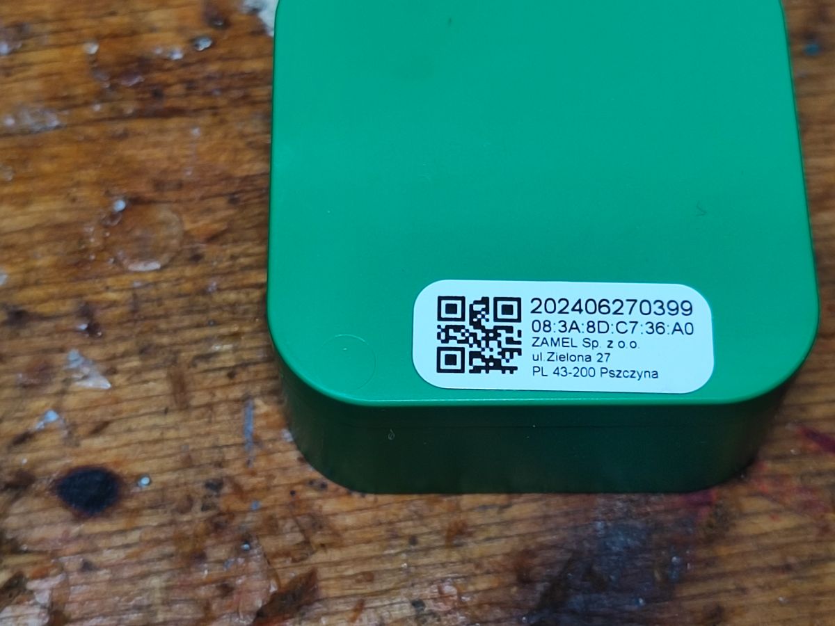

    Here is the gadget itself:

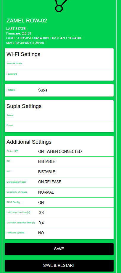

    We then visit 192.168.4.1 (hosted by our device) and enter our WiFi network details there, as well as our server and the email of our Supla account. The server from our Supla account can be found in the Supla panel.

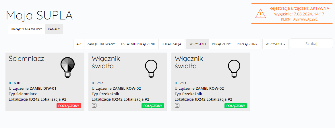

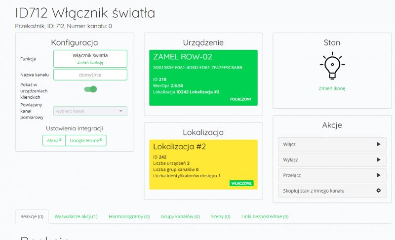

    We then press "Save and reset" or reset with a physical button on the device. The device should appear in our panel:

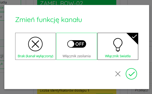

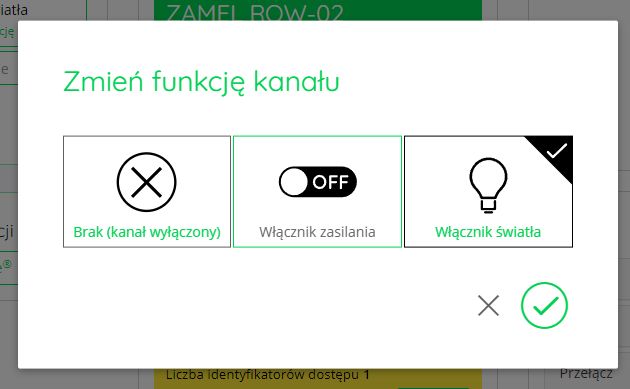

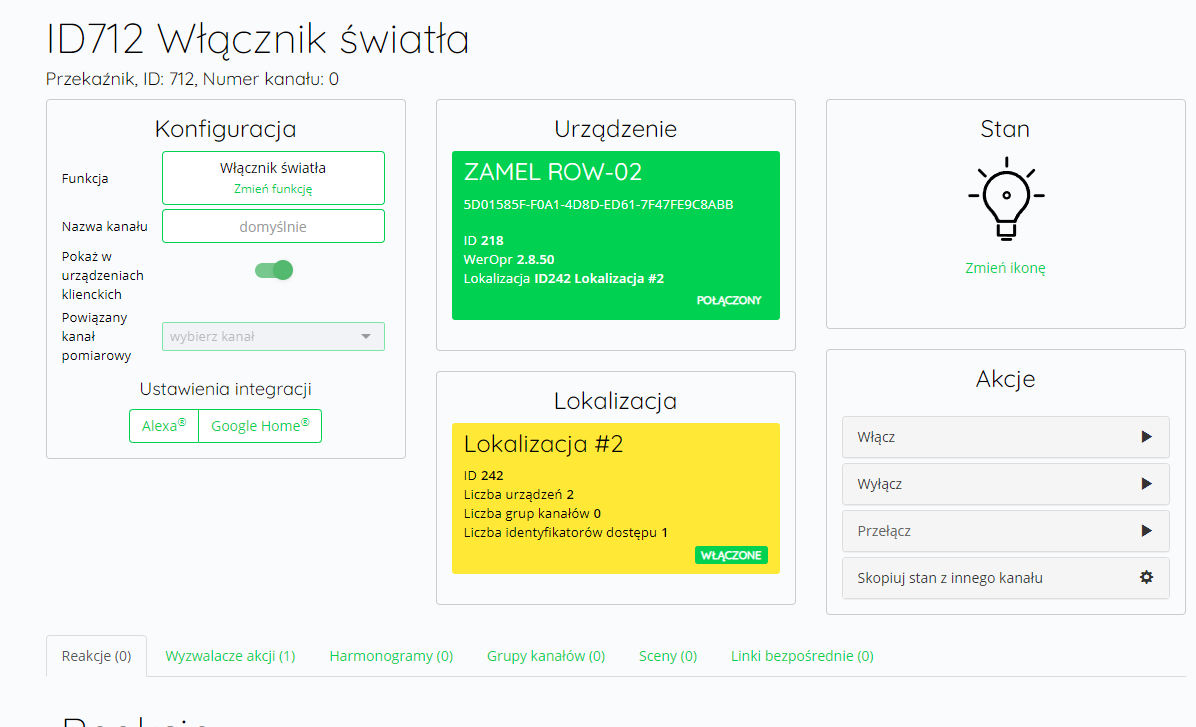

    This particular module (ROW-02) offers two channels and can control two lights.
    Of course, you can choose their icons, names, etc.

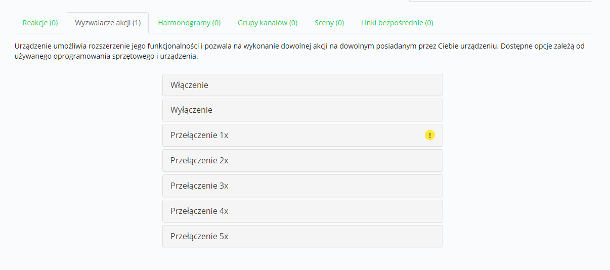

    You can also trigger actions with it, but I have already written about that in another topic.

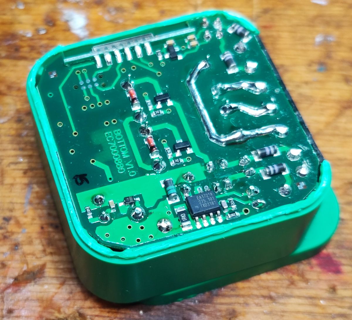

    Interior of Zamel ROW-02 .

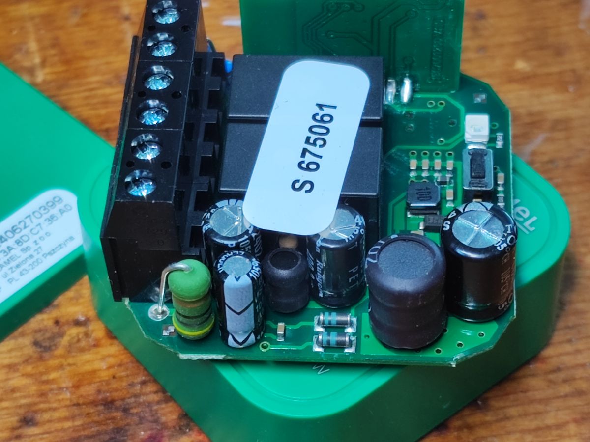

    Similar to Tuya products - lift the lid:

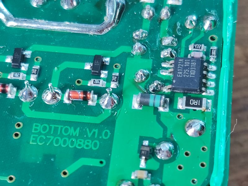

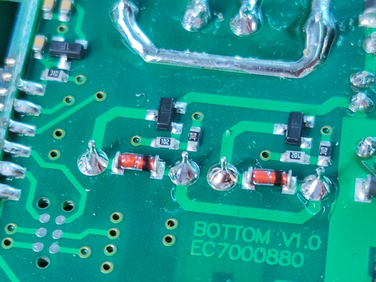

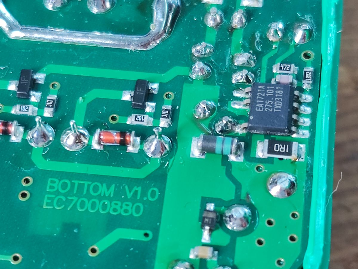

    The tracks for the higher powers are additionally tinned.
    You can already see the first circuit - the EA1721A. Or rather, probably a TEA1721A. So here, however, is a switching power supply in flyback topology? I have often seen non-isolated step-down converters in such products.

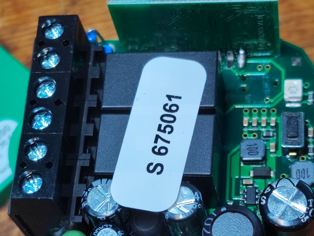

    We look further afield:
    Brief test, pairing and interior of the Zamel ROW-02 (double-overhead light switch) Brief test, pairing and interior of the Zamel ROW-02 (double-overhead light switch) .
    And from the top of the tiles:

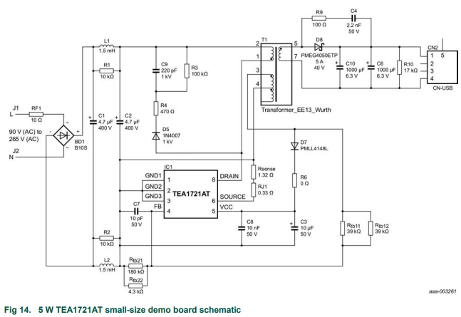

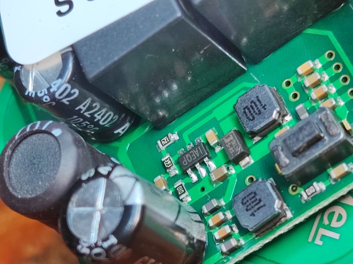

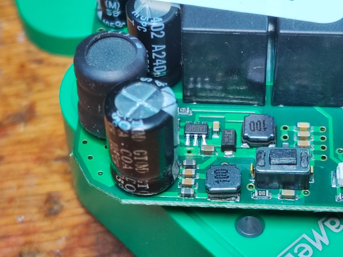

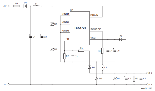

    I don't see a pulse transformer here, so not a flyback after all! I guess the TEA1721 can work in other topologies too. I found other schematics on it:
    That is, however, again a non-isolated circuit. But he generates the voltage for the relay, for the WiFi module there is separately still a small step down inverter:

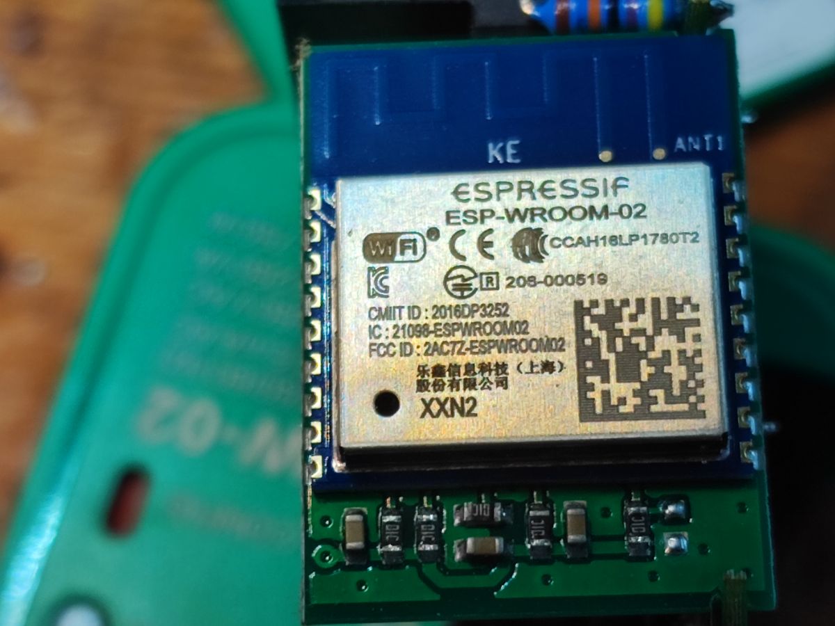

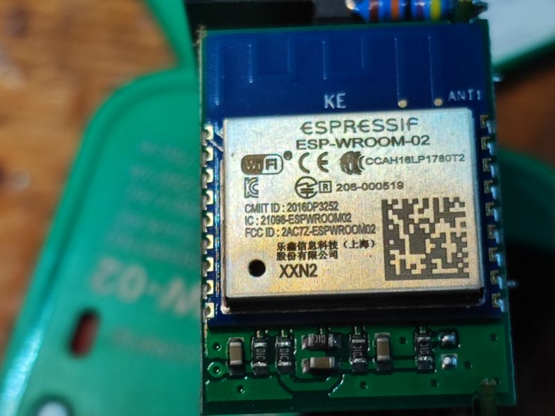

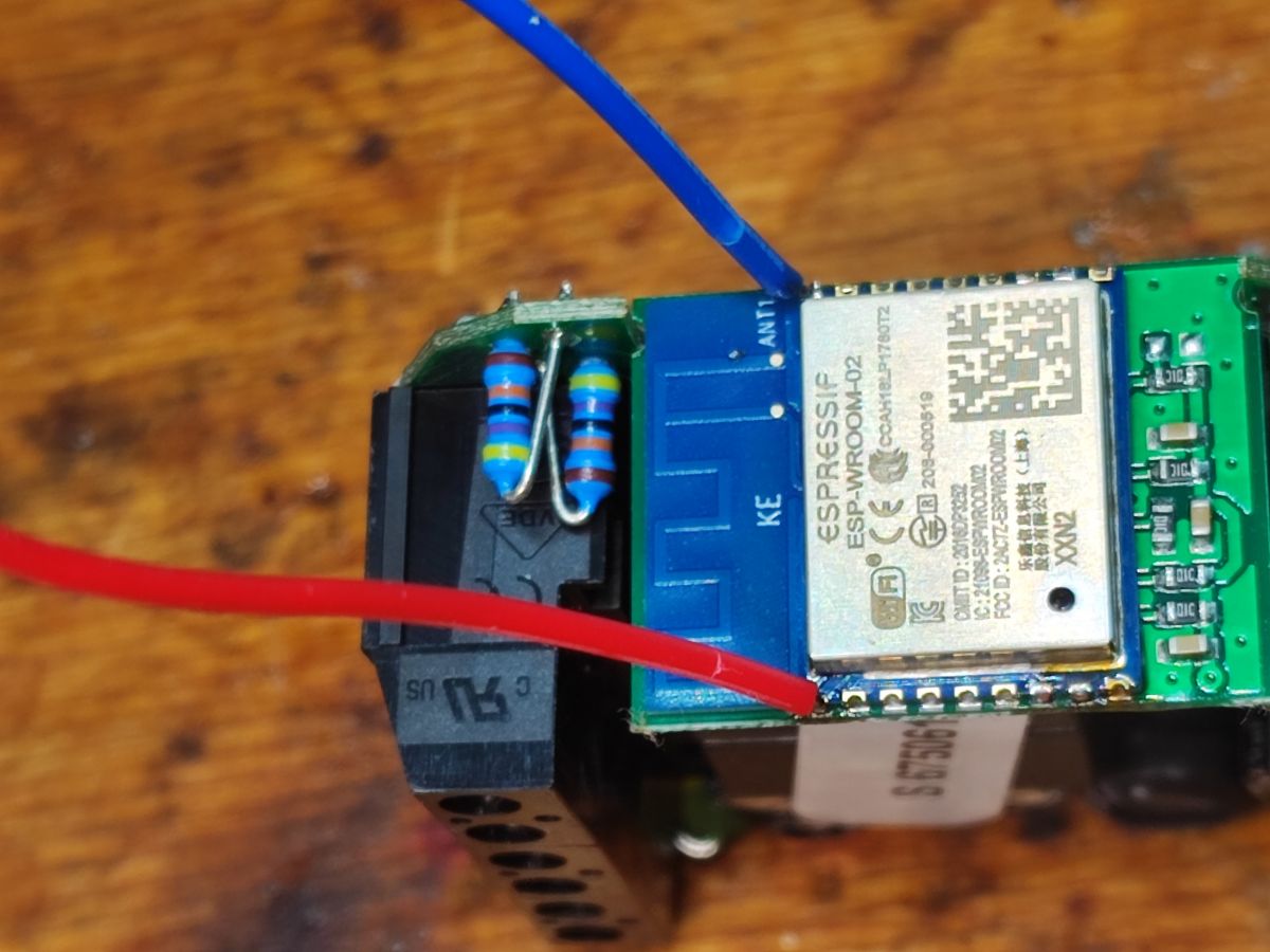

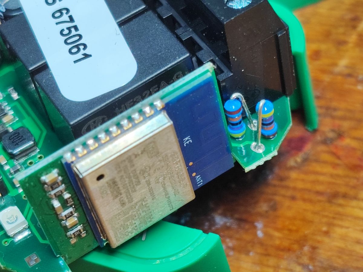

    And then there is the WiFi module:

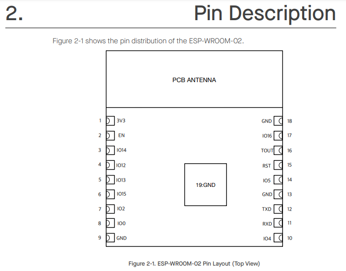

    ESP-WROOM-02, or ESP8266.
    Outputs:

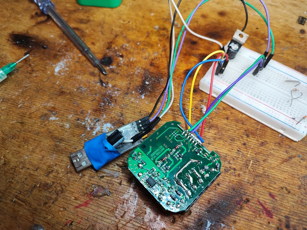

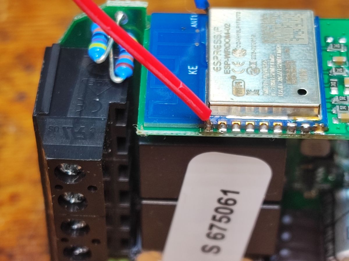

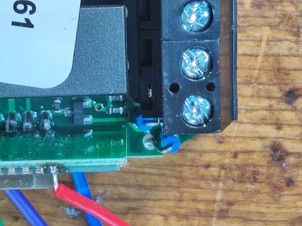

    For the "principle" I connected a USB to UART converter and ripped the flash, but that's probably off topic, as the Supli is unlikely to need to be converted to Tasmota.
    Brief test, pairing and interior of the Zamel ROW-02 (double-overhead light switch) Brief test, pairing and interior of the Zamel ROW-02 (double-overhead light switch) Brief test, pairing and interior of the Zamel ROW-02 (double-overhead light switch) Brief test, pairing and interior of the Zamel ROW-02 (double-overhead light switch) Brief test, pairing and interior of the Zamel ROW-02 (double-overhead light switch) .
    My copies of the IoT batches:
    https://github.com/openshwprojects/FlashDumps/tree/main/IoT

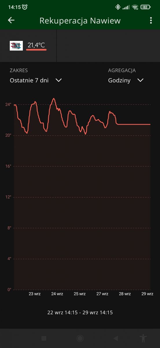

    krzbor wrote:
    ...Can you elaborate on the subject of equipment hanging up? ...
    Well one of the Sonoffs has just crashed:

    If you have it on a DS18B20 sensor then check that it is original because this happens on fakes.
    In the ESP supply you can also increase the capacitance of the capacitor additionally.

    Zvirek wrote:
    Well, one of the Sonoffs just crashed:
    Is the data controlled from the cloud or locally?

    From the cloud - I'm using the app, but I'll try to access the device directly by IP.
    As for the sensors, I think it's unlikely to be their fault, as the issue is not with specific thermistors, but virtually most (there are eight sensors in total in the three sonoffs).
    The problem disappears when the power is disconnected and switched back on.
    PS. I read somewhere that someone had a similar problem as their AP was jumping channels - I have the same set up, so I'll still try hardwiring one particular channel and see if that has any effect.
    Edit: I set the channel rigidly in the APs a couple of days ago and so far everything is OK. Could it be that the Sonoffs don't like channel changes?
