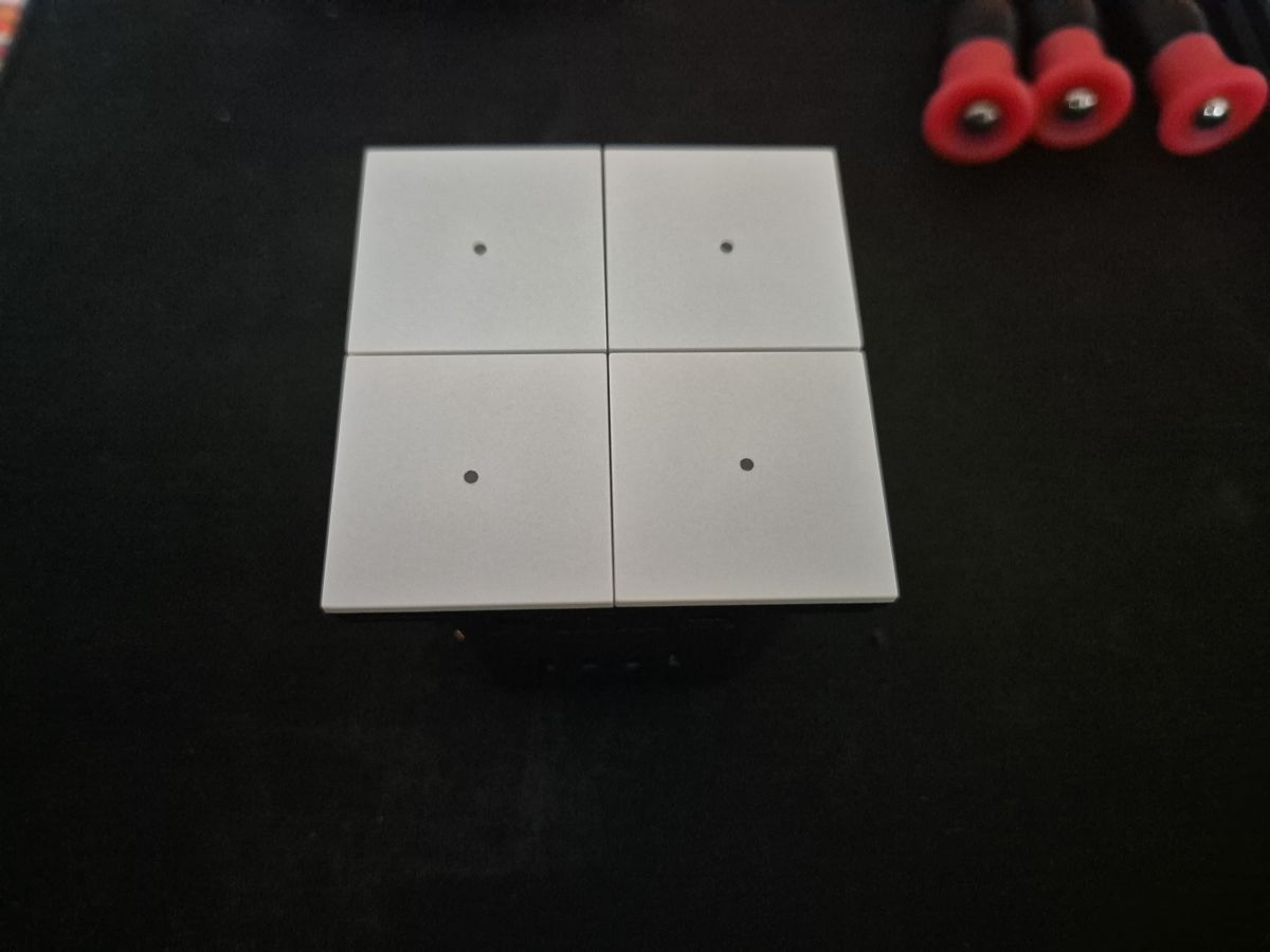

    I am going to show you how to flash the BSEED E-Serie 4Gang Switch without any soldering:
    Top view of BSEED E-Serie 4Gang touch switch on a black background.

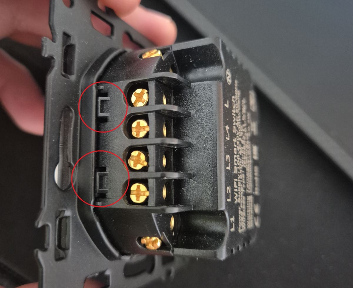

    First you need to get the switch out of the metal frame, by bending these clips with a screwdriver:
    Close-up of the back of a BSEED switch with a metal frame and visible clips.

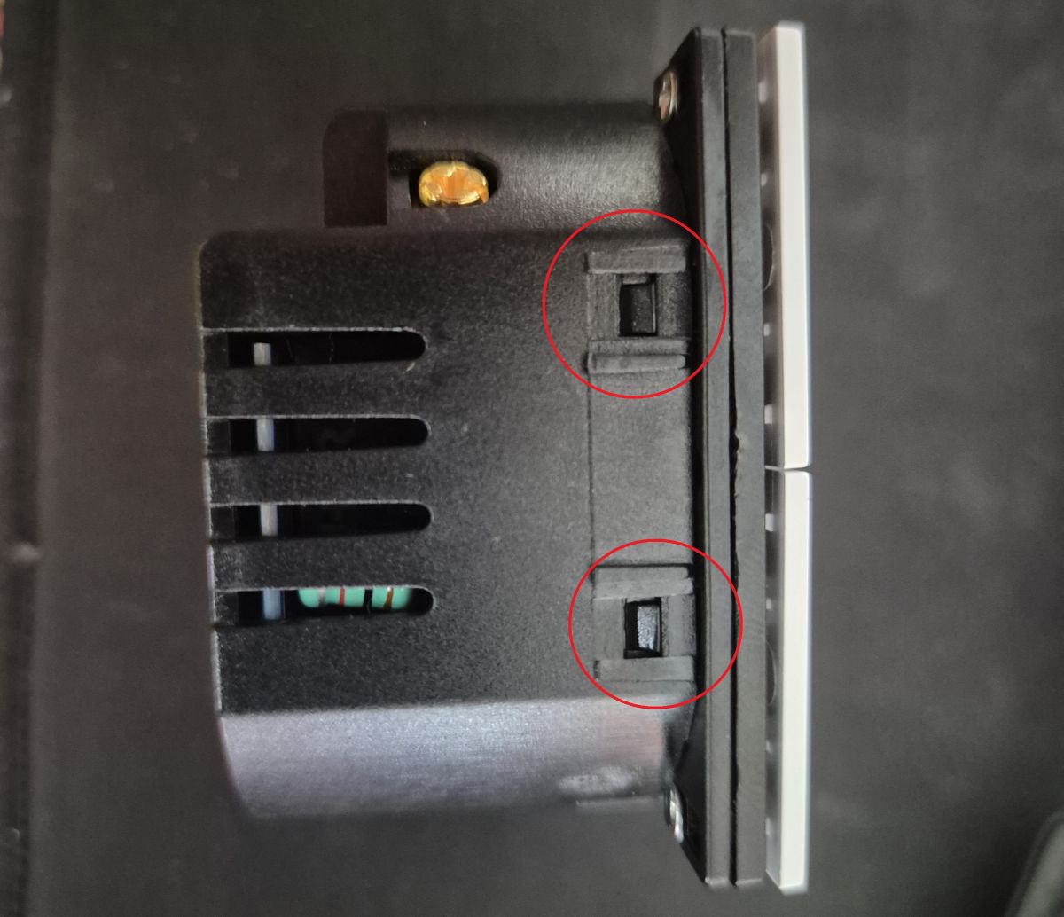

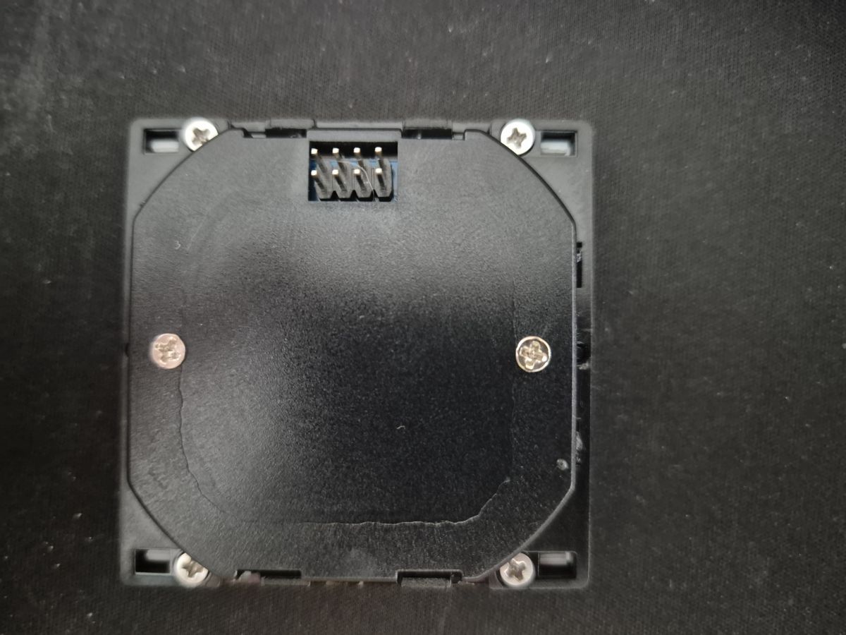

    Now let's get the upper part out of the switch. Again we are using a very small screwdriver:
    Side view of BSEED E-Series 4Gang switch with marked clips for disassembly.
    You will get the upper part with the buttons and the module inside. You open the small screws:
    Back of the BSEED E-Serie 4Gang switch module with visible screws.

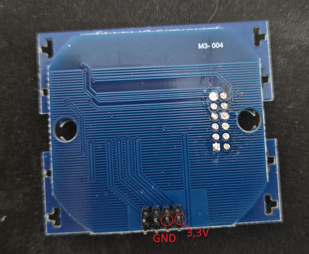

    Then you can open the upper module to receive the board, front & back. You will see the two pins for 3.3V and GND.

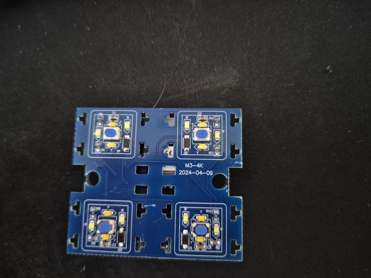

    In fact it is two boards, soldered to each other. Don't try to separate them! They are soldered to each other:
    BSEED E-Serie 4Gang switch board with electronic components and component labels.  BSEED E-Serie 4Gang PCB with GND and 3.3V markings.

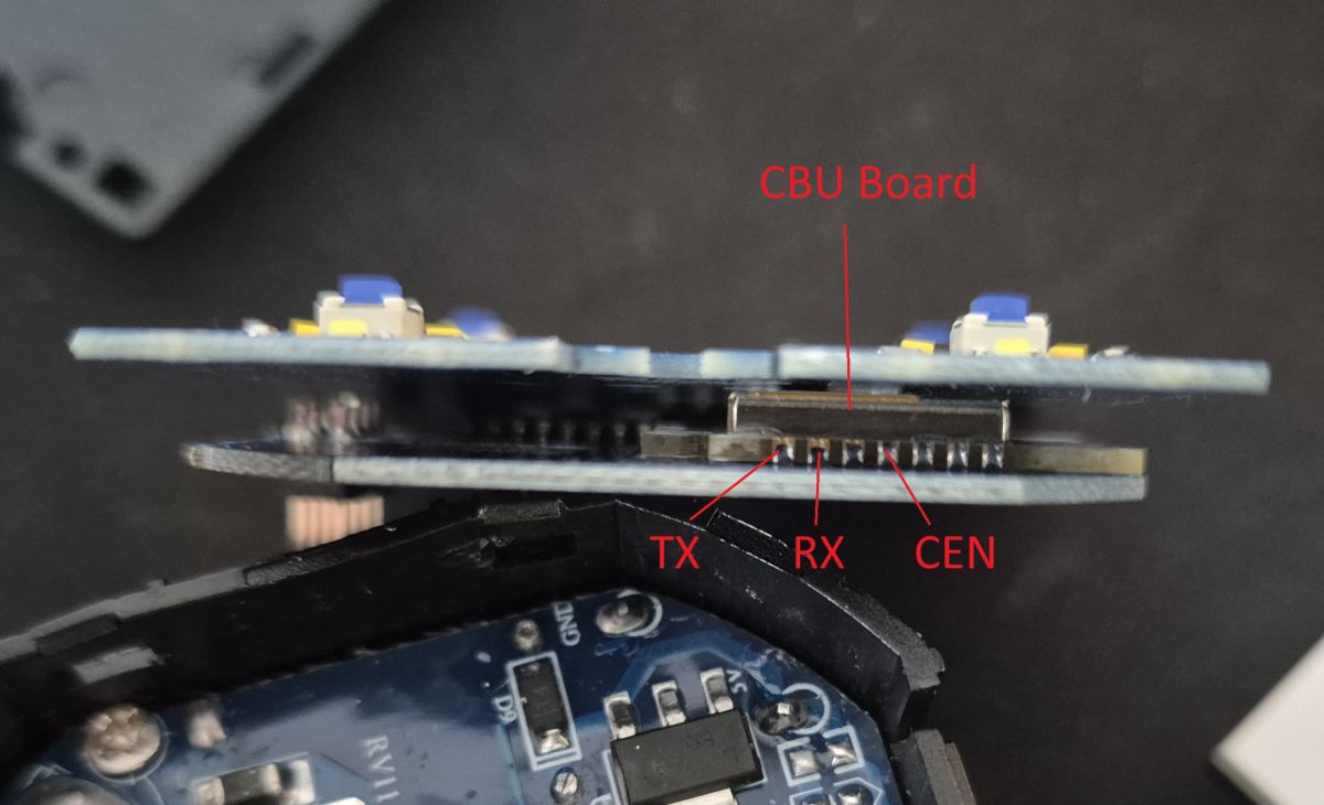

    If you turn it to the side, you can look between both boards and you will find the CBU chip:
    Close-up of two connected circuit boards with TX, RX and CEN pin labels on the CBU board.

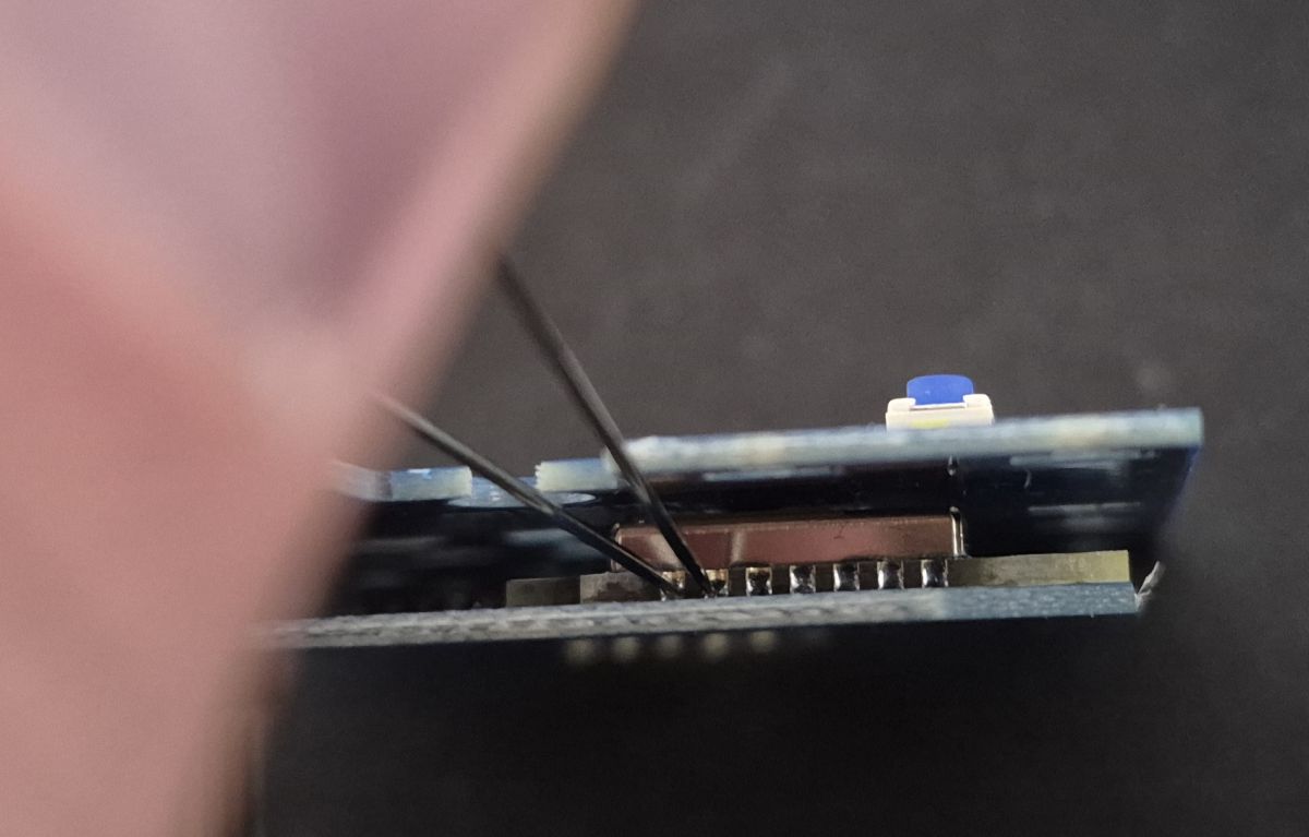

    Instead of soldering, try it with two sewing needles and a very steady hand. If you manage holding these 2 needles with one hand, you can use your second hand for the CEN-Port:
    Close-up of a circuit board with two sewing needles inserted between its layers.
