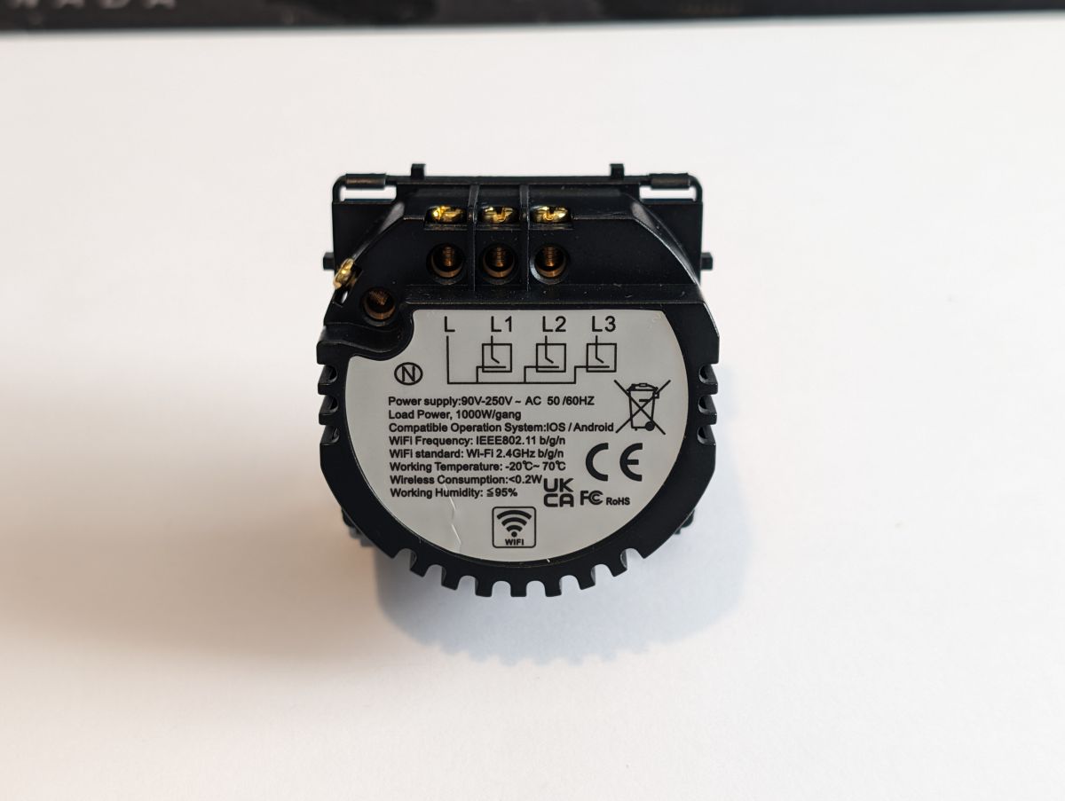

    Like a lot of the smart switches, this does require a neutral at the switch.

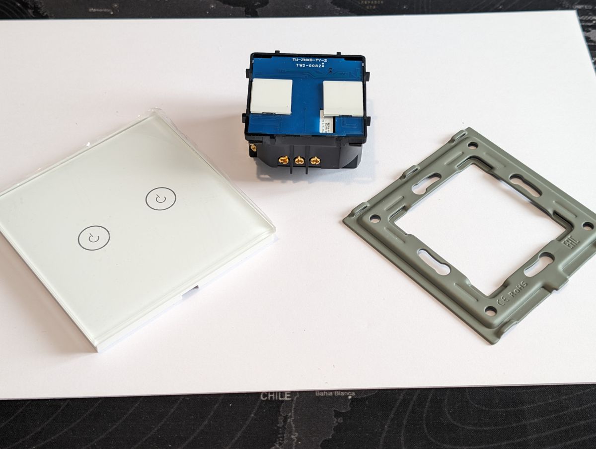

    Unboxing the switch & what is in the box, the first thing I noticed and was impressed with was the mounting plate, it's a strong metal plate, which is a substantial upgrade to a lot of the flimsy plastic housings. Also this is the first switch I have seen using touch panels not springs.
    Components of the BSeed SmartLife 2 Gang smart switch on a table. Rear view of the BSeed SmartLife smart switch, model 2Gang1way with technical description.

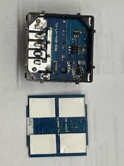

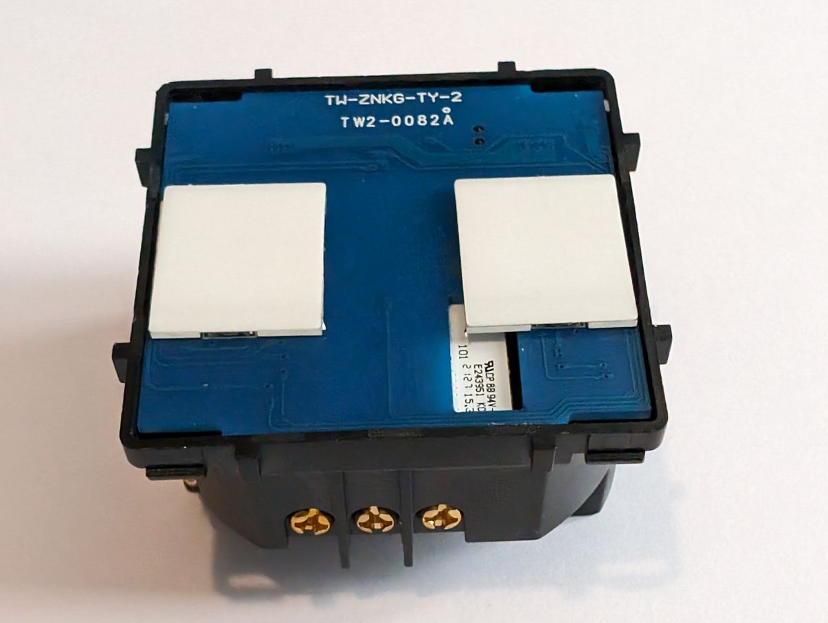

    The touch panel pcb is secured in place solely by the 6 pin connector and is easily removed by gently prying around the edges.
    View of the mounting plate of a 2 Gang smart switch with the touch panel removed.

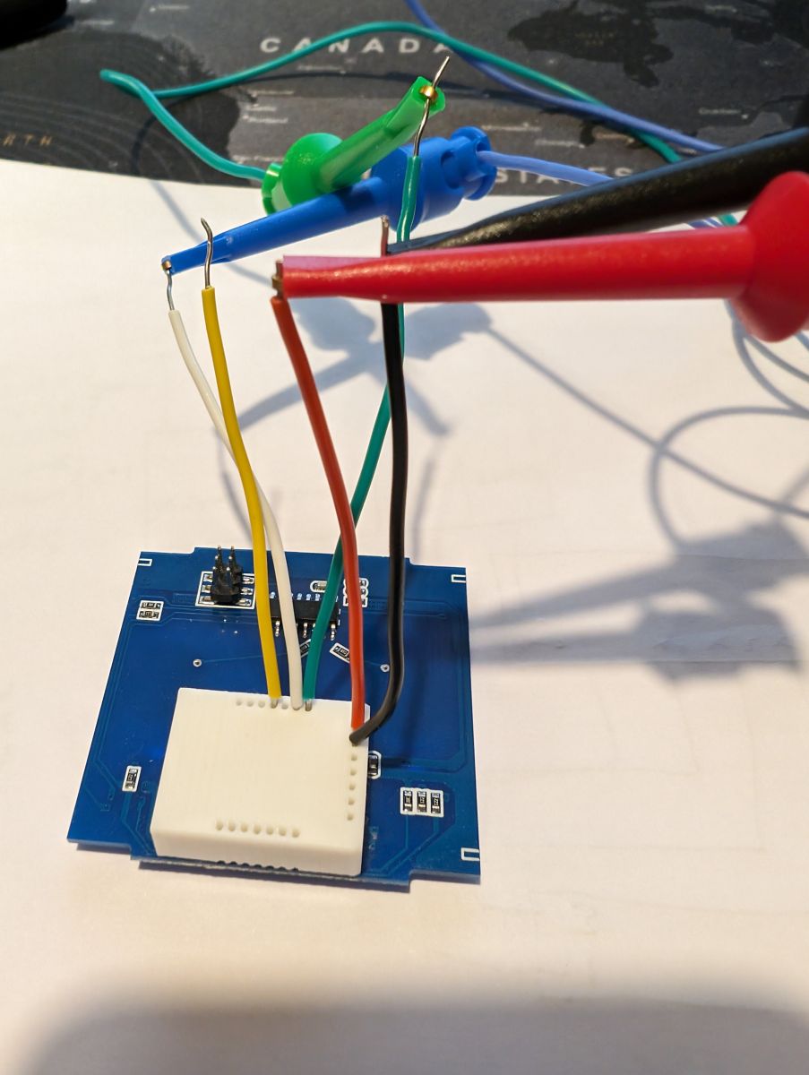

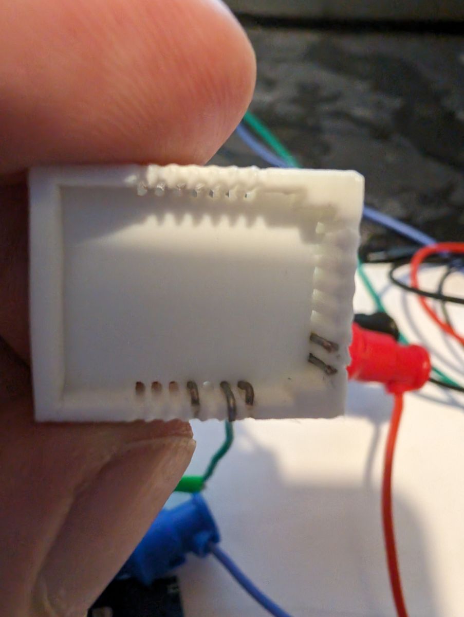

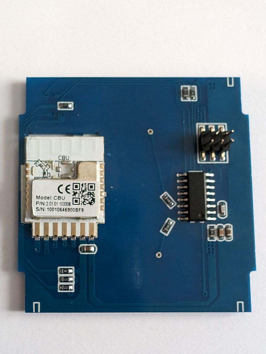

    Upon removal of the touch panel pcb, it was revealed that the switch uses the tuya CBU module, so whilst soldering is a possibility, I decided to design and make a solderless jig for the module. The module snaps tightly over the module so does not need holding in place and is readily available here at www.printables.com to download and print (if you don't have access to a 3D printer and want a module sent please PM me)
    PCB with attached cables in various colors. Close-up of a plastic holder for a module with visible pins inside. Tuya CBU module board with electronic components.
    Flashing the module took a few attempts, it would not accept the method of tapping CEN to GND, so I had to revert to removing and reapplying power, this threw various errors and failed but after several attempts the device was read and flashed successfully. In the photo showing the flashing jig and wires in place, the connections are as follows Red(3.3v), Black(Gnd), Green(Tx), White(Rx), Yellow(CEN)

    A CBU-based device, nice. CBU is unique among Tuya modules because it has P16 routed out, while CB3S and CB2S don't have it. This device could be hacked to even use a WS2812B LED strip.

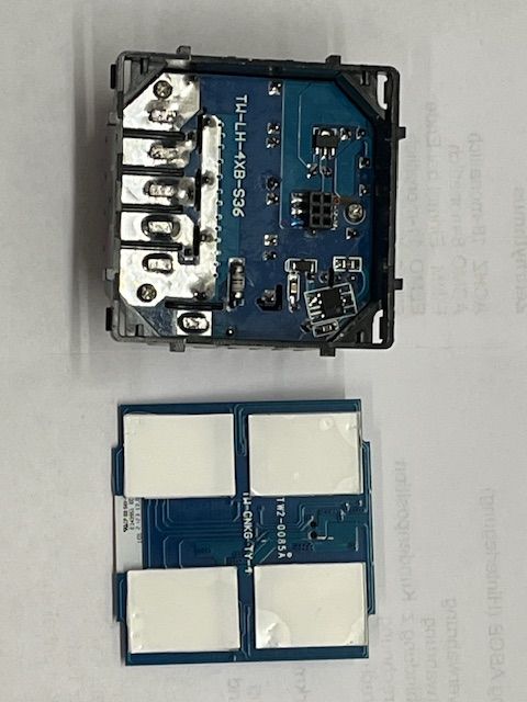

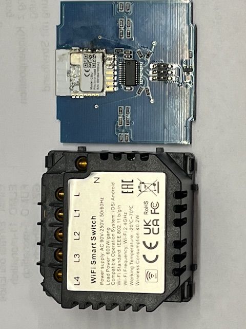

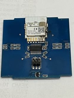

    Peny11

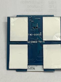

    Top view of an electronic module with four large white areas on a blue printed circuit board. Electronic board with mounted CBU chip Interior of an electronic device with a circuit board and four buttons. WiFi Smart Switch module with Tuya chip and circuit board. >>20964221
    Hallo
    Ich bin neu hier in diesem Forum und finde deine Vorrichtung einfach super genial! Perfekt !
    Ein großes Lob an dich für die geniale Vorrichtung.
    Ich habe auch so einen Touch wie diesen von BSEED!
    Meiner ist von Entuoia hat 4 Tasten und auch diesen Tuya CBU Chip verbaut!!
    https://de.aliexpress.com/item/10050056761423...st_main.5.7a885c5fvtncQf&gatewayAdapt=glo2deu
    https://de.aliexpress.com/item/10050058440719...1670407.1005005844071975&gatewayAdapt=glo2deu
    So weit ich herrausfinden konnte, kommen fast alle diese Schalter von Tangwo Electric Technology!
    Sie sollten sich alle mit Open Beken mehr oder weniger gut flashen lassen.
    Ich habe schon sehr oft versucht diesen CBU Chip zu flashen aber leider ohne erfolg.
    Durch die vielen versuche habe ich mir die Lötpunke am Chip beschädigt das ich es nicht weiter versuchen kann.
    Diese Schalter sind wirklich super und ich möchte weiter versuchen sie für meinen Zweck zu flashen.
    Könnten sie mir so eine Vorrichtung auch nach Österreich senden?
    Ich bin neu hier und weiß nicht wie ich dir mein private E-Mailadresse senden kann.
    Ich hoffe sie können mir Helfen!

    Also, the 6-pin connector is a good place to connect to for power on these boards. Just use a continuity meter to check which pins to use. This makes it easier to flash if you need to toggle the power like I did.

    @Peny11 this may be TuyaMCU device.
    See the TuyaMCU guide:
    TuyaMCU flashing, setup and configuration guide - configure dpIDs for Home Assistant
    You may need to disconnect UART from the MCU for the flashing to work. See the linked guide.
