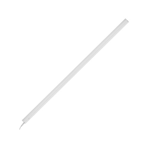

    The ARLEC UH551HA Linkable bar light is a mains powered cool/warm LED bar light. It is also available in different lengths (UH552HA 87cm) and RGB (UC566HA)
    Long white ARLEC UH551HA LED light on a white background.
