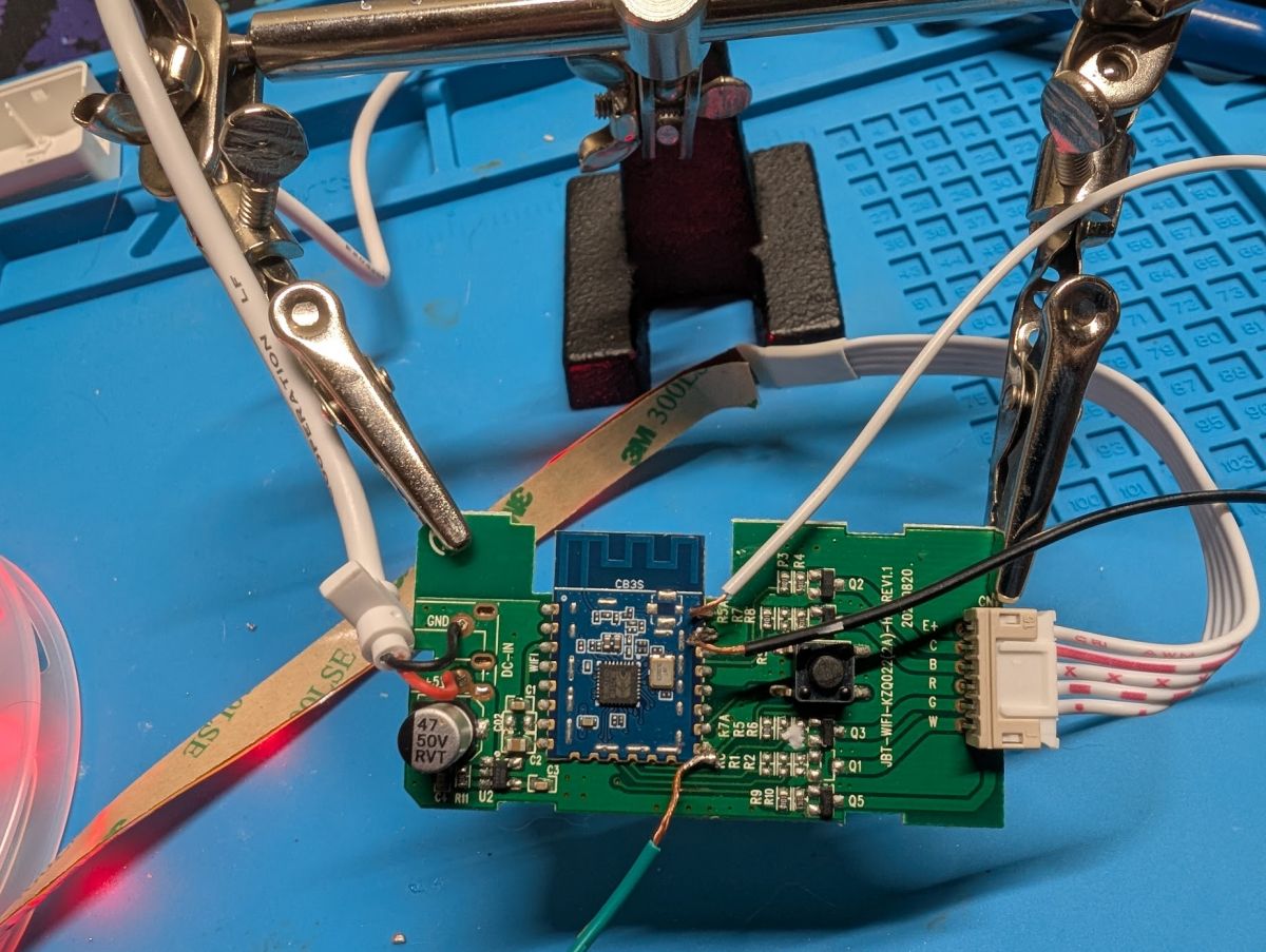

    The product photos from that thread are nearly identical to this one so I didn't go to great detail in getting more photos. Just one of the box and one of the board since this uses the CB3S chip so it's a little different to set up.
    Merkury Smart Wi-Fi LED Strip box with smartphone app.LED circuit board with soldered wires on a blue mat.
    Flashing was mostly straightforward. I had a moment where the board didn't seem to be responding to button presses or recovering after power cycling by unplugging it. I thought it was bricked, but shorting GRND to CEN briefly forced a reboot and things got going again. This happened more than once after the firmware backup step starting with a device fresh from the box and not yet set up so if someone has trouble with the flashing process keep that in mind.
    I also had trouble with the flashing tool not being able to automatically discover the correct config to use. From that other thread and some fiddling with the GPIO discovery tools I settled on this config.

    Good job! So, the device is working now as you want it to, or is there anything we can improve?
    If you have some time and will to fiddle with it, you can for example try adding some external sensors, like DHT11, DS18B20 or BMP280. They are easily configurable with OBK and they won't affect device functionality and they still can be seen easily by HA Discovery. You still have many CB3S pins unused and this could be used for some hacking.
    You could also solder the extra transistor which can be seen as missing on photo (Q1) and get full RGBCW experience, as long as you connect matching LED strip.
