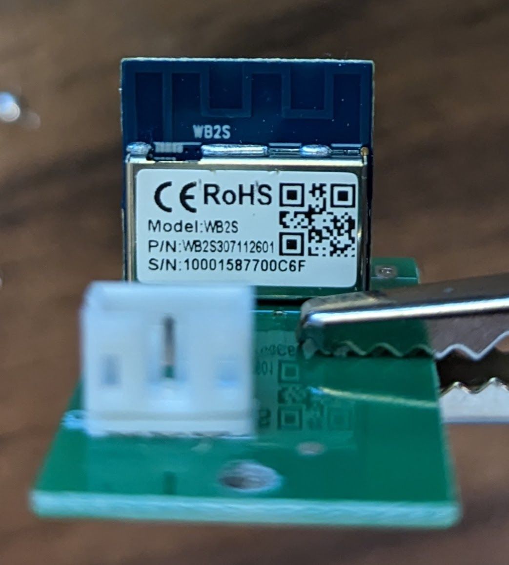

  • Device was on clearance at Wal-mart in the US. These use the "Geeni" app to pair. I did not pair before doing the firmware flash. Used BK7231GUIFlashTool to flash.
    I used an old Arduino Uno board's UART to flash. Had a nice 3.3v source and it tolerated the levels of the USB UART.
    Photos
    [BK7231T/WB2S] Merkury Smart Wi-Fi Outdoor/Indoor Plug MI-OW101-300W [BK7231T/WB2S] Merkury Smart Wi-Fi Outdoor/Indoor Plug MI-OW101-300W [BK7231T/WB2S] Merkury Smart Wi-Fi Outdoor/Indoor Plug MI-OW101-300W [BK7231T/WB2S] Merkury Smart Wi-Fi Outdoor/Indoor Plug MI-OW101-300W

    Thank you for the teardown. I can see that WB2S is on an interesting mother board, just 3 pins, gnd, power and relay. Very simple device.
