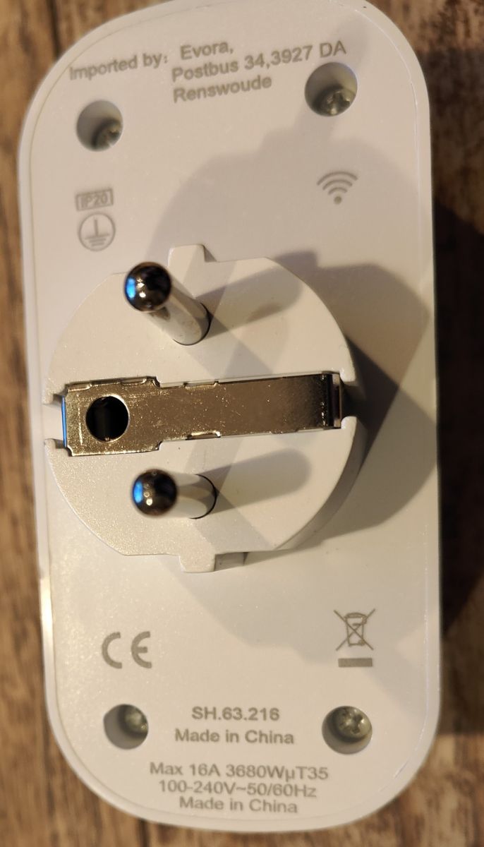

    Now for the physical appearance:
    [BK7231T / WB2S] Teardown Kruidvat Smart Plug Dual (with Energy Meter)

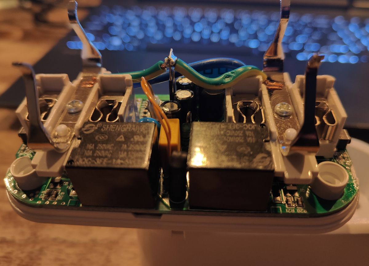

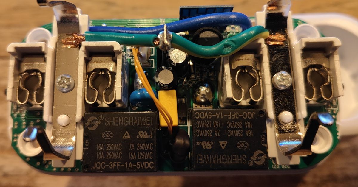

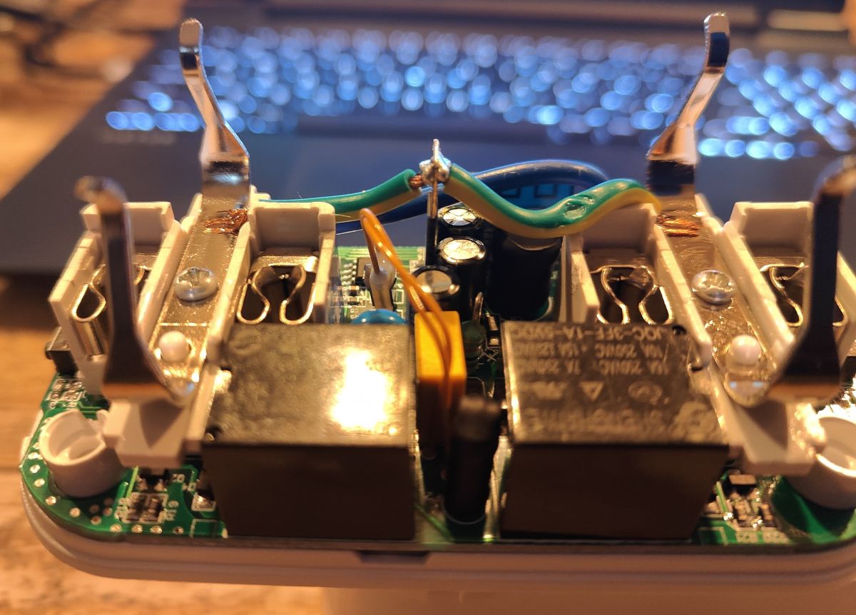

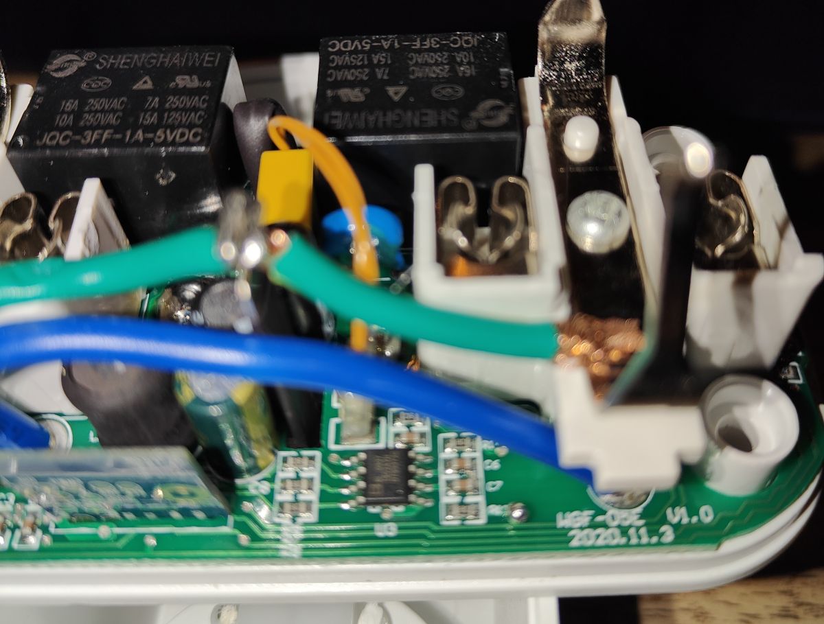

    And the inside:
    [BK7231T / WB2S] Teardown Kruidvat Smart Plug Dual (with Energy Meter) [BK7231T / WB2S] Teardown Kruidvat Smart Plug Dual (with Energy Meter) [BK7231T / WB2S] Teardown Kruidvat Smart Plug Dual (with Energy Meter) [BK7231T / WB2S] Teardown Kruidvat Smart Plug Dual (with Energy Meter)

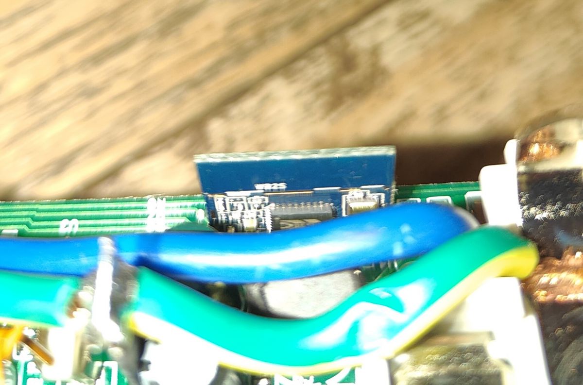

    And now, the stuff we care about;

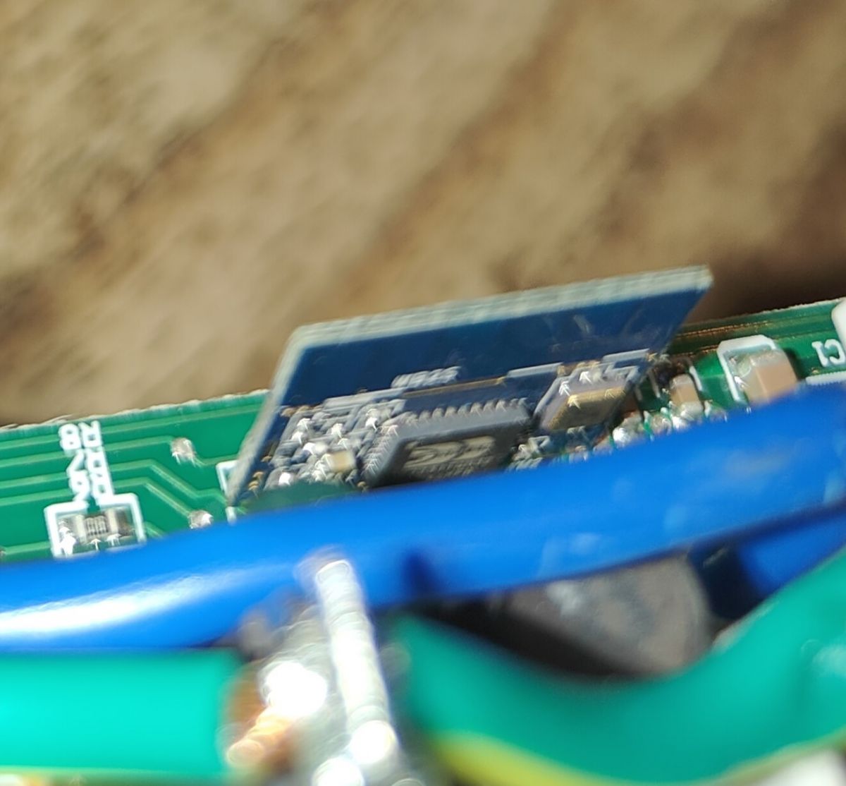

    The unit comes with a WB2S Tuya module. And I can confirm it is correctly labeled. The chip is a BEKEN BK7231T, which makes it compatible with OpenBeken.
    The pictures are not the best, as the Tuya board is mounted closely to the internal chassis parts that make up the socket and relay.

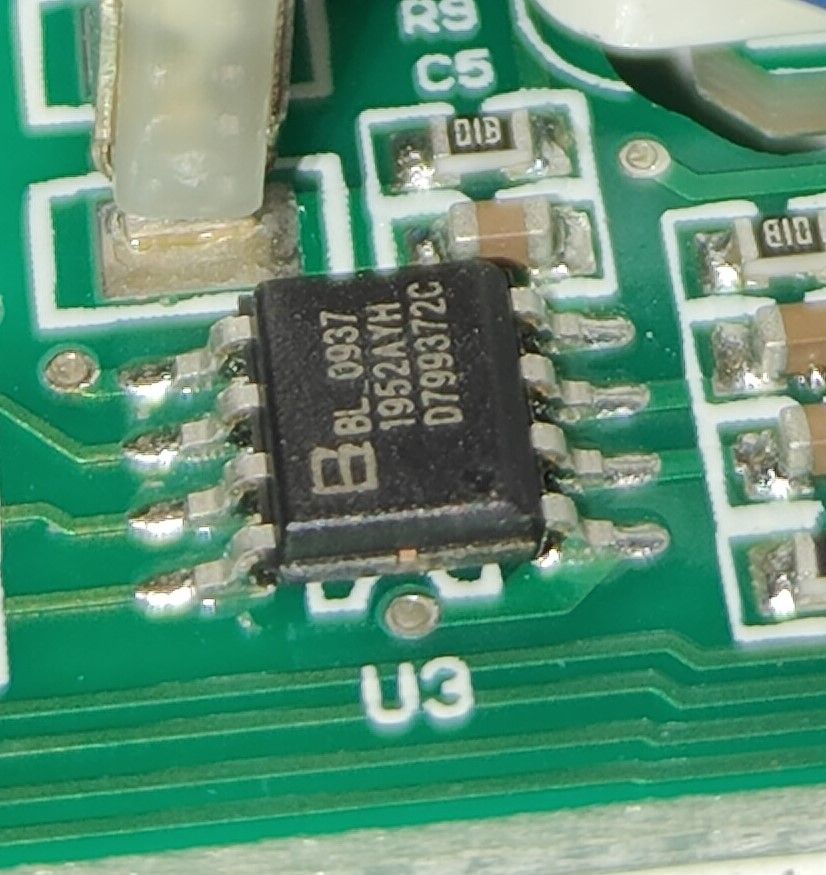

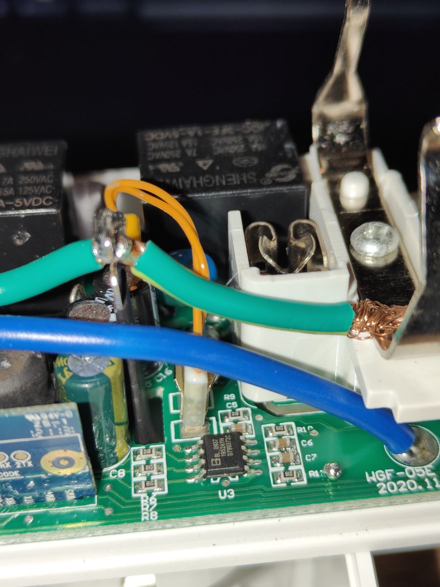

    And now, what makes this Plug such a good purchase? The BL0937

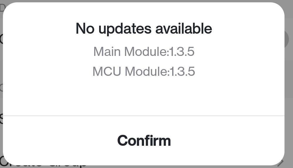

    This unit came with MCU version 1.3.5. I need the version number for cloud-cutter. Unfortunately, I've not found an easy way to recover the build number without installing the Tuya Cloud software. For now, it is fine as I am using an old android device that I disconnect from the internet.

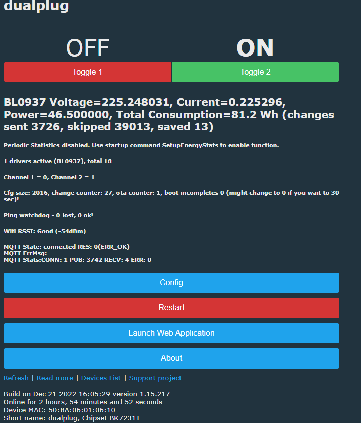

    Some tweaking; Selected Flag 6 for instant switching

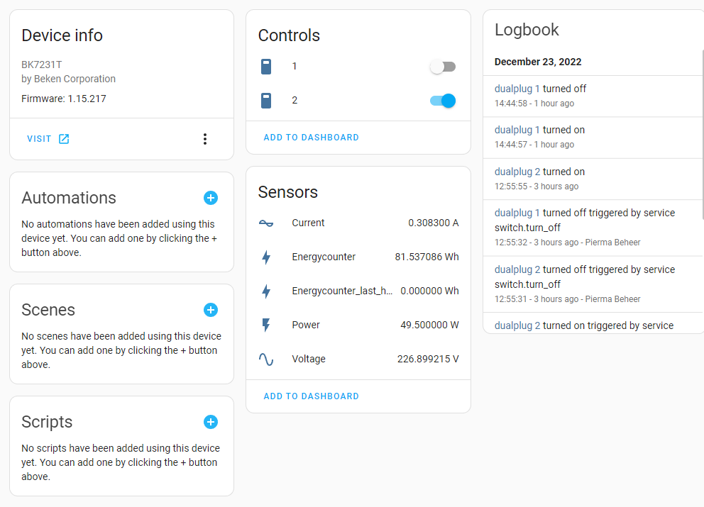

    Configured MQTT and it works perfectly

    As the BL0937 seemed uncalibrated, I had to do some calibration. The voltage was set to 220V, but we ran around 234V. So with the VoltageSet command, I corrected this. The load value was 60Watt, using a 60 watts light bulb. So no calibration is needed there. I would like to do a posting on calibrating the BL0937 sockets but may be some one has already done so.
