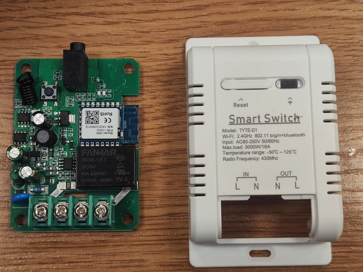

    Hi. I don't know. if this is the right section, if not please move the thread.

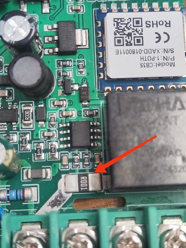

    I have purchased a TYTE-D1 temperature switch controlled by Tuya. It has a temperature sensor and it allows you to control, for example, the heater in to heat water in the boiler according to a set schedule and turn it off once the water has heated up to the right temperature. Unfortunately, although it has a declared load of 3000W, there is a note in the description that the resistance load is only 1000W. I have connected a heater with just 1 kW to it, which, however, in practice (at the start of heating) gives a load of up to 1100 W. This is too little to damage the switch, but enough to trip the overload protection and disconnect the unit. After taking it apart, I can see that there is an electronic component on the path carrying the 'phase' to the relay that may be responsible for the overload protection. And here is the question for you. Is it possible to bridge this component to remove this protection? I can check it, but I don't want to tamper with the device because I can still return it free of charge. I warn you that I do not intend to use it with more load than this 1 kW heater.
    Close-up of a circuit board with a highlighted electronic component. .
    Circuit board and case of the TYTE-D1 temperature switch. .

    How does the device supposedly check what type of load it is? The relay inside is for 16A. It's a low resistance resistor.

    The device, moreover, has a so-called energy consumption meter. It was on it in the application that I could see that when the heater drew less than 1000W, everything was OK. But when it momentarily increased to over 1000W, it would disconnect the relay after a few seconds. Now I see that this protection probably cannot be circumvented in a simple way. I also don't understand why they declare 3000W/16A on the device, but in some situations it is only 1000W.

    Continuous load, long operation - larger path cross-sections - heat dissipation, arcing during diverting.
    Add an additional relay triggered by this device.
  • #5 21446432
    akm97
    Posts: 274
    Rate: 78
    Well, yes, only that it would have to be a 230V controlled relay and in addition I will lose the function of measuring the energy consumed. I also got information from the shop that it is possible to remove one fuse responsible for measuring power, (I don't know which one) only that this would also "remove" the wattmeter function.
