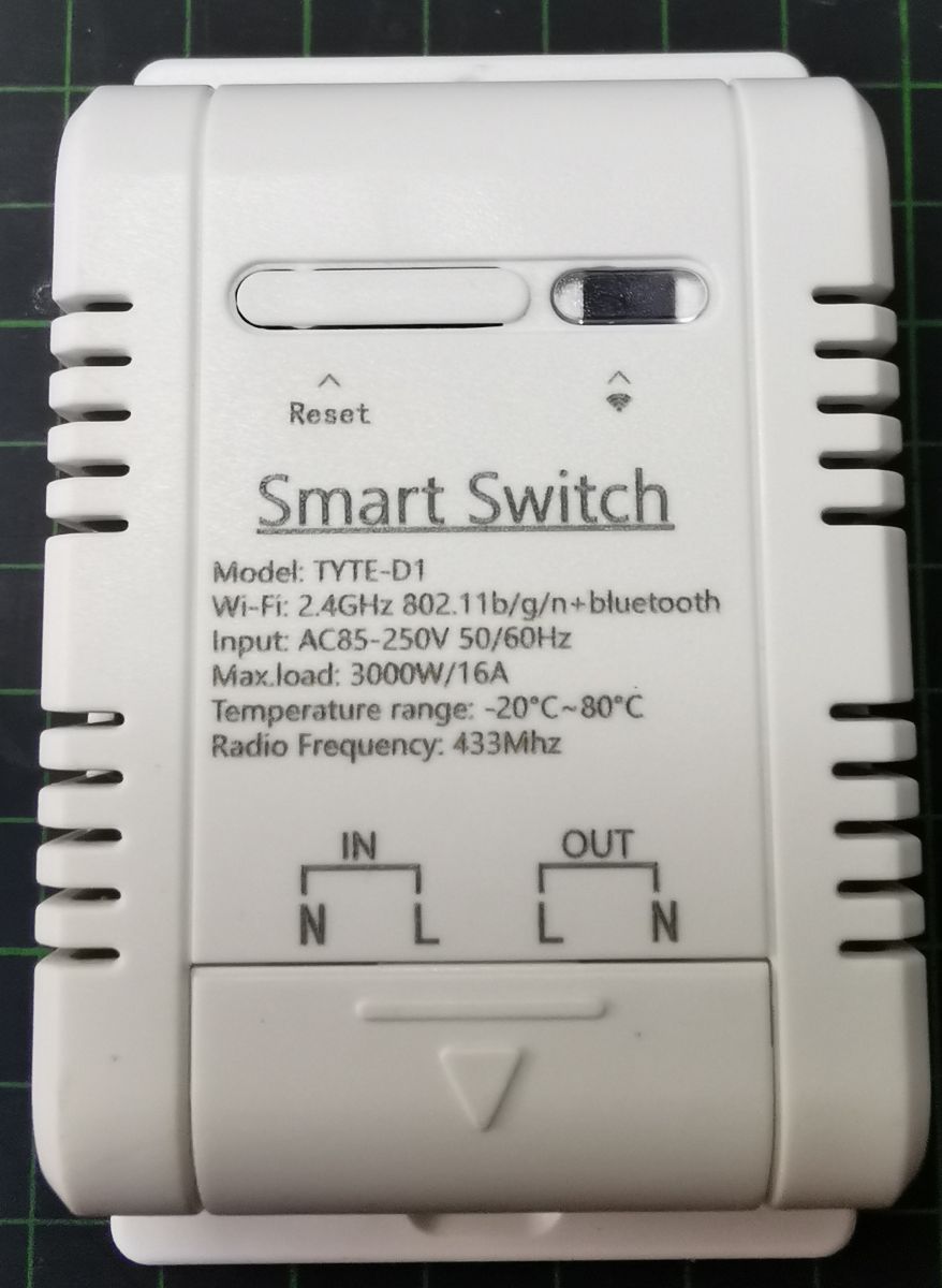

    Here is my new project:
    Tuya Smart Switch
    TYTE-D1 Wifi / bluetooth temperature relay

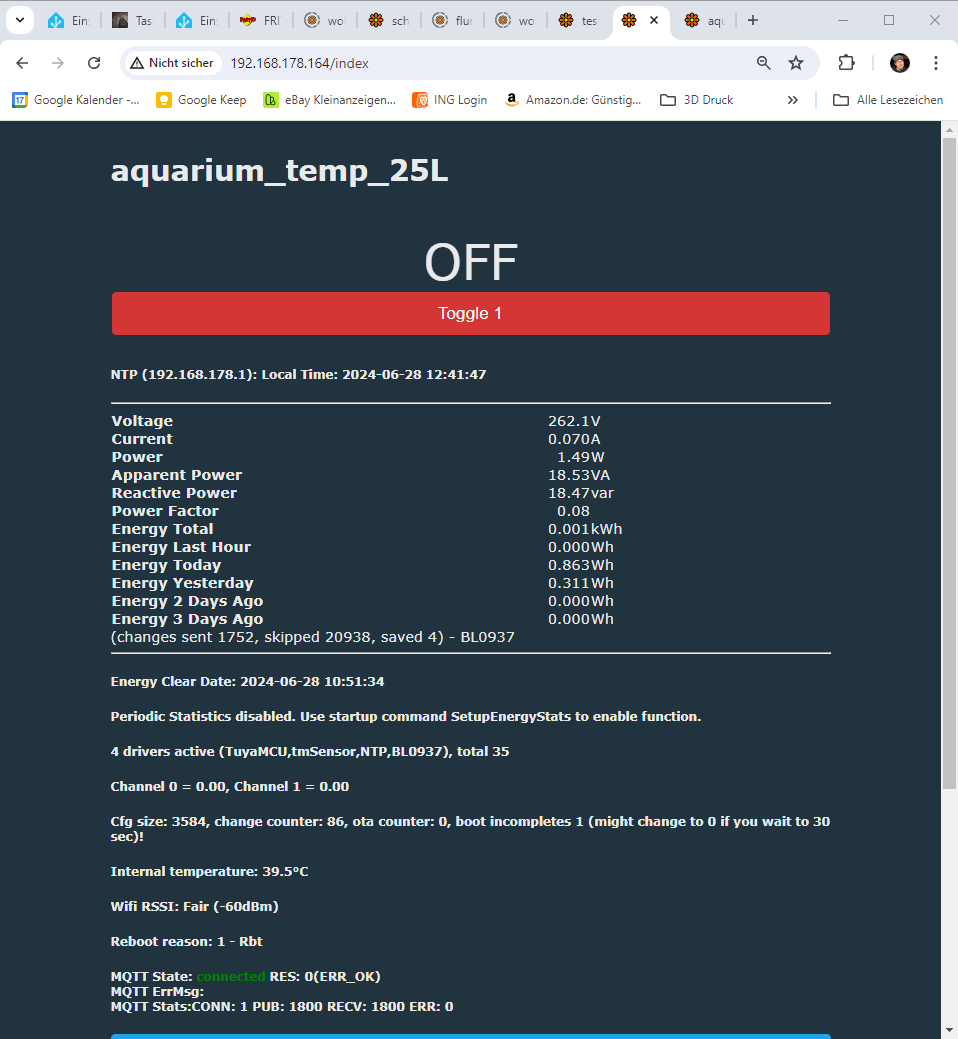

    I've flashed it, works fine, get the power parameters, relay is working, but I can not get the temperature.
    White Tuya smart switch model TYTE-D1 with visible technical specifications. Tuya Smart Switch circuit board with electronic components including CB3S module.
    Screenshot of a web interface showing relay status.

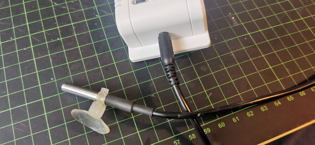

    I want to use the relay to work with my aquarium heater, there is an external temperature sensor.
    Where is my fault?

    >>21135733
    It's an external sensor via 3.5mm plug.
    External sensor connected via a 3.5 mm plug to a white device on a measurement grid.
    I don't know the GPIO pin.

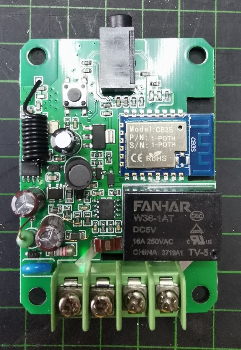

    I flashed your dump and factory reset it. This is the boot log
    obviously I don't have the sensor attached, but it looks quite clear from the reset fail messages it's a DS18B20 sensor from Analog Devices

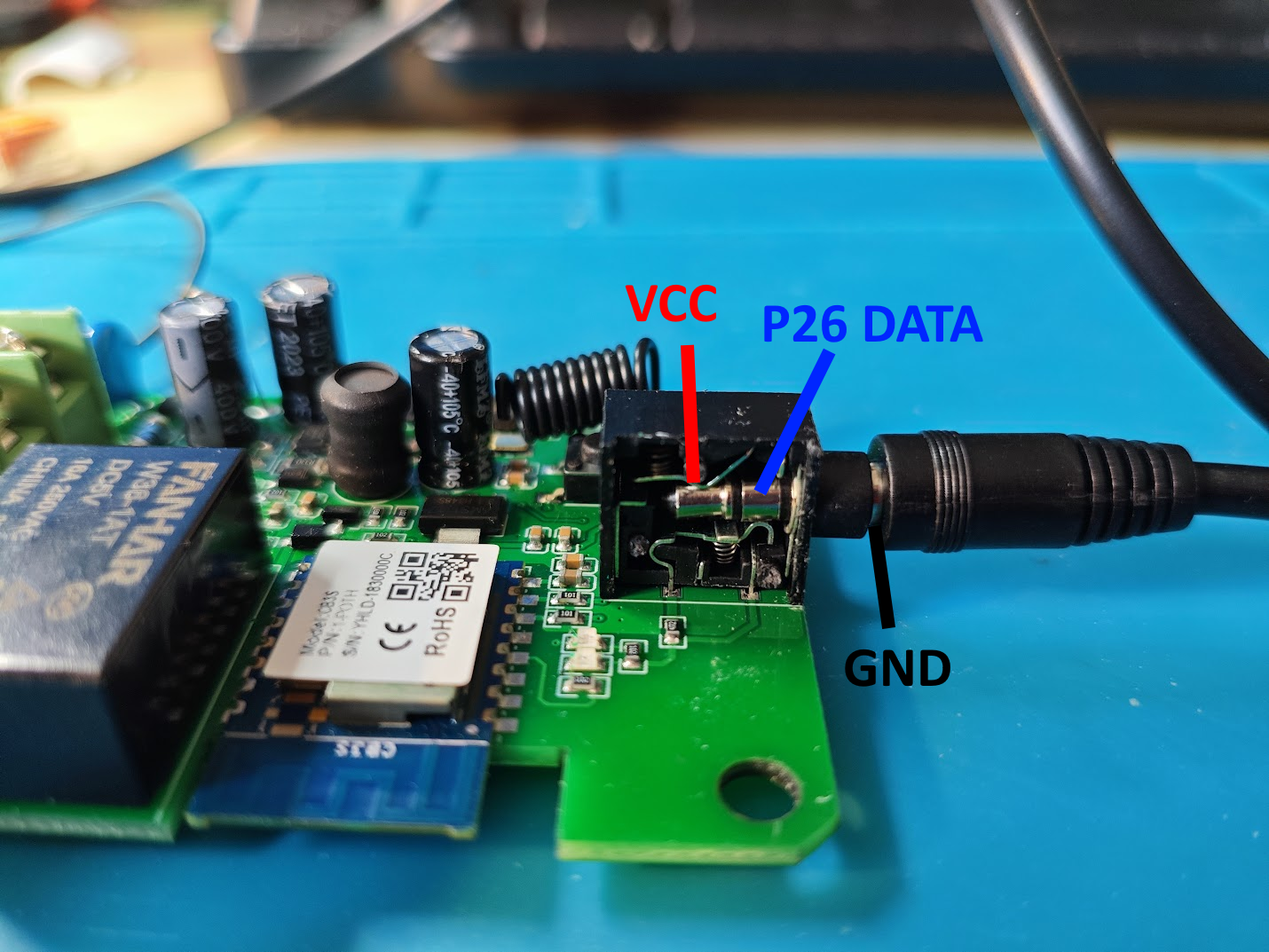

  • #6 21138205
    Posts: 5062
    Help: 438
    Rate: 893
    If you have a multimeter you could trace to where it goes on the CB3S module. But still, a driver would need writing for the DS18B20 I imagine.

    #9 21147604
    Posts: 5062
    Help: 438
    Rate: 893

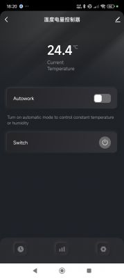

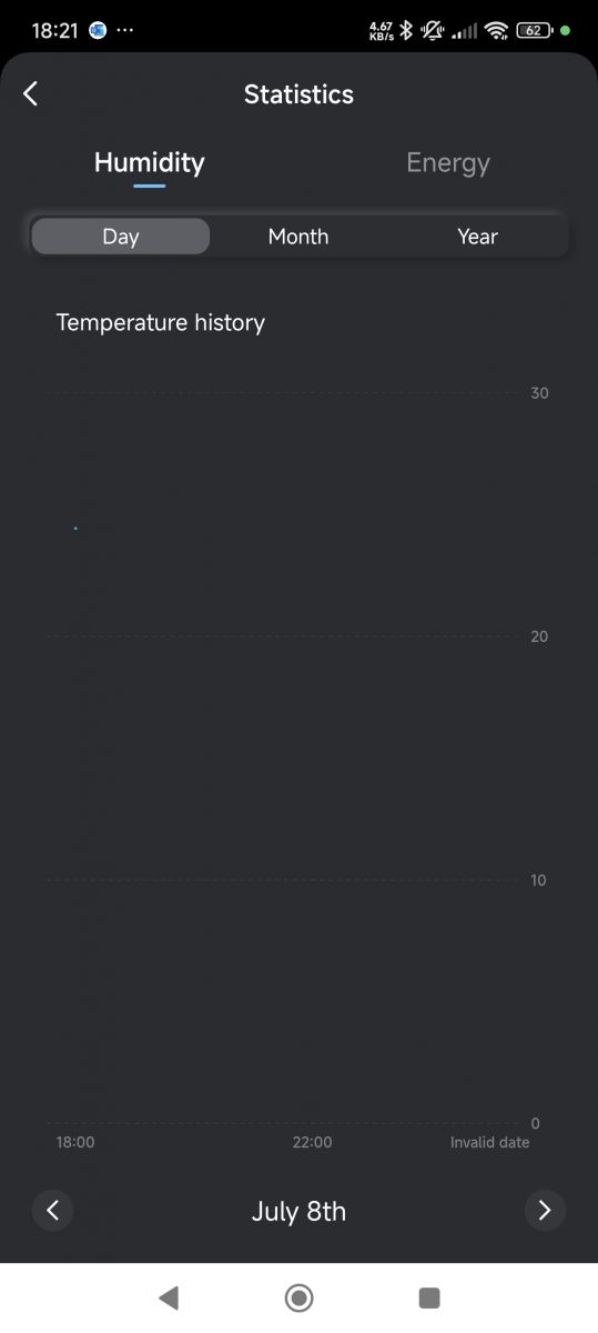

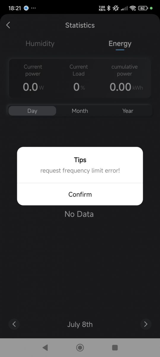

    The GPIO for DS18B20 on the TYTE-D1 is P26
    "sel_pin_pin":"9",
    "bt1_pin":"7",
    "vi_pin":"6",
    "netled_pin":"14",
    "one_wire_pin":"26",
    "ele_pin":"24",
    "rl1_pin":"8"
    one_wire_pin could be a new detection for Easy Flasher I guess. I've not seen this for any other device though.
    I didn't know One Wire was a standard

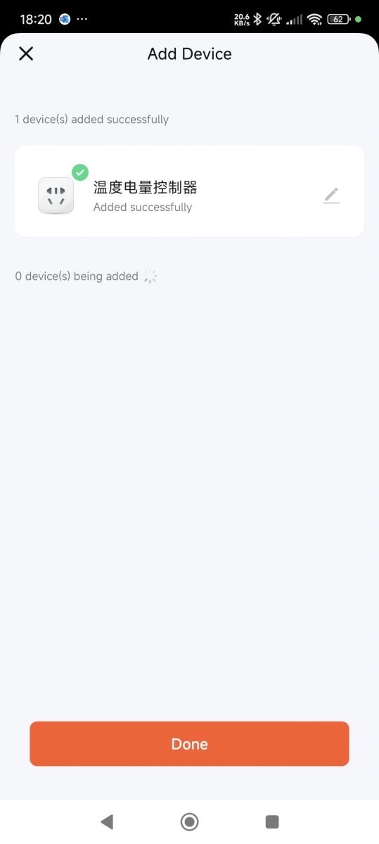

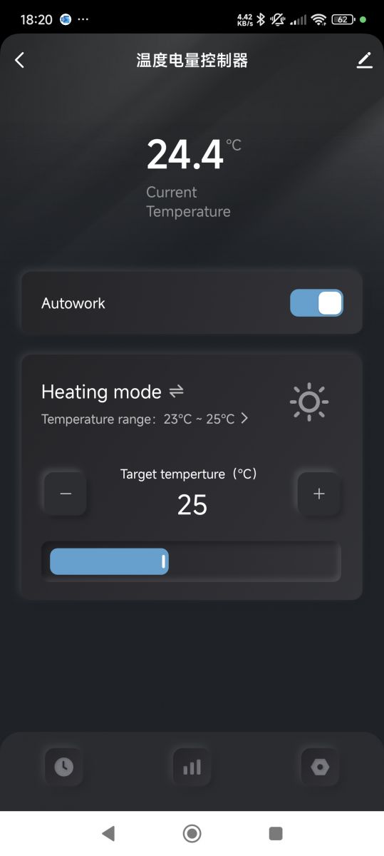

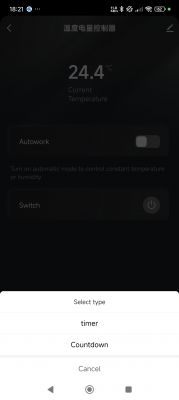

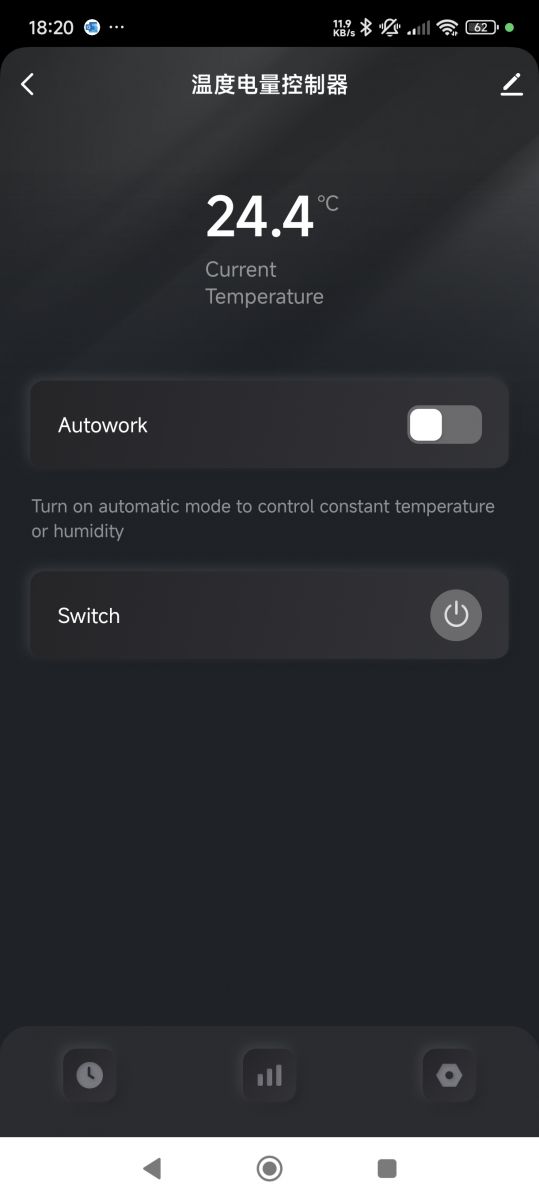

    for the record here is what the Tuya app options look like for TYTE-D1
    Tuya app interface showing current temperature. Tuya app on a phone displaying temperature and automation options. Screenshot from the Tuya app for TYTE-D1 with an error message and statistics. Screenshot of the Tuya app showing humidity statistics for TYTE-D1. Tuya app interface on TYTE-D1 showing current temperature 24.4°C, autowork settings, and options: timer, countdown. Tuya app screen with added device.

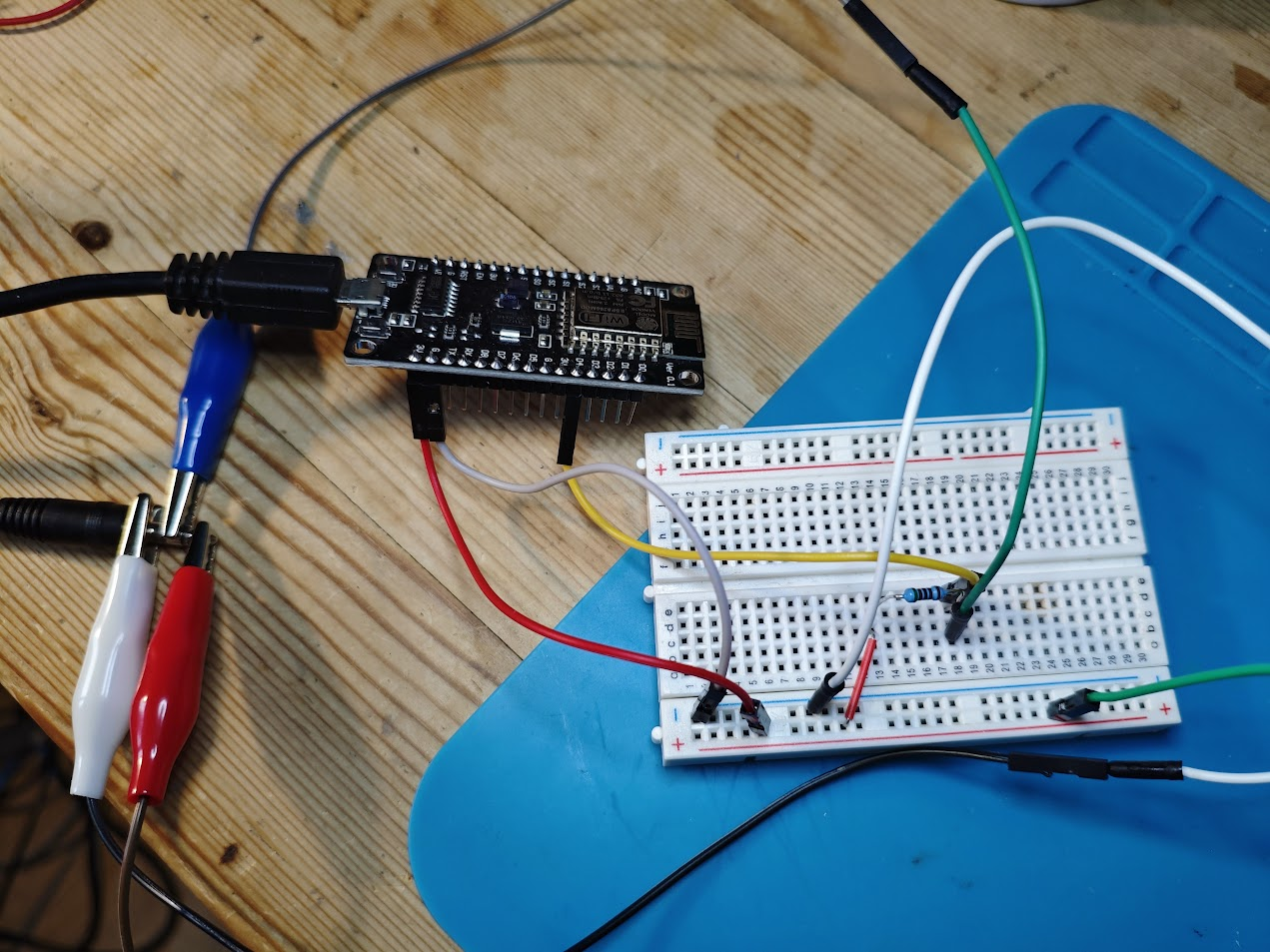

    I have not progressed since last post on closed PR comments. I was posting 3.5mm jack continuity findings for the record
    Added after 10 [hours] 50 [minutes]:
    with an adapted single Arduino sketch to combine the print_family, check_fake and discover_fake examples from https://github.com/koendv/CheckDS18B20/tree/main with the DQ (data) pin connected to D4/GPIO2 of an ESP8266 NodeMCU we can see that the DS18B20 in my TYTE-D1 is a Sensylink clone - CT1820B
    Code: Arduino
    Screenshot of results checking DS18B20 chip for clone.
    https://en.sensylink.com/html/web/product/wdcgq/xpbdcw/1662800678185840642.html
    ESP8266 NodeMCU board connected to a breadboard with wires.
    • sensylink_ct1820b.pdf (241.22 KB) You must be logged in to download this attachment.

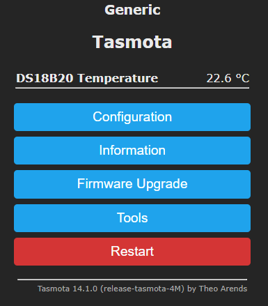

    well. the latest I know is that on BL602 the driver seems good https://github.com/openshwprojects/OpenBK7231T_App/pull/1294
    but regarding the TYTE-D1 and Beken the latest is that with startDriver DS1820 18 the fewest CRC errors are seen with PR build 1296_merge_7117258cf00e with powersave 0. I don't think I found a working timing with powersave 1
    https://www.elektroda.com/rtvforum/topic4056286-30.html#21165621
    I think @max4elektroda was going to do something with a logic analyser

  • #26 21316992
    Lawk1961
    Looks as if there is a sub GHz radio as well. Coiled antenna opposite the WiFi module. Top label says 433MHz

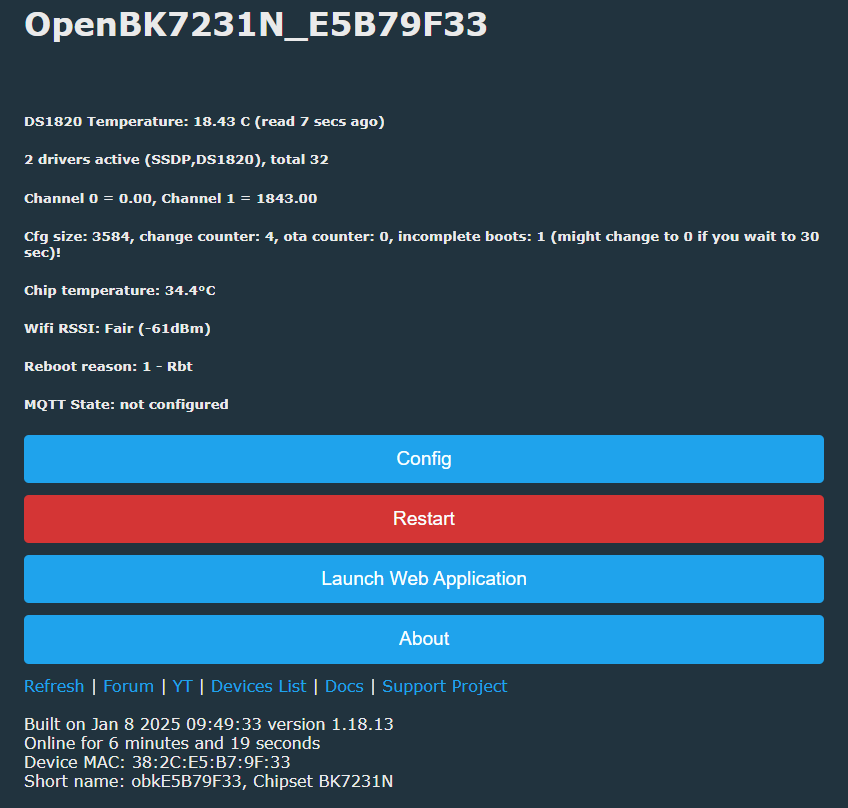

    I am waiting for final shipment of DS18B20 set from China, so I will be most likely soon able to add DS18B20 to my test boards. I'll check this out and let you know. Please remind me if I forget (like in a week or two).
  • #30 21382943
    Posts: 5062
    Help: 438
    Rate: 893
    OK for me on latest on P26
    OpenBK7231N_E5B79F33 settings screen displaying temperature and Wi-Fi information
